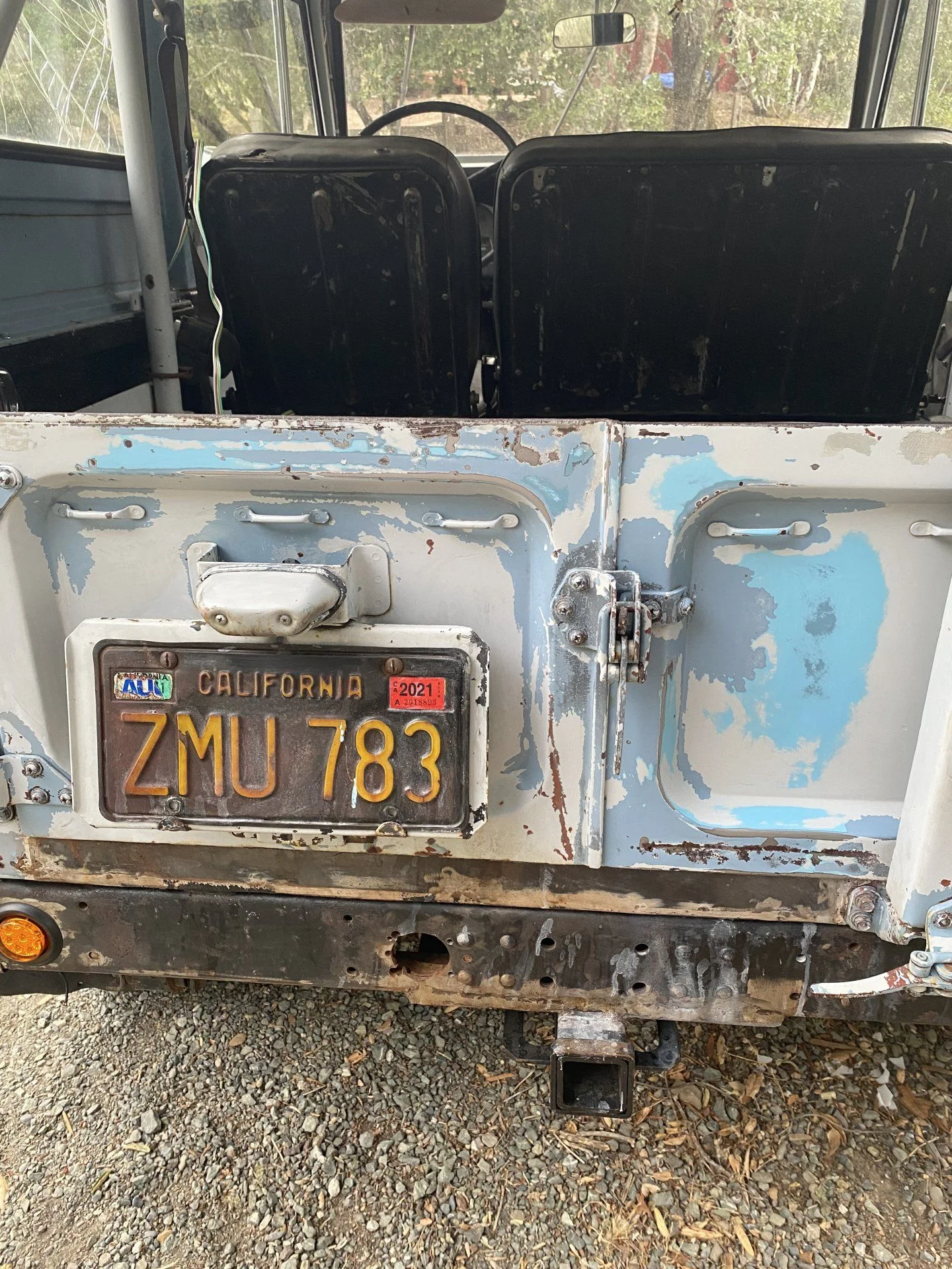

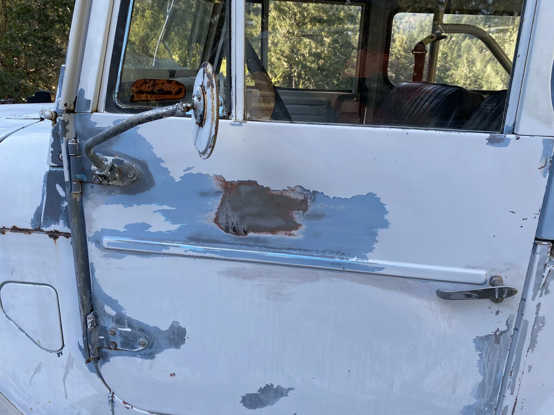

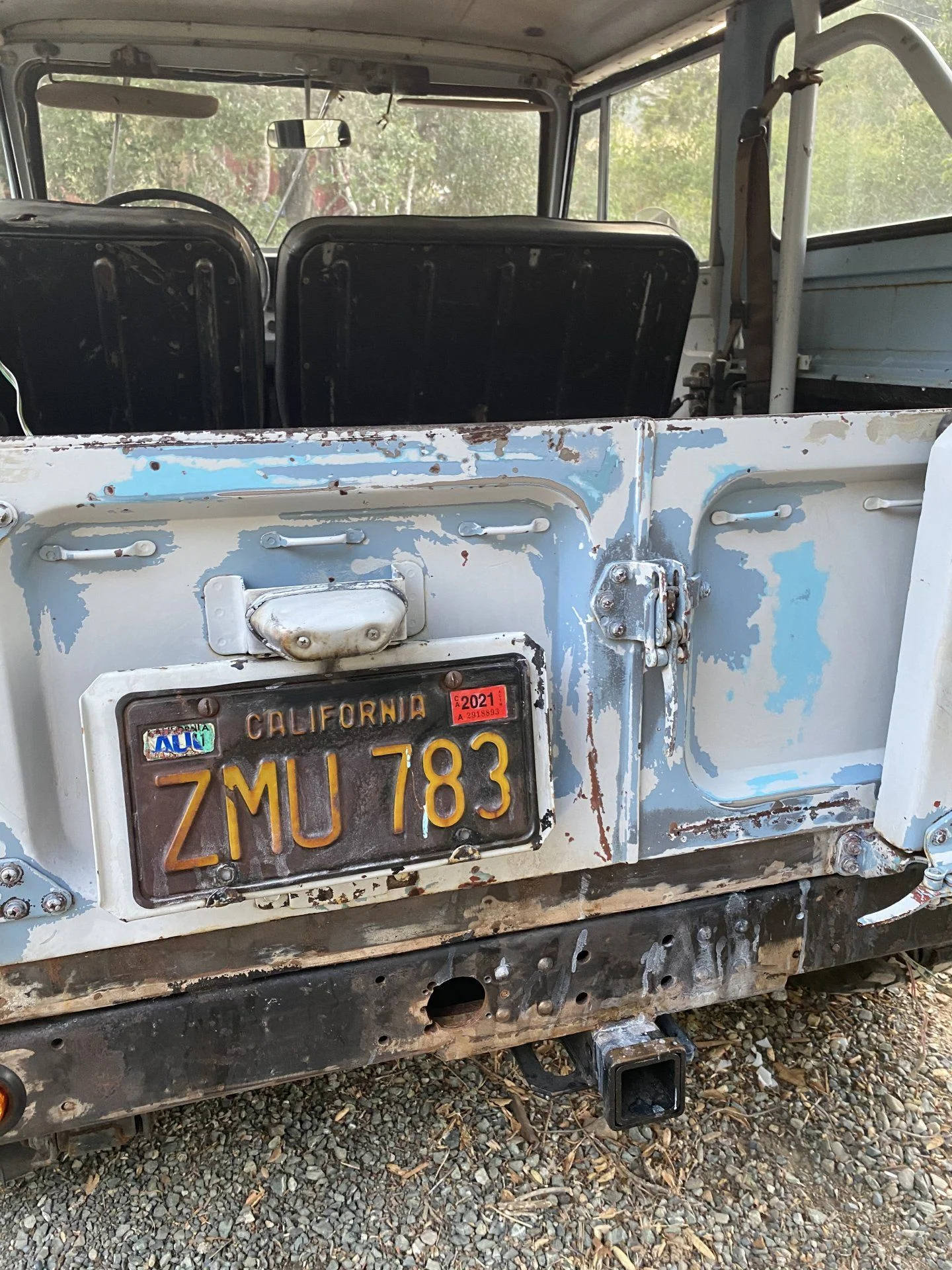

Started to try and get down to the blue with lacquer thinner and purple scotchbrite.
Ran out of lacquer thinner. I tried zep oven cleaner but it didn’t do anything. Maybe it has to be easy off.
I think it's trial and error. Success and method seem to vary, depending on the prep done for the paint job. I bet my wife and I have 100 hours into getting back to the original paint on our 40, and we haven't started the inside of the tub. It's definitely a labor of love! Keep trying in hidden spots and hopefully you'll find the secret for that truck!
I'm inspired by your work @projectTuRD - I'm wanting to take off some cheap paint from areas of my truck. The front bib was painted white at somepoint, but I can see the original yellow underneath in a couple of places.
I used EZOff under the hood and it was too much, took it down to the red primer, unless the hood was originally red, which is entirely possible).
I've had good luck with aircraft stripper for removing serious over spray on my headlight buckets. It removed some of the cadmium plating, but the chrome on headlight rights was completely unaffected. But it may be too strong and could take off ALL the paint. I'll the Scotchbrite and thinner first.

And I have around 100 hours in stripping po primer to get to the original beige. My best method was automotive lacquer thinner in a spray bottle and using a stiff brush and lots of 0000 steel wool and rags. I wonder why they always want to spray Grey primer on everything. Actually I believe some of my gray was some sort of an industrial spray paint
I bought a spray bottle just to try this out. I waste a lot pouring it onto the scotchbrite pad.
