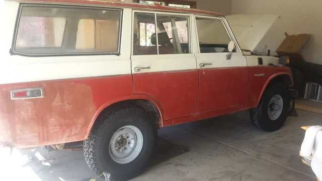

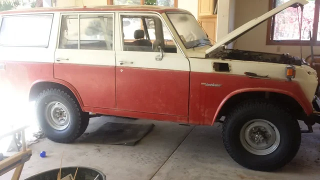

Quick update. Progress moving along at the speed of a....well....an fj55...Received my new window gear and got the rear window working great from both the gate switch and dash switch. Now just need all the weatherstripping to seal it up. New steel wheels should be done at the powder coater tomorrow and then off to the tire shop for the new 33's. Power wash done underneath, tune up done and motor seems to be running well. As soon as the wheels get put on, its off to the body guy. Should have the new lift kit in the next couple of weeks. Waiting to find a bunch of parts. Definitely a slow moving process. Pretty fun tho.
Replaced the dry rotted rubber with the new kicks today. Thought I was going to actually be able to take a little test drive....nope, fuel pump decide to take a leak. Oh well, Maybe next week.
Those are 33x10.5x15? If so, how have they affected the power? Does your truck already have some type of lift? Maybe a shackle lift?
I have not had a chance to drive it yet. Drove it down the street with the dry rotted 31" tires it came with but never got out of second gear. Pretty low gearing, hoping power won't be too much of an issue. I know quite a few others run 33's with original gearing. I don't plan on setting any speed records regardless. Thought I was going to be able to take her out for a test drive but of coarse the fuel pump went out as soon as I got the tires on.
No lift, no shackles, just stock original springs. Planning a 2.5" lift from cruiser outfitters.
I'm in the same exact boat as you. I have the tires but can't decide wether to pull the trigger on that lift. Can't wait to see pics.
Tires seem to fit fine with the stock springs. I like a little more clearance so will definitely lift. I know a guy at a local spring shop. Plan to have him check it out for options when I get it running. If he doesn't have a better option I will go with the Cruiser outfitter lift. May be a while for pictures :)
