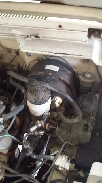

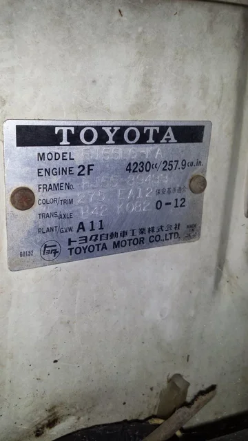

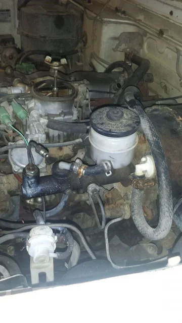

I have attached a picture of my trim tag. Yes on the ASCO. Looked for holes on the block. Kind of hard to see whats going on plus not sure exactly what I am looking for. Also attached a pic of my master cylinder. Not sure it is correct. Others I have seen look different. Mine had a trailer brake set up of some type. Getting rid of that but thinking maybe my master cylinder was modified?? Looks different from a couple other '78's I have seen.

There should be another VIN tag at the lower part of the driver side "B" pillar that will list the build date.

Your master cylinder looks like someone swapped in a MC from a 60 series.

Checked the door tag. May 1978 build. Hope the PS holes are there. Would like my wife to be able to drive the pig on occasion. I don't think she will be a fan of no PS.

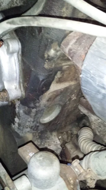

Bolt holes on the block for PS pump mount:

No Luck, Bummer. See pic

Yeah, just a long shot. I think by late '78 (or if block had been replaced) they were installing blocks set up for PS pumps.
Nothing is impossible if you are dumb enough - see my PS thread linked above for how I overcame the lack of PS pump install provisions on my block.
OEM power steering only appeared on 79's and there aren't may of those around. There are plenty of options available to add PS - search the 55 section. My wife drives her 55 w/o power steering with out issue - you just need to get it rolling a little before you crank on the wheel. She calls me soft because my pig has PS :steer:.
