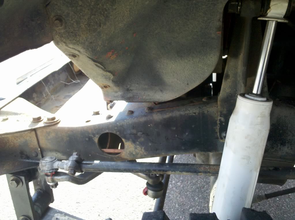

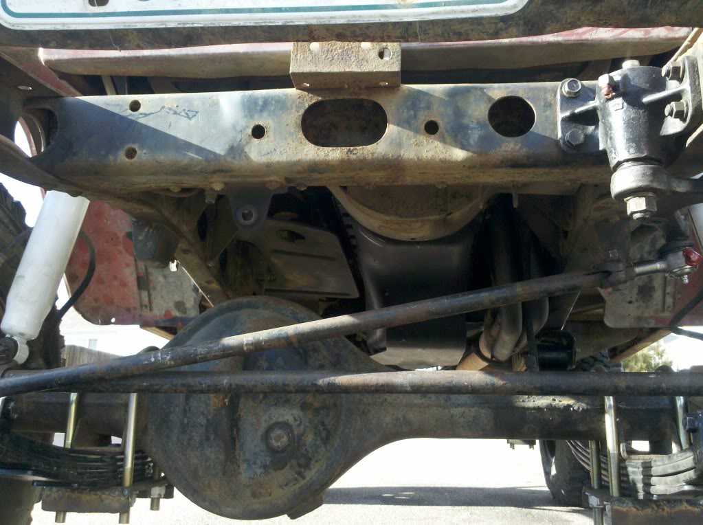

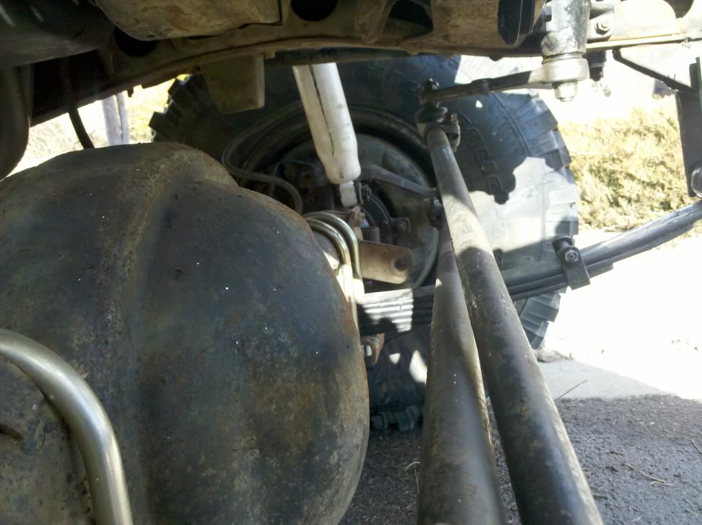

The front axle is sitting too far forward, even the shock angle is off...
Most likely front springs need to be flipped around...
I agree than the front axle is further forward than the stock position. But, before you go changing anything, keep in mind that many 40 owners move the front axle forward (and rear backwards) to stretch the wheelbase from the stock 90".
The shocks may lean backwards, but that's an easy fix by swapping in some Ford shock towers and welding them where you want them. Ford towers will also allow you to run longer shocks, allowing for more spring travel.
Also, if the Saginaw box was positioned appropriately to the axle, moving the axle will open a large can of worms.
Is the axle perpendicular to the center axis of the truck (parallel to the fire wall)?
Is the draglink more or less parallel to the axle? (it's ok if it's somewhat forward on the pitman arm end... but in moderation)

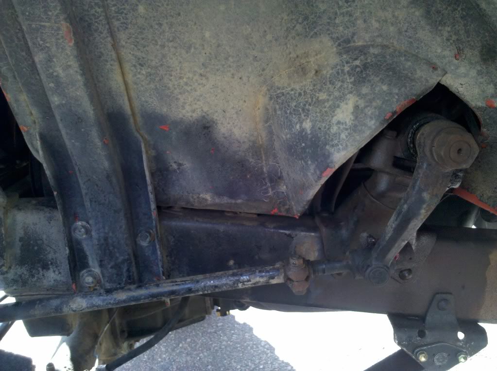

If the stock draglink was used, it likely needs to be shortened. when the wheels are pointed straight ahead, is the pitman arm pointed straight back?
Is the pitman arm indexed appropriately on the steering box? If you temporarily remove the drag link, then turn the steering wheel side to side counting the turns to determine the halfway point... at this point, you want the pitman arm pointing straight back. Now, the draglink needs to be adjusted/modified to fit.

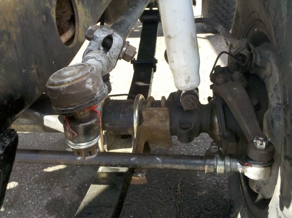

The one other thing you should try to address is the draglinks angle relative to the ground. The Tie Rod Ends used, and the absence of a dropped pitman arm, appear to be making this angle steeper than need be. This will increase bump steer. While you're at it you should see if you can improve this.

Your relay-rod and drag-link are too long, which is why you're having trouble turning left. if you leave the tie-rod (which goes between the two wheels) alone, you can fix this problem... but there's a bigger problem. The end of the drag-link attached to the bel-crank is further back than the axle. It should be further forward... and I don't know the solution. It would help if it came to the center (or top) of the tie-rod, rather than the bottom.
You've got no steering damper installed... it's good to run one to protect things.
You likely need a castor correction shim. After it's installation trim off the excess U-bolt.
The left shock rubs on the relay rod. Your shocks angle backwards.
The bump stops don't line up with the axle.

Oh....and about your steering problem :) Like bikersmurf said above. Pull your drag link off of the pitman arm and turn the wheel side to side. Find center and then see if the pitman arm is pointing straight back. If it's not make it so it is. You may be able to do this by adjusting the link from your steering box to the pitman arm. Then make sure your wheels are straight and adjust the length of the drag link so it will fit up to the pitman. From the pic's it looks like you need a shorter pitman arm and could use some drop to it to get the geometry right.
Once again, if you are thinking of power steering this can all be corrected then. To get by, at least look at the things above. It will help, probably won't fix it all but it will help.
I don't see how a different pitman arm will help. He's got stock 40 steering... Not Saginaw.
The issue revolves around the position of the Bel Crank, and steering linkage adjustment.

We are talking about the same thing here. Bel crank, pitman arm. Needs to be centered, shorter and lower if he wants to keep the axle where it is. Not sure if they make parts to be able to do this or not. Looks like the PO did the job 1/2 way. Cheapest fix would probably be to move the axle back to stock. If it was me and I had the cash, I would convert to saginaw and high steer.
