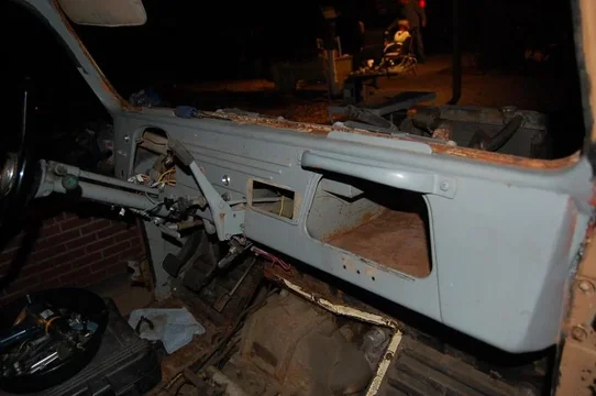

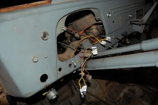

Got a few hours in on the LV last night.......nothing major. Removed the upper and lower tailgates, the lower proved to be a real PITA thanks to some frozen screws in the hinges. Also started removing the dash components and wiring harness.
Should have the body off this Sunday :cheers:
dash pics

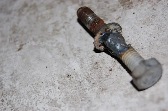

Impact hammer wasn't cutting it on removing the tailgate screws :o
I had to resort to welding bolts on the the screws so I could remove the tailgate latches....... not pretty but effective:hillbilly:

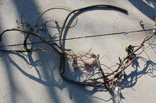

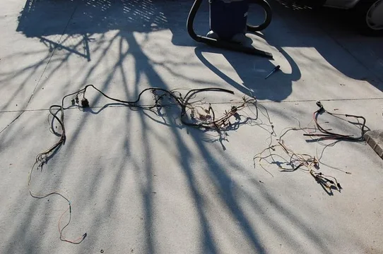

We continued where we left off on Thursday night with removing the wiring harness, steering/ column, etc. in preparation for pulling the body off the frame.
The wiring harness has been butchered thru the years.... looks like I am going to be contacting Coolerman to see if he can hook me up with an LV harness

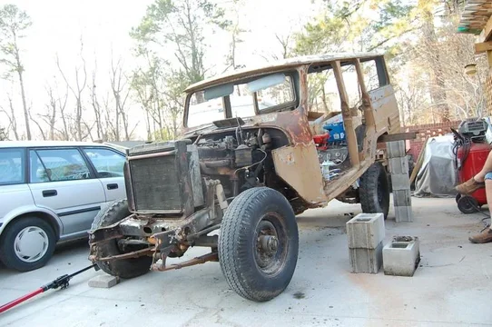

After we removed all the above items and detached all the linkages and hard lines connecting the body to the frame I busted out the impact gun and removed the body mounts. Then it was finally time separate the body and frame!!:beer:

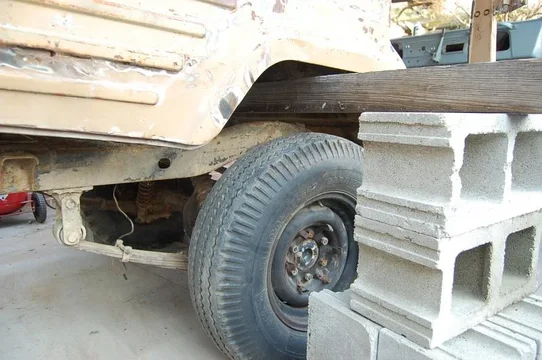

However with a lack of lift or bobcat to lift the heavy body off we had to resort to very primitive and ghetto methods to remove the body. I can't say I am particularly proud of our methods but they worked.:hillbilly:
We resorted to using two high lift jacks, some cmu blocks, and 4x4 posts that we had laying around..... flame away:beer:
She is free!!
ghetto....
had to add another block to get high enough to clear the wheels.... gotta love the rake

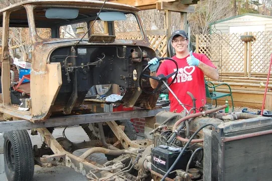

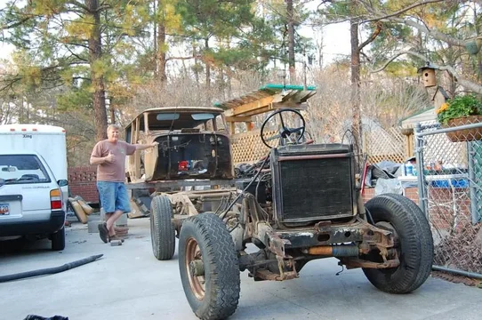

After getting the rear situated we moved to the front end were we experienced our first real "DUH HUH" moment of the project so far. We had the front end jacked up high enough to clear the tires so we could roll out the chassis but for some reason we couldn't get the chassis to roll more than a couple of inches :confused: First thought was that some how the tranny had gotten knocked into to gear, so a quick check revealed it was in neutral. So we then turned to make sure we had disconnected all the lines and wires.... our quick search revealed nothing. Confused we tried again to roll the chassis out with no luck again..... frustrated we decided to take a break to think it over for a minute. It was only when we stepped back from the cruiser far enough to see the whole thing that we realized our problem:o
Take a look at the photo and see if you can spot what we forgot to detach:doh:
with the radiator support rod disconnected we finally rolled the chassis out :rolleyes:
With this milestone reached in our project I got a little caught up in the moment......:grinpimp:
I sure hope we don't get any gusty winds in the next couple of days......:eek:

blocked cab
That blocking setup for your cab looks like some of the finest work straight out of the Clemson Engineering Dept! Sorry, couldn't help it....football season is NEVER over.

....small cause...... big effect :D

Thanks Peter..... how does that old saying go?? "Sometimes you can't see to trees for the forest" :D

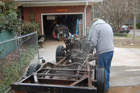

Made some more progress Sunday....... nothing to exciting but it was work that had to be done. Pops spent the whole day pressure washing the frame/ axles and scraping all the mud/ gunk out of the frame rails. My lil sis and I spent the day using paint striper to remove multiple paint jobs from over the years!
Enjoy the pics :cheers:
Before pressure washing.....
during.....
finished.... much better
