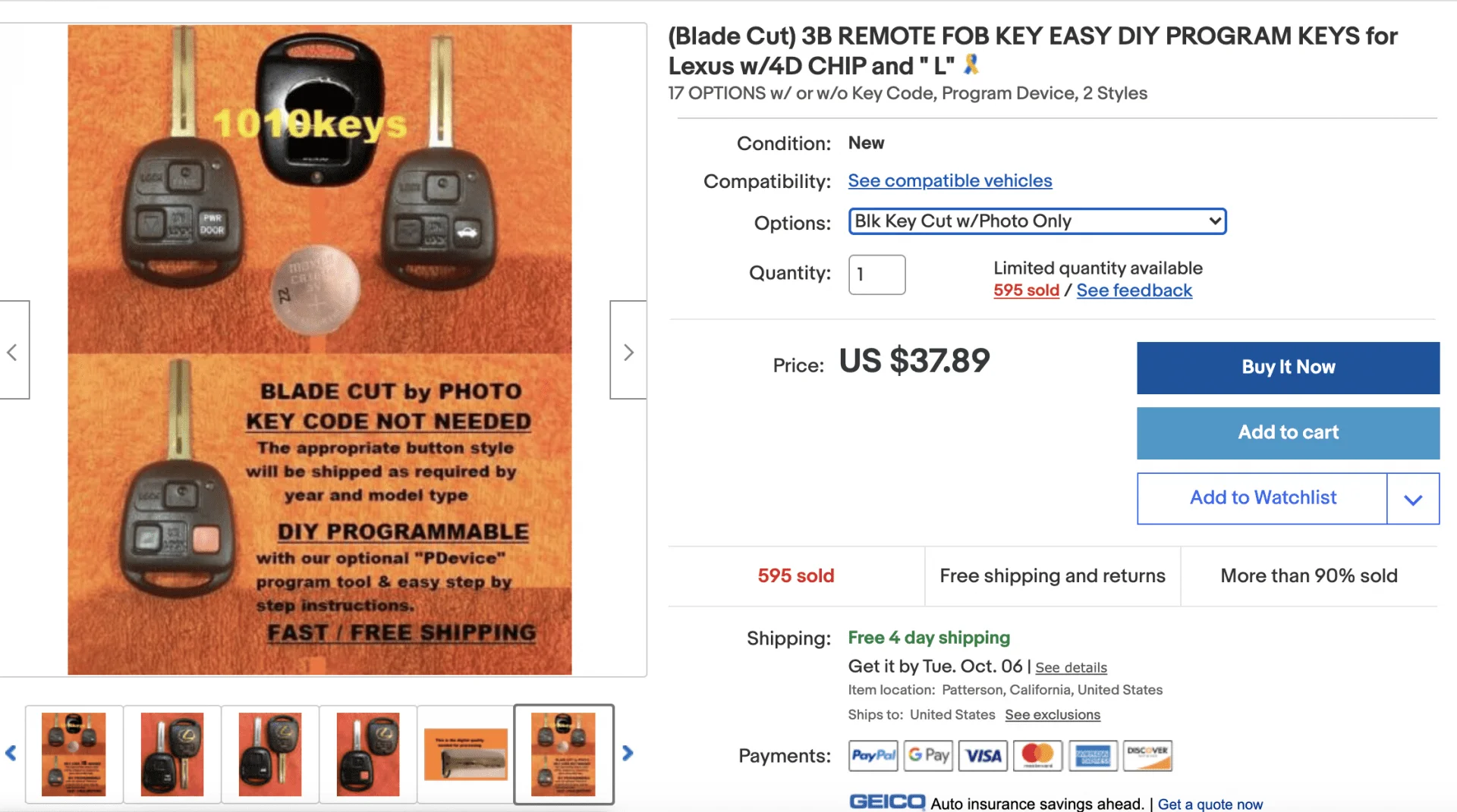

Can someone talk to me like I'm stupid? I own a repair shop, just bought a 2005 GX470. I love the car, but it came with one crappy half broken key fob. I read a lot on here before posting. I emailed 1010 keys only to find out nothing and they definitely respond in a cryptic language barrier manner. I just want two of the OEM style 3 button key fobs to lock/unlock/start my car. They won't give me straight answer on what to buy. I told them I have Techstream etc. They responded with what I can only call jibberish. Can anyone help me out? Or should I just pay the 150 my cost for a new key fob from the dealer?

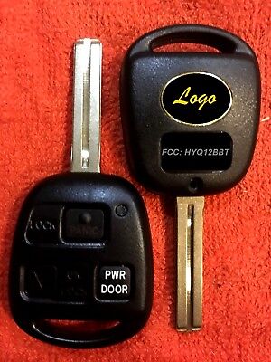

If the transponders are good, swap them into fob shells amd get the blades cut.
I recently ordered a key, heres beta another listed from my other posts.
rover.ebay.com
2 New Replacement Key Case Shell Keyless Remote Fob Uncut Blade Lexus Gold Logo | eBay
Our new Lexus key now carries the Lexus logo in gold just like factory. There are no electronics included, simply place your existing electronics inside and have the blade cut. This is perfect for people who want to fix or renew a broken key.
Just order the keys from 1010 on Ebay. When they show up, program them with techstream. Done. You are making this harder than needed.
You can also get a replacement shell to fix the broken key from Ebay.
Thanks man, not trying to. Which one of the 17 options do I order? That's my question.
This thread rocks! Ordered 2 new keys with transponders from 1010keys on eBay for $45. Followed the immobilizer and programming instructions and SHAZAM! 2 new fully functioning keys for $45 instead of $195/each at my local locksmith. Thank you all!

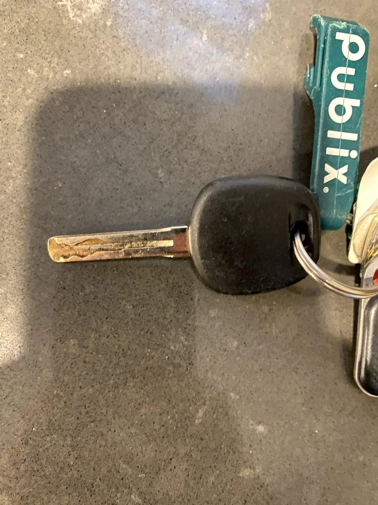

Ok I'm still a little confused after reading this thread. My wife has a 09 gx470. She lost the master and fob at some point and buddy of my father in law cut a key based on the Valet Card Key years ago. Well that key has not been working at times. It will not turn the door cylinder or the ignition cylinder.
Here's a picture of the current key
Can I use these 1010 keys to replace?
Do they come with the remote lock/unlock?
If not do I have any other option other than paying the dealer?
^ Just take a photo of a good known key that works in all the locks and use 1010keys to cut it, I only had one key and thats what I did. No issues at all with my new keys aside from them being slightly tight in the ignition lock cylinder the first few times they were inserted until they "de-burred" themselves.
