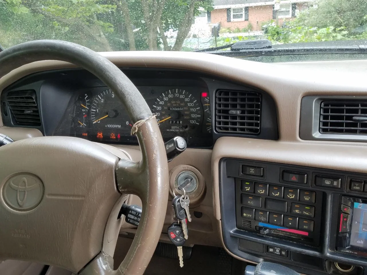

My steering wheel was extremely worn, and a hole about 6 to 8 inches was cracking across the top of the wheel. Because of my OCD, I knew I had to fix it. My research brought me to a steering wheel cover, which is offered by a company that is associated with this website, but the prices seemed high, the color did not seem to correctly match the factory color, and the vendor has several questionable ratings on the “Buyer Beware” section of the MUD classifieds. Due to all these factors, I set out to do everything on my own.

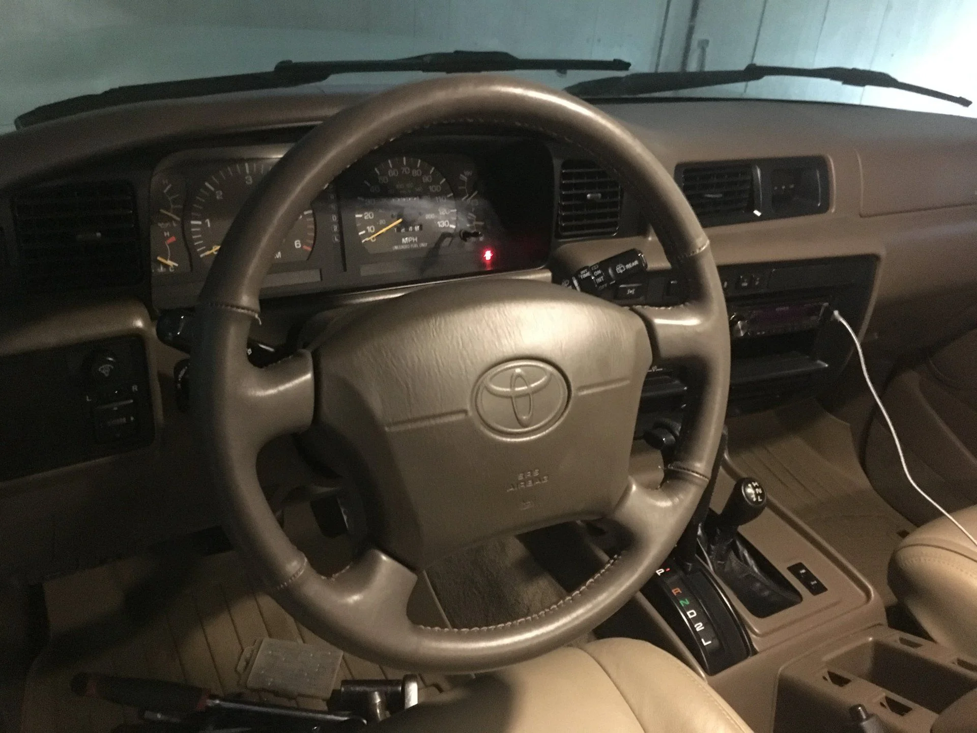

I spent a good part of yesterday afternoon installing my new cover. Now, I am definitely not very handy with a needle and thread, but the results are fairly good, considering my skill set. The leather, on the other hand, looks beautiful.

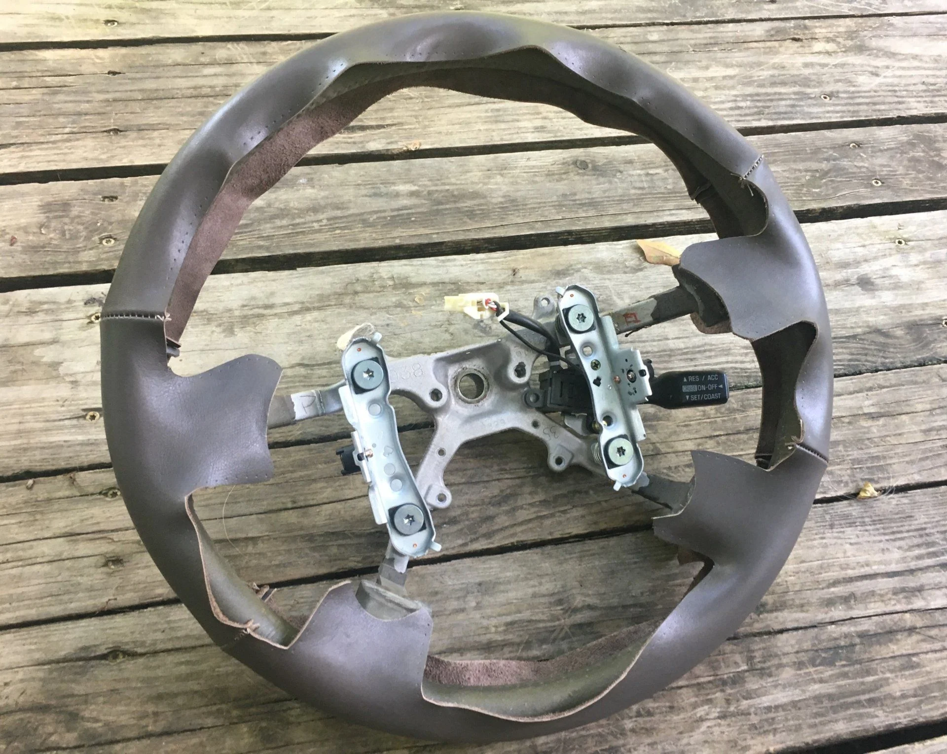

In this picture, I am using some E6000 adhesive to glue the edges of the leather down around the contours of the spokes. I am using green frogtape to hold everything in place until the the glue cures.

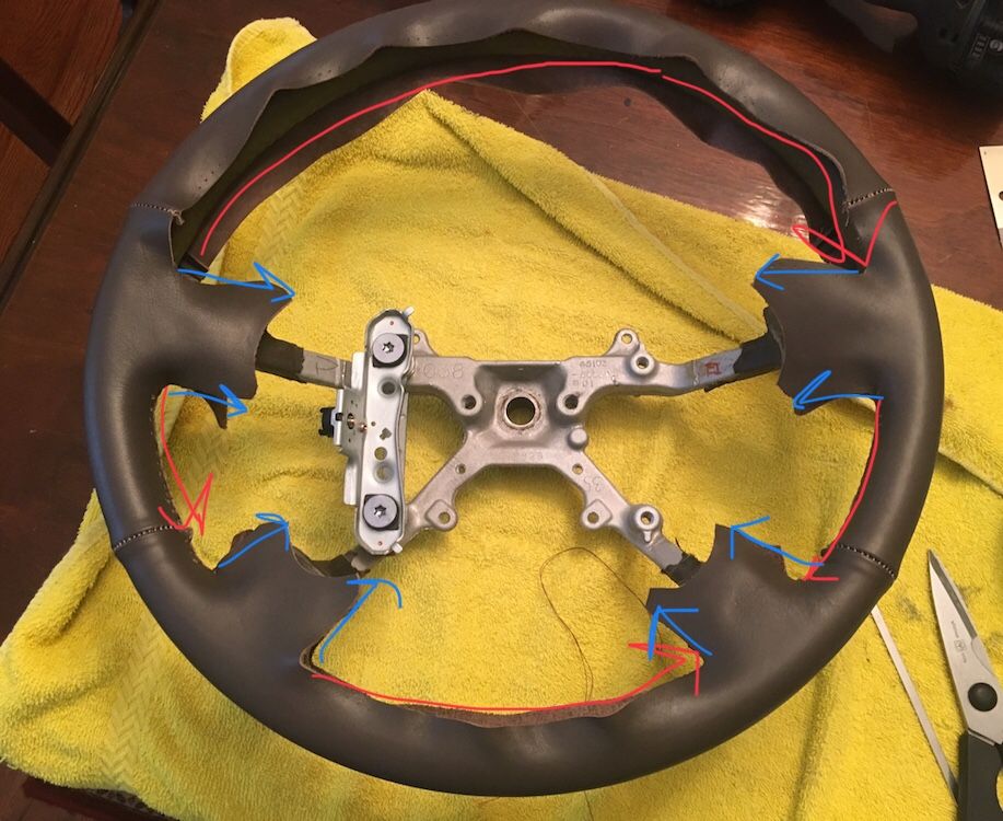

Here’s a quick rundown of how to do it. Do the seams along the red arrows first. Start at the outside of the lower spoke and work across the wheel to the lower outside of the next spoke. Do this until the entire main seam is done. Then stitch along the blue arrows stitching toward the center of the wheel. Use a bit of adhesive on the spokes before laying the leather down. If for some reason you have a bit too much leather in a place and it is bunching up at the seams, you can carefully trim the excess with an exacto knife before stitching it the rest is of the way.
If for some reason the leather is too tight and short in an area, you can soak the section in warm water and the leather will swell. You will have about 4 hours of work time until the leather shrinks again.
Remember to work slow, and check your work often. Ensure the leather is not bunching up, if it is, you can stretch it, and manipulate it by how you sew the seam.
There are several videos on YouTube showing various methods.
