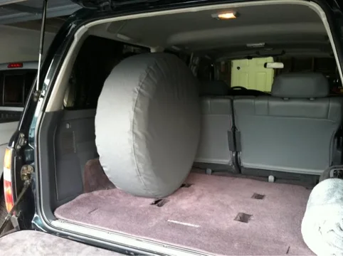

You can fit a lot of stuff in the back of an 80 if you properly pack it.
Tire and all. :grinpimp:
Heck, I fit 4 37's and a 35 back there no problem....

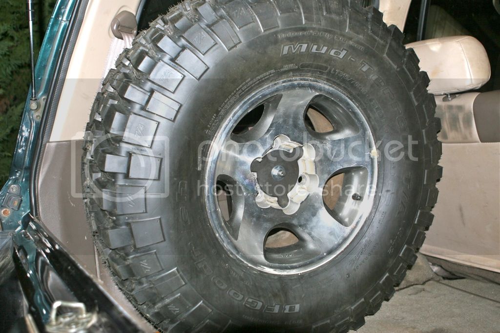

I have been thinking about this as well. I have since been storing my spare upright in the cargo area with ratchet straps and the 3rd row seat bracket similar to alot of other folks. It is actually kind of a pain to get right and I would like a more solid solution. I have always wanted to do a homemade carrier and had planned on using the 3rd row seat bracket as ebag did above. My solution looks like this: Drawn in paint since I don't have AC on my laptop. The black is the existing bracket and the tire, while the gray is the added tube and plate. No holes cut, no other support other than the 3rd row bracket.
Here's one I made and used when I had 35's. Very similar in design to yours. Used all existing mounting points.

Hey Derrick, I think I have your old spare mount. I always liked your design, and was going to try & duplicate it, so I lucked out when it came up forsale (again). Great design, I made 1 change & added a gusset just in front of the tube at the floor plate.

That is nice. We are on the same wavelength but you found a way to make it much cleaner than mine would have been. Well done. An interior carrier will definitely be on my project list over the winter. Lots of great ideas here.

I am glad you pick it up. I noticed that Cruiseruf had placed it in the classified section when he moved up to 37s. This is not my design BTW. Someone on here posted a magazine article called "The Comfy Cruiser" which had the idea. I liked it and just copied.
