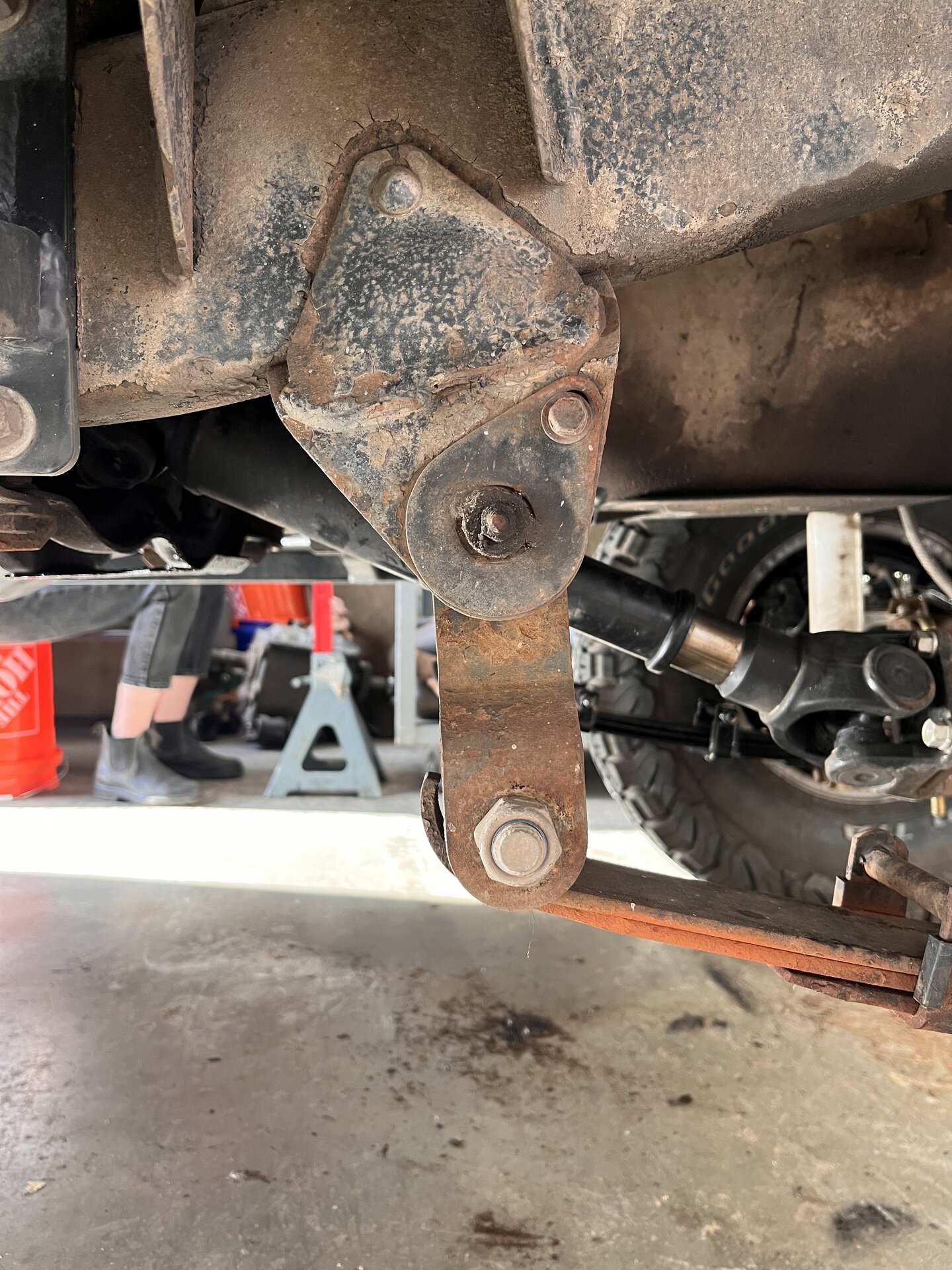

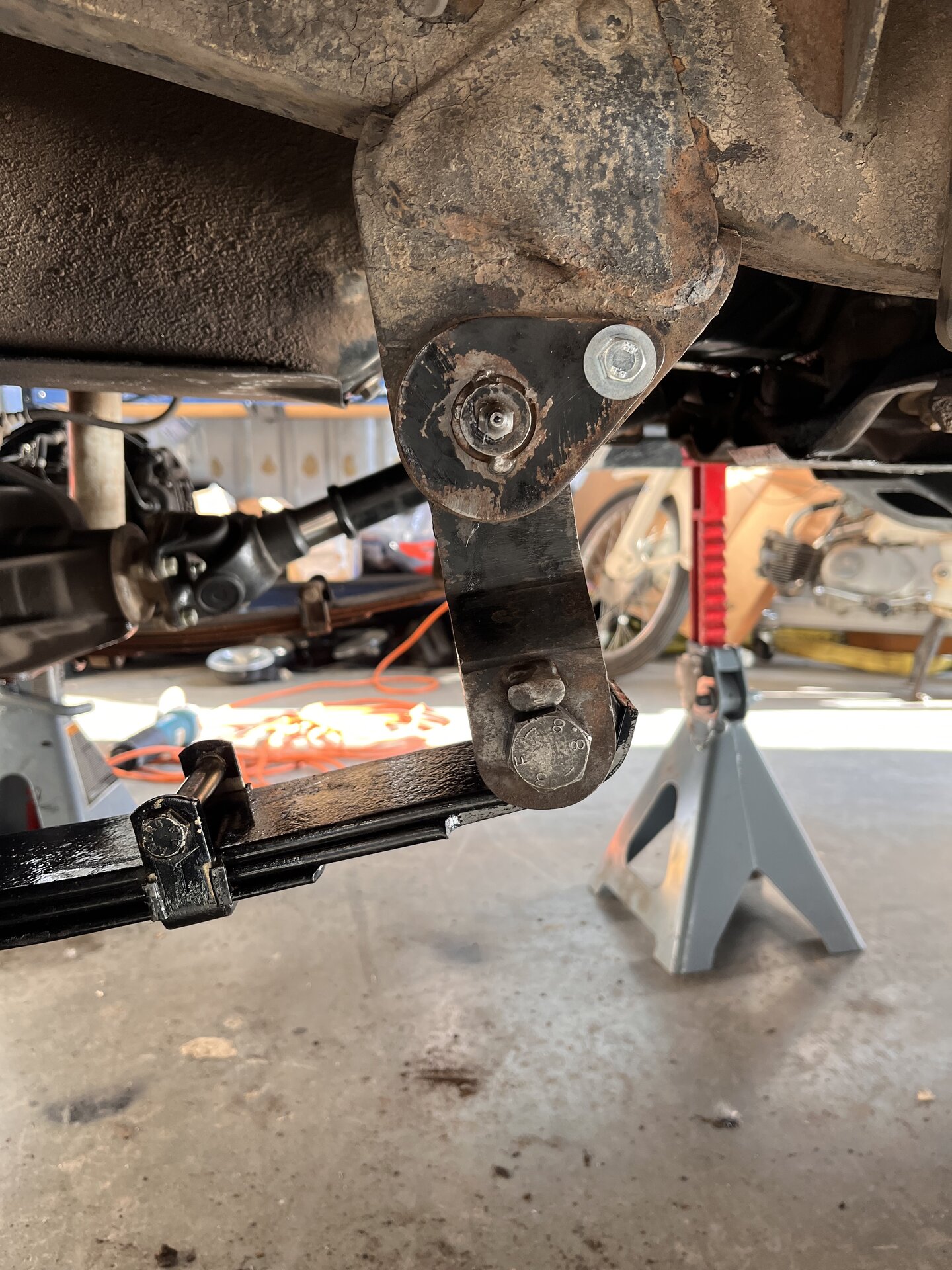

Well I finally did it. Dobinsons HZJ75 front springs are the same dimensions as 60 Series springs but about 1.5” longer. The fixed end to center pin distance is the same so the axle stays in the same spot. The leaf packs had 7 springs and I removed two. Depending on how it settles I may remove another. The shackle angle is much improved. In the photos below note the front driveshaft so you can orient the front direction.
Before:
After:
The ride is much improved even with fresh springs and old shocks. Thanks to @lcwizard and Timelapse on IG for letting me bounce ideas off them.
For future SR folks: the HZJ75 springs are a great choice.
