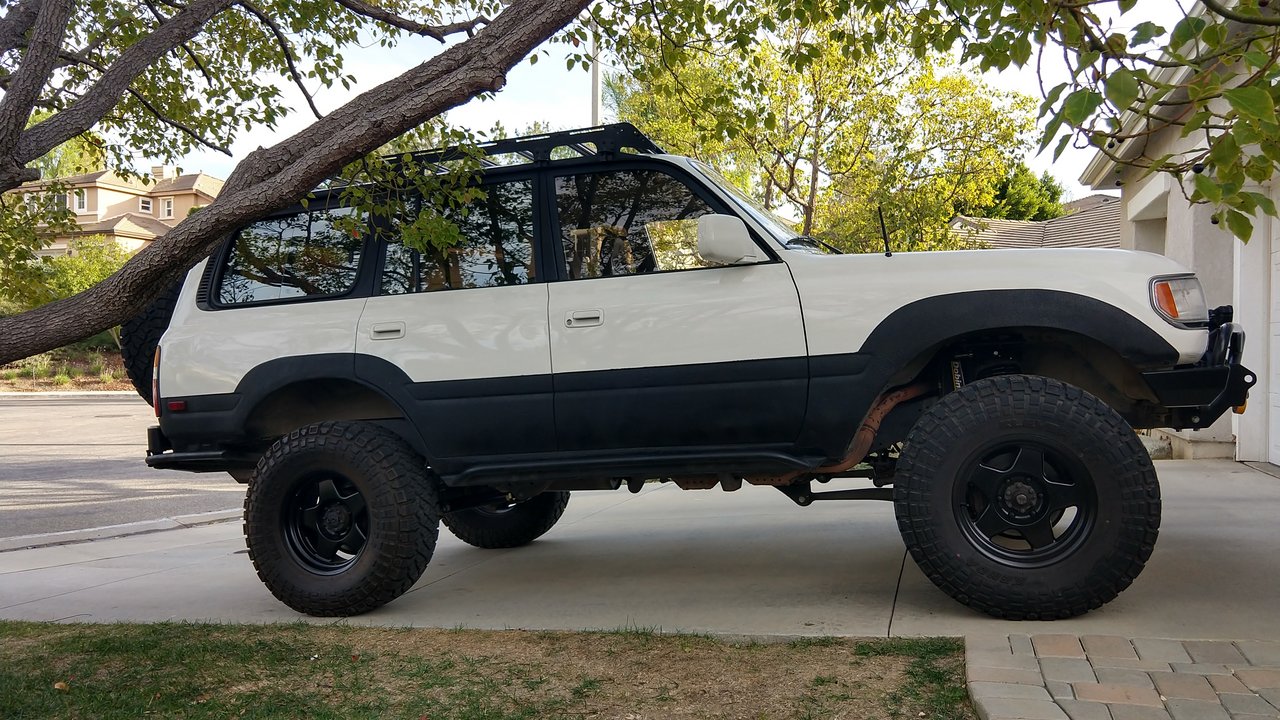

My hub to fender measurement is 26.625".What are your hub to fender measurements? 5" from old stock suspension maybe but not a true 5" of lift when measured properly I'm sure
6.5" of lift? Seems way out of whack compared to everyone else!! Are the stock flares still on it, and does it have a body lift?My hub to fender measurement is 26.625".

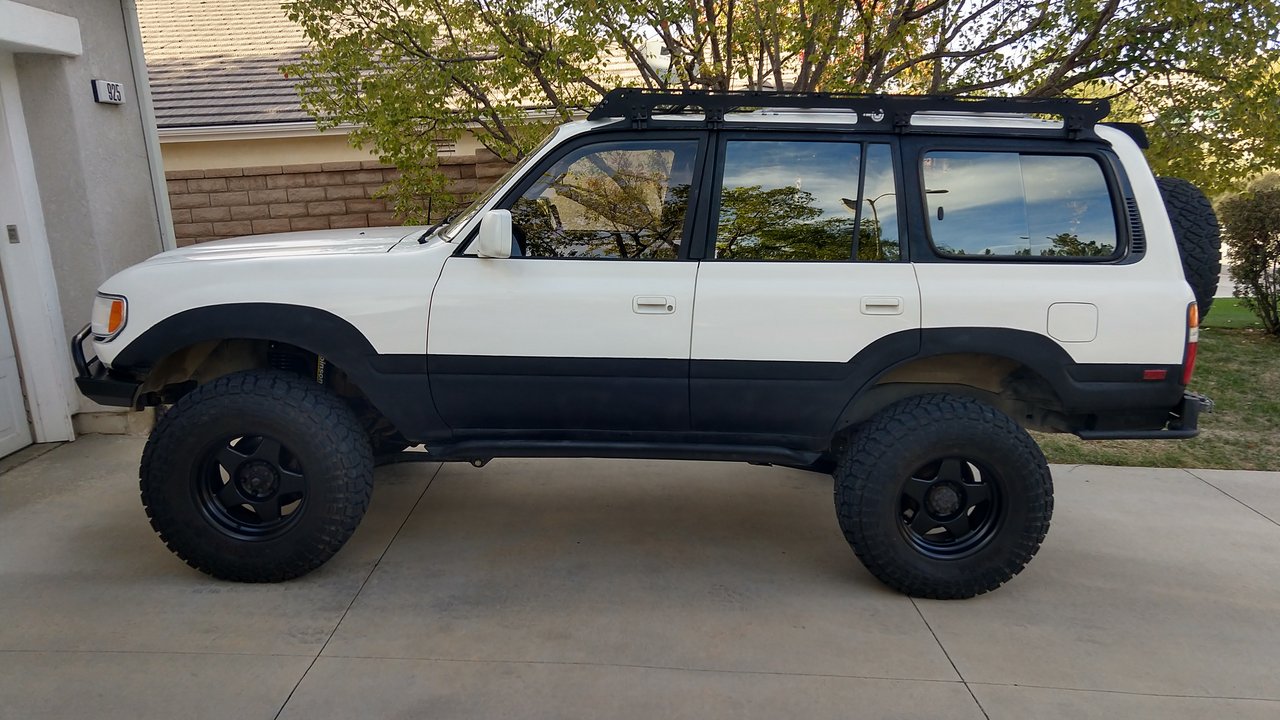

Thanks for that. That was a consistent height those coils were giving before they had the design change last year.I‘ve had 24” center of hub to bottom of flare for 3 years now. No change in height. It is the 144vt 3.5” coil. Running bumper, lights, winch. View attachment 3017608View attachment 3017614
And what's the new average height?Thanks for that. That was a consistent height those coils were giving before they had the design change last year.
It's all extremely dependent on how much weight is added, but about 1" taller than Dobinsons list the coils. 3.5 is actually more like 4.5", so 24.5" hub to fender as an example up front.And what's the new average height?
That was my result as well.It's all extremely dependent on how much weight is added, but about 1" taller than Dobinsons list the coils. 3.5 is actually more like 4.5", so 24.5" hub to fender as an example up front.
I just realized that I did not subtract for the 1" body lift. Even still I have a lift 2" over advertised spec with a heavy front end.6.5" of lift? Seems way out of whack compared to everyone else!! Are the stock flares still on it, and does it have a body lift?
