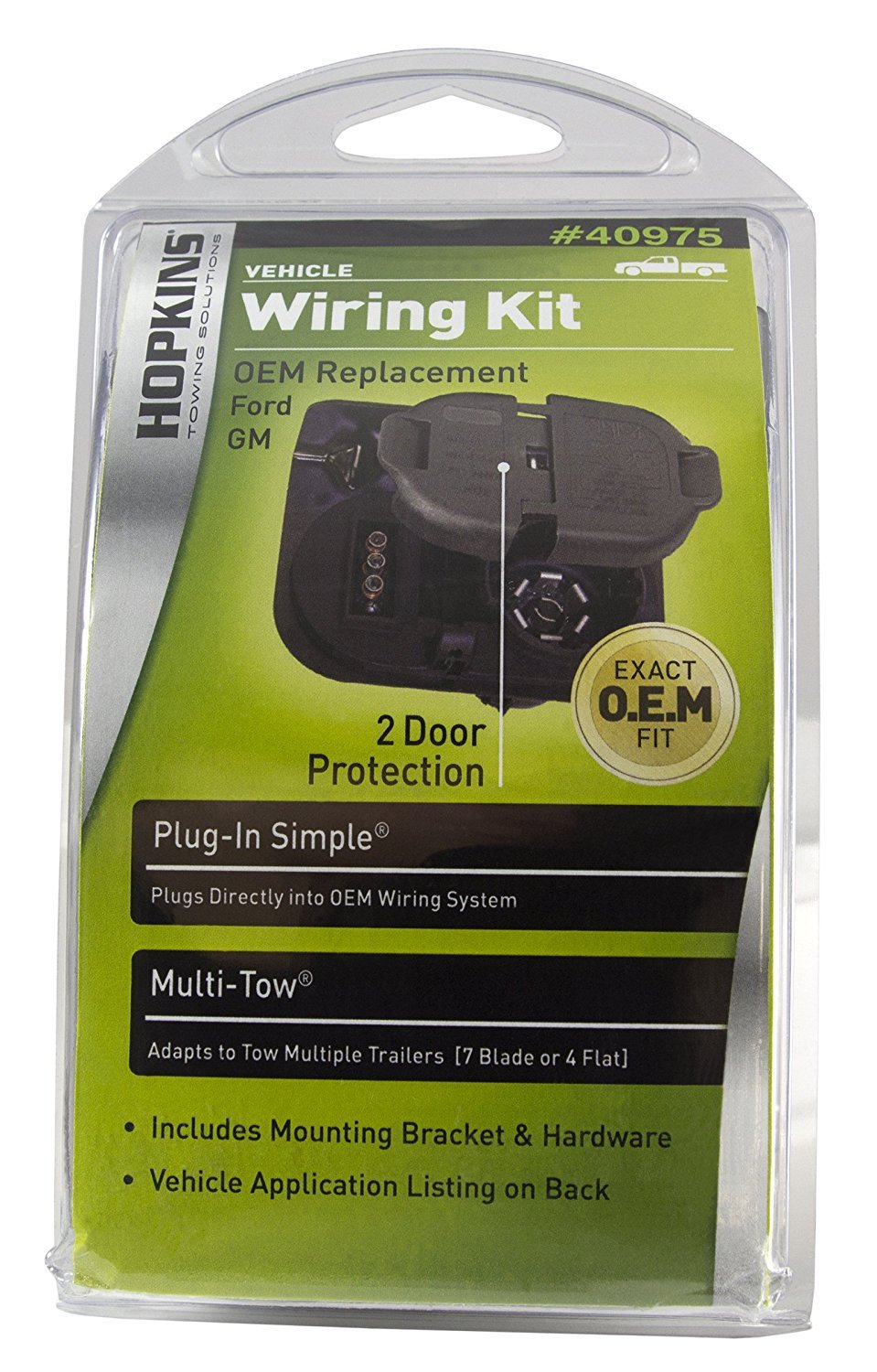

Any reason the 7pin trailer plug couldn't be switched for a Hopkin's 40975 Multi-tow unit? Obviously the mount hole would need to be modified to accommodate this style plug but might I recommend it instead of the one you're using? It's a much more OEM solution that's used on so many vehicles so it's pretty proven. Seems like the new bumper has a little more room for this too.
Link: https://www.amazon.com/dp/B001NYYREC/?tag=ihco-20
I would vote for what Ben has currently has chosen, as the 4 pin flat is not as universal as it once was. Many boat and other trailers have gone to disk brakes which require the backup light wire to disable surge brakes in order to backup. So they are using 5pin flat or larger connectors.
Adapter pigtails are cheap and going to be required in a lot of cases even if you have a 4 pin flat piggy backed on the connector.
The connector I referenced has both a 7 pin and a 4 pin so it's the best of both worlds and includes a reverse wire (blade atyle 7 pin are wired this way). As for disabling brakes while backing up, a good brake controller can accomplish this too. My Tekonsha Prodigy 3 has a brake lockout mode for reversing. I have the referenced plug on my 2015 Jeep Grand Cherokee and I got one for my Land Cruiser too. ItsI what's used on the newer Toyota Tundra and Tacoma with tow packages too.
... As for disabling brakes while backing up, a good brake controller can accomplish this too. My Tekonsha Prodigy 3 has a brake lockout mode for reversing. I have the referenced plug on my 2015 Jeep Grand Cherokee and I got one for my Land Cruiser too. ItsI what's used on the newer Toyota Tundra and Tacoma with tow packages too.
You are mistaken on the brakes, boat trailers and others with disk brakes have surge brakes, not electric brakes so there is no controller. Most all of these have moved to 5 pin flat connectors, to pass the backup wire to cutoff valve on the surge brakes. So you would need a 7 pin to 5 pin adapter. Once you get past small utility trailers, to boat, horse, travel trailers you need a 7 pin to something (other than 4 pin) adapter.
So we are needing adapters in many cases, so lets look at total cost to support 4 pin flat.
Your suggested connector with a 4 pin flat costs about $20, the 7 pin only connector cost $5. For $8 you can get a 7 to 4 flat adapter.
@Skidoo I see where you are coming from on the adaptors. Surge brakes suck but they have a place on boat trailers since electric brakes could short under water when loading the boat in or out of the water...Almost any small U-haul or utility trailer is still a 4-pin and it's nicer to not need an adaptor.
Anyway, I'd still prefer a nicer, OEM style connector with no screw plate on a 2400 dollar bumper but I'll work directly with Ben on this request.
