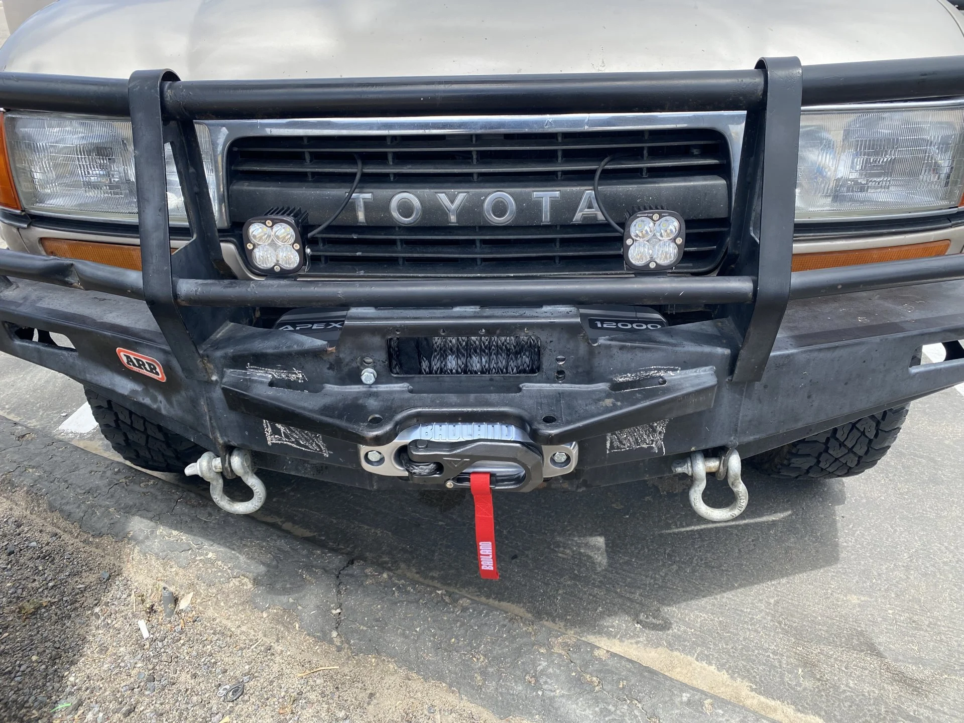

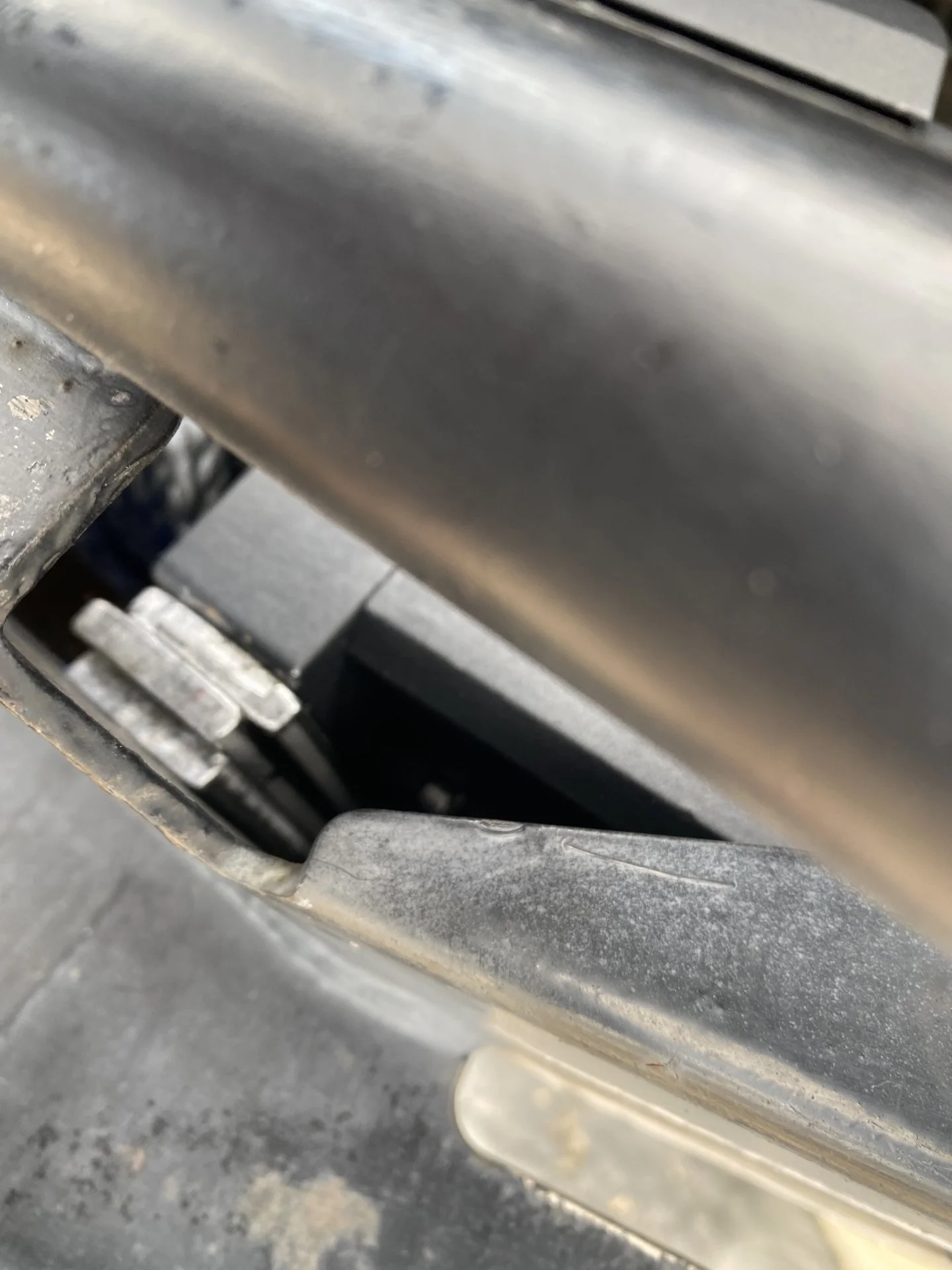

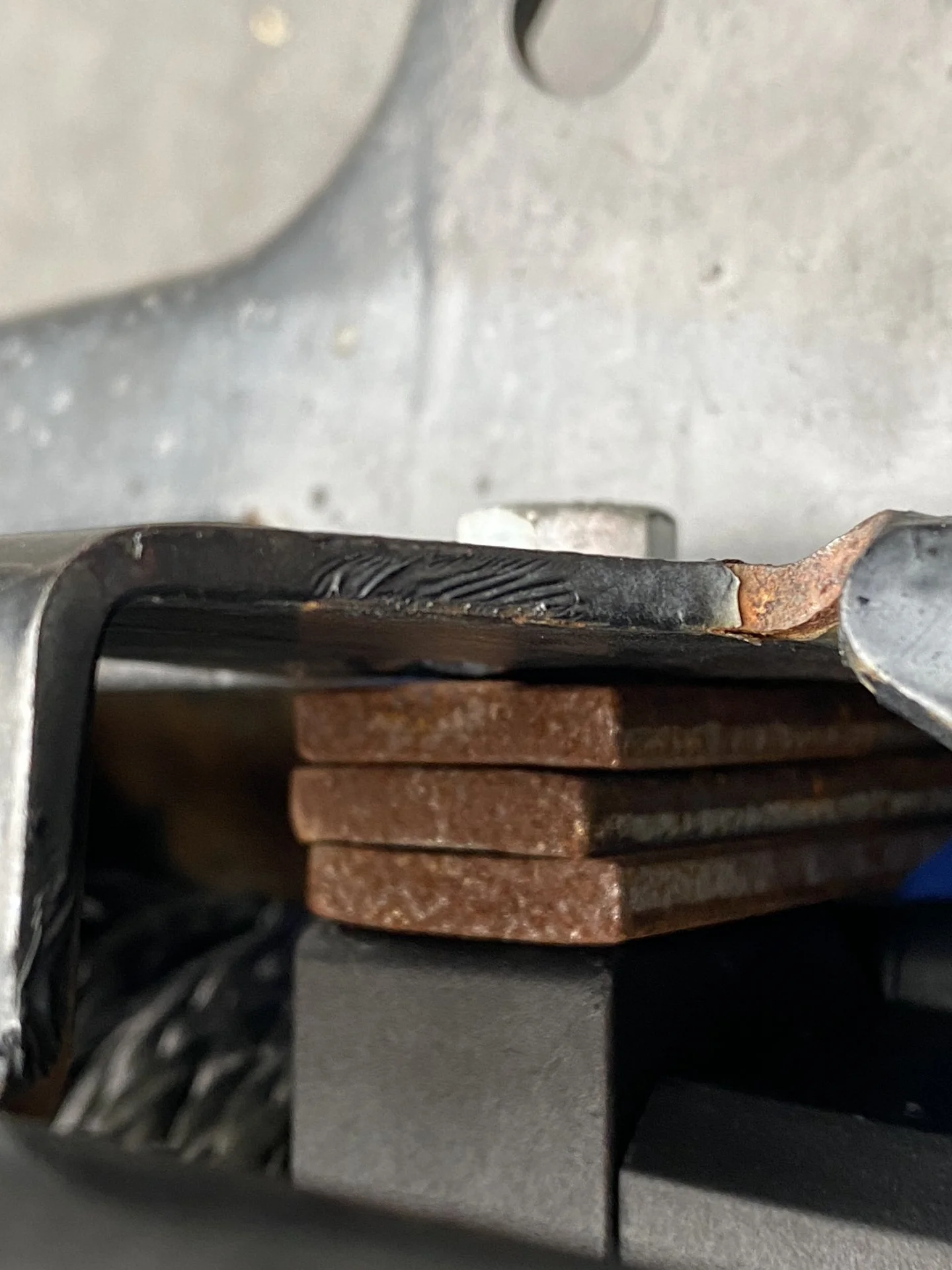

I bought this winch and installed it vertically in an ARB bull bar on a 91’ 80 series. So, far, I have only load wound it and have used it only once to test it on an uphill pull, but was not stuck. I did have to make some shims so it would fit. ARB does sell a shim/ spacer kit, though.

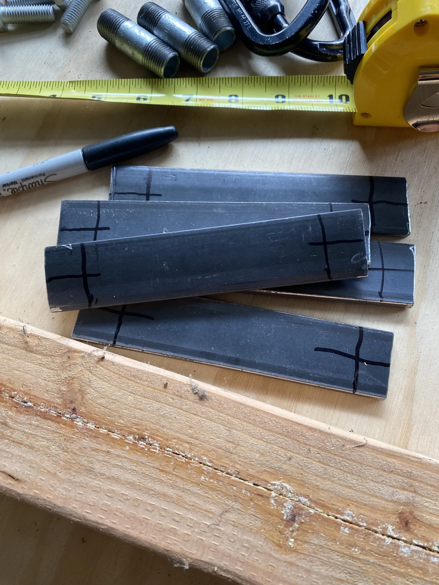

I bought this winch and installed it vertically in an ARB bull bar on a 91’ 80 series. So, far, I have only load wound it and have used it only once to test it on an uphill pull, but was not stuck. I did have to make some shims so it would fit. ARB does sell a shim/ spacer kit, though.View attachment 2681569View attachment 2681571View attachment 2681572

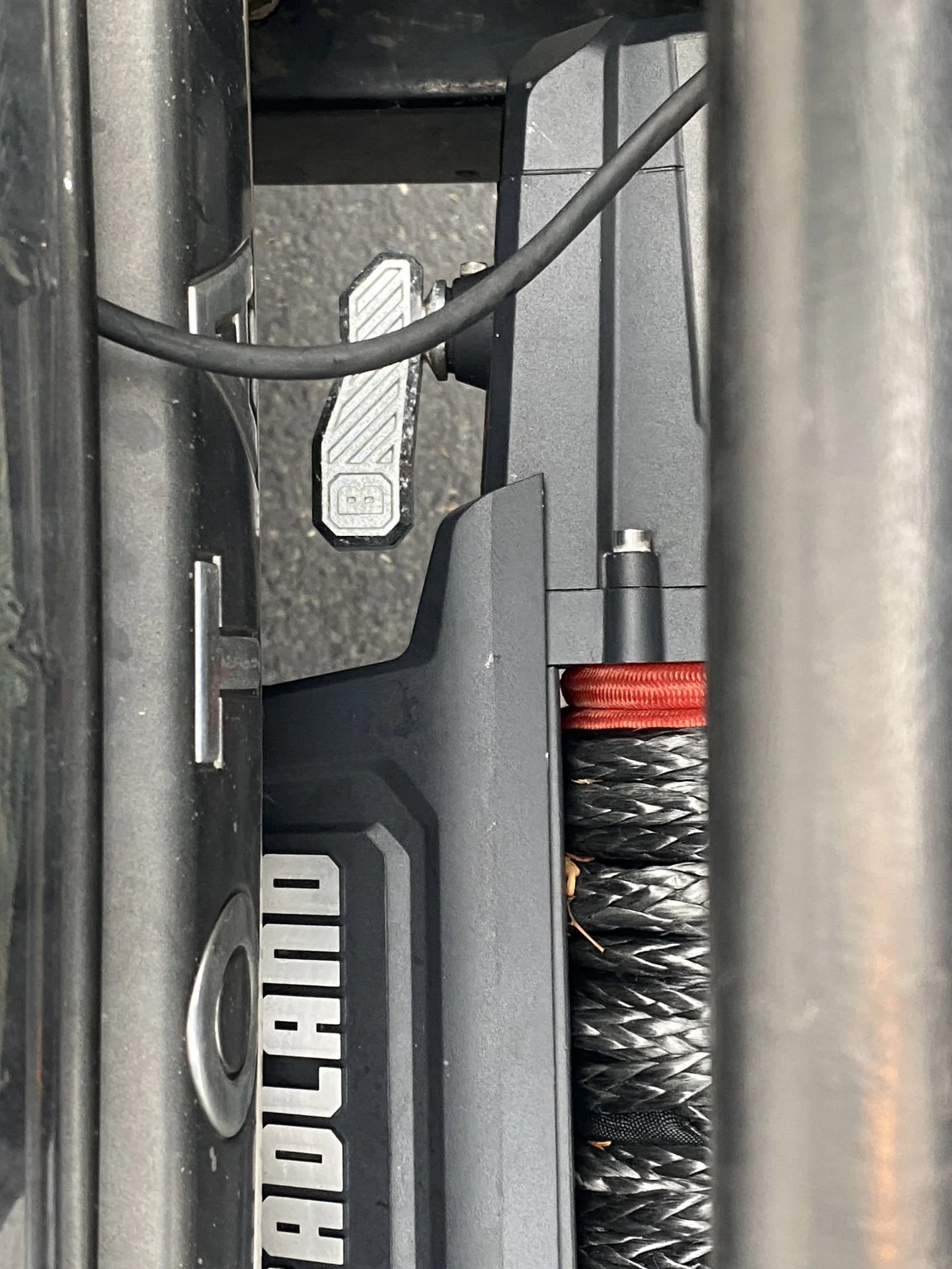

Can you post of pic of where your clutch lever is? Can you get to it easily? Also how thick is the spacer you used to fit it in the arb?

The clutch lever is very easy to access. ARB makes spacers, but i made a set of six from 1/4 inch steel. I’ve used the winch a half dozen times; wired and wireless; no issues yet.

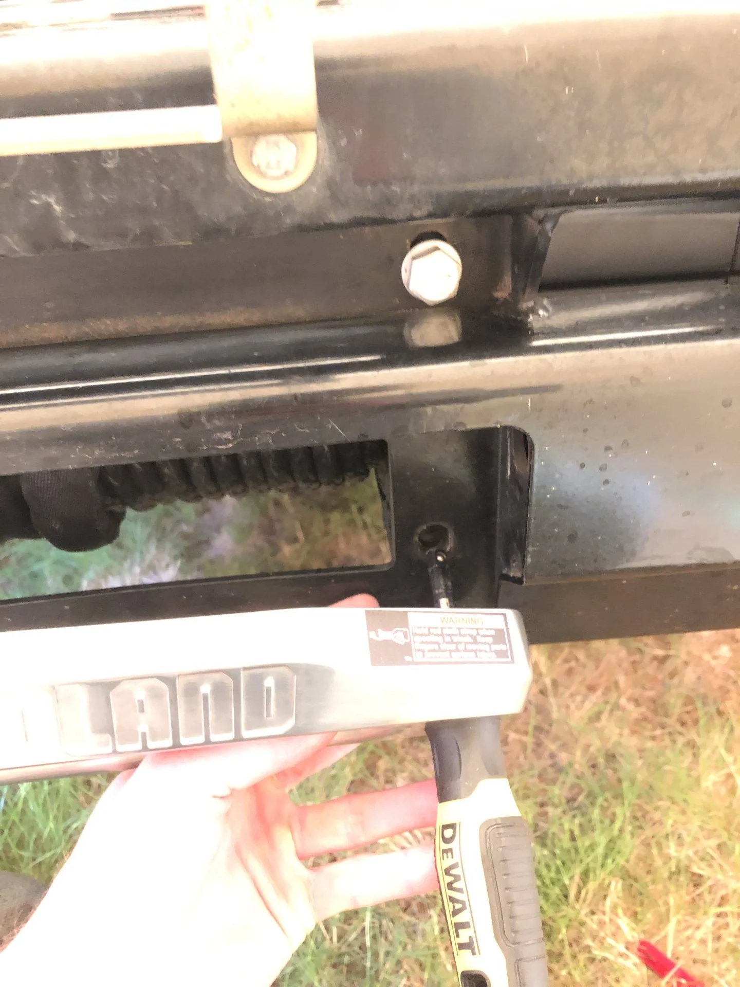

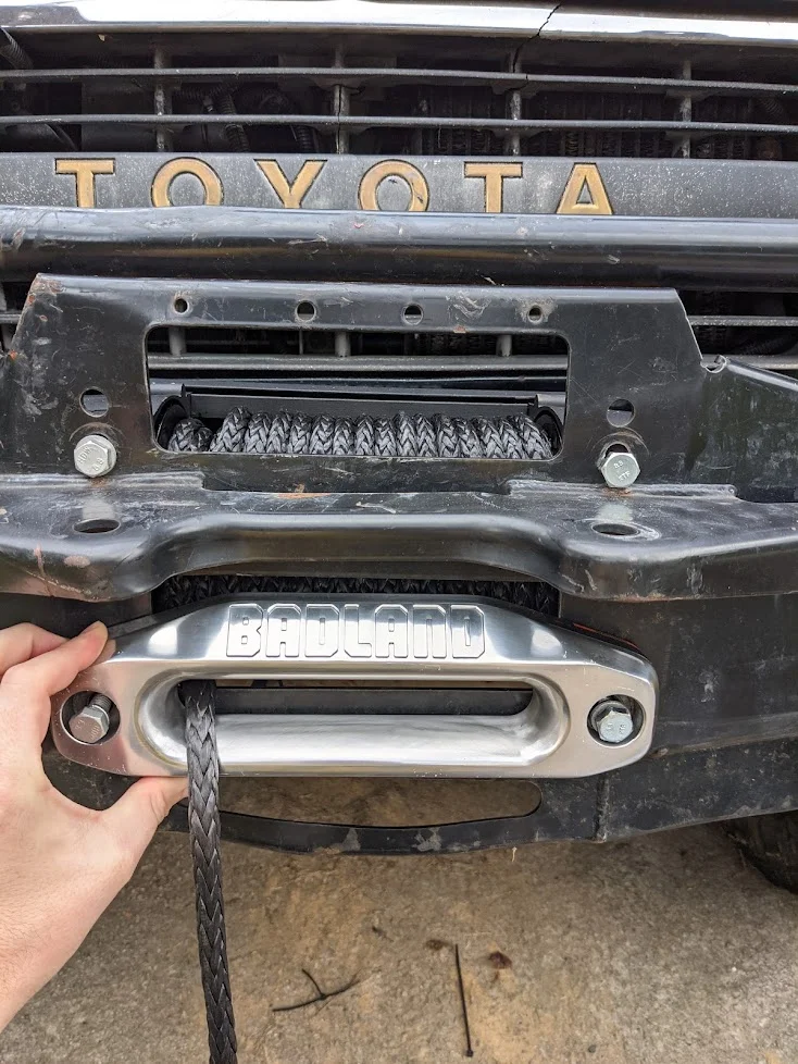

So I ended up picking one of these winches up for 275$ off a classified ad new in box. But I have a FJ62 new style ARB and I don’t have the separate holes or space for the fairlead bolts. Can I just run a bolt through the fairlead directly to the feet of the winch and be OK? (In the pic the screwdriver is simulating the bolt running through the fairlead, then through the bumper, then to the bottom foot of the winch). I would assume so but I am not 100% sure. Any help would be appreciated! I don’t really want to drill a separate hole for the fairlead and space the winch out so I can bolt on the fairlead. Make sense? Thanks!!

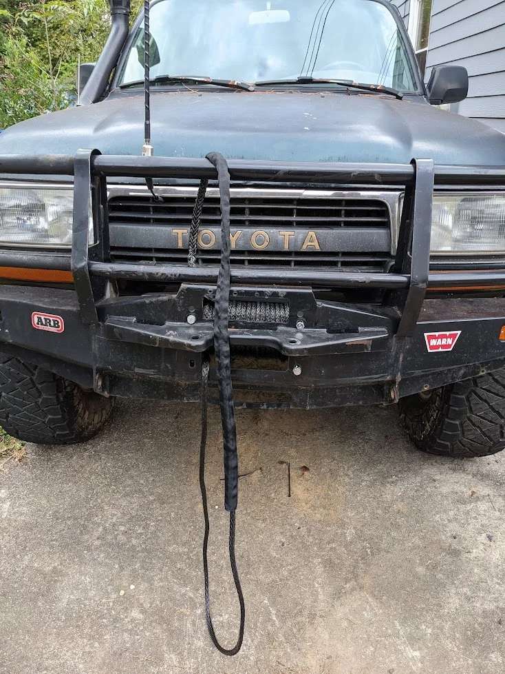

I’m running the winch feet to the front 👍🏼
I ran my winch bolts through the fairlead but had to buy longer bolts. The rule is there should be as many bolt threads in the foot (that square nut) to equal the diameter of the bolt.
Finally added this winch onto my rig... Hooked it up and relocated the control box behind the back of my bumper with a zip tie and some silicone . Re-wrapped the winch under tension with the FJ80 in the background looking neglected haha. Came with super high-quality parts and I had to grind the sides of the fairlead about a 16th on each side to fit into the ARB fairlead spot... I also had to trim the bottom bumper fairlead lip where the fairlead sits because the lip was higher than the fairlead and it was starting to do damage to my rope so I trimmed that and it's perfect! I bought a few recovery straps and tree savers and I'm ready to go. Still need to pick up a snatch block, a couple of shackles, and some front tow points from trail tailor but that's it...

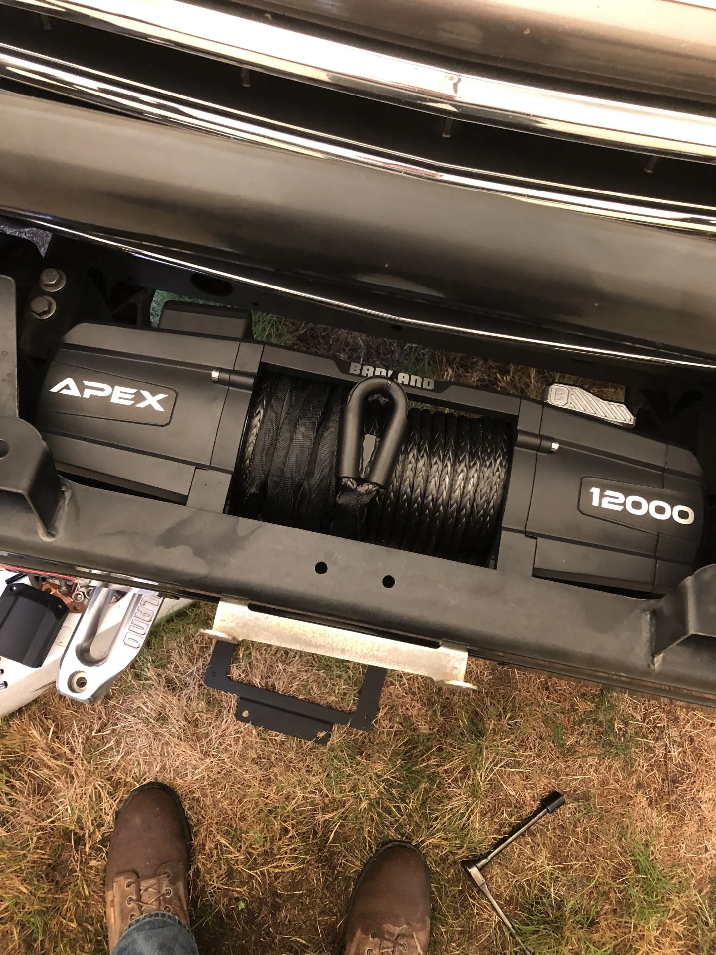

How long did you go with the screws from Fairlead into winch ?
I got some 40MM from Napa , but that was before I realized that I was going to have to use the same holes in bumper for winch mount and fairlead.
Also what are you using on the back end , in the winch same nuts provided by Harbor Freight?
Also did you remove this part from the truck?( Sub assembly front end) , on my 8o the attachment in middle of front end I broke screw trying to get it out , so I just bent it up , but is still resting on the top of the winch.
