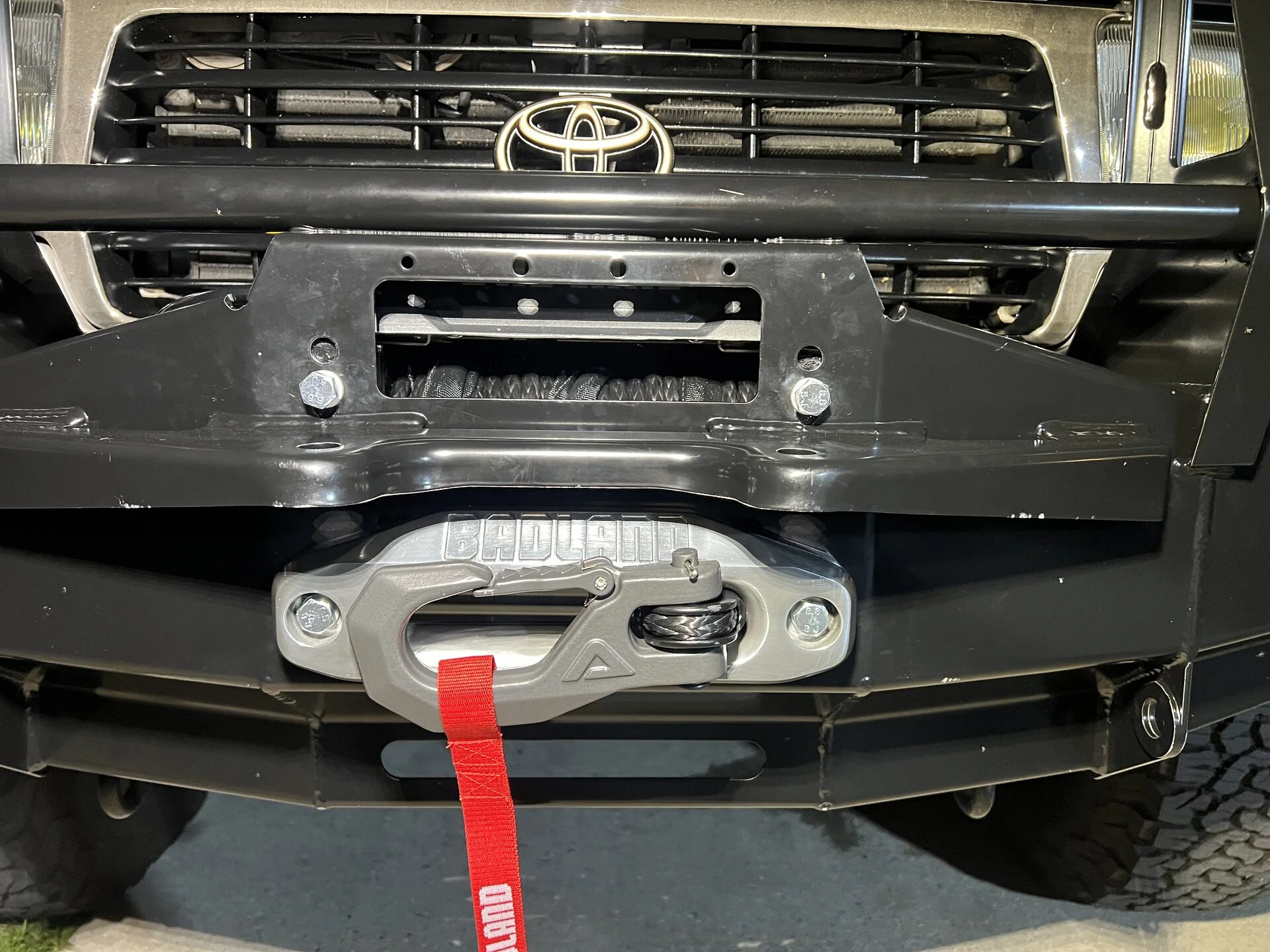

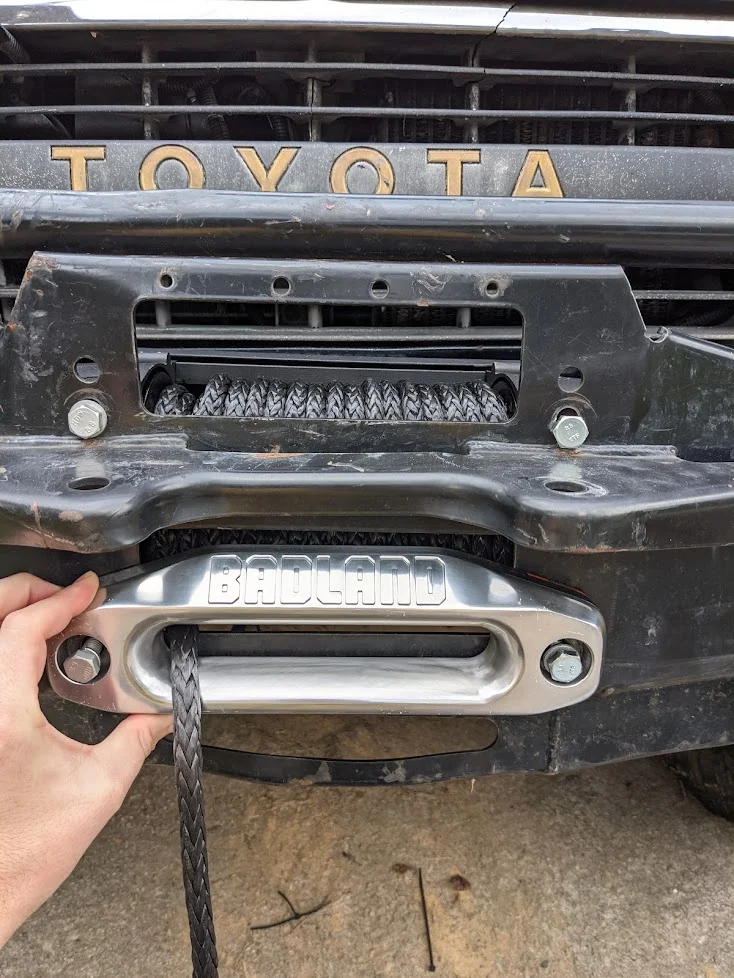

The advantage is that its the correct fairlead for a foot forward mount.

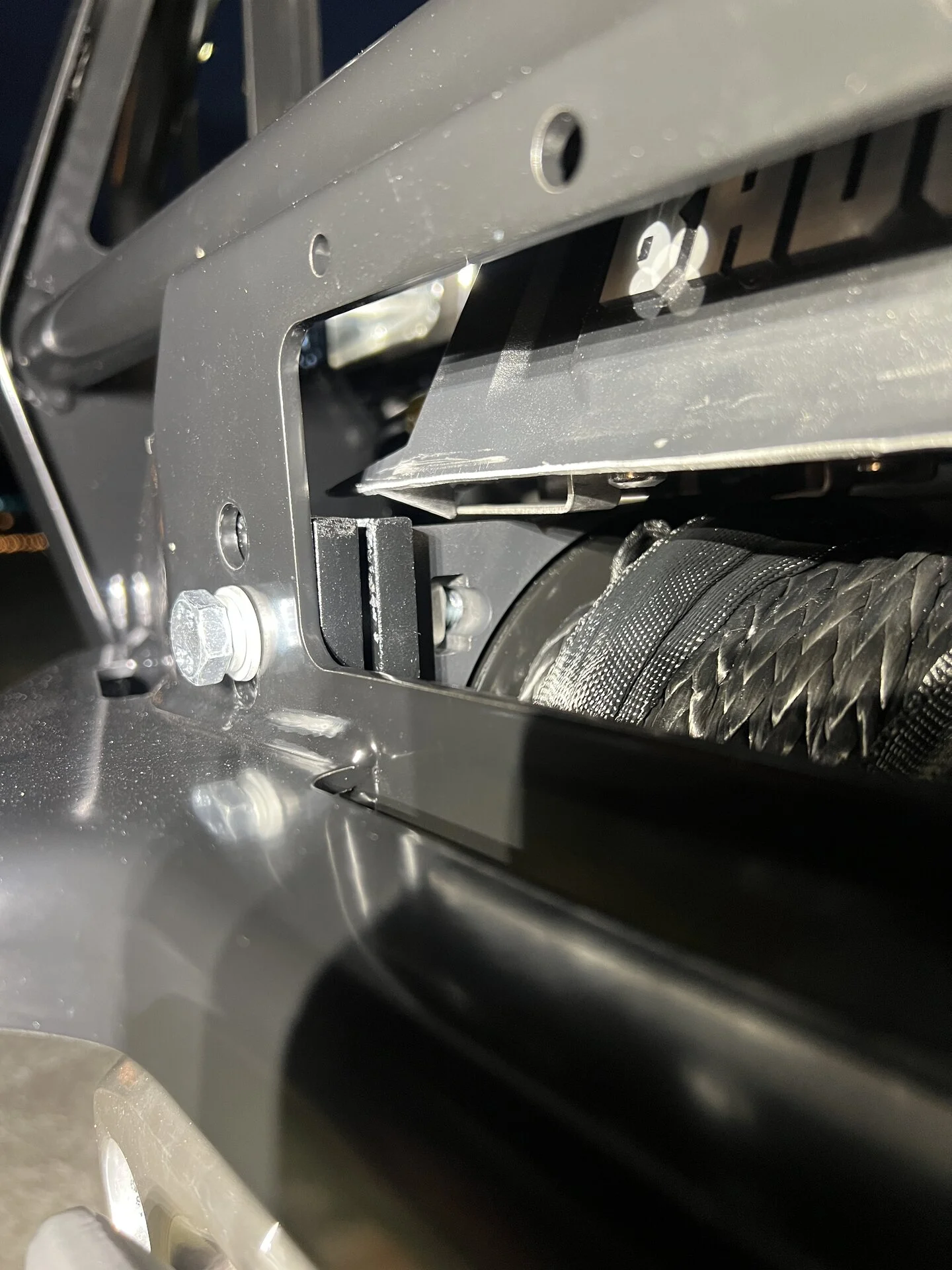

Notice these pics and how the stock hawse doesn't line up with the opening property.
What's the advantage of this?

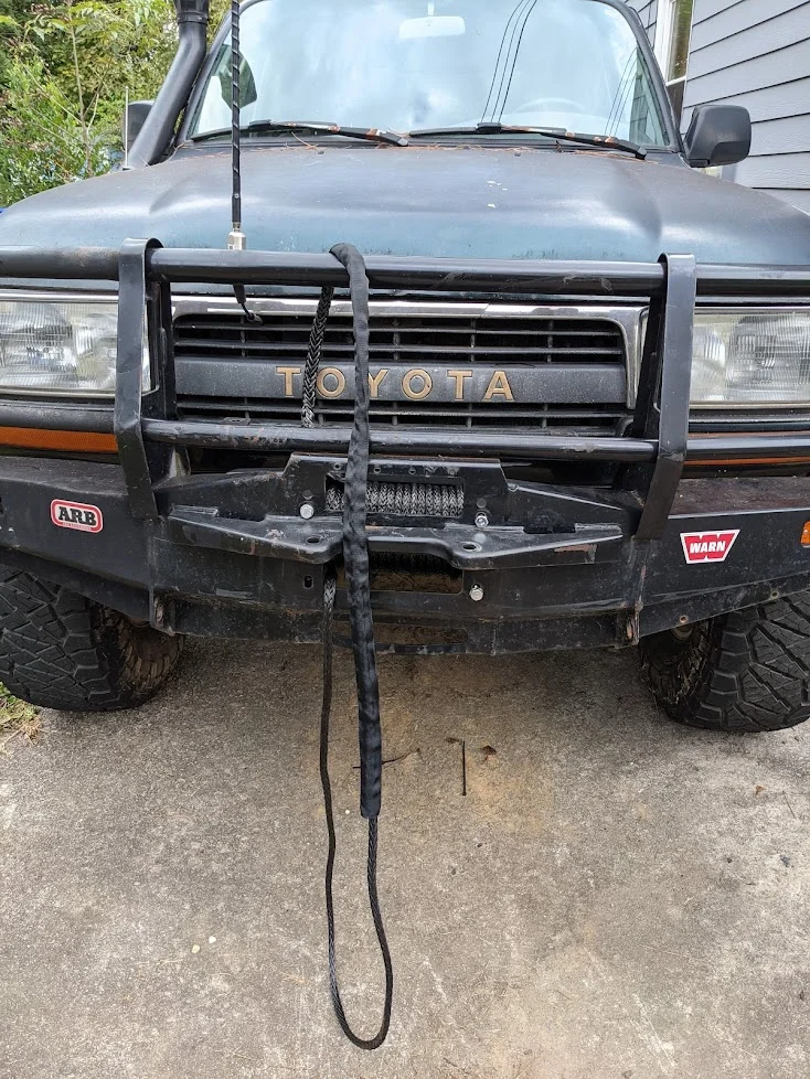

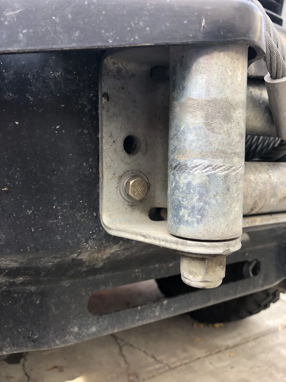

Seeing that 1st pic made me look at my roller fairlead mount. I don't remember if the Warn fairlead came with the offset holes, or I had to drill them myself. You don't have that choice with the Hawse, but may be it's just a smaller opening in the ARB that messes up the alignment.
Pic of my ARB mount for ref:

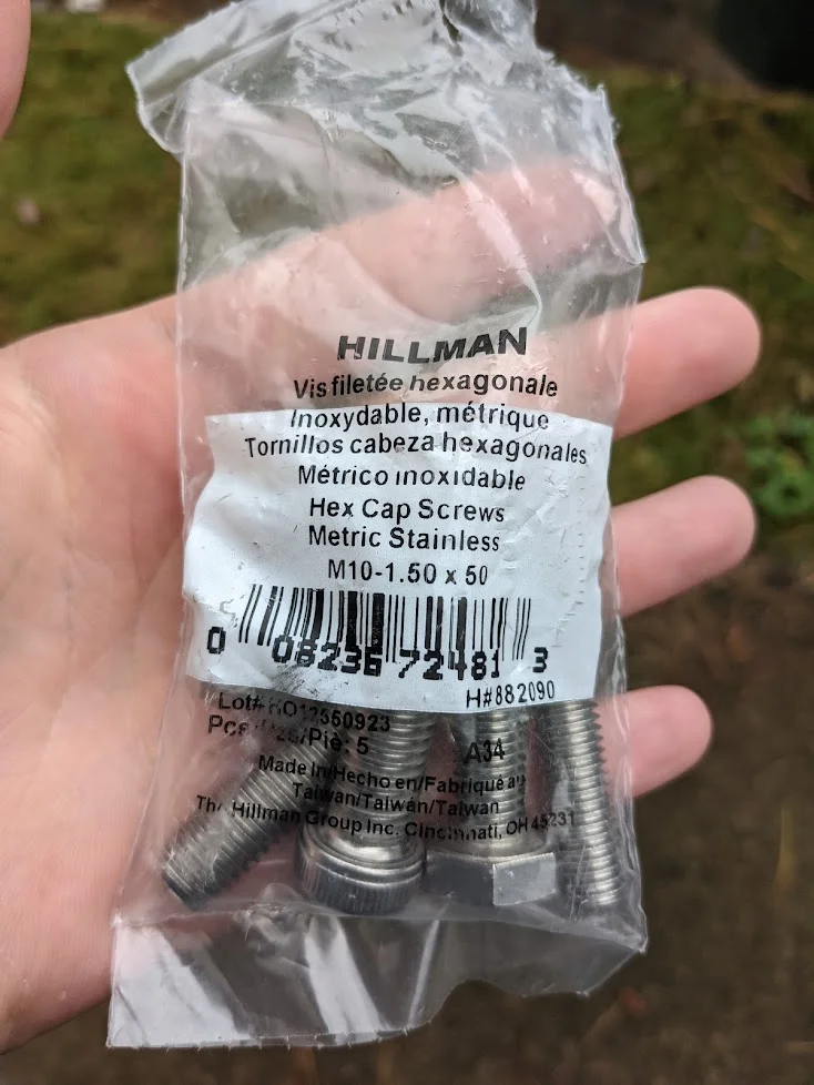

I used the square nuts that came with the winch, i did not need to remove a sub frame, and I’m sorry, i don’t recall the length of the bolts, i believe their were M10 2.25. Take the bolts with you and add the difference and buy a couple different lengths of the same bolt. Fit them in the parking lot and swap as necessary. I bought them from Home Depot.
All good , thanks for the reply , i got a 6 pack at Lowes , they are stainless steel which isn't as strong as the 8.8 hardened bolts. but 6 for 8$ pretty good. I am using these on the bottom where ill put the fairlead ( offset factor 55 ) great look there @gnob , on top i have 40 MM 8.8 bolts from Napa .

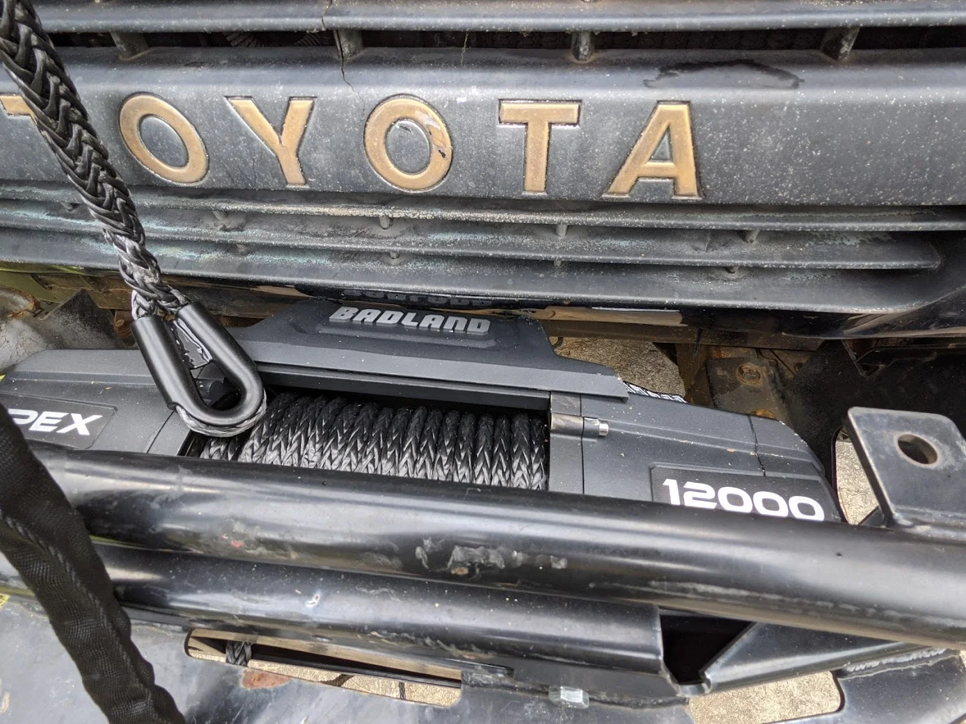

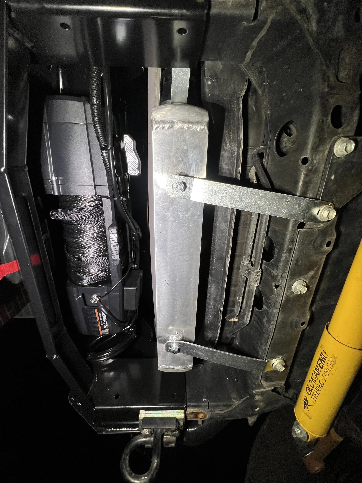

Wanted to post what I did to fit my Badland Apex 12k winch on my ARB bumper. I didn't read much of this thread bc it's 13 pages so someone might have had the same idea for the winch controller. I have a 96 HDJ81 (RHD DIesel) with a front mount intercooler. Used two 3/8" thick x 2" wide bars as spacers with 2 washers to make the winch not touch. Not happy about adding the washers but wanted a little wiggle room if the bummer flexed. All the bolt holes and fairlead matched up and fit without any issues. Needed longer M10x1.5 bolts, think it was 55/60mm for the top and 70mm for the bottom? For the winch controller, I cut the bottom of the housing and moved it back a little to clear then drilled and tapped two holes on the winch to mount it. The cuts aren't too pretty but it works. I think it might have fit in between the winch and intercooler but I never tried.
