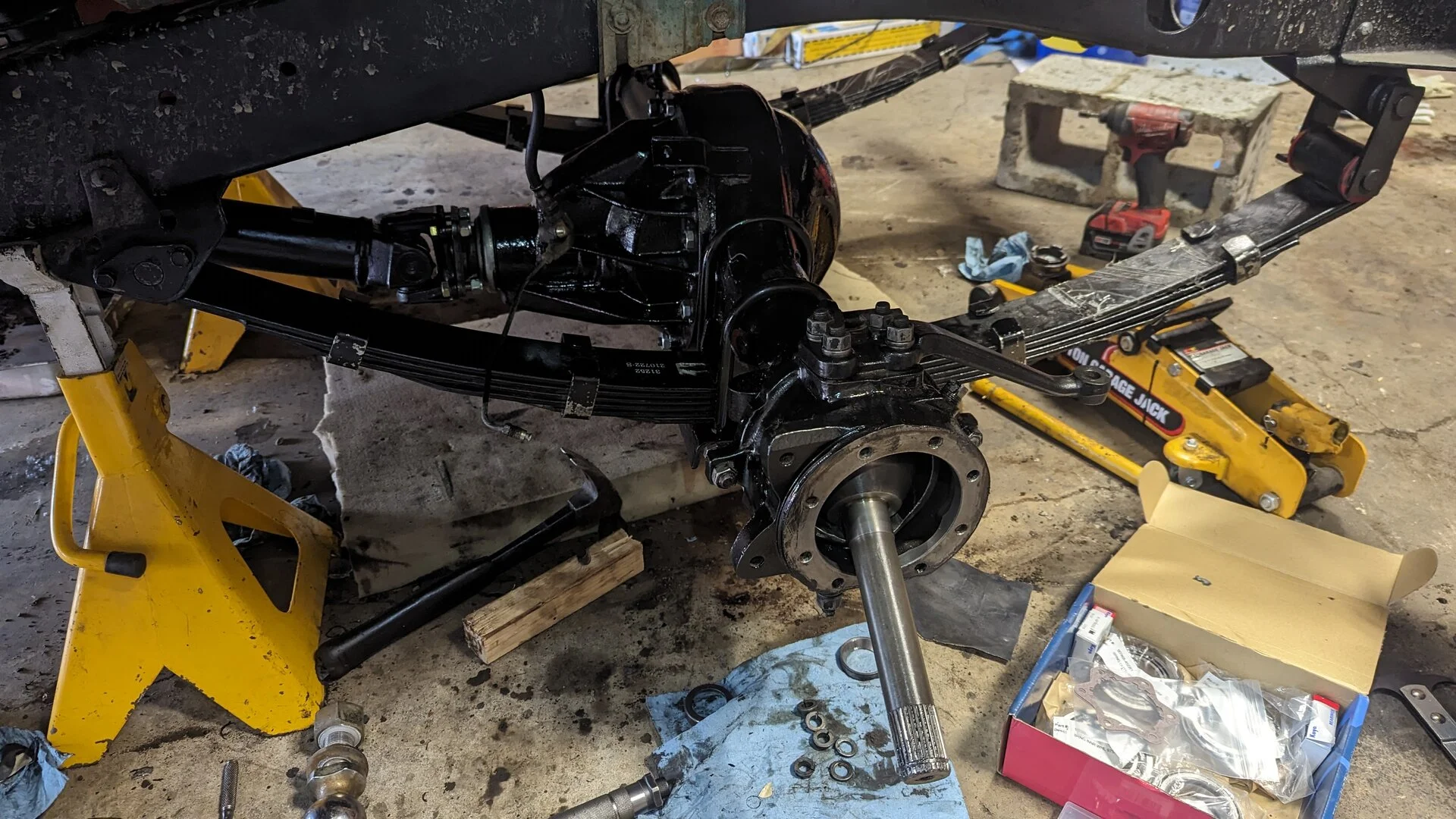

My 40 is missing two and they are M11 1.25 pitch and not available anywhere it seems. If anybody had an extra set rolling around and would be open to helping out I'd appreciate it.
The picture shows the studs that need nuts. I'm missing two for the opposite side of my 40.

The painted, sealed and rebuilt front axle all shiny and new looking.
The rebuilt knuckles and associated steering linkages.

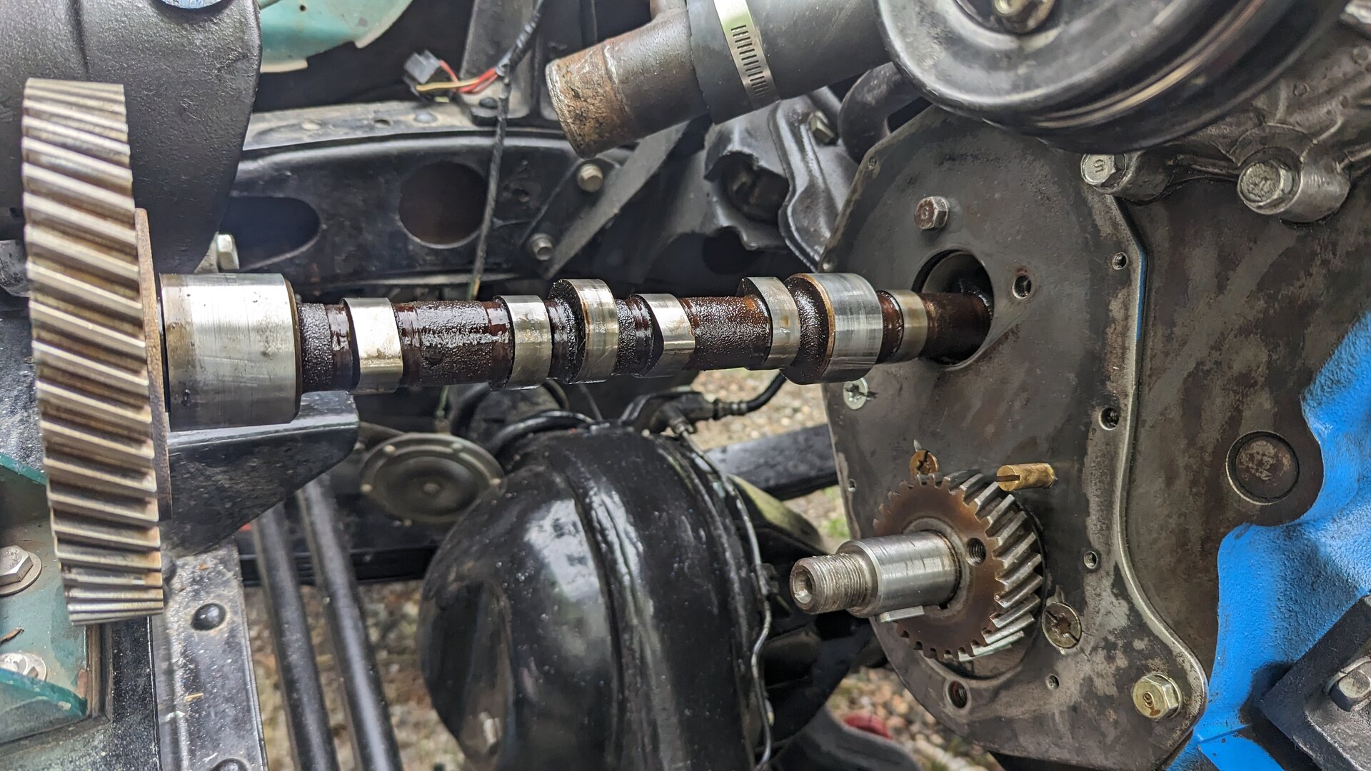

I pulled the camshaft gear off instead of pulling the camshaft out and am planning on heating the gear in the oven and reinstalling per a few threads here on MUD. Hoping it'll be easier/less invasive than pulling the camshaft, valve train, lifters, dissy...

Put the camshaft thrust plate back on and after heating the cam gear for 25 mins at 295F I failed 3 times to put it back onto the camshaft. Ended up having to pull the air filter housing, valve cover, valve train, distributor, side cover, lifters, rods, fuel pump and the camshaft out. Quite the frustrating setback, but I got it all done and then back together in probably 5 hours and got to bed by midnight. Such I'd life I guess. Took it for a few drives the past couple of days and so far 0 leakage! So in the end, it was worth it.
