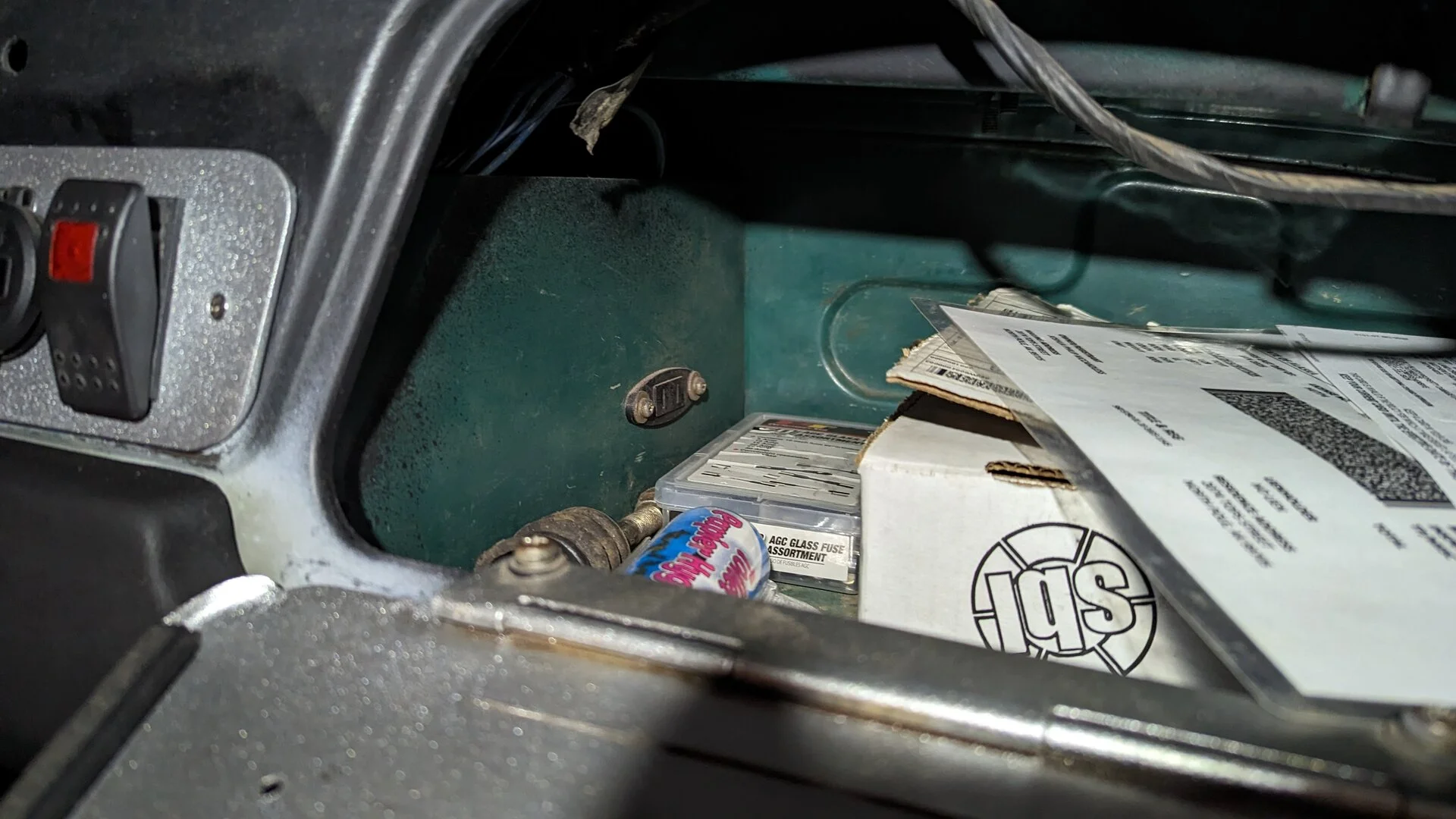

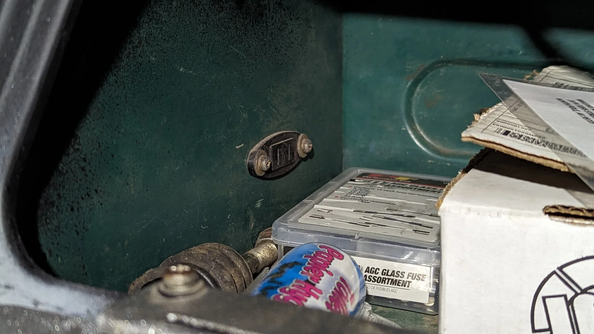

Can anybody tell me what this is?
It's inside the glove box compartment. Looks like an electrical plug of sorts and there is wiring run to it from the backside.
It’s a plug for the accessory light.
That is a sound deduction
Yep, should be getting power like your tail lights, headlights, lighter etc without the ignition being turned on.
I'm assuming it receives a constant 12V, but feel free to correct me if that assumption is wrong.

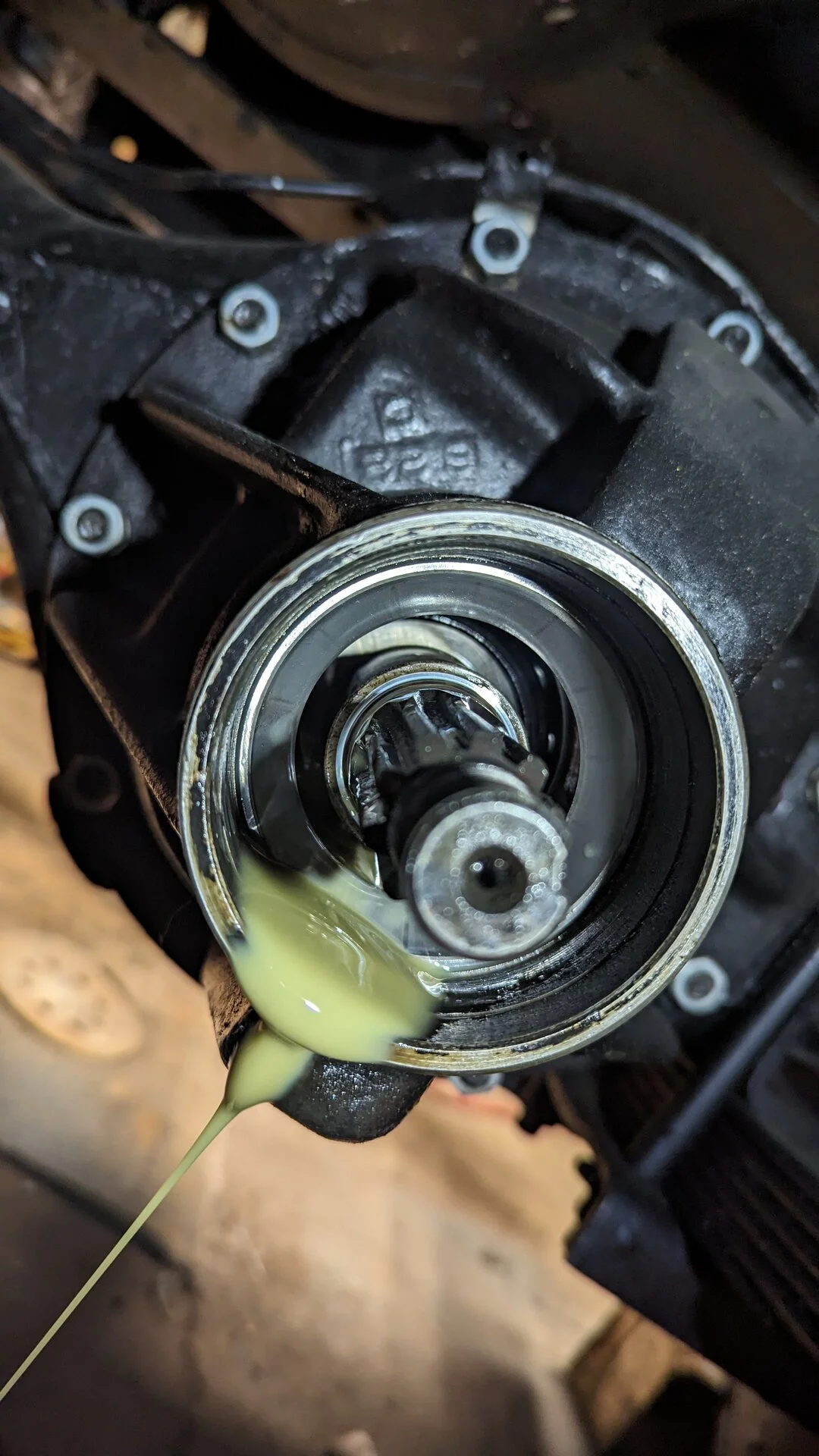

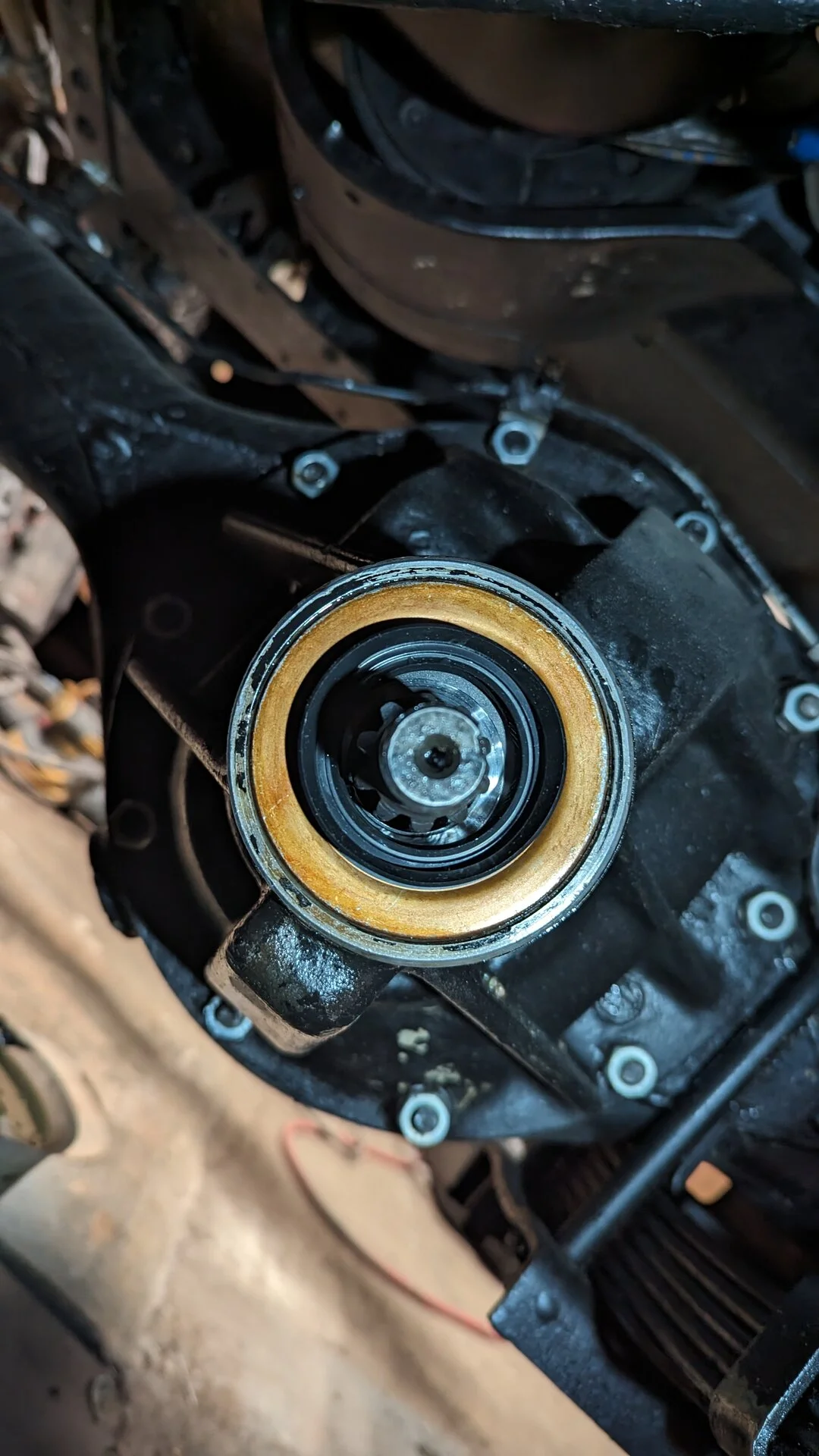

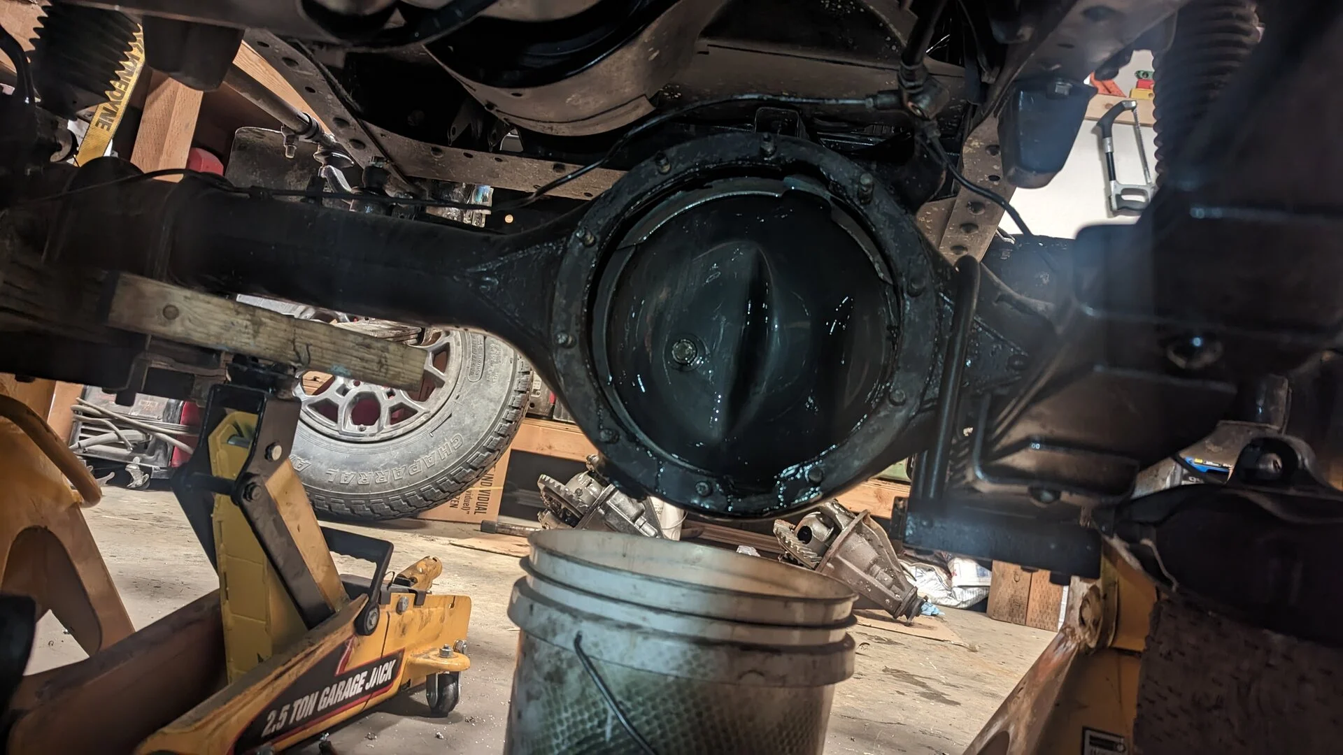

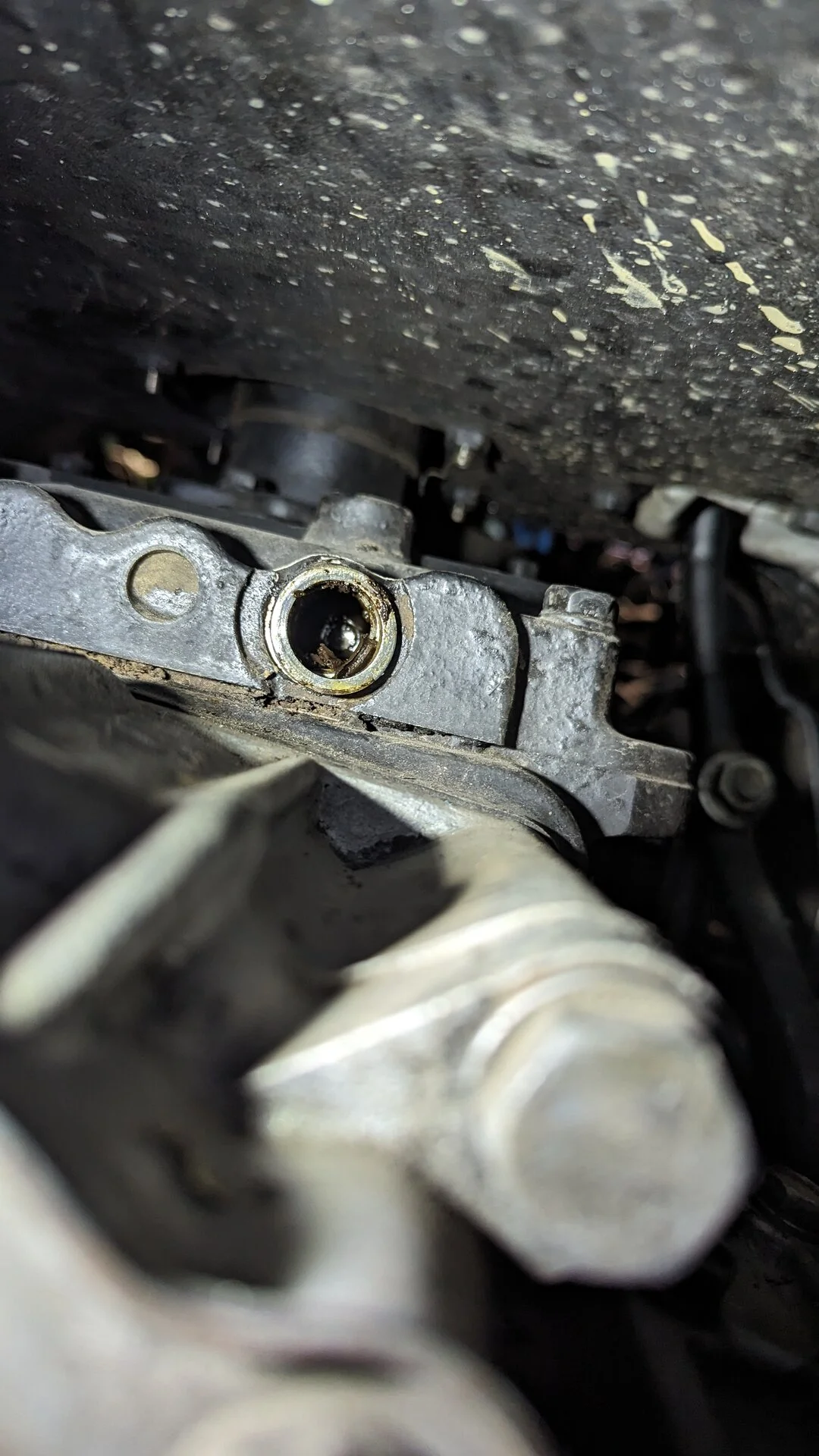

Pinion oil seal replacement complete.
Must have got some water in the dif and so I ended up changing out the gear oil with new.
Also noted that when I went to undo the nut, it was loose. I could turn it with my fingers and could have taken it off except for the stake.
When I put it back on the whole pinion bearing and drive shaft flange was much tighter and had no slack whereas before it had tons of slack and wobble.

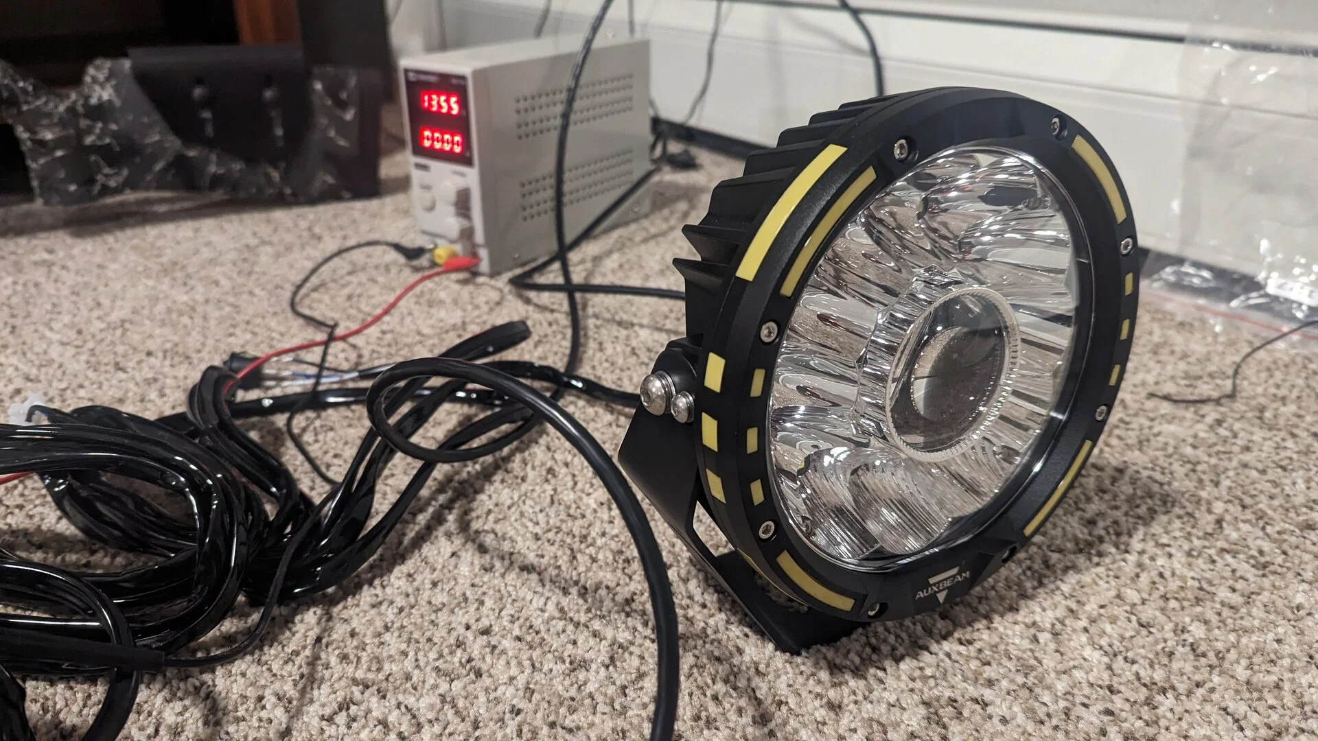

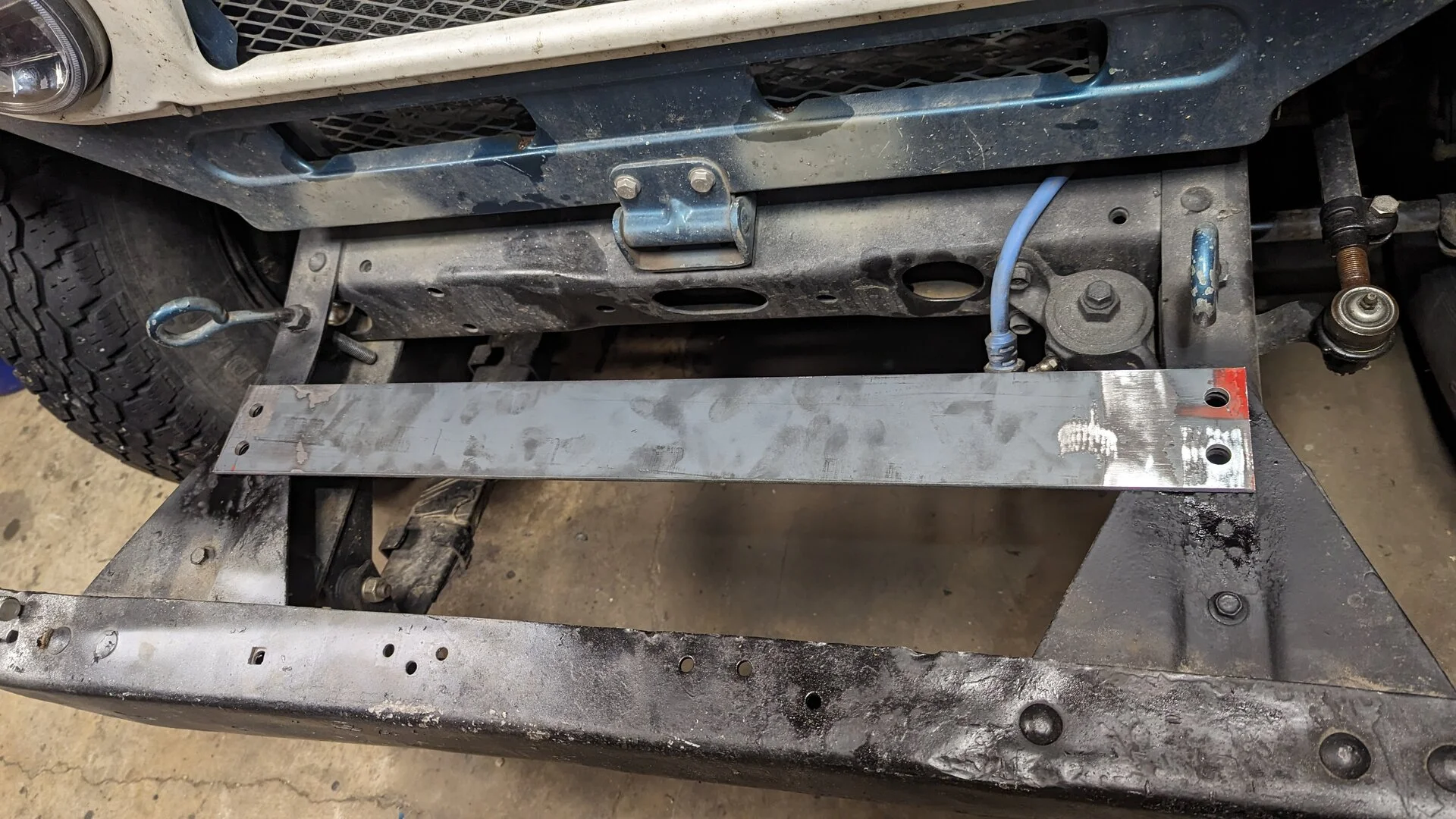

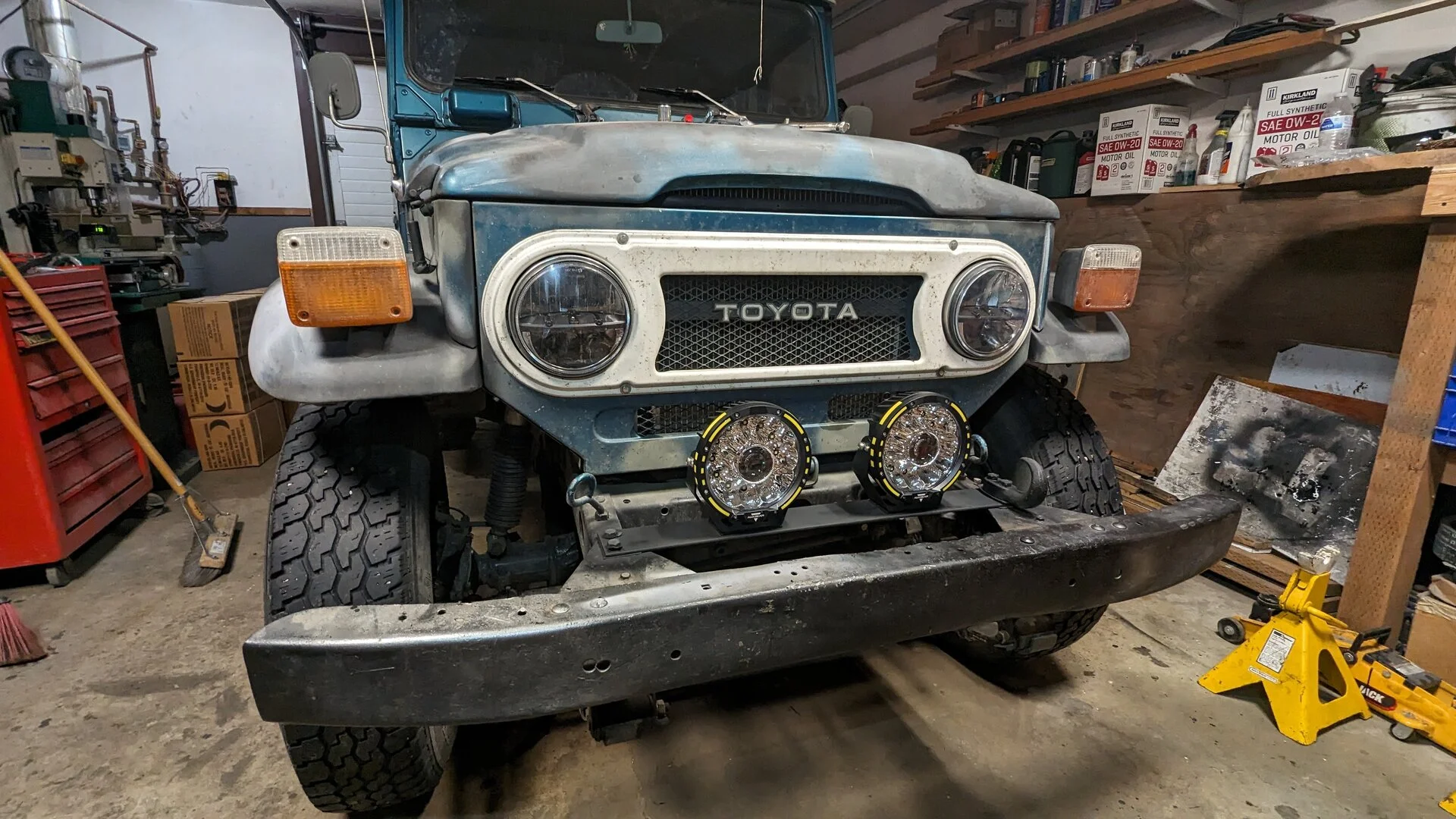

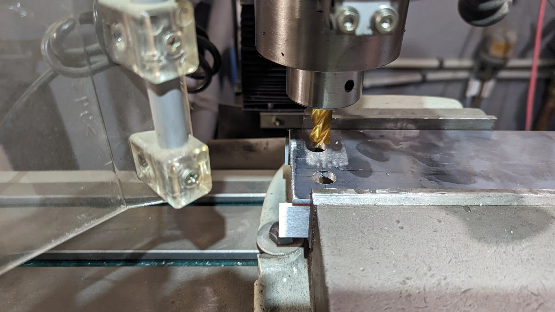

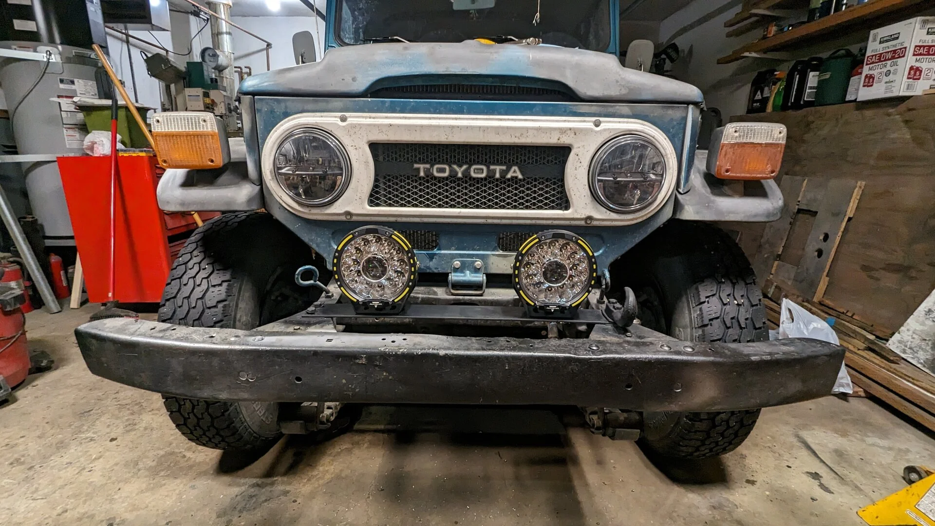

Mounted some lights to the front of the FJ40 this weekend. Used a 3" wide steel bar and mounted it to the frame via the tow hook holes and bolts.

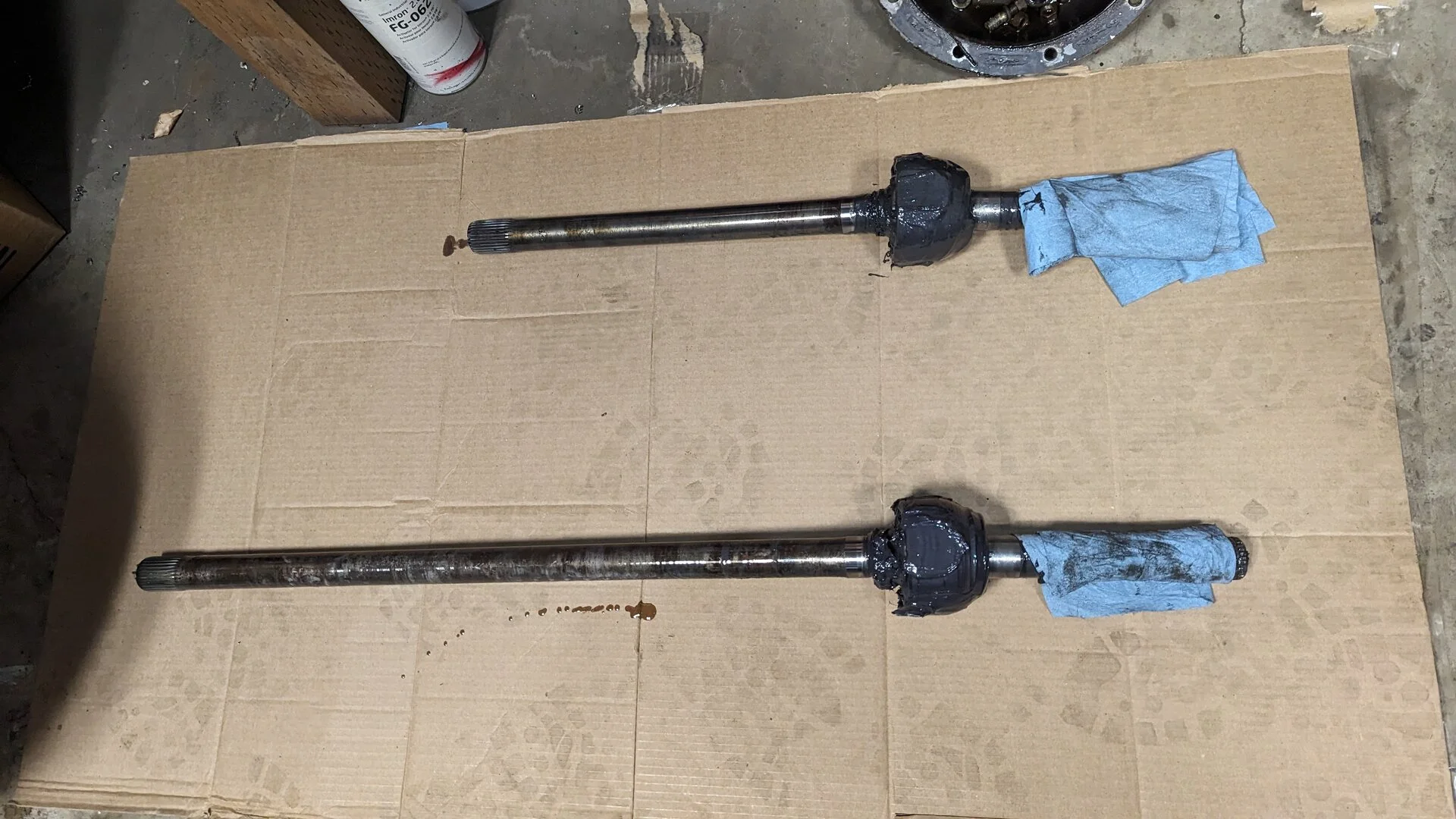

Pulled the knuckles and axles out AGAIN, in order to check the backlash of the ring and pinion gears. Backlash was .013" and so I reset it back down to .007". I was trying to track down a grumbling sound that only occurs in 4wd and only happens when decelerating. 7.5 hrs later with everything reassembled and the grumbling noise was still present. Not a complete waste of time as I checked the backlash, but not the most productive project.

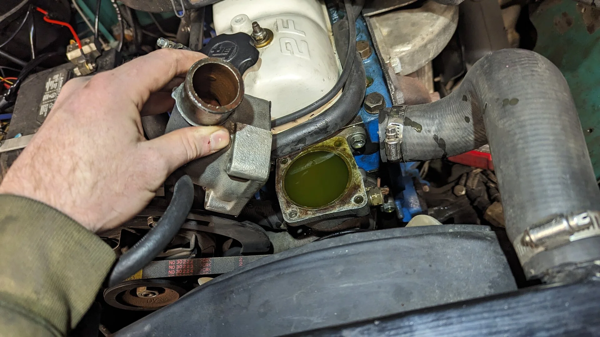

An old trick is to put cardboard in front of the radiator to help the truck warm up quicker, and this trick really works great and in the case of my FJ40, it seemed to work too well. After about 10 mins of driving with the cardboard, the engine was overheating. The heater was putting out a lot of hot air, and as soon as I stopped and pulled the cardboard out from in front of the radiator the engine cooled off and the heater was putting out semi hot air. 🫤.
Next step is to swap the T-stat. I swapped in a 190F T-stat and will see how it goes. The original T-stat was 180F.

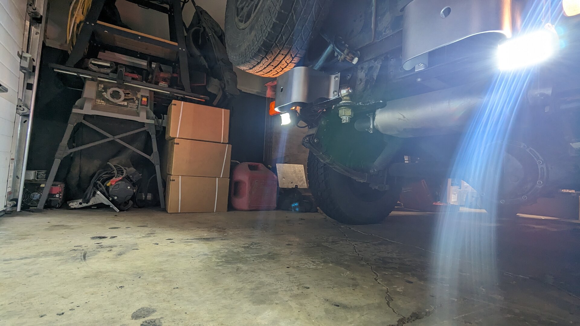

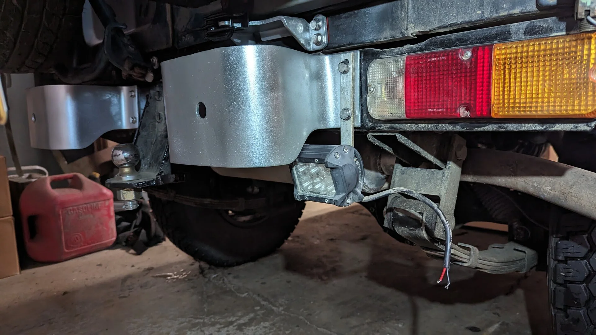

I also wanted a bit more light when reversing in the pitch black of the Alaskan winter. I had a couple cheap led pod lights lying around and figured out a non-invasive and non permanent mount for them.

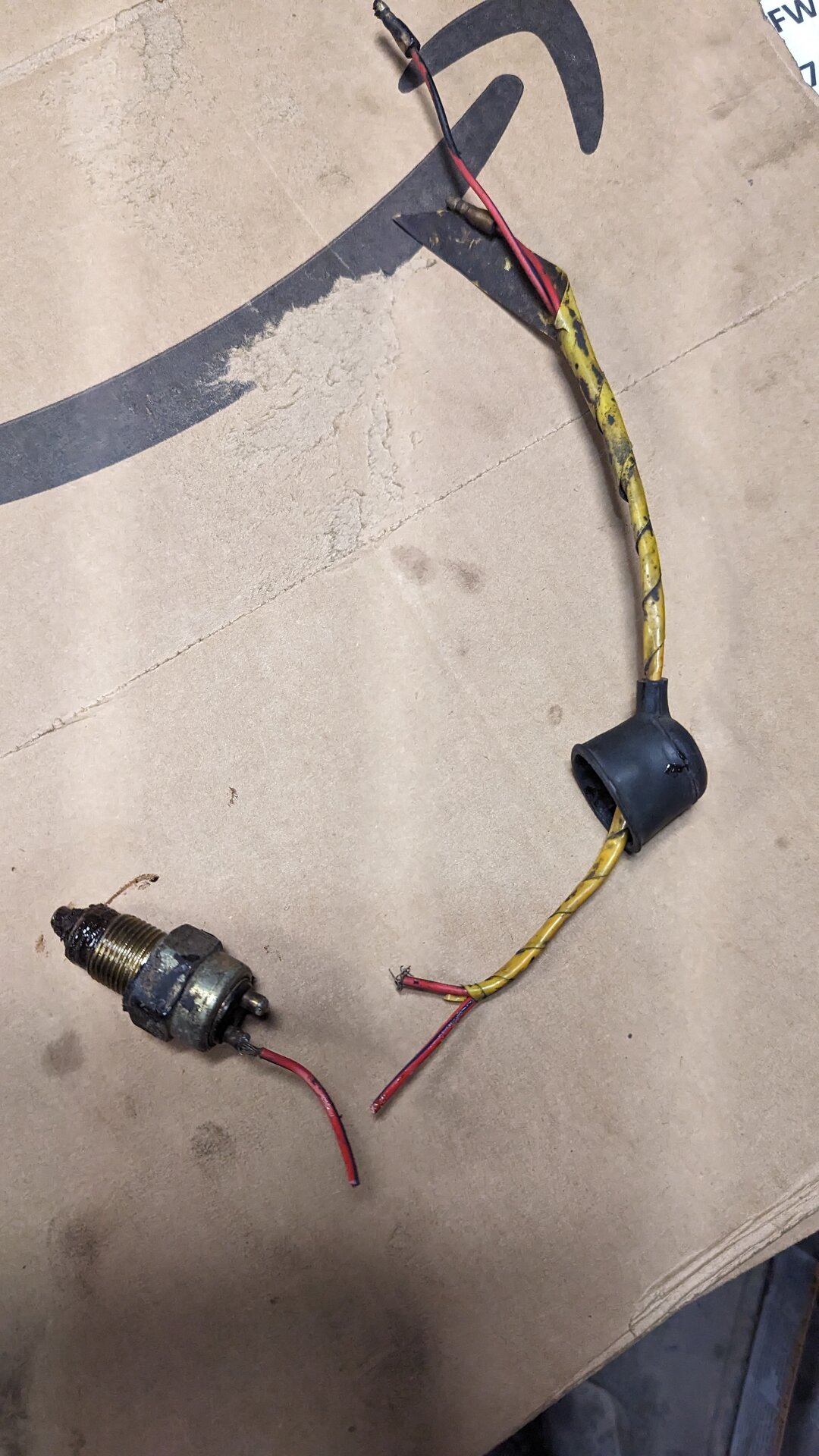

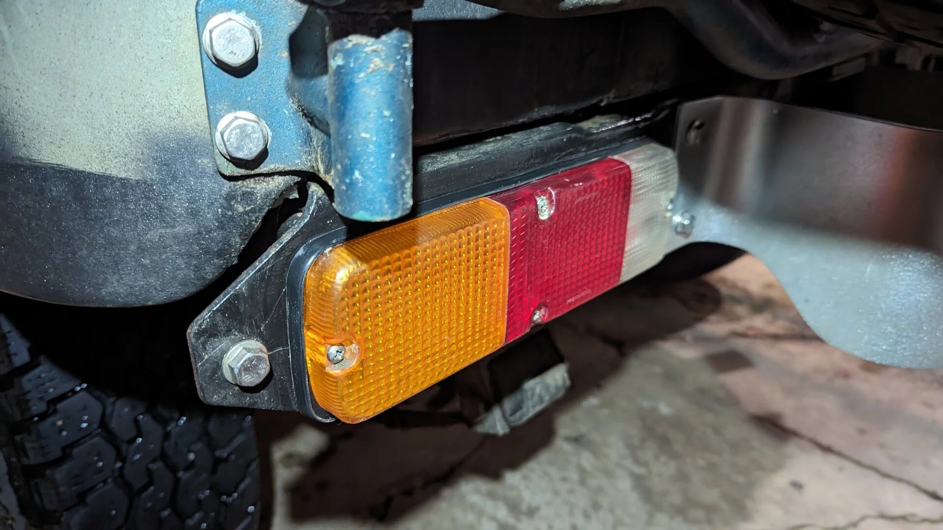

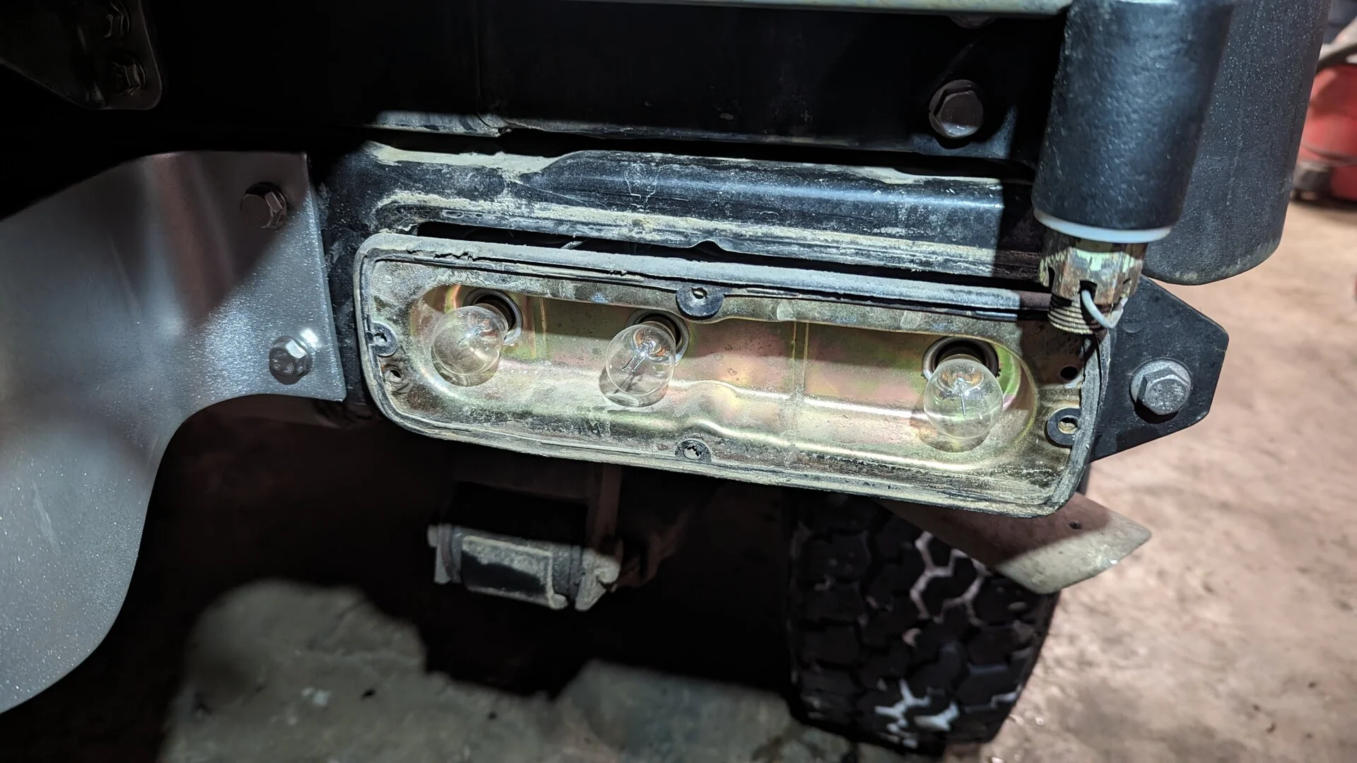

Wasn't getting reverse lights.

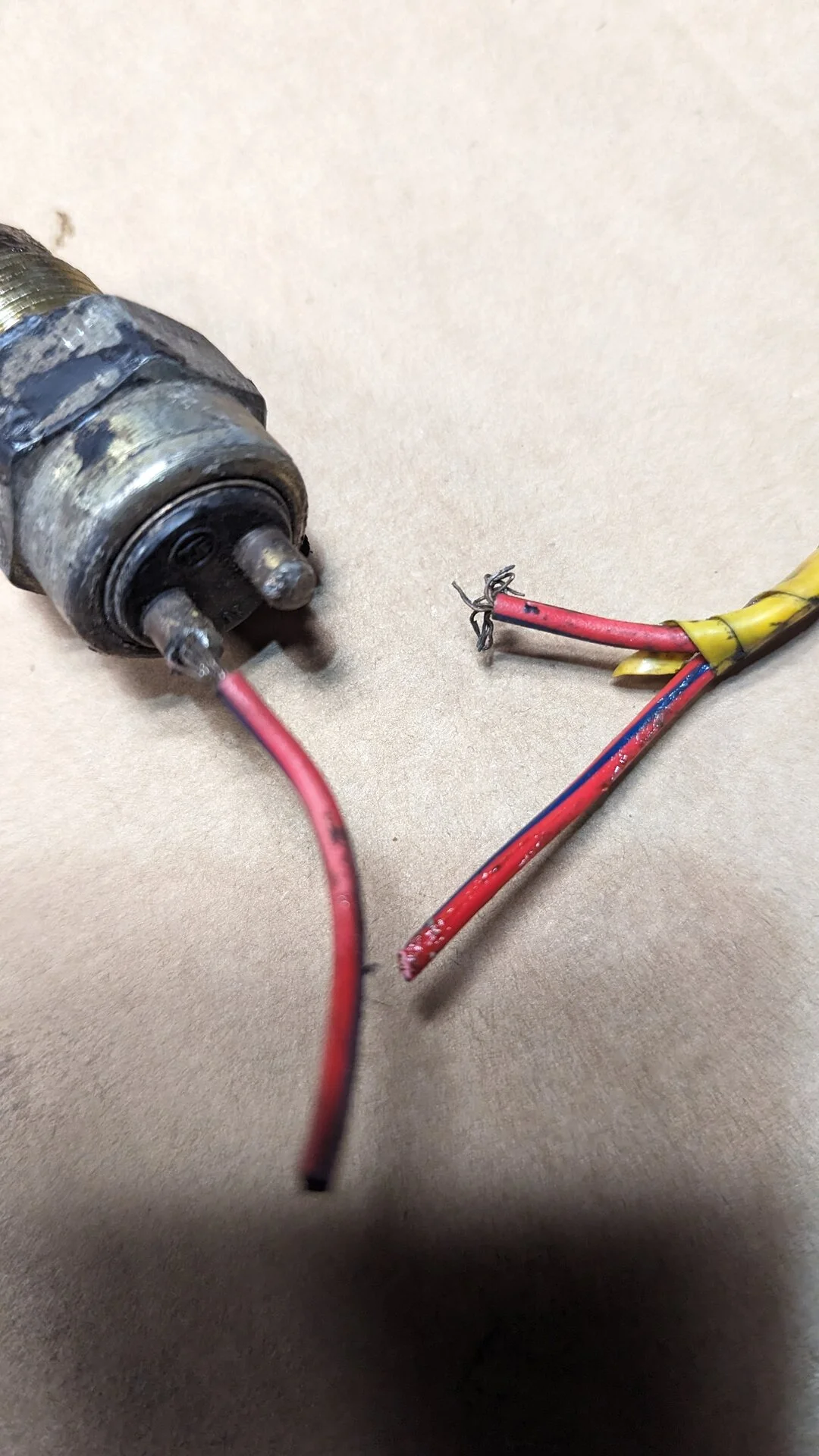

I pulled the reverse switch out from underneath by snipping the one wire still soldered to the switch and using a 24mm socket to break the switch free.
Proceeded to clean the switch up and resolder new leads to it.
Tested the switch and it's a normally closed type reverse switch, and appeared to function flawlessly.
Reinstallation was a treat, but with a 15/16" wrench I was able to get it reinstalled. Plug everything in and amazingly my break lights now function! Who knew...
Also finished wiring up the two LED pod lights in the rear and tied them into the reverse light switch too. Now I've got loads of light flooding back behind me for all those miles of backing up I do. (Sarcasm)
