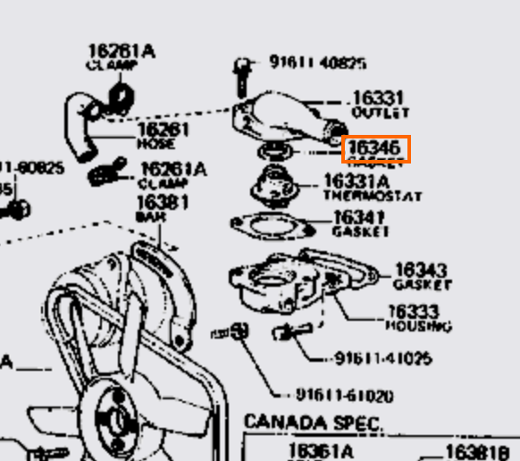

It wasn't apparent in the thermostat picture you posted so worth making sure you have the "gasket" that goes on top of the thermostat. Without it coolant is able to bypass the tstat.
You know, I honestly don't know if I had a gasket there or not. Grrr
Here's to another task that would have been easier to do right the first time🤣.

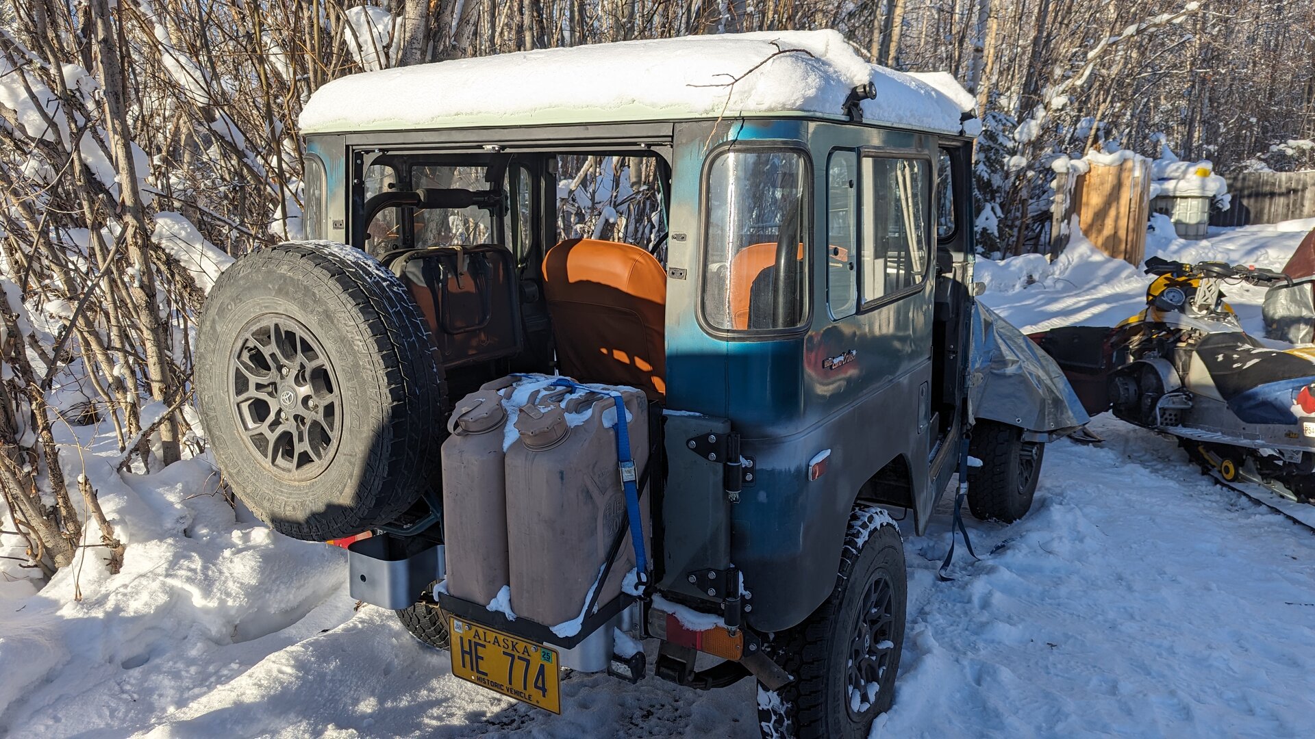

-18F on Sunday and the FJ40 started up without being plugged in. Groaned and whined the whole time, but it started. Not too shabby for those temps and this vehicle.
Plugged it in on Monday and the temps also weren't as bad and it fired right away.
Still pretty cold blooded even with the hotter Tstat and cardboard covering half the radiator.

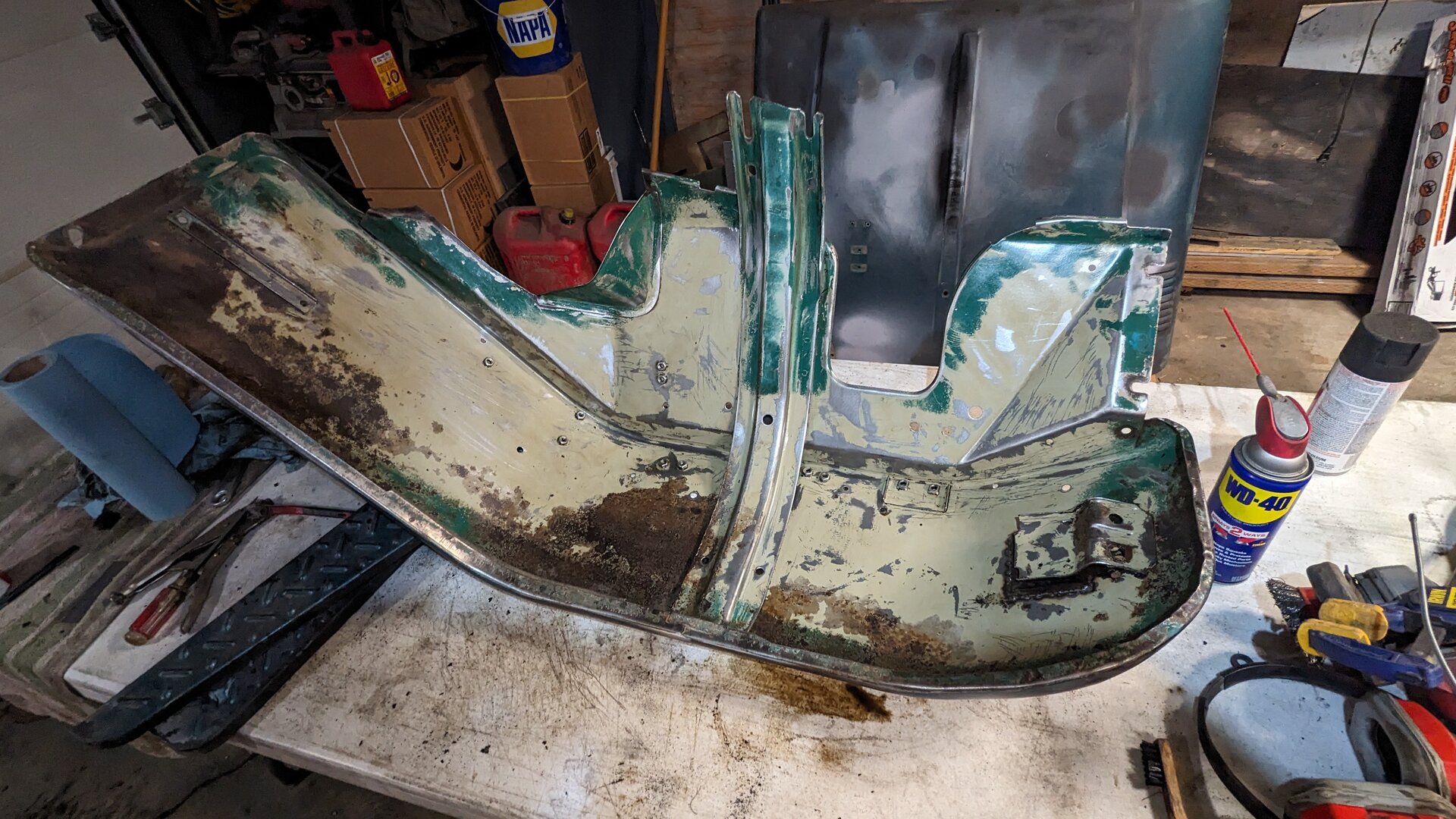

Stripping, wire wheeling and sanding.

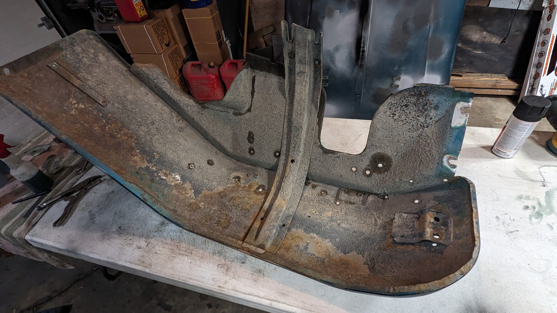

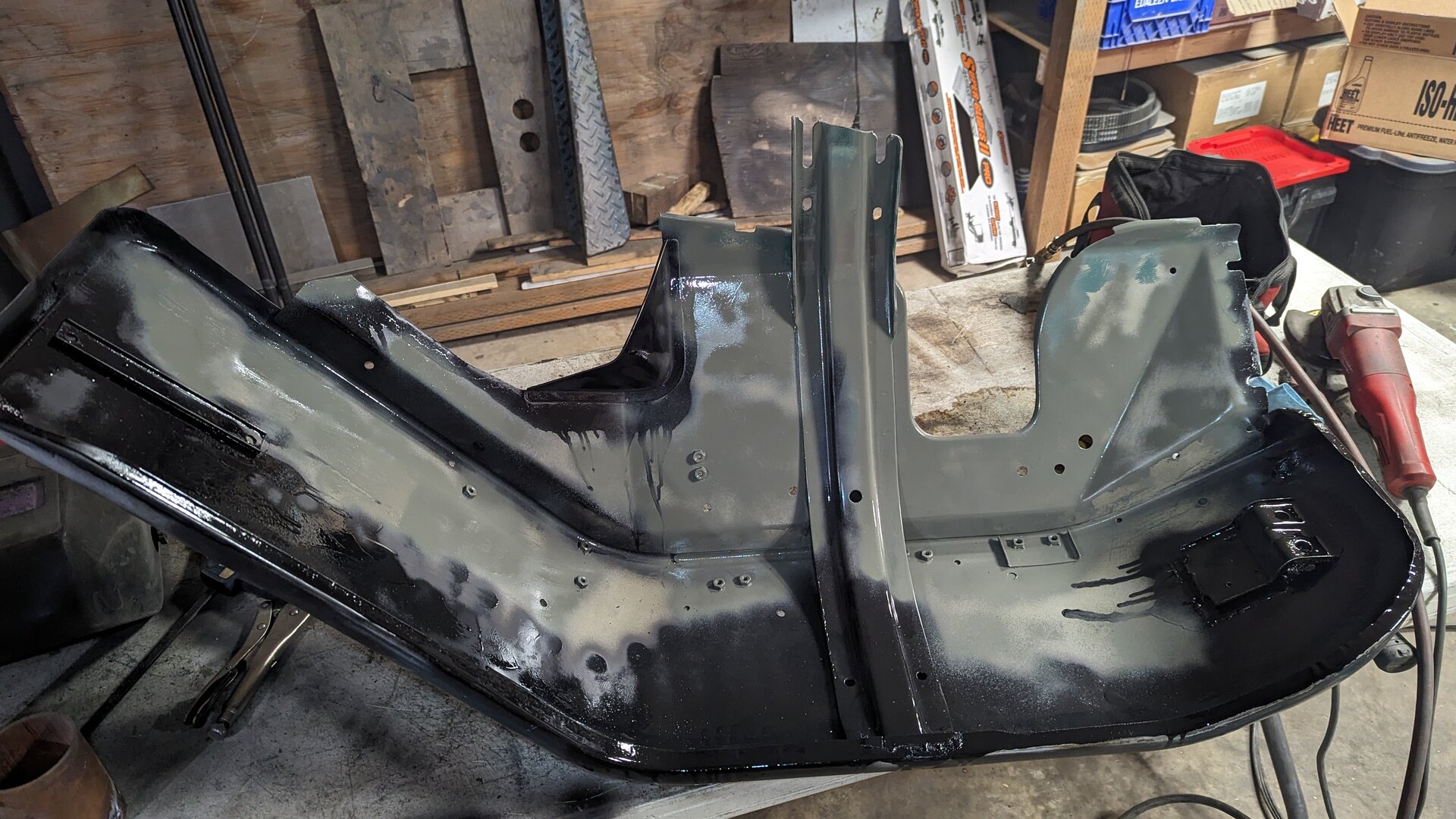

The PO sprayed an asphalt undercoating on the vehicle and so I'm trying to use the cold to my advantage by setting the wheel wells outside to freeze before chipping off the undercoating. Otherwise it just tends to smear under the wire wheel.
After the parts are clean and ready for paint I spray a rust converter paint where there was rust and spray self etching paint on the bare metal.

The fenders I had on mine was like a tar undercoating. Heated it with a heat gun and scraped most off with a plastic Bondo scoop. Definitely was a pain to remove.
Well done with the cold trick!
And by "cold" this is what I mean. The asphalt flaked off nicely with a big flathead screwdriver used as a chisel. Then I used WD-40 to clean up the residue.
Then I used some rust converting primer and have all the parts ready for epoxy primer and Rustic Green paint.

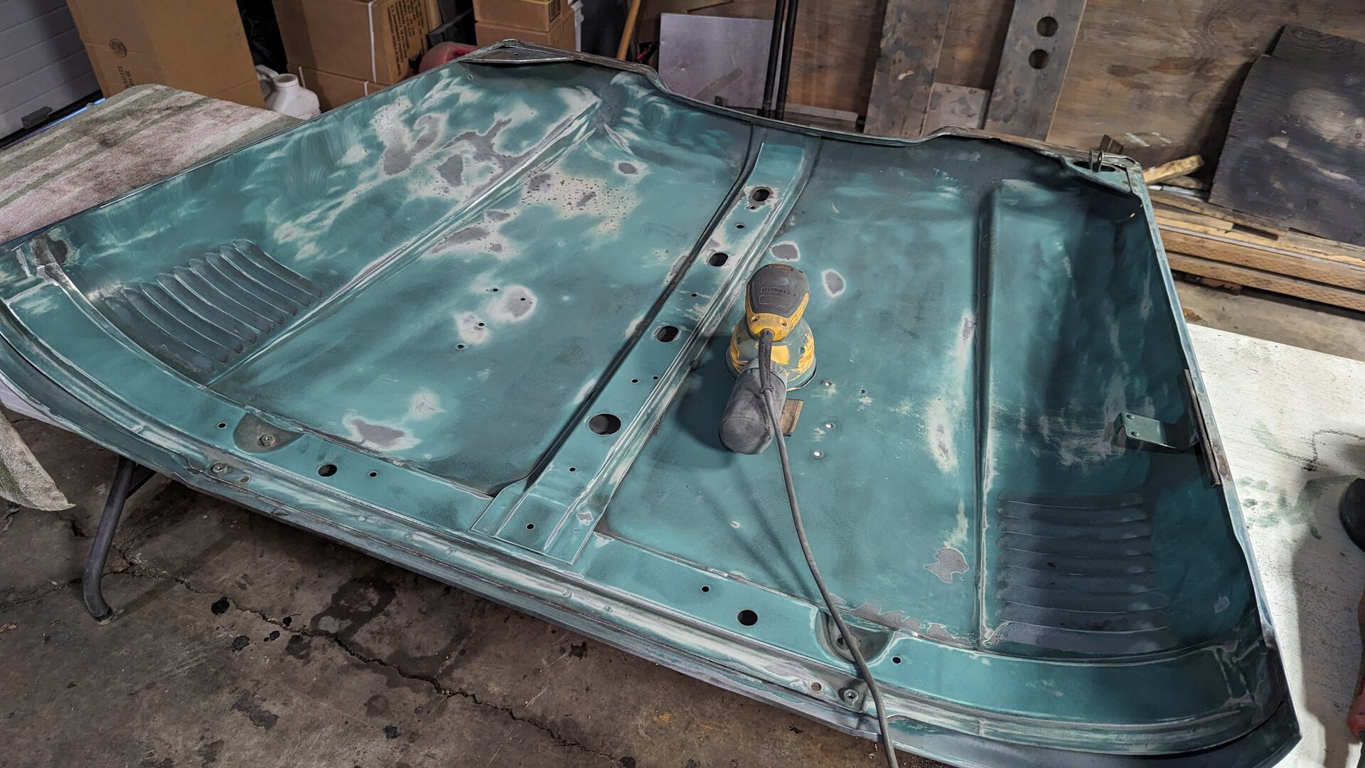

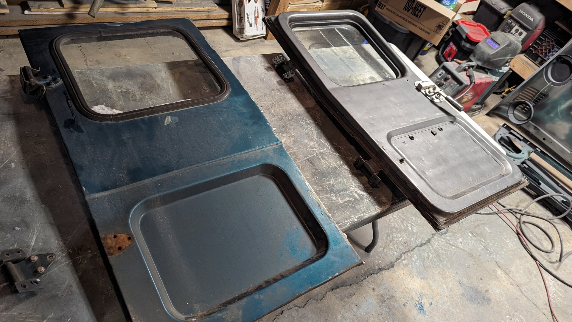

Took the doors off today and stripped them down.
Wire wheeled any rust and spent a decent chunk of time scraping "crud" out of the bottom of the doors and using compressed air to open up the clogged drains at the bottom of the door.

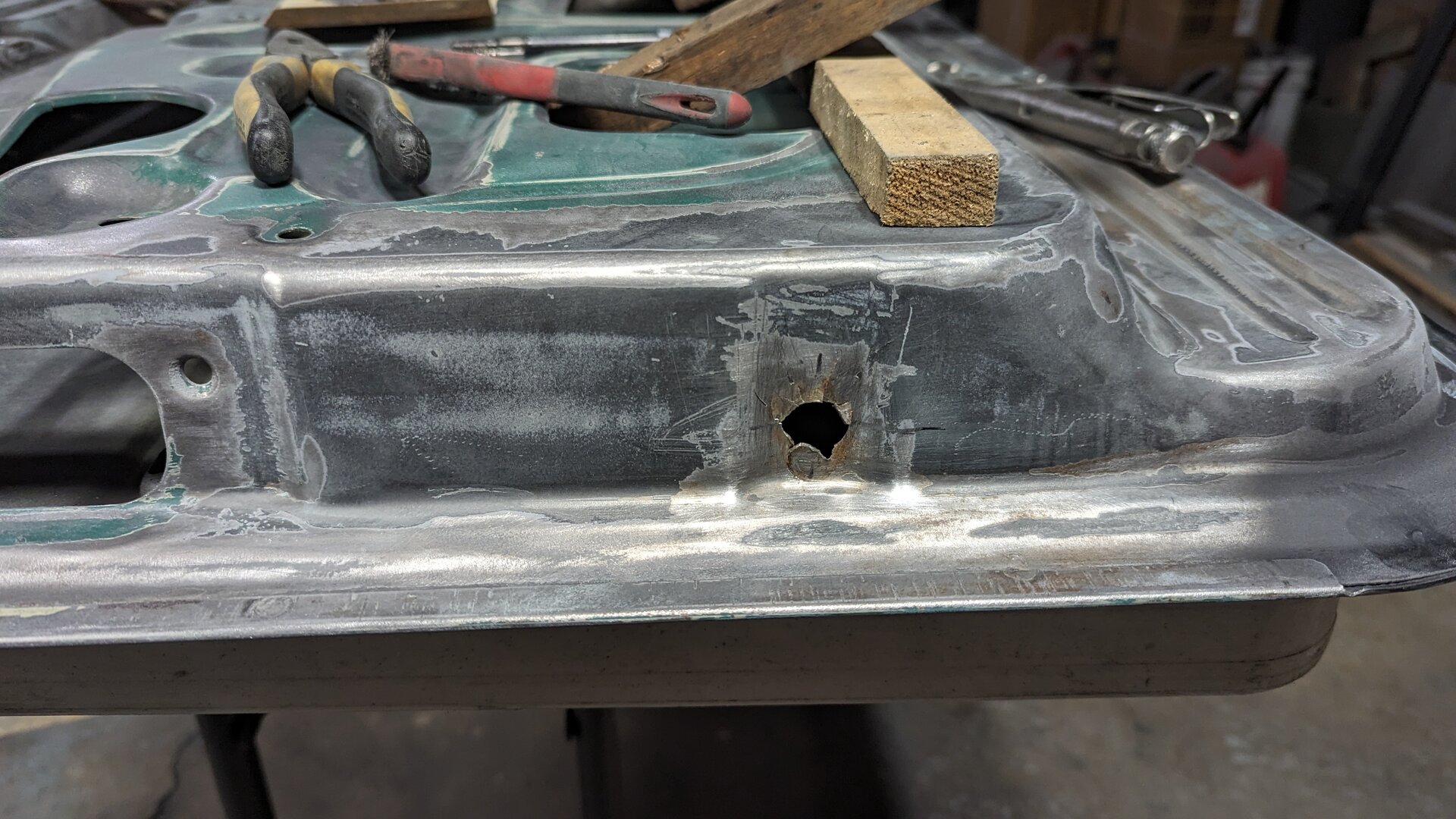

Also found a previous repair that was filled with body filler to be unacceptable so I removed it and poured the metal out as much as possible from behind. Will still need some filler.
More paint prep in the rear ambulance doors. Tedious stuff sanding and dealing with rust for hours. On a positive note, the rear windows popped right out without much fuss. One of the seals was broken and so I've got that on order for when I reinstall everything this summer.
