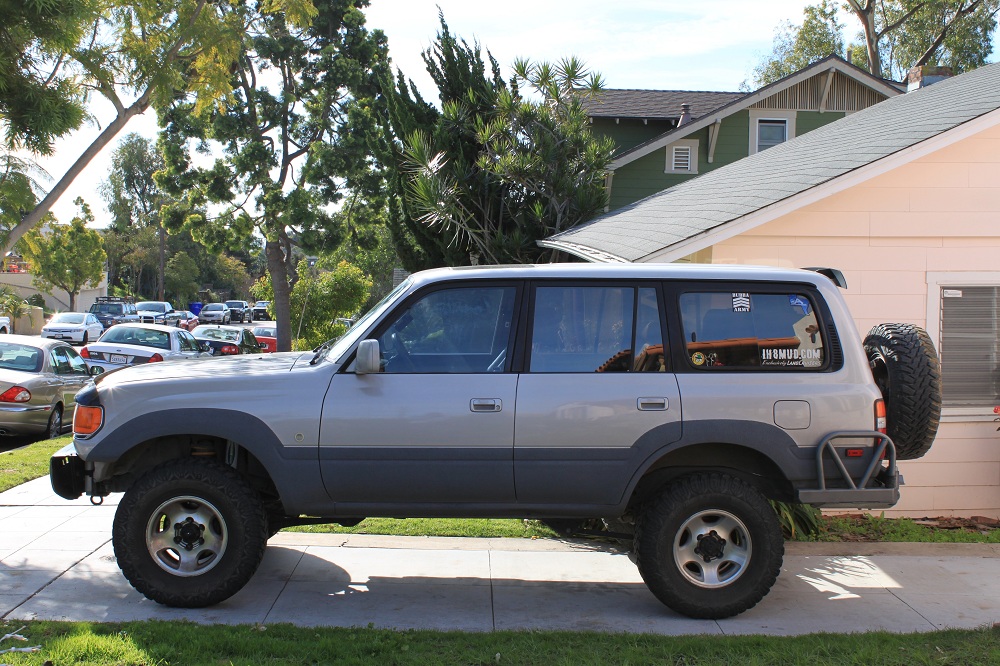

Do you guys think 1" spacers will be too much once loaded up in back?
This is hos my rig sits with my 100# cargo box plus about another 100#'s of CO2 bottle, tools and spare parts.
*Edit*
Well I guess the smallest you can get is 20mm (.78 inches) so what's the difference from 1"
