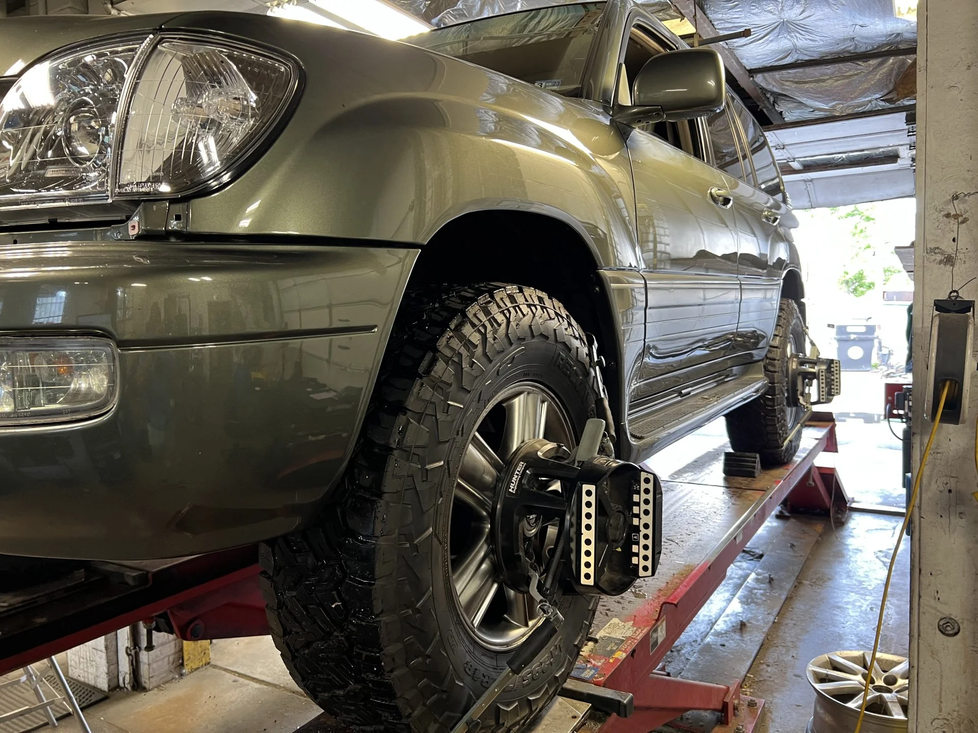

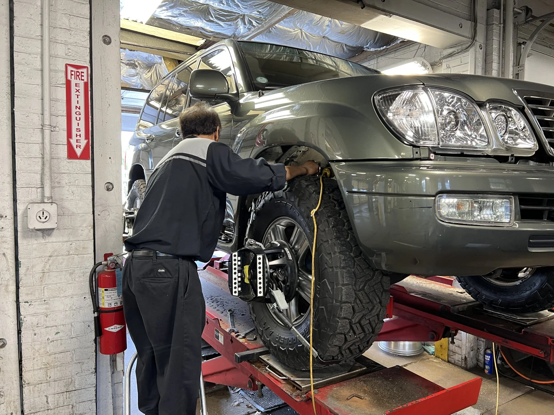

Our Alignment specialist has refused to work on my truck because of the adjustable control arms but he tackled it today to my surprise.

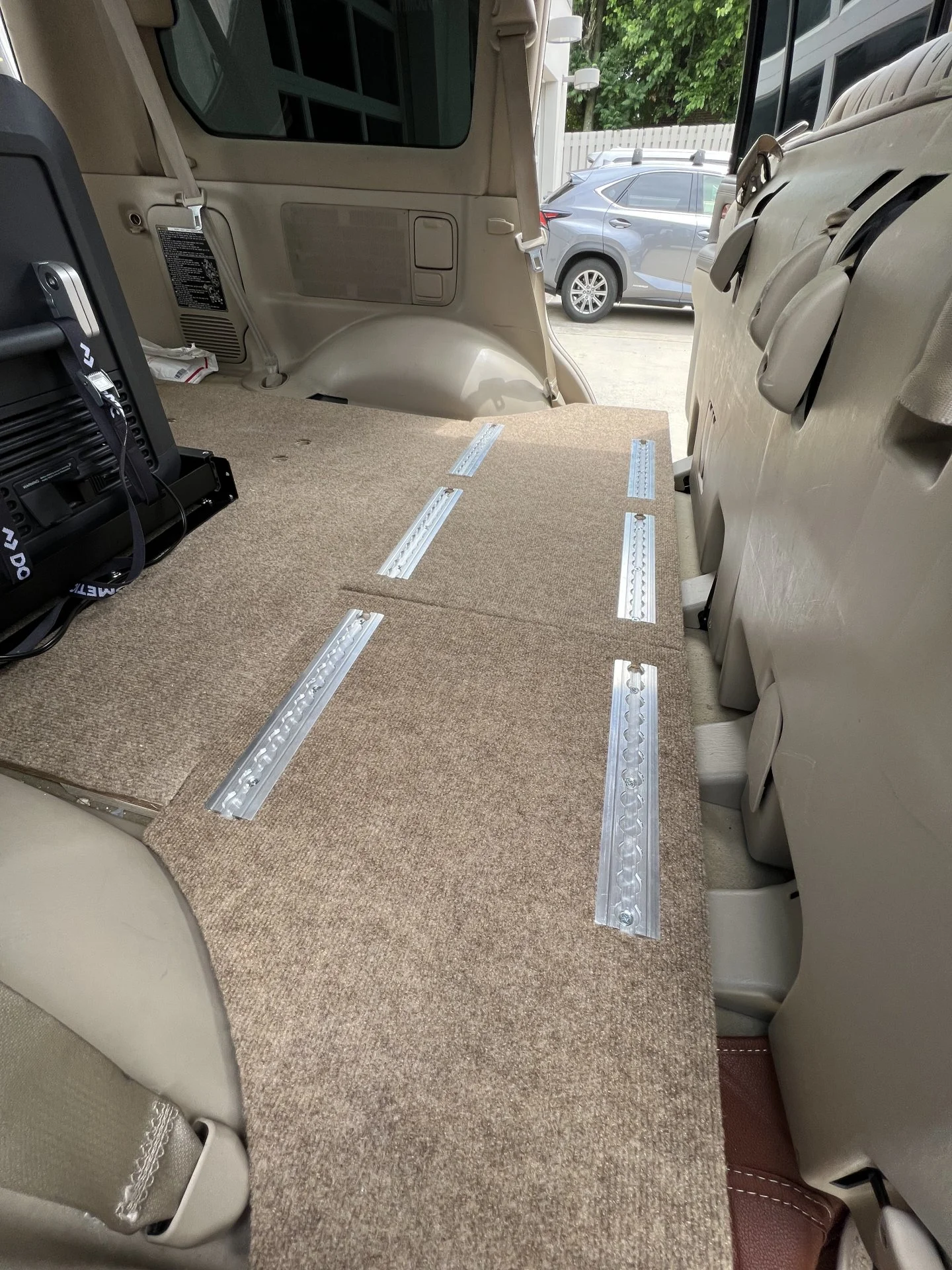

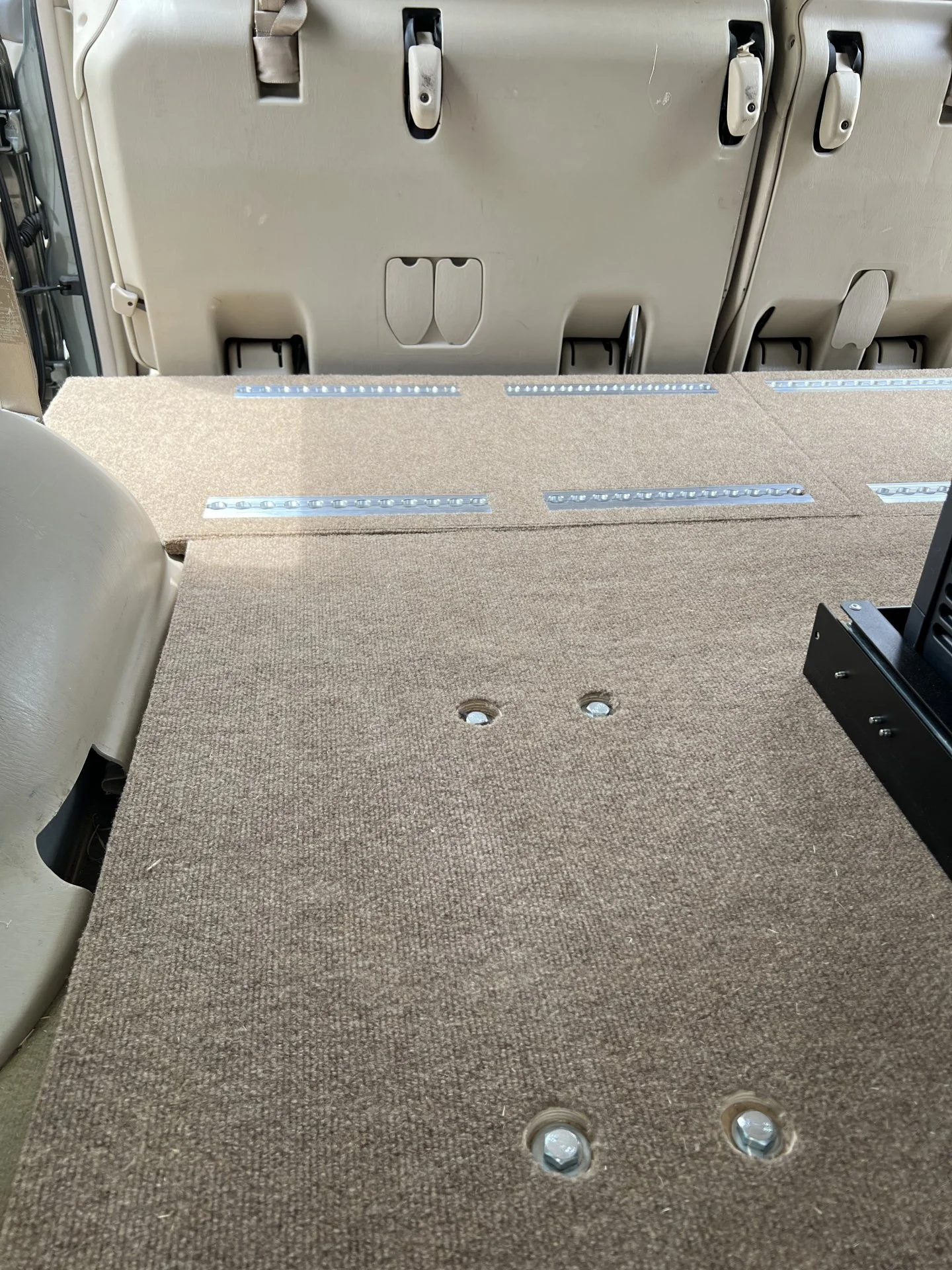

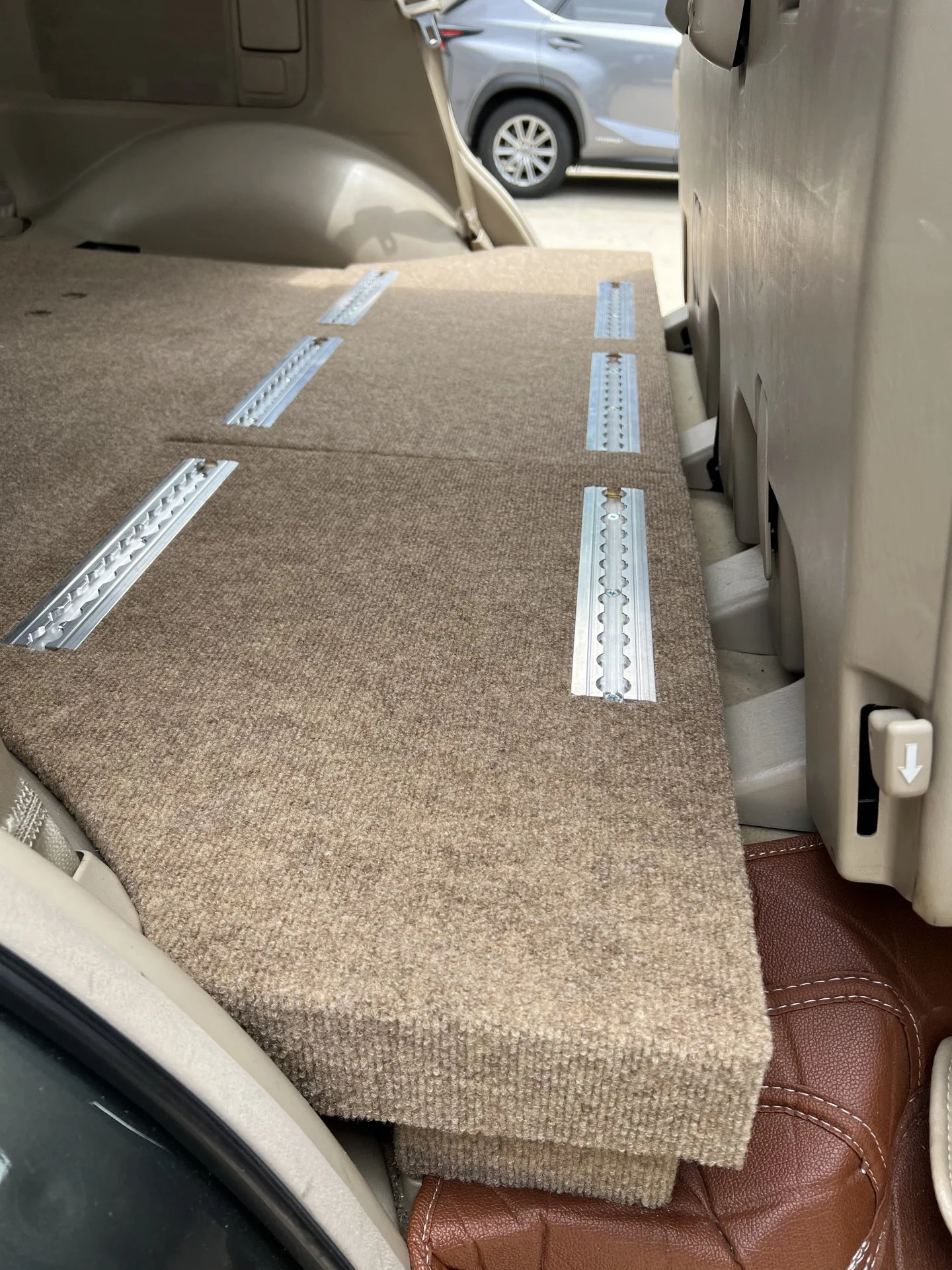

I was also able to finish the extension of the plate I built for the fridge. I think I overdid the L-track but I had quite a bit sitting around …I also plan on running two strips in the area next to the fridge. I need to trim the footer on the left section so it sits absolutely flush

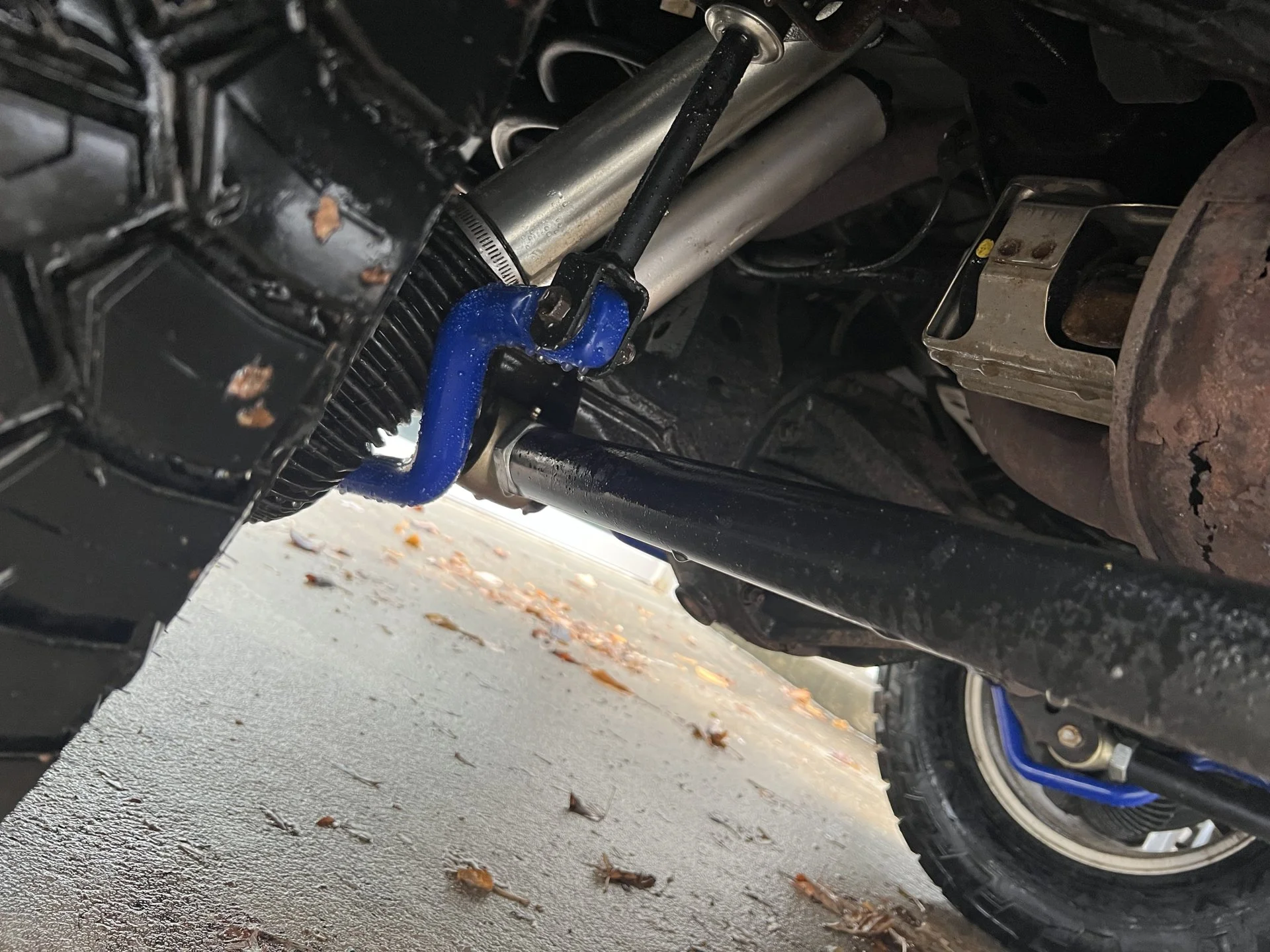

So adding the Slee Suspension really changed the ride…comparable to AHC.

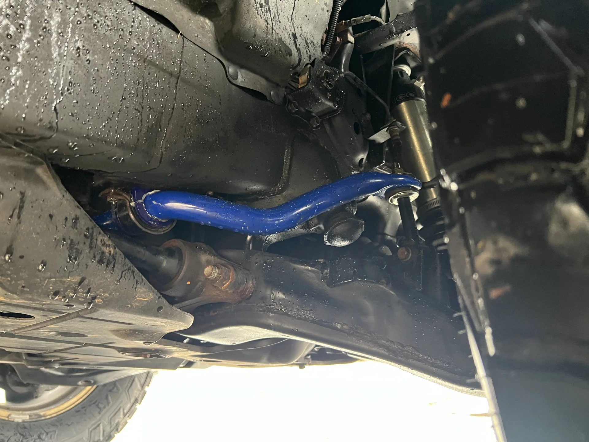

Adding the extended sway bar links which brings the sway bar back to normal allowed way to much lean in corners and side to side body motion which is one reason I would never buy a 200 and run the OEM suspension.
So searching heavy duty sway bars brought me to SuperPro. Made in Australia but also sold stateside. Came with new bushings and the bar is much larger than stock. I just drove it a few blocks and the new sway bars really controls body motion. The only issue is the rear sway bar is just touching the suspension boot… something I’ll have to watch. That rusty muffler is getting replaced with a new OEM next week.
Silly question: How are the extension platforms secured down to the truck? If a load secured to your L-track was properly motivated wouldn't it just take the platform with it? I've been thinking about a modified plate that replaces the plastic step your platform is resting on with an aluminum one with 1-2 recessed D-rings just for this type of setup. Or maybe a custom bracket that pokes a d-ring out from under the cosmetic shroud on the outside of the 2nd row seat hinges?
P.s. Glad I found your build thread! Keep the mods coming so we can just copy you. Hahaha
The extensions are not secured to the truck and I do I need to figure that out.

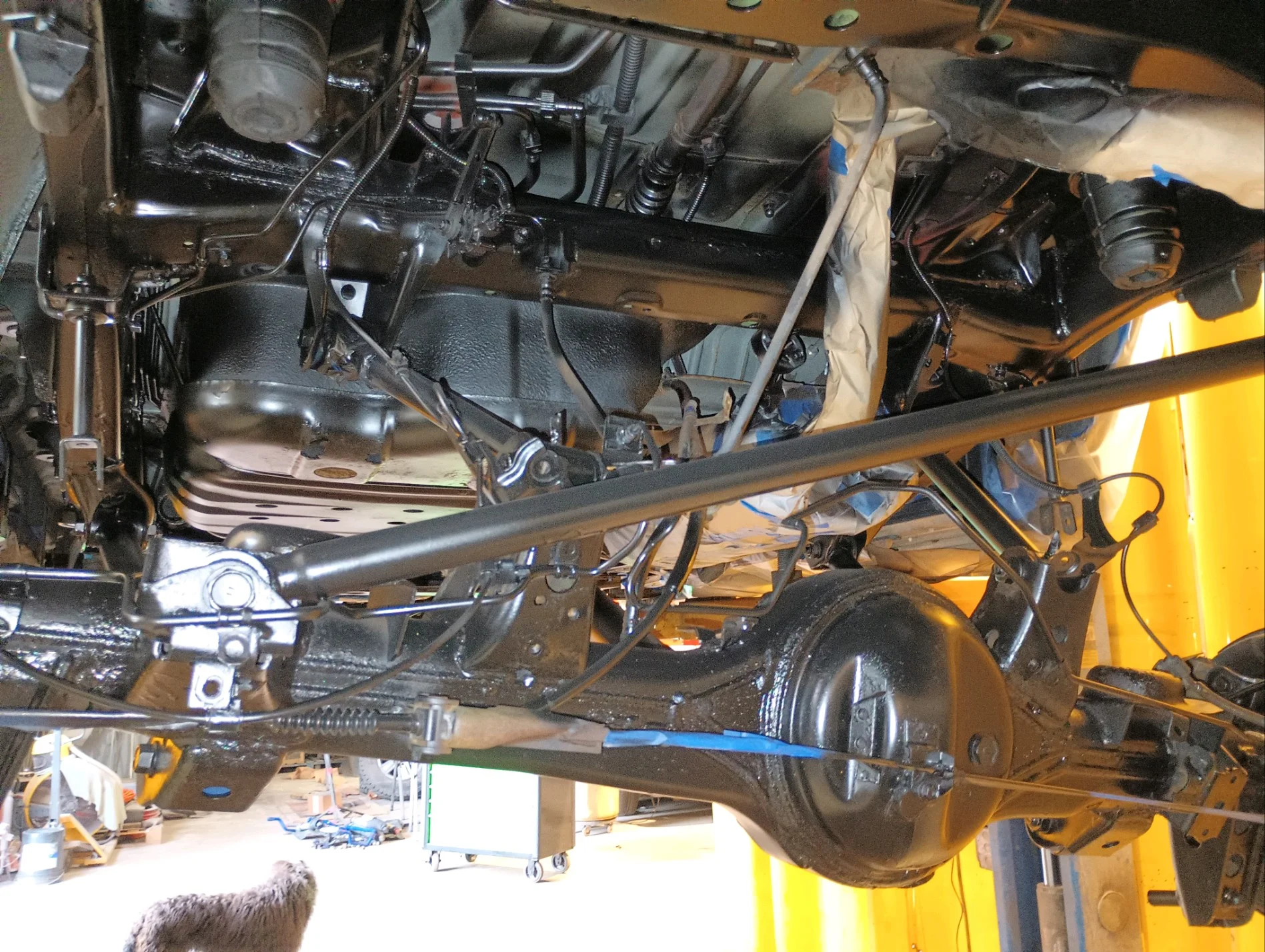

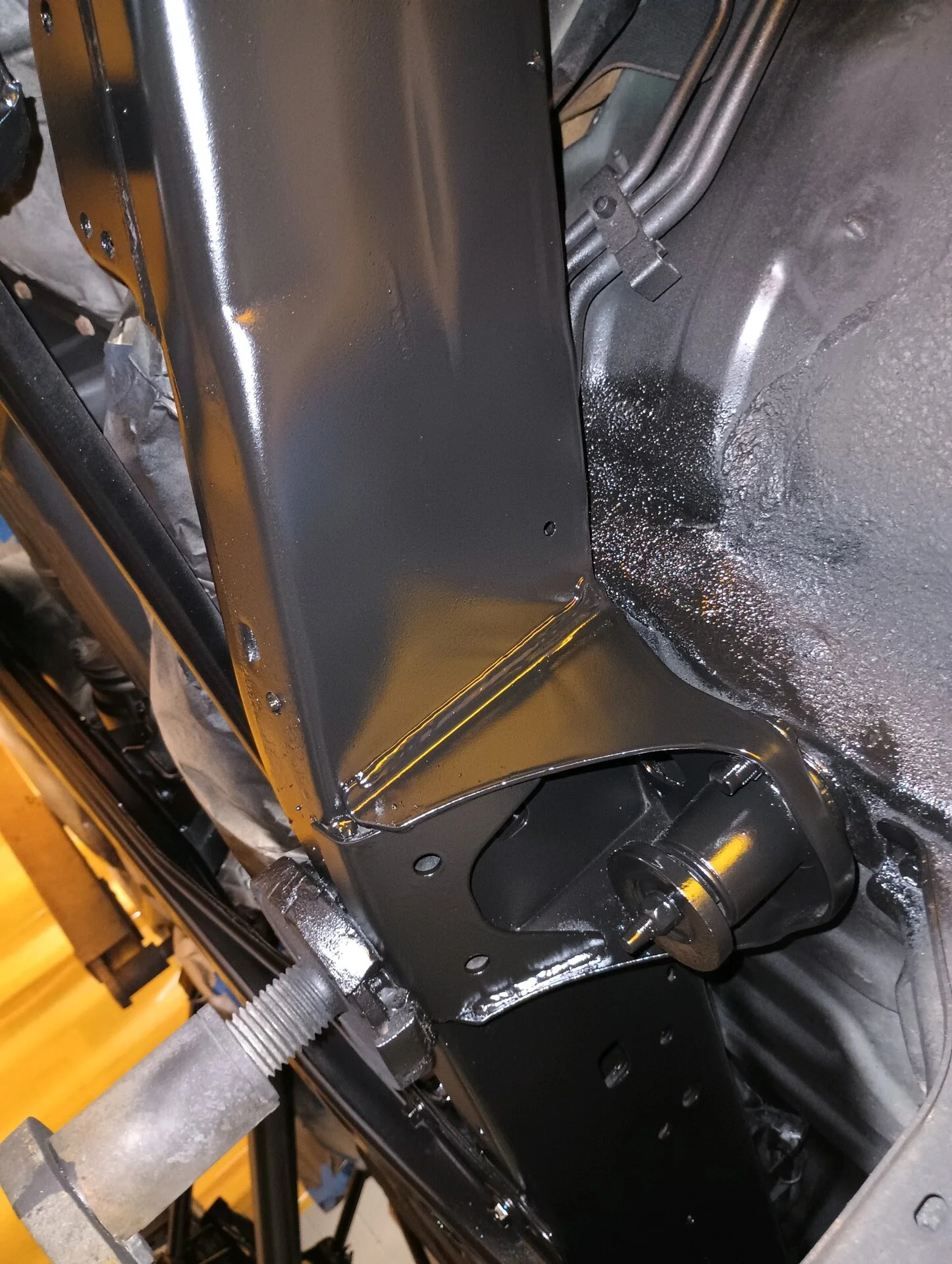

What do they charge for a service like that?
Wow! What all is involved in this process?

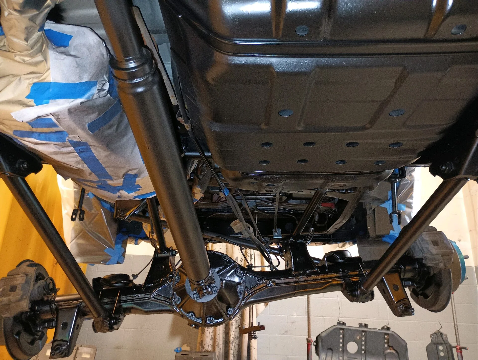

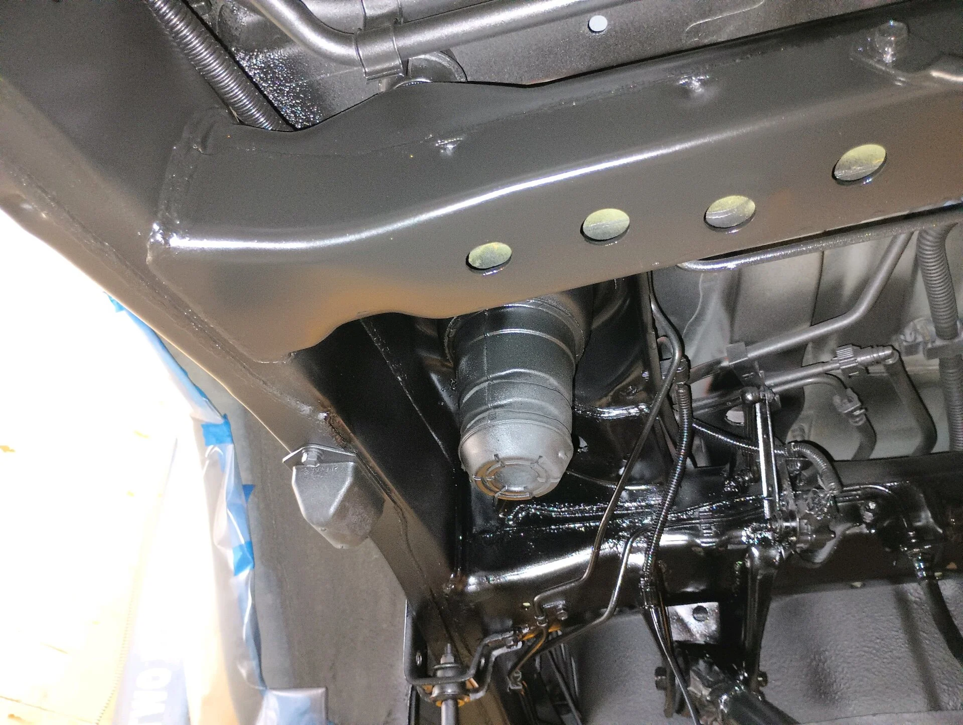

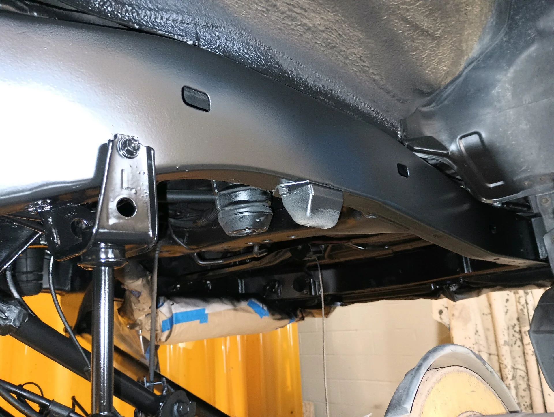

Removal of suspension, sway bars, and everything you don’t want painted.
Degrease and power wash chassis and internal frame where accessible. Wire wheel, and wire brush any surface rust. Rust encapsulator internal frame and exterior then paint with chassis black. My LX wasn’t that bad but I’m replacing the gas tank skid plate which had a few small rust holes
what do they charge for a service like that?
Each job is based on the condition of your truck. Prices range from $2000-$4000. This cost me $2800 and I bought extra rust encapsulator so they applied 4 coats of encapsulator. The pictures above are just with the encapsulator. They still have to do a chassis paint, which is the final coat. The internal frame treatment is a slightly different product.
Wow! Looks like they do a great job. Do you normally have this done prior to every winter?
No, this is a permanent solution and should last for years. If you look up Eastwood Products they have a full variety of chassis and frame treatment products.

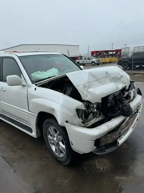

Well Lou’s green Machine is Now an Idahoan! After my son totaled my 2004 LX, I was being a smart ass and sent Lou a picture of my wrecked 04 and said I might need new headlights. Of course Lou laughed and said he literally just posted his 06 LX for sale on Mud 5 minutes before I sent him the pic.
I know Lou does his upgrades right and takes care of his cars, so I felt really comfortable buying it and shipping it sight unseen. I am going to continue this thread as I have some other upgrades in mind for the new 06. Going to try and continue building it as an overlander.
