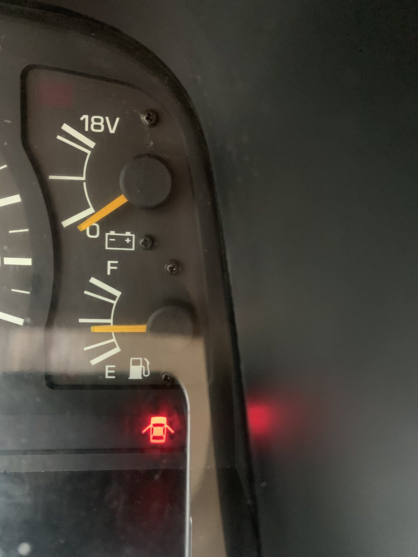

Ok.. onward and downward I go. Seriously is there a door ajar dash indicator light? I have read through some posts about this mysterious door open dash icon and also apparently the seat belts have a warning buzzer and well.. none of those things work for me so does anyone have a picture of this dash icon for the door open Symbol? Of course my D dash icon is also dead but I just haven’t had a good enough reason to go messing around in there yet!

Thanks that is very helpful. Dang it now I have to figure out how to get that to work too. Thanks for the picture I seriously couldnt find anything in the owners manual or on here to indicate It’s position in the dash.

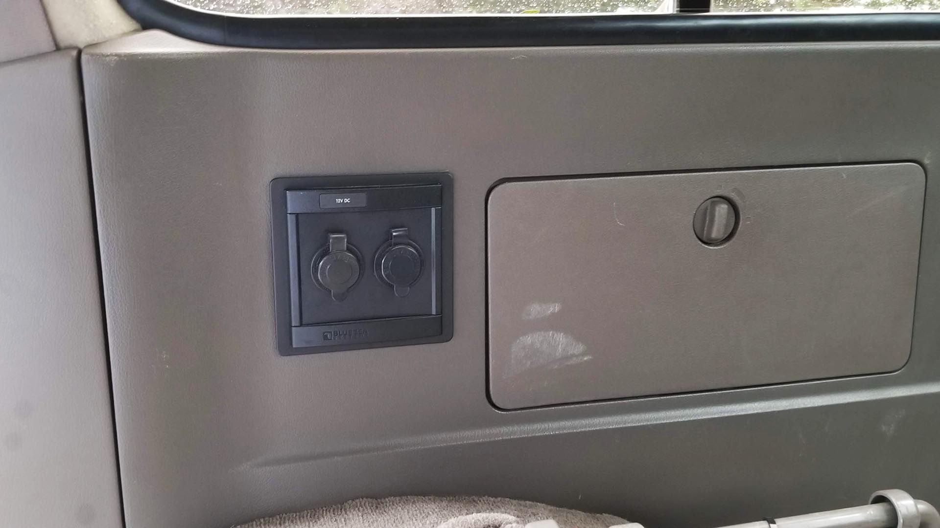

I used the Blue Sea panel in the rear quarter of my LX450 in place of the ash tray that was there. It's always hot and works very well for my ARB fridge and allows me to plug in whatever device I want to charge overnight when I'm sleeping in the back. My needs are simpler than yours, but you get the idea.

There, it is connected to a simple blue sea fuse box (5045) that is mounted onto the passenger seat bracket. I think I used 12AWG from that point to make two cables that go the distance from there to the rear quarter panel in the trunk where I have the ashtray cover replacement plate from SolveFunction @Outsane.
For me, I basically just wanted some usb ports to charge phones, headlamp, etc. and a 12V socket to run a boot drier to warm ski boots on the way to the mountain. The circuit breaker up front is nice to be able to turn off power to the trunk too if you ever want to. Not the fanciest setup, but it works great for what I need!
