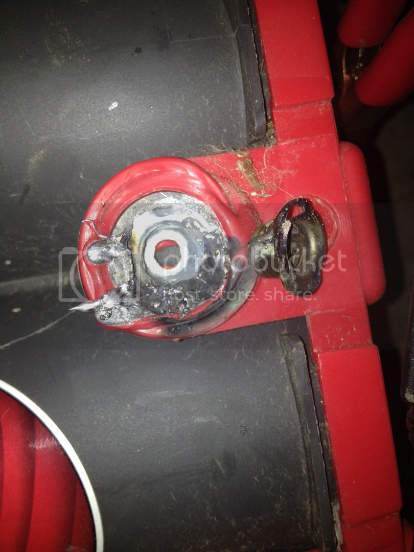

I'm a big Optima fan. I have a yellow top in the cruiser. It always holds 13+ volts, and always starts even in subzero weather. I use red tops at work in back up generators on remote mountain tops. They just work, and you can find them anywhere. I also trickle charge them with a battery tender periodically. I would guess in the last ten years I have personally purchased and installed north of 40 Optima's. The only "problem" I have ever had was due to my own idiocy. I ran two red tops in series off of the side posts, then attached a readywelder and proceeded to burn through 4 pounds of wire. The terminals overheated and literally melted the lead out. This battery still holds a charge. It would not have happened had I used the large terminals on top.
