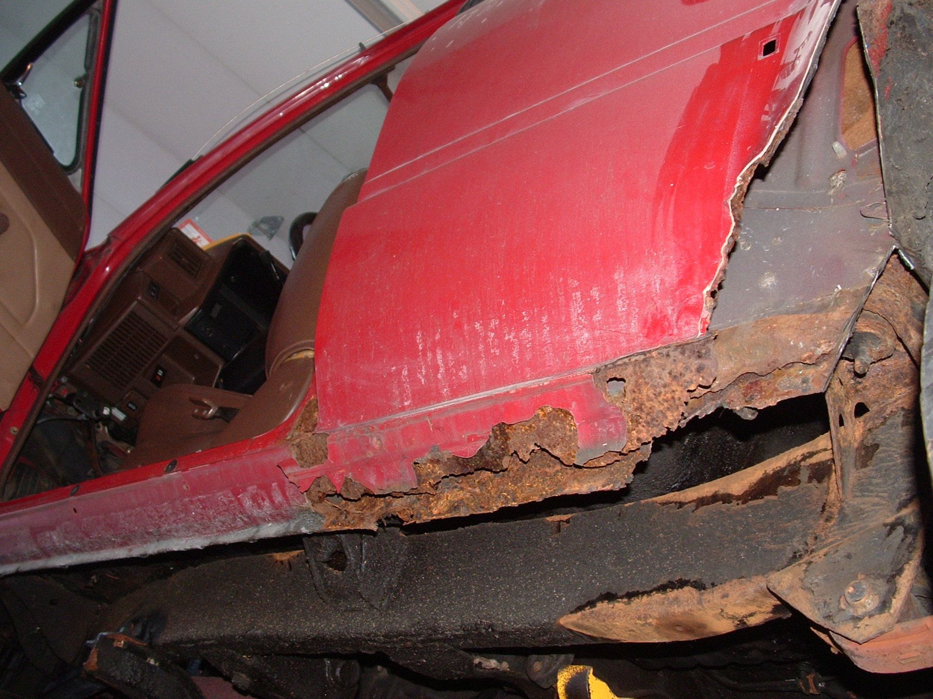

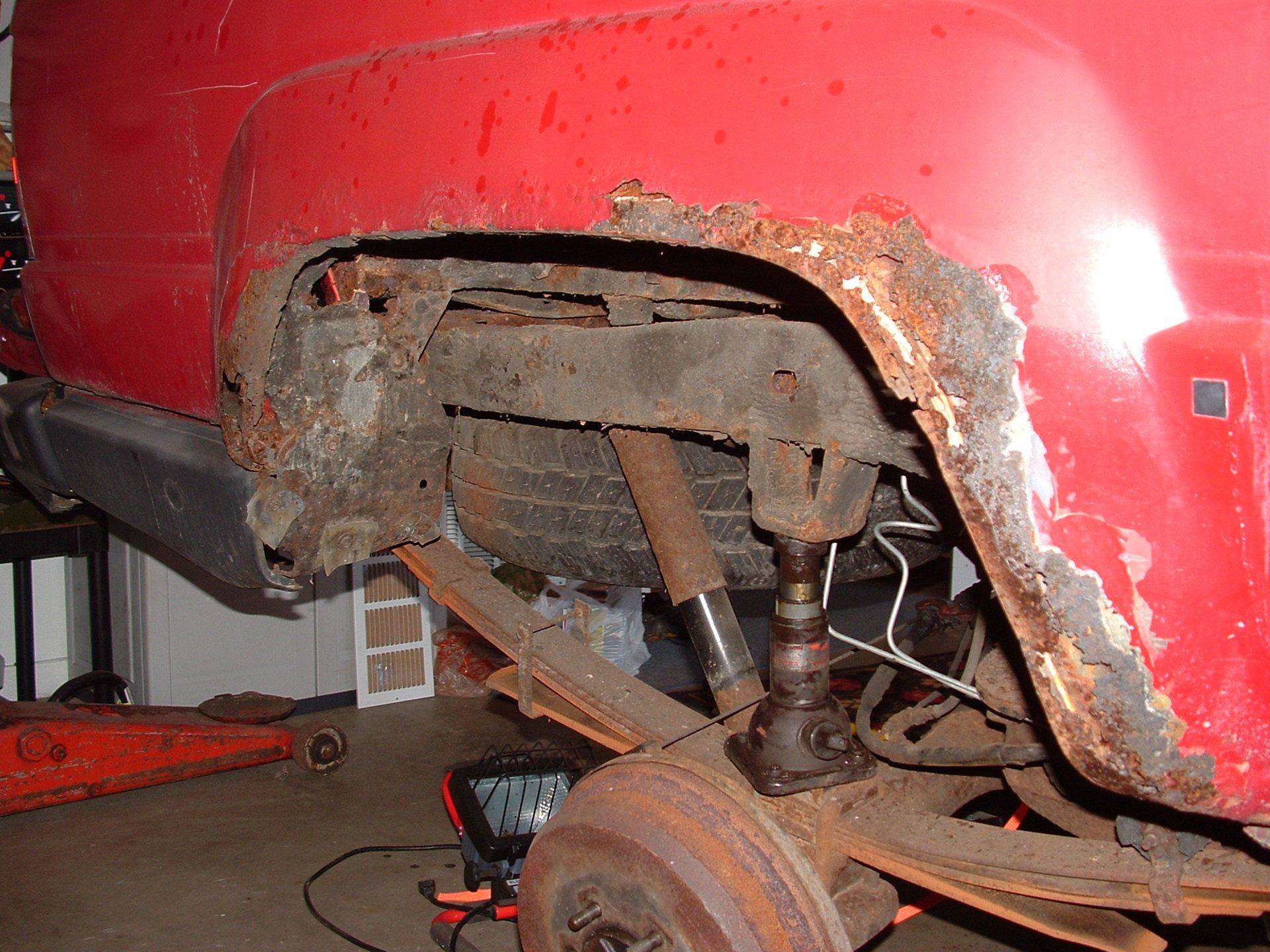

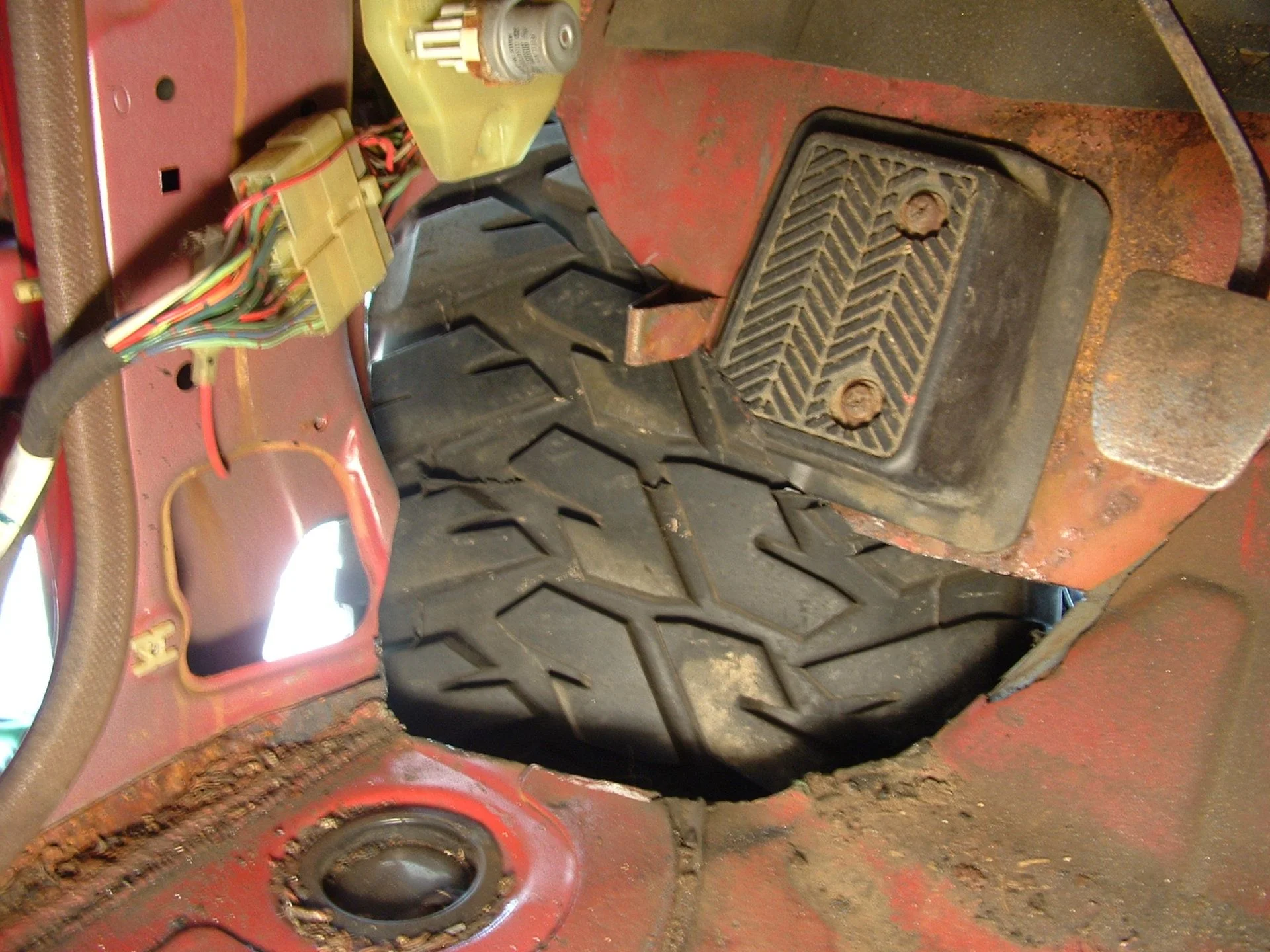

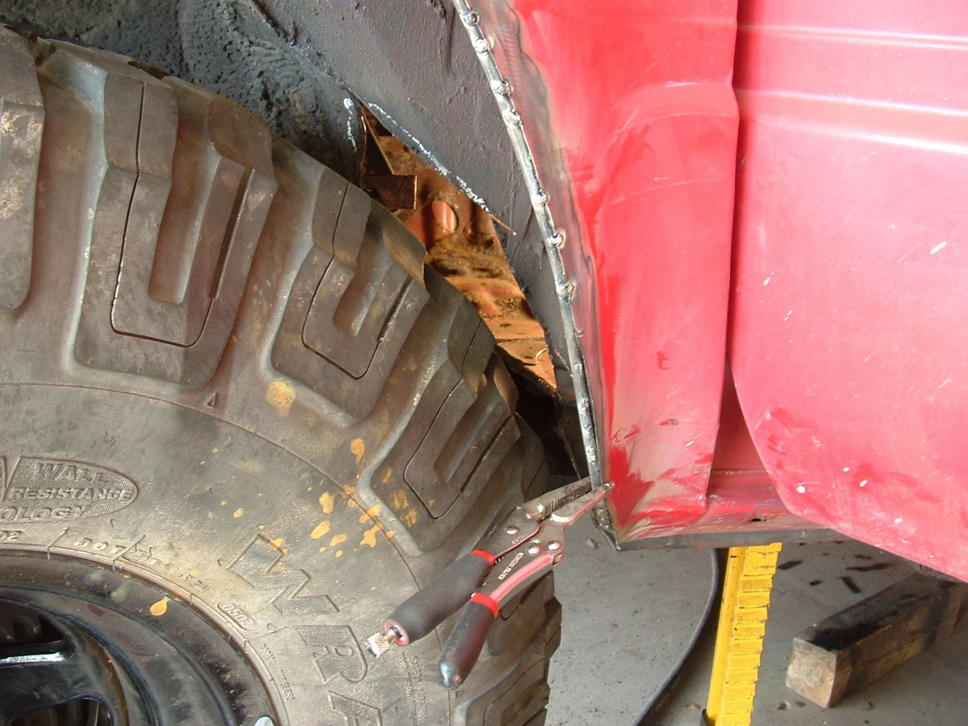

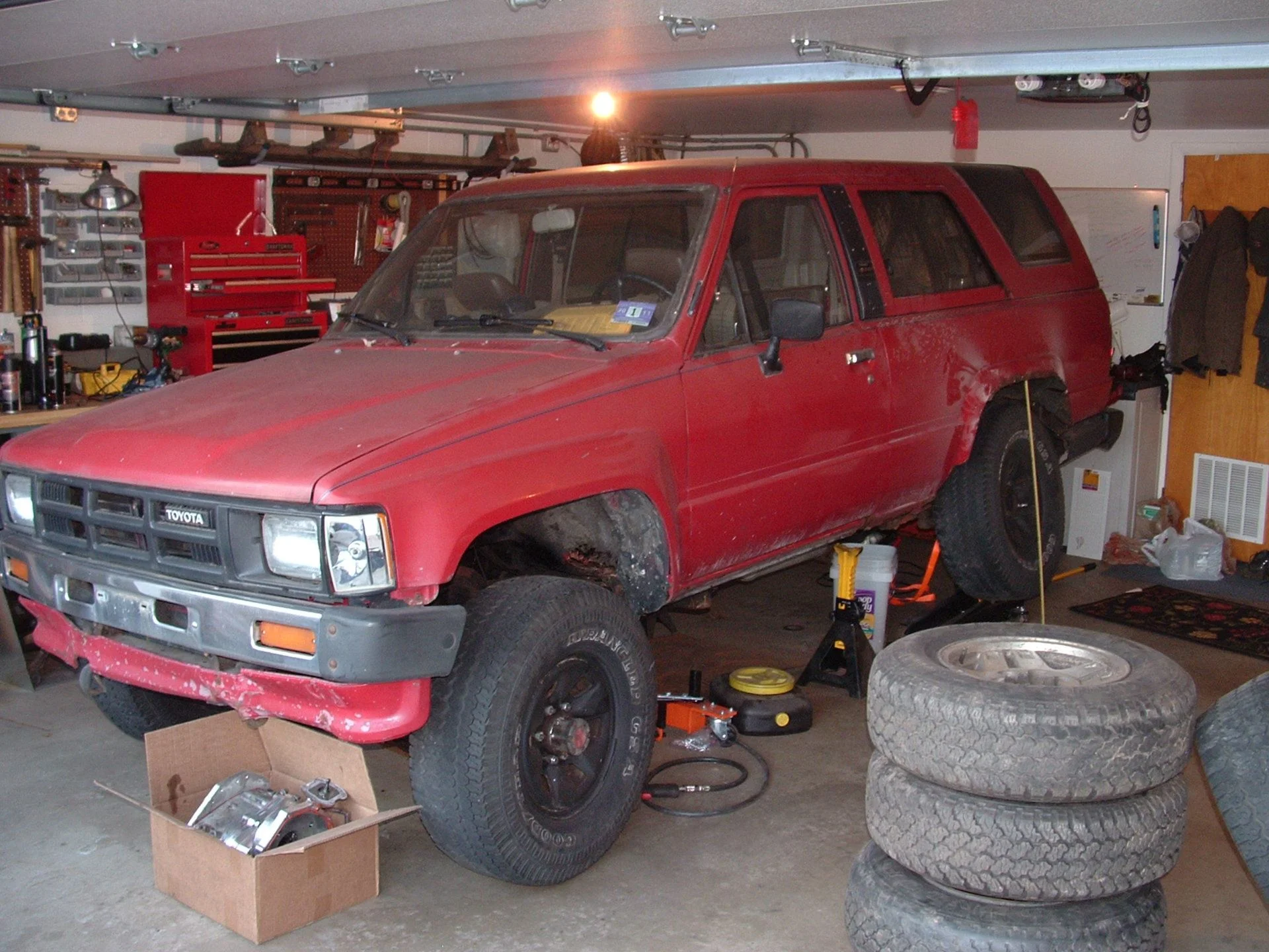

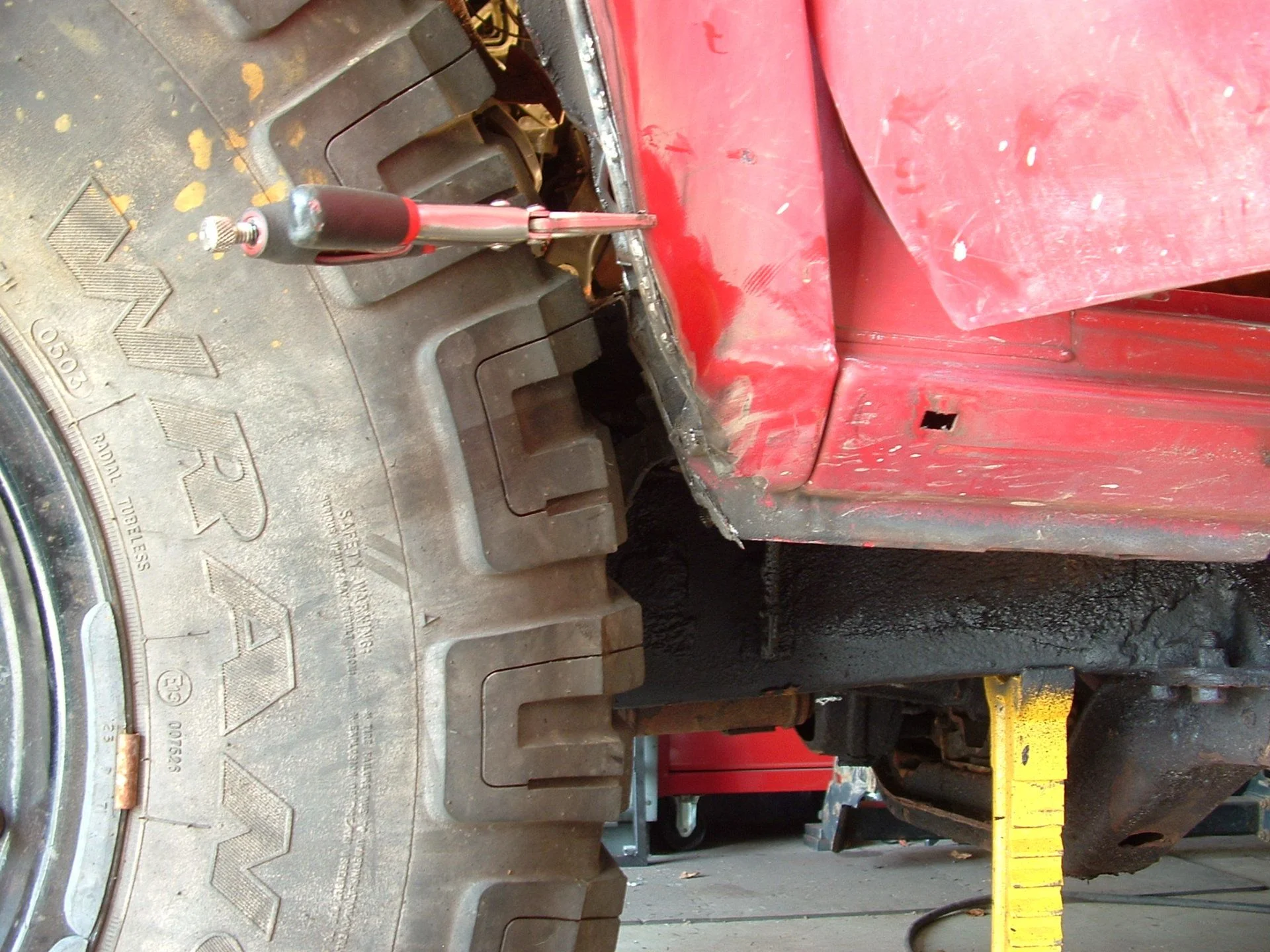

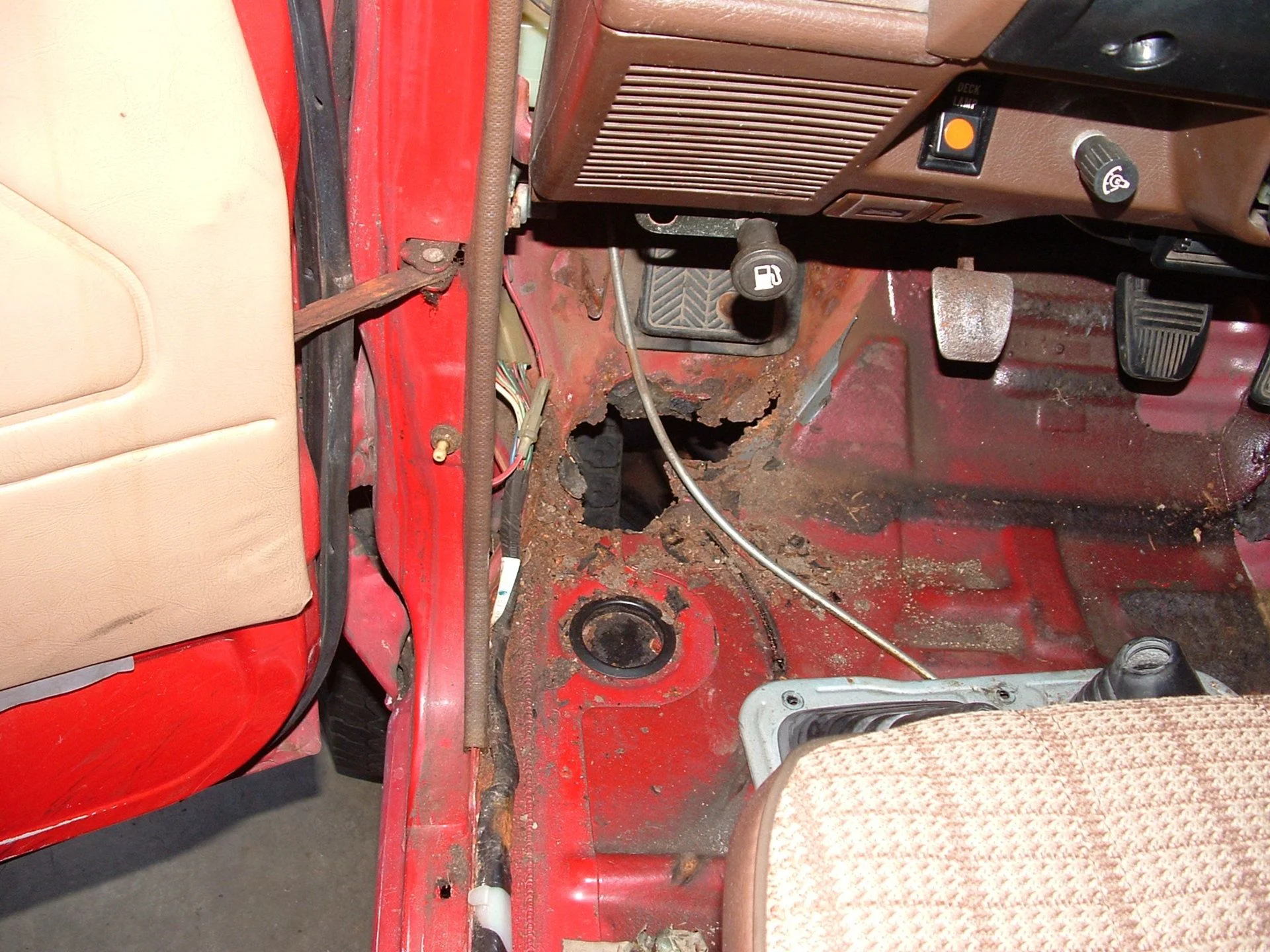

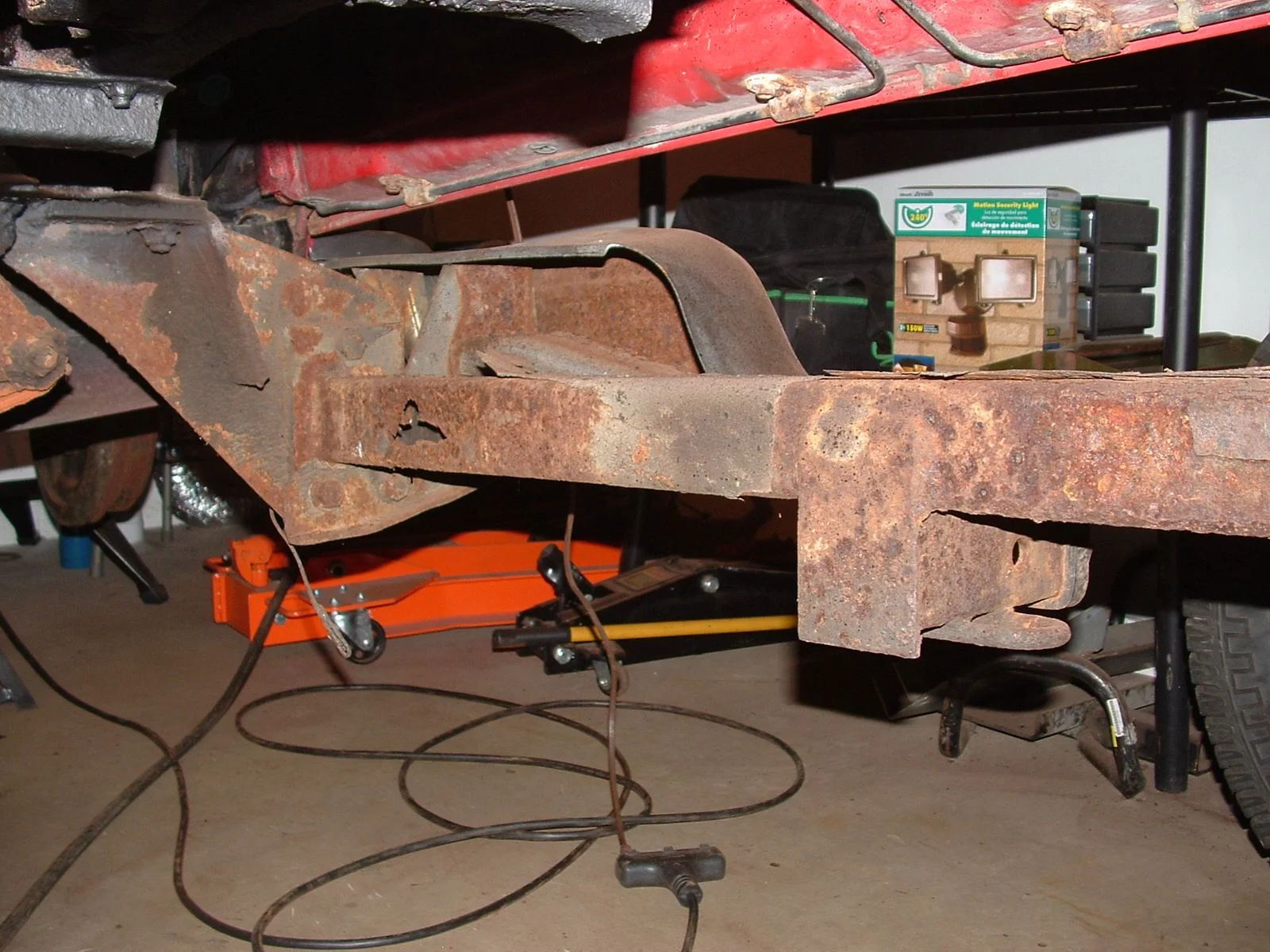

I had to move it inside fast. I came home from work like 3 days after I got it and found a big orange sticker on the windshield calling it abandon and saying I had 10 days or it would be towed. I knew I couldnt put it in the street with no inspection or insurance but it was in my driveway! It had alot of rust that I intended to remove for tire clearance. I borrowed a 35 from @jtaco1 for mock up and cut to stuff 37's with no lift. I took 3" out of the rear fenders all the way around and a bunch from the firewall.

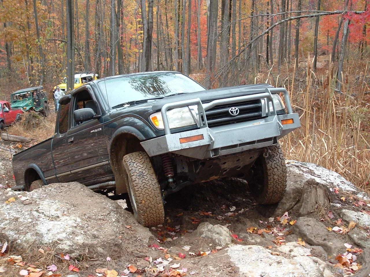

So, some of you have known me for a while. @jtaco1 @shmukster @YotaFun @surfishjoe @crawyota Will remember I had a early tacoma before the 4runner. In fact that is why I have the 4runner. It was one of the buyback trucks with the swiss cheese frames. Mine was a 98 extra cab. I had built it over 5 years to have a 2.5" lift sliders, bumpers, skidplates, crawlbox, rear locker, and a m8000 warn winch.
As part of the buy back we received 1.5 times kbb retail value in excelent condition. Regardless of actual condition. We were also aloud to remove any aftermarket assocries we had put on the truck. It simply needed to be able to move under its own power. Any of us that had them bought back ran with this. When I turned it in I had to have it towed to the dealership. I removed the rear axle, lift, rear shocks, bumpers, tail lights, front diff and drive shaft, I removed the CV axles and manual hubs too. The air box even got sold to a guy in CA. The 4runners wheels and tires got put on it and they hit the brake calipers as it they went around. It was accepted in this condition and I got to sell off the parts and reuse some of the others. All in all I drove the truck for 5-6 years and put 45k on it for the low price of $500 and if you factor in the parts I pulled I made $ on the deal.
