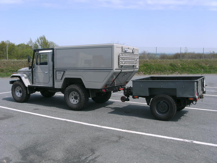

NATO tow hook ??
NATO hooks with tow ball...
