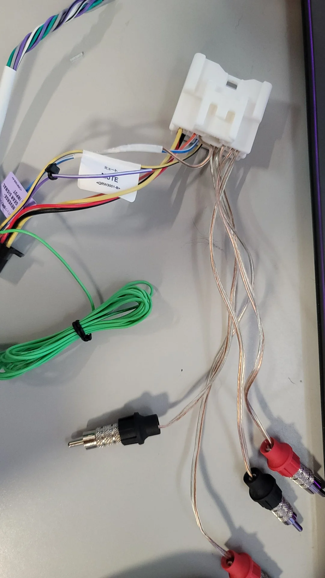

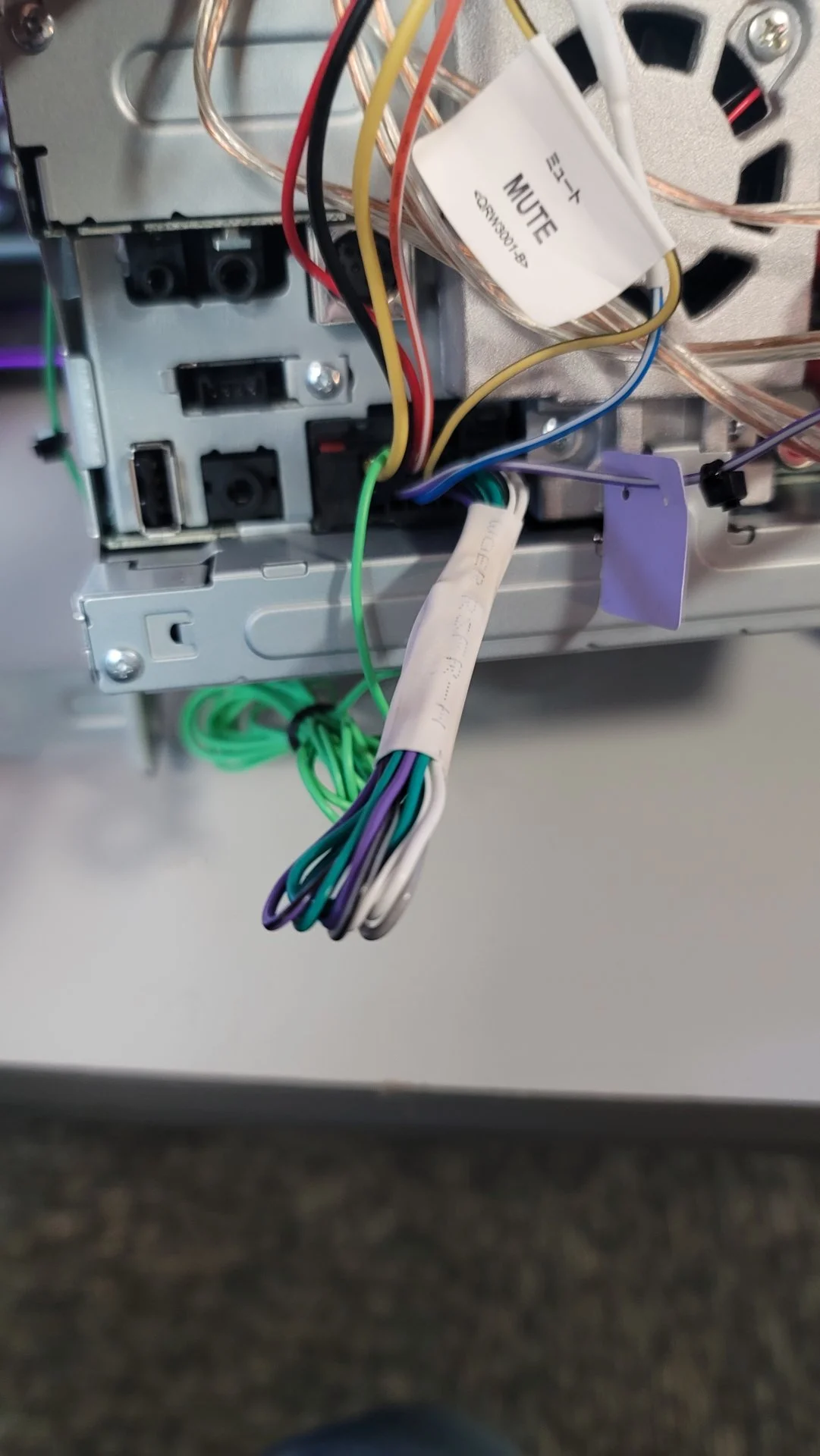

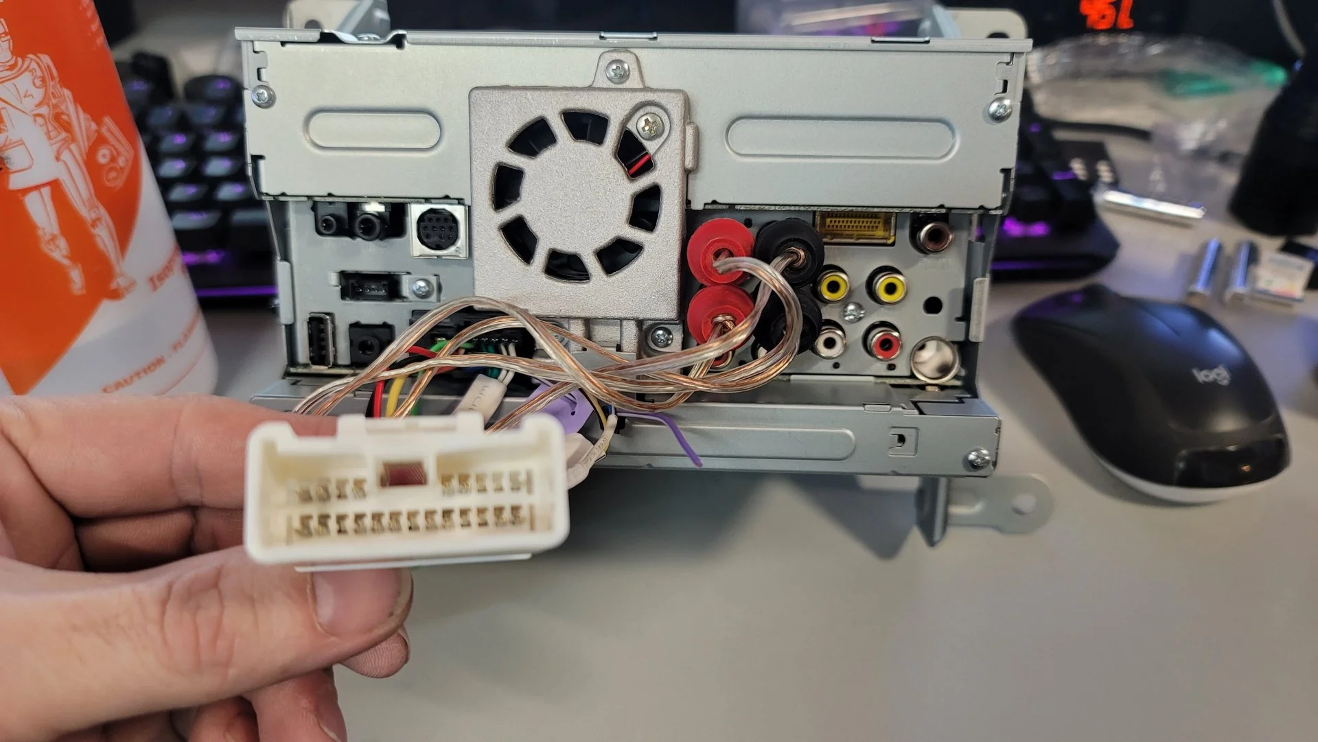

Spent some time wiring stuff the other day. Here's what I've learned. Pioneer decks don't fit great unless you use RCAs with very short shielding on the head (I used some old quick change RCAs that stick out rather far and had a hard time getting the HU in far enough to full seat. my HU had a mute wire, and the LX shows a mute wire at position 15, while testing I did not have it connected and was getting a slight hum and some random pops from the speakers. After wiring up the two mute wires, the hum went away and the sound quality was much cleaner. I couldn't find anything on the "Beep" wire or what it's intended use is, so I left it alone. The HU is amplified and I wanted to use the LX amp since it has a driver for the sub and there is not a good bypass for the amp without doing a lot more wiring than I have time for right now. This being the case, I opted for using the Line level (ish, they are still powered on my HU, but only very slightly. I think this was causing the hum that the mute fixed). The plug from Corsa worked perfect and was fairly easy to get set up. I highly recommend using high quality automotive crimpers if you can, as it will make getting the crimped wires in the plug easier. I moved recently and haven't finished setting up my shop area so I was stuck with some general electrical crimpers and they worked, but I have a lot of years of experience using the wrong tool... The trim on the LX was very easy to remove and a basic trim removal tool works just fine, I haven't hooked up cameras yet, waiting on them to come in, but I'll add some details when I get to that stage. I ran my mic to the same spot pretty much everyone else has and did a parking brake bypass because I hate the way Pioneer locks even basic settings down. I'll run my reverse trigger when I do the camera, but I'm going to setup the camera to always be powered when the car is, this way I can switch to it at any time, rather than just when in reverse. I have loads of speaker wiring left over from my days in the audio world ( save everything, you never know when it'll come in handy) so I just used some wire of roughly the same gauge for the RCAs. It's not by any means my finest work, but it'll do for now. Eventually I'll redo all of this with better quality wiring and add some additional features/components, but for now I just needed some tunes in the truck for daily use...

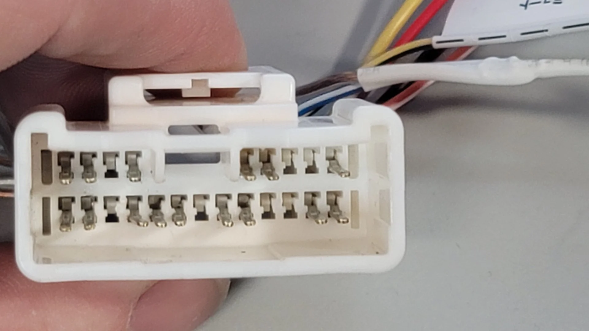

Well I have three connectors with enough leads to make two harnesses but I can't for the life of me figure out how to de-pin them. They are REALLY snug in there. I've de-pinned other toyota plugs before and I have a depinning tool but it's not working. Short term, I'll probably just cut up the plug to get the pins out. Longer term, finding a decent crimper seems to be the best way to go but I'm not spending hundreds of dollars on one!

I decided to go to the junk yard and found a few prius that had the correct male terminals. I de-pined it over the weekend. I'm going to solder connect them in and use the connecter mentioned earlier.

How did you depin them? I have some connectors as well but no luck depinning them. Do you have a special tool?
