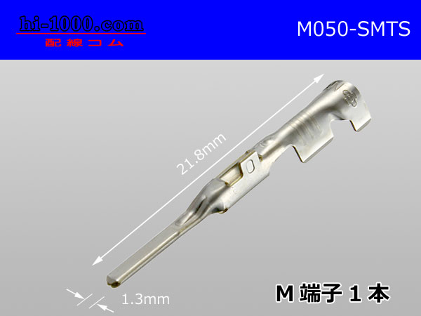

Excellent write up @PabloCruise!!! Thank you for providing the magical Toyota part numbers. Here is a link to a supplier of the male connectors ($0.20 each) in case anybody is interested:
That is excellent! That will save someone a lot of $ vs. buying the Toyota repair wire.
And you can use color coded wire!
Thank you!
