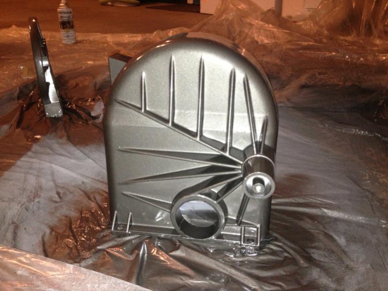

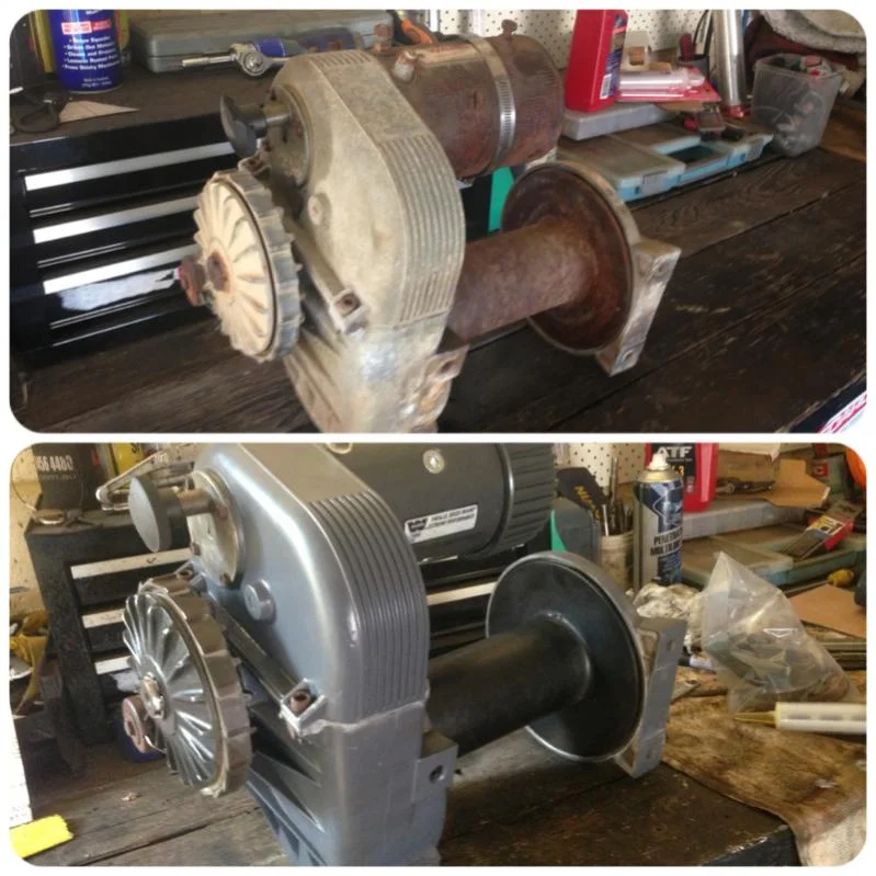

Can anyone confirm that this is powder coat and not paint? I'm about to restore a couple 8274s and absolutely love how this looks.
Looks like powder, but I think there is a rattle can product that is similar.
The solenoid cover is powder and I would guess the winch body is as well.
I showed that picture to my powder coat guy but he didn't have a close match. It looks like silver vein to me, but the silver vein he had on display looked different. I went with a gunmetal grey on this one, but I may try to paint my next 8274. Does anybody know the name is the paint that is supposed to be similar to this finish? I assume it is Rustolem Hammered Silver, but I wanted to check with yall first.
I really enjoy working on these winches. Can't wait to get some pics up when I finish this first one.

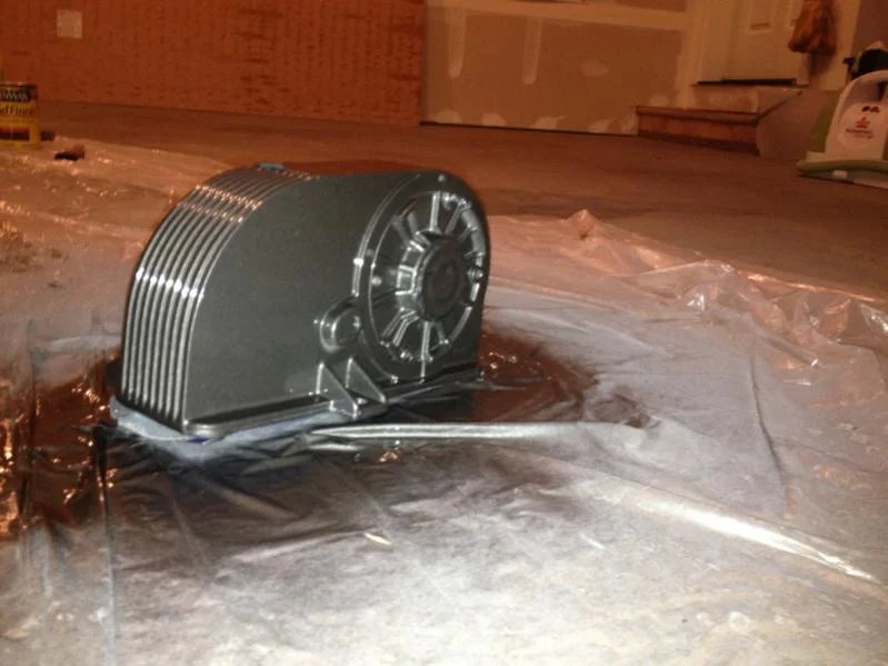

I just painted mine with rustoleum's Metallic Carcoal and standard Aluminum paints.
One coat primer and two coats paint. We shall see how durable it is. Didn't want to fork over the money for powder coat.

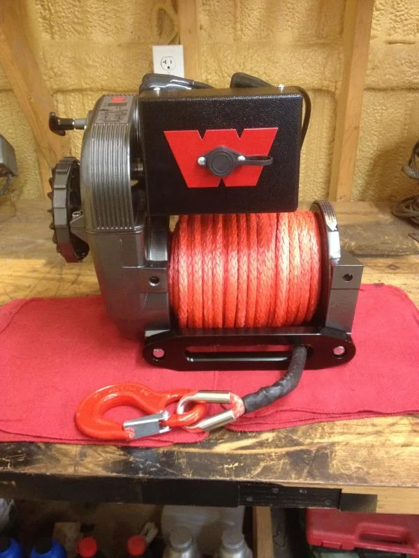

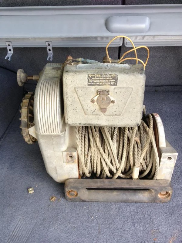

Thanks for the informative thread fellas , I'm looking forward to freshening up my 8274 that i scored for $150.
I opened the case up and it looks to be in very good shape too.:D

I ended up going with powder coat on mine. It looks great but made reassembly difficult at times where the powder coat guy didn't mask it exactly how I wanted. From the looks of the Rustoleum paint above, I will probably try that on my next one. I'll post pictures of my first one as soon as I complete it.
In your post (281), I believe that finish is not powder coating, but a Rust-Oleum paint product. They have a line of paints called 'hammered' and the grey product they offer looks just like that in the picture.
