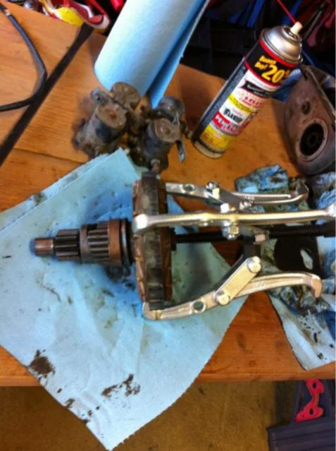

I just tore into another 8274 and found I have a rust issue. The clutch can't be removed since the pinion gear is rusted to the motor shaft. Also, the main gear is stuck on the drum splines. I have soaked all of it in PB Blaster for a few days to no avail. Any suggestions on getting this stuff free? Even if I can't use most of the parts due to pitting, I'd still like to be able to use the cases.
B-F-H
brass drift + bfh.
And/or a pulley puller.
You might be able to remove the motor and all electrics and cable. Go to kmart get a large plastic tub big enough to submerg it in molasses. I think this will work but will take a long time. Aluminum wont work with electrolysis. Contact toomanytoyz here on mud to find out what molasses to use. Beats a bfh

He's talking about separating the gears, not aluminum. They are strong. Hit them.
brass drift + bfh.
I'm not sure we are talking about the same thing. I have everything in the lower case removed except the main gear, which is stuck on the drum splines. I have soaked the parts in PB Blaster and driven wooden wedges between the case and the main gear, but it has not budged. There is no way to use a gear puller, since the gear is inside the case.
I may try Kroil.

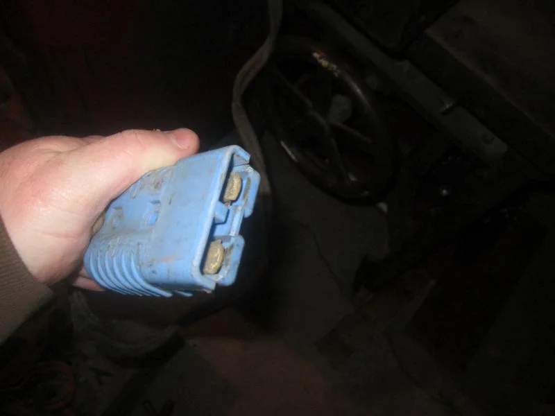

I just scored this one for $200 from a CL ad my father-in-law and I went to last weekend. The ad just said a bunch of tools with some random pics, so we took the ride since you could see a few hotrods in the background. I didn't see the winch until I went to the corner of the shop to grab a box to put some stuff in.
I bought it for $200 with NO warranty other than the sellers word that it works. Time will tell. My question is what kind of battery connection is this? Can I find the other end easily??

Nice score!! Yes, very common connection. Google "jumper cable connector"
or "anderson connector"
Try setting the unit on the end of the spool with the case sitting up. Spray kroil oil on it every 6 hours or so tapping it with a plastic mallet. It will take a long time. The other idea would be to try engine release out of canida. Fill the case up so the release covers the shaft stuf is not cheap though and it would have to soak a couple weeks. Need to figure how much you need to cover the shaft. That stuff made my pistons come loose after i removed the rod bearings.
I've pretty much given up on it at this point. Even if I got it all apart, the main gear would be rusted beyond the point of being usable. The upper housing is the same way. I'm going to chalk this one up as a loss.
On to the next rebuild.
