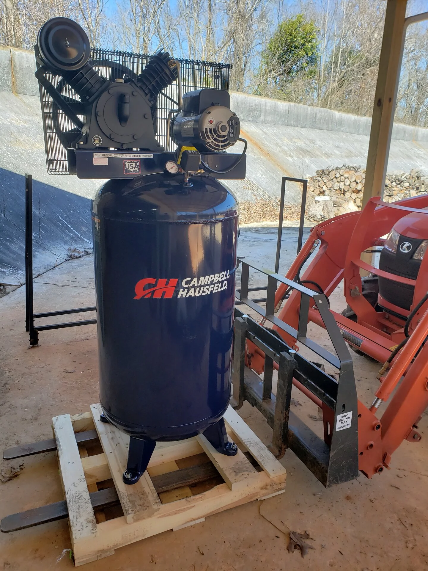

The compressor has arrived and is available for pickup!
Guess I know what I will be doing this fine rainy Friday afternoon.

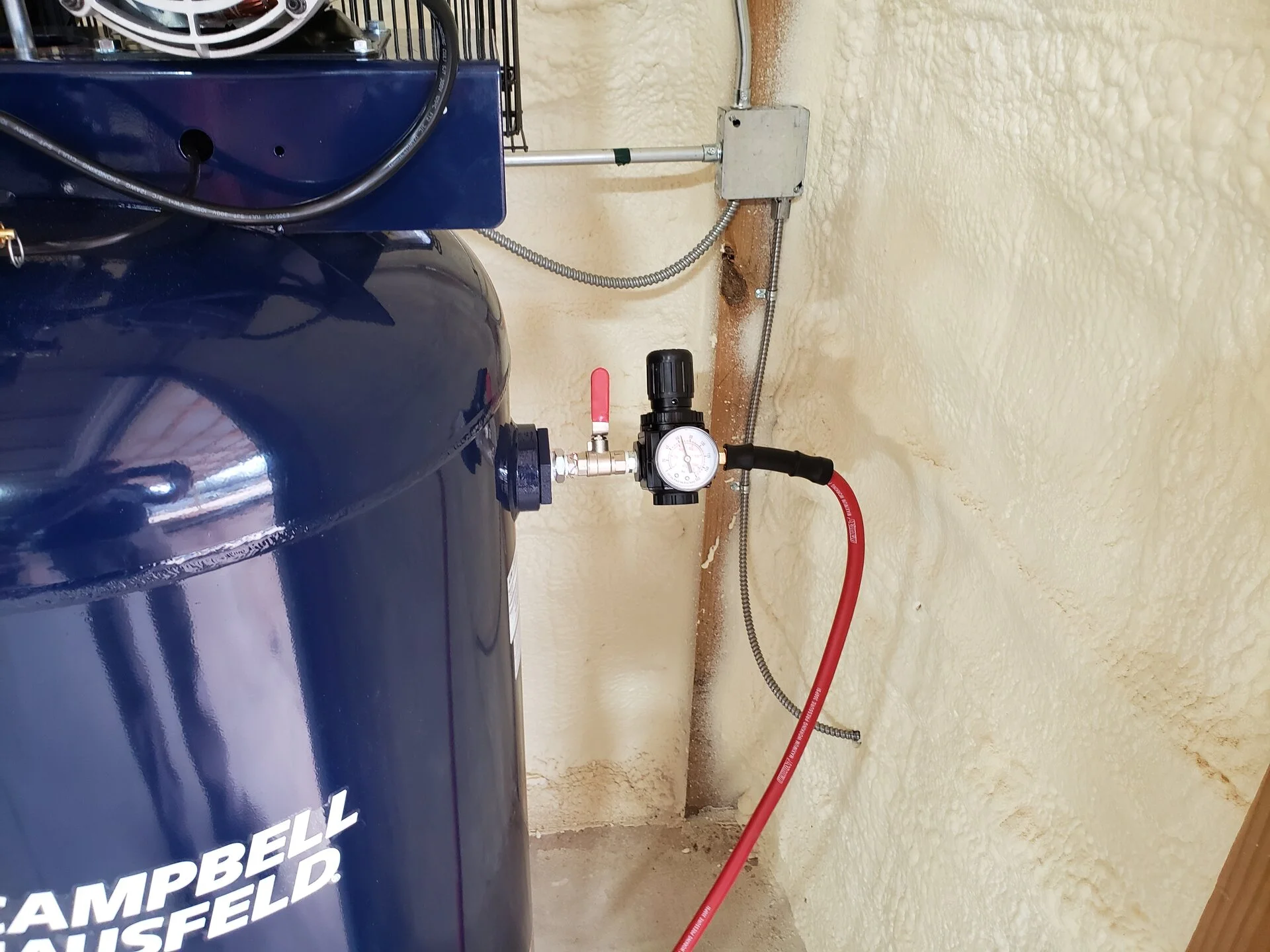

Wired in and filled. Did not properly plan so I do not have rhe right fitting to go to a ¹/4 hose disconnect.
Also, the compressor has no integrated on/off switch. I think because it is a commercial model. I may add one. It is nice to know it is off and will not run if there is a leak somewhere. Right now I will just flick the breaker.
It was fun to get it set up. A Mudder came over to lend and hand and make fun of the process.
Commercial compressor will use an external mounted contactor box with circuit breaker/heaters. These are turned on and off by opening the circuit between the pressure switch and the contactor control coil with a switch.
If your compressor is setup where the pressure switch takes the full motor load through it's contacts, but it does not have a manual off lever on the pressure switch, you could add an appropriately sized 2 pole switch before or after the pressure switch. Or you could add an external contactor in an external J-box with a switch like a commercial compressor.

I could just add one of these or similar.
I could also switch out the pressure switch for one with an on/off switch but that would not be ideal since the one that came with the compressor is matched to the compressor's performance.
The similar compressor that is less expensive because is does not have the "commercial motor" and appears to have a less resilient pump does have a manual switch on the pressure switch.

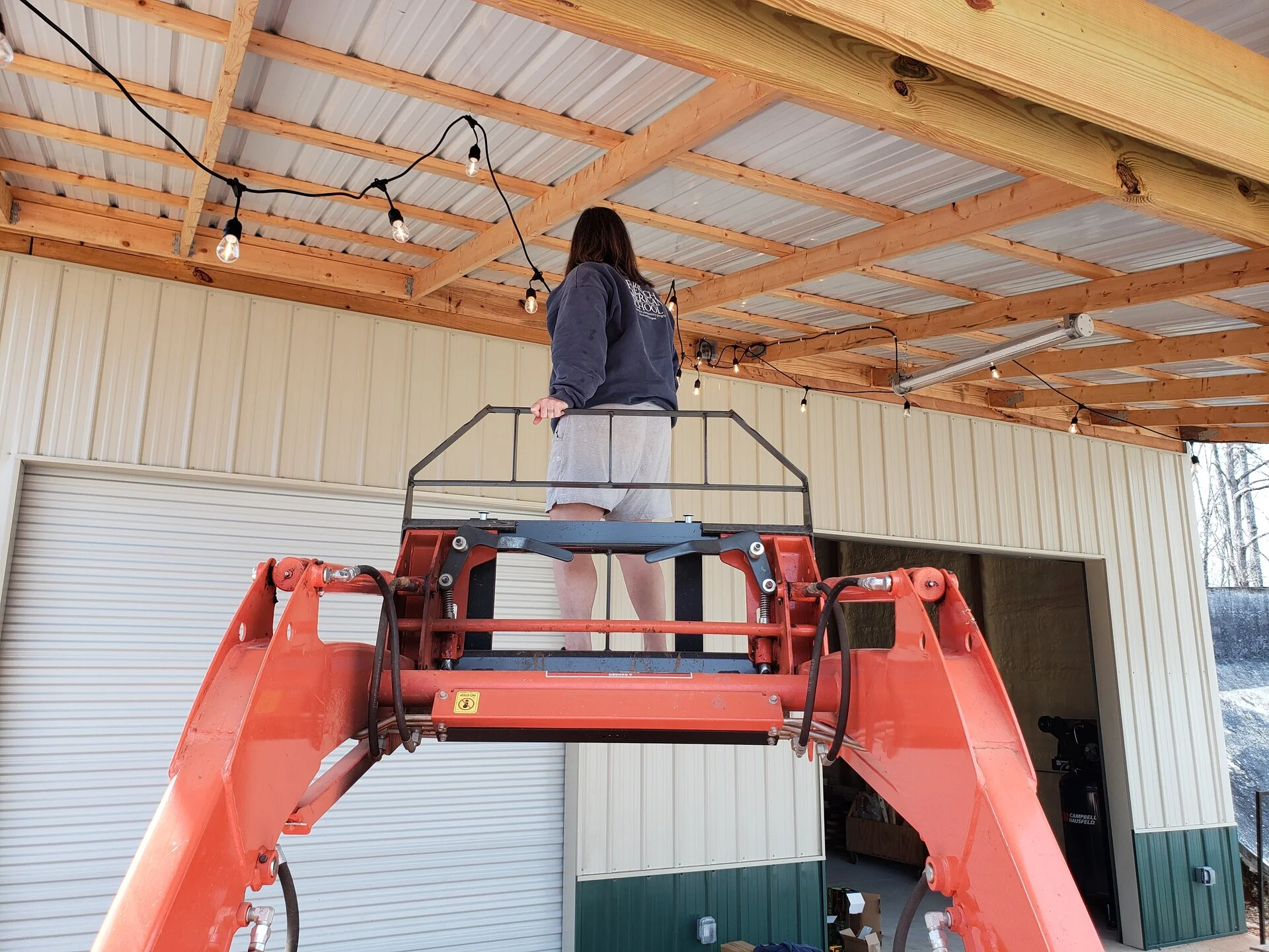

We hung a big led under the leanto today. Got it for free from a friend. It is a big sealed tube. He used to sell them commercially. When he retired he had a bunch of samples left and gave them away.
Then put some gutter guards on. That was a huge pita. Far easier to put on with an asphalt roof. Still have one long run to do - not sure when I will get to that. It takes two of us to do that project.
Also got 48 feet of LED string lights for under the leanto for mood lighting in the res. We will get thos up tomorrow and I will post pics of both.
