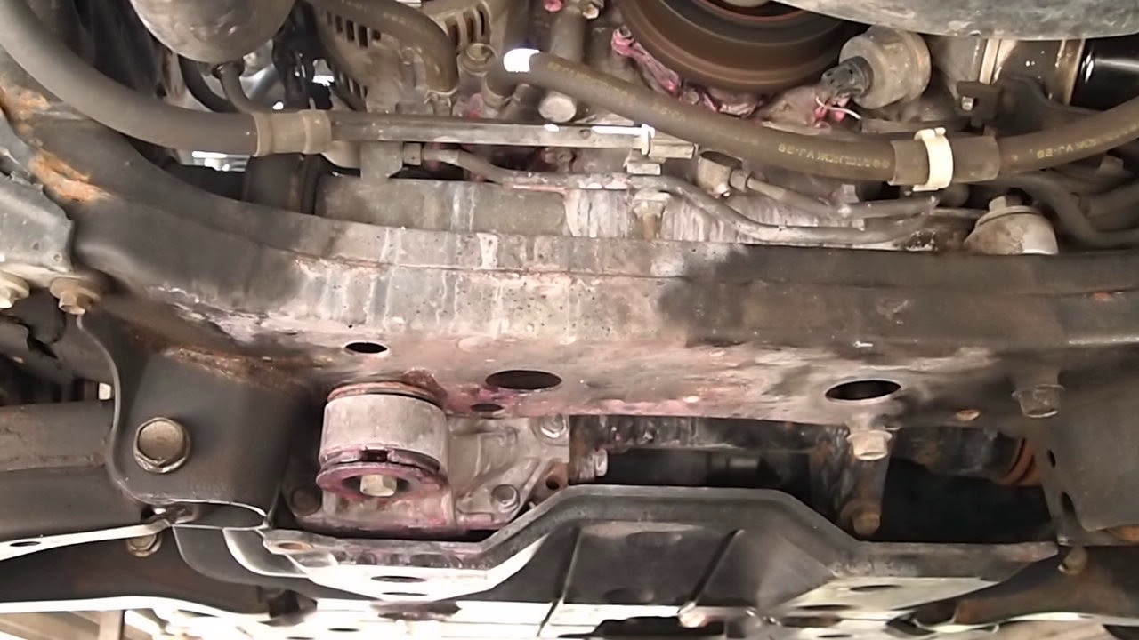

Key, when doing ZPC (in ABS tab). Vehicle level, wheels straight & steering wheel dead on. No one or cargo in vehicle, door close, full tank of gas, tire pressure set. Dead on straight & level, is hard part for me. So best done, while on alignment rack.
To check your rack, look at the rack while someone turns the wheel (with the truck on). The rack should not move much at all. If you see the rack moving before the tires, the bushings are shot.
Some R&P mounting bushings, we've no doubt they're shot. They're be very little rubber remaining. We'll see rack housing lift off the frame, when wheels turned.
Poly bushing won't move much if at all. They're near indsurtable.
OEM rubber bush are designed to move side to side.
Better indicators
03-07: How much bushing outer cup has turn.
98-07: Condition of rubber. Does rubber lift and separate, when wheel turned. Does vehicle wonder on HWY, even when TRE, alignment, ball joint good and wheel bearing tight.
New OEM R&P normal movement:
Viewing rubber bushings, as steering wheel turned side to side. Can be very revealing. By watching for rubber separation and rack housing lifting.
These we see cracking in aged rubber, as nears end of useable life.
This R&P moves excessively and without bushing resistance.

New rack solved it for me. Was due at 330k. What's your mileage? Swapped to poly bushings while I was at it.

This came about for me after installing poly rack bushings. Removing the front sway bar was negatively helpful, of course.
So you swapped in poly bushings and removed the front sway bar and this started?
