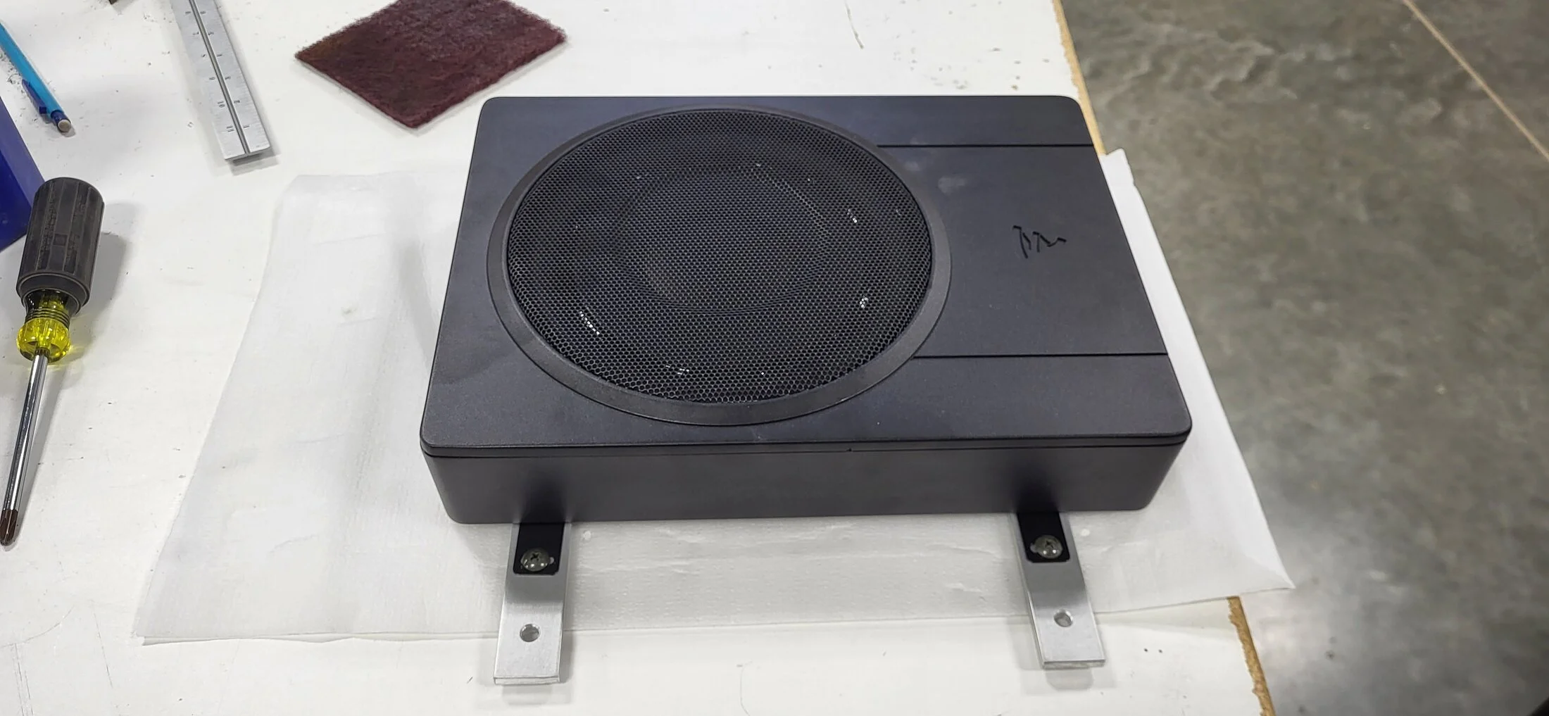

Stereo upgrade.
Bought a little Focal powered subwoofer to go under the driver's seat.
I didn't get many pictures.... sorry. It was hotter than Satan's dick in the shop, and I just wanted it done.

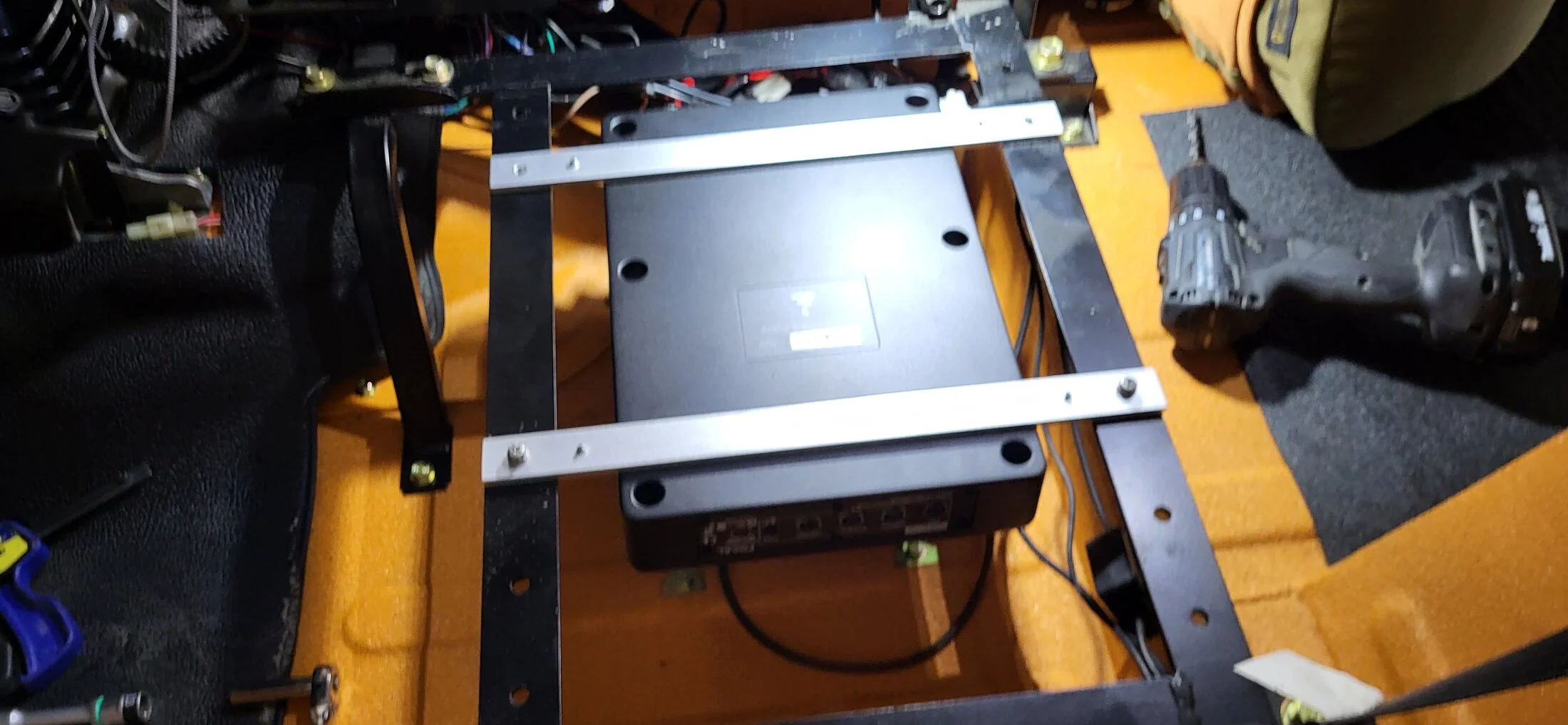

Used some ¼"x1" aluminum bar to saddle it between the frame rails in the seat bracket.
Poked a few more holes in the seat bracket, and voila, mounted.
It doesn't need a ton of juice. I just used a 8ga wire, (with a 30a fuse at the battery), to power it. Ground i just dropped straight down to the floor where I've got a few other things grounded.

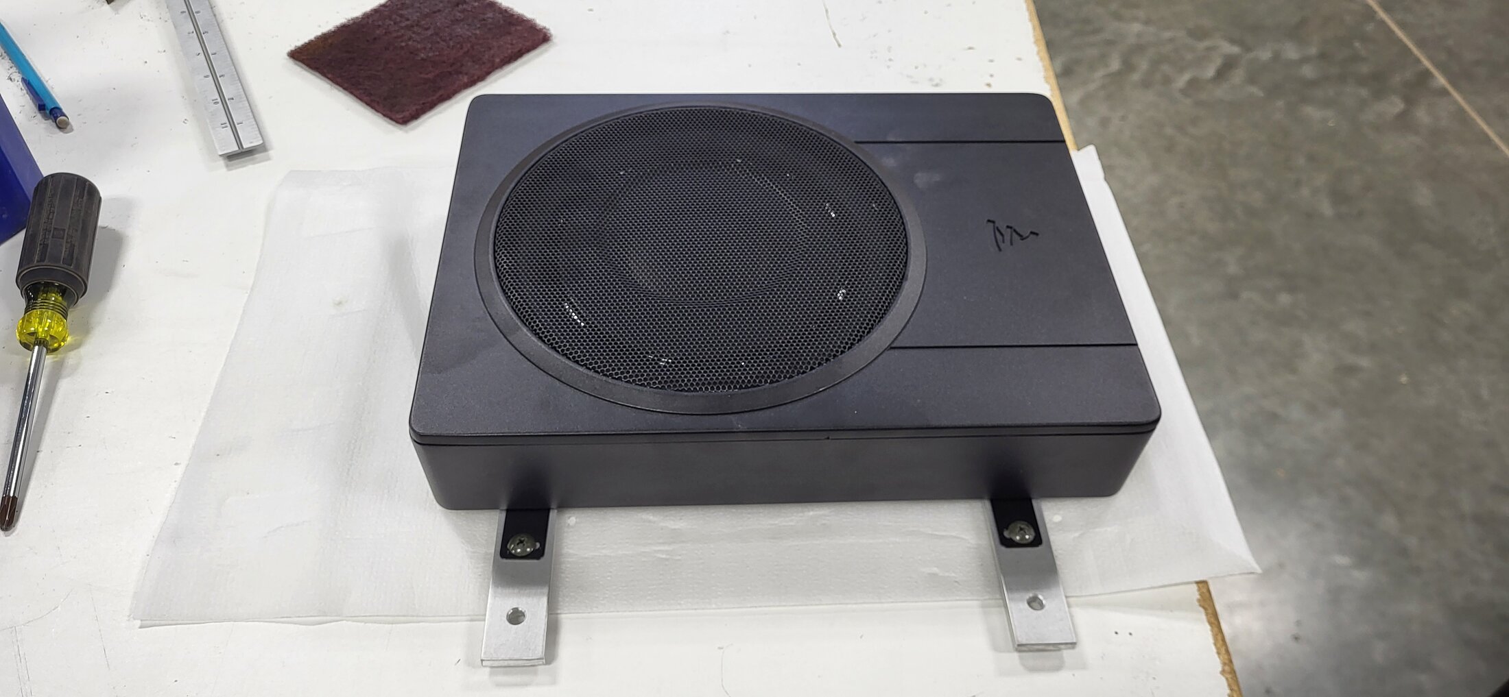

Stereo upgrade.

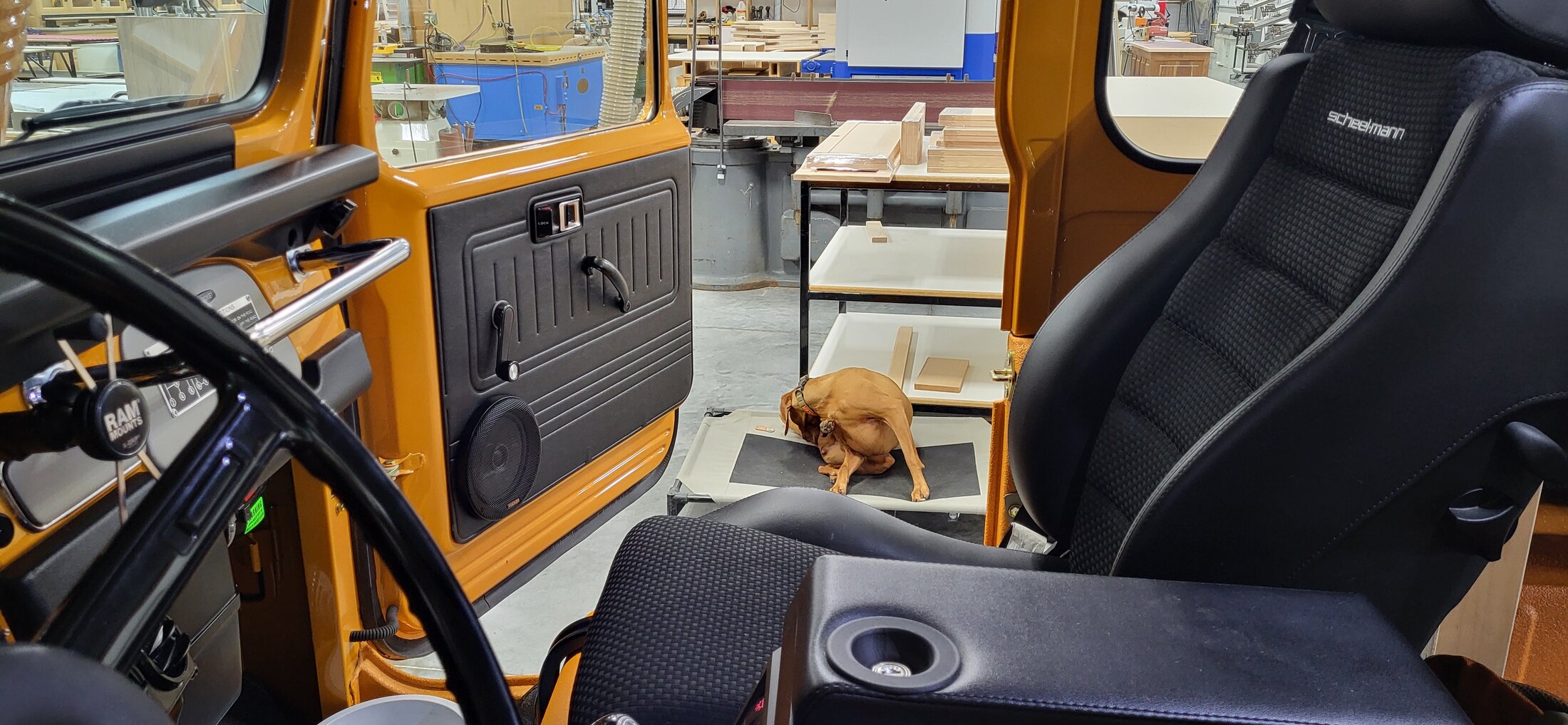

Tinker, as per usual, being super helpful licking her own ass.
