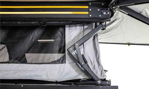

Here is how patriot campers does their awning lifts. How much extra height are you trying to get?
That could be accuated with a screw too. Pulling both sides in.
That in turn will be a sloppy, finger removing nightmare until I'm the up or down position. Which kinda makes it fun. 😆

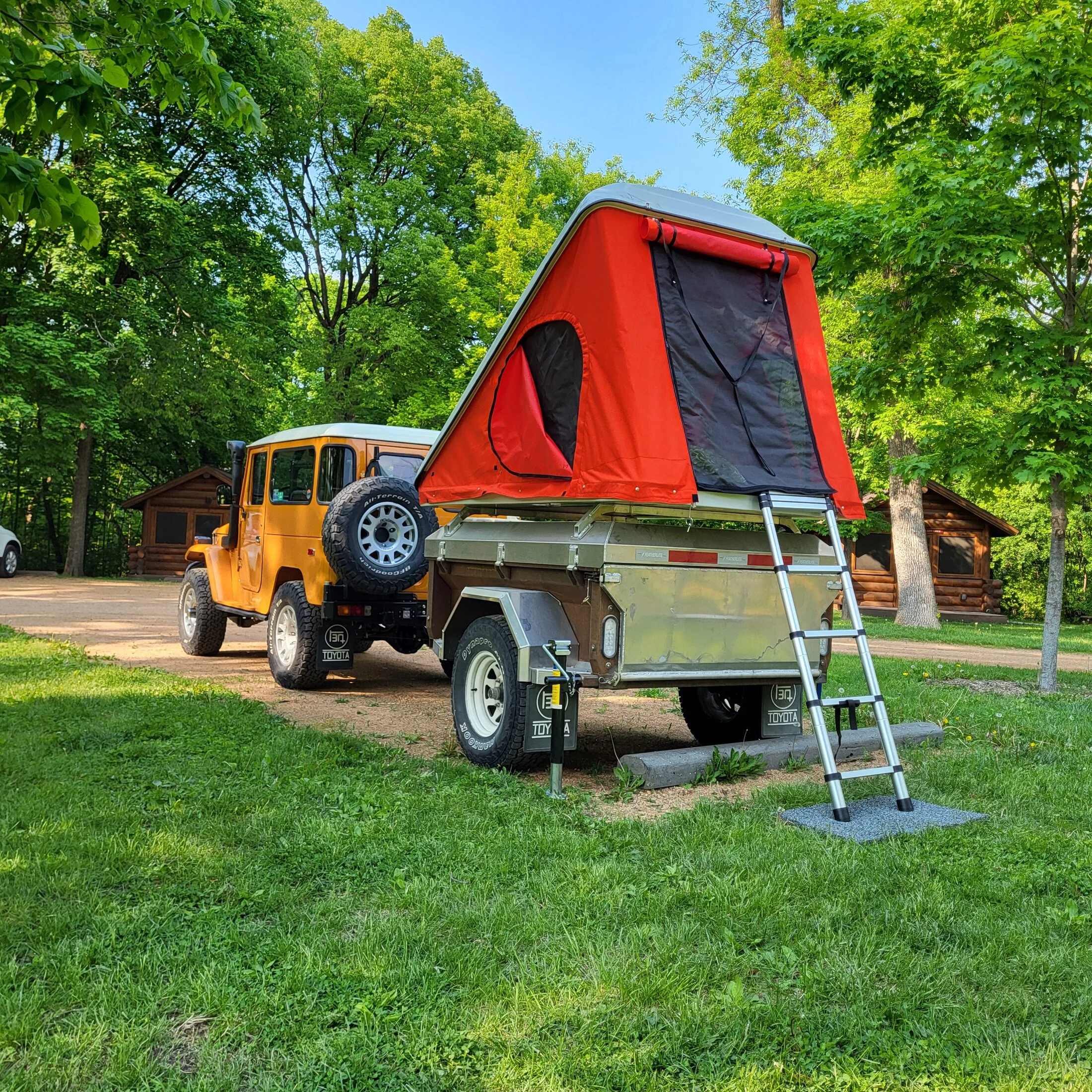

Correct. I want to put it on the little camping trailer long term.
But low when not in use, so it doesn't snag every freaking thing on the way by. Or beat itself to slowly to death while going down the road
Reading is hard. I see you said trailer now.

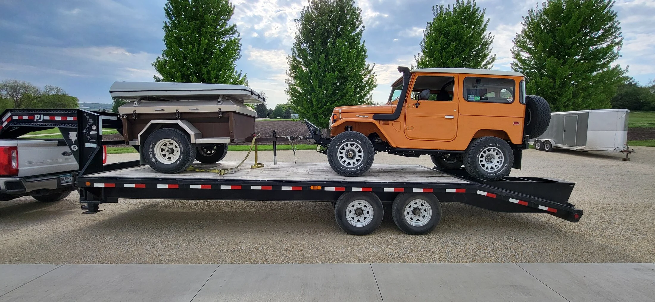

Best i can do for trailer pictures at the moment....
It's kinda wedged in my garage at the moment.
