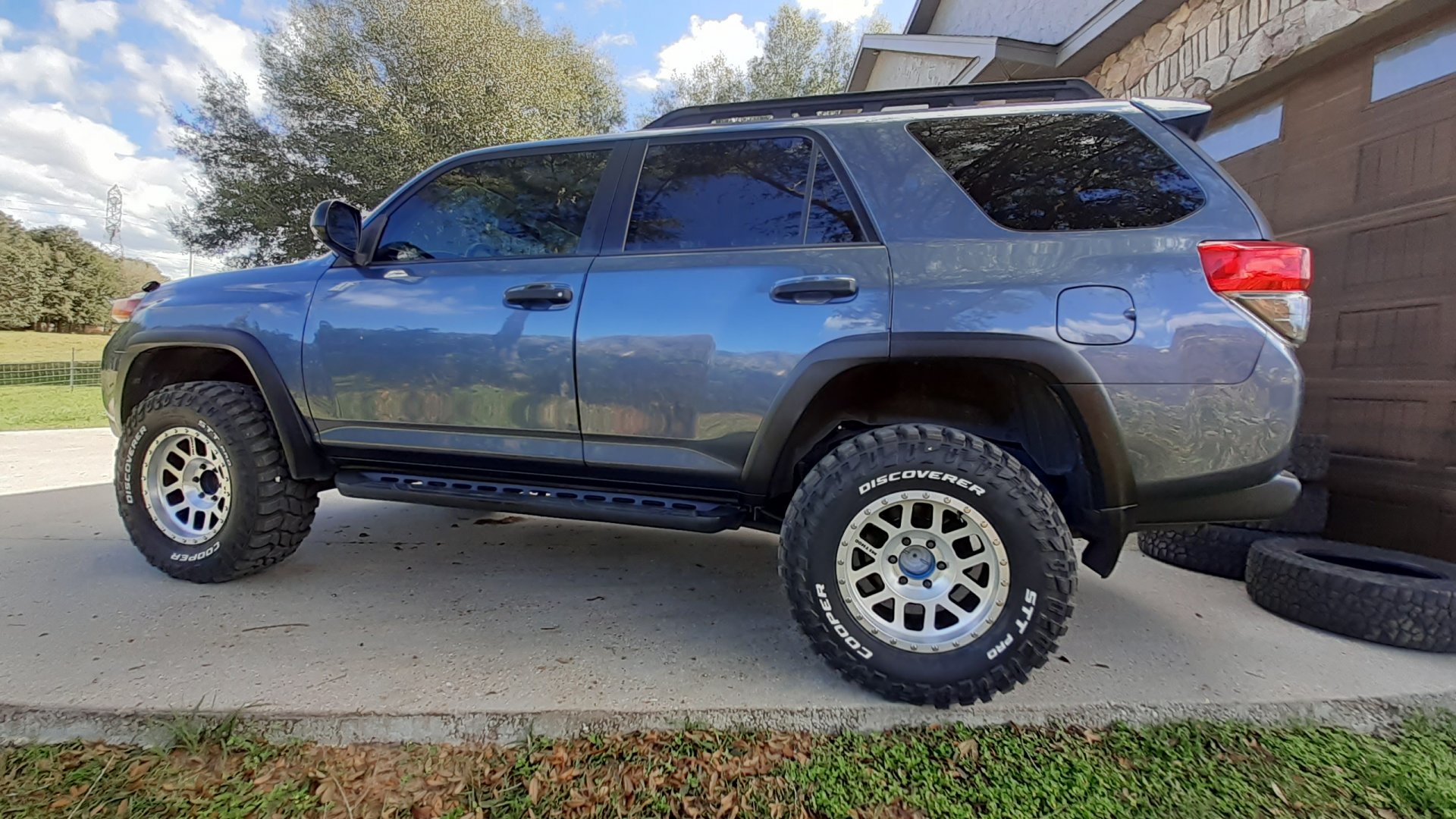

As for the methods I'm a fan as I run them on my 4runner, however I cant say the finish on the machine color has held up very well.

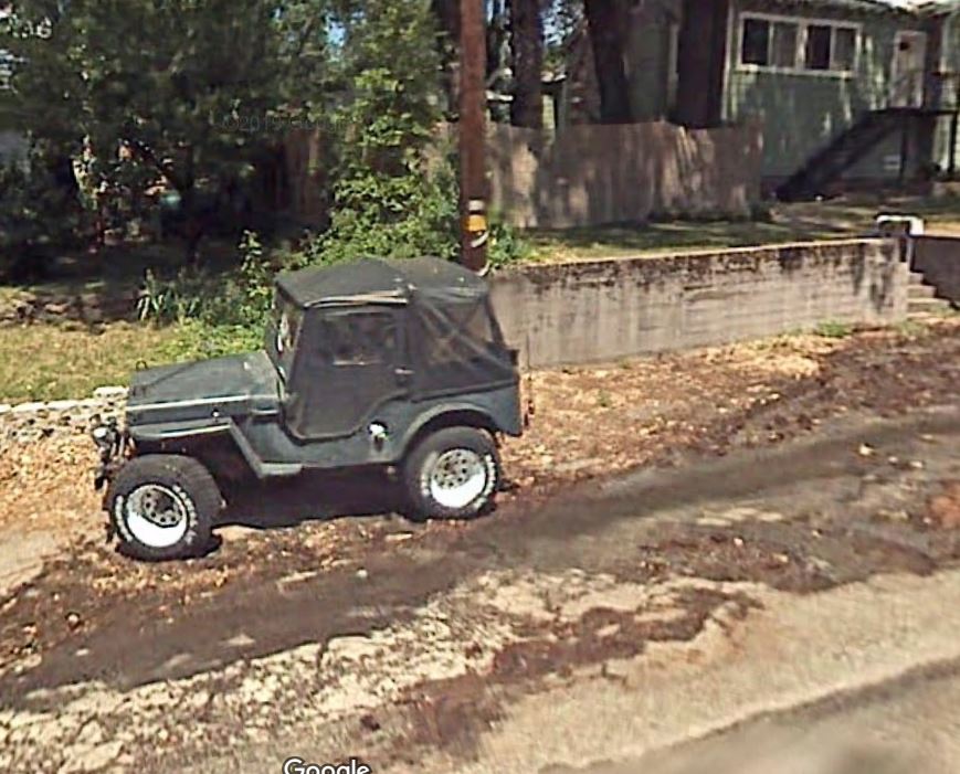

If I knew anything about chemical stripping paint, I'd go exhibitionist / steak with a 40, proudly showing the spotwelds, rust, manufacture tooling stresses, bad bondo, etc. Until then, I have black and white camera settings, and rust.
Boeshield it, then use the foam sponge that comes with a can of Mequires auto paint wax, after it turns chalky looking, about a week or two later. I personally spend zero time on rust and dirt/oxidation removal, from this point forward, I'm over that already. You can also use straight paraffin wax on a super hot day, or on parts that won't matter if they get exposed to a tiny bit of propane from a soldering torch. Just paint the rear flares, and the steel spokes, probably a primer grey (flat or gloss) and it will look great.
Or, paint it. Pollux, whatever. I got really close to buying a 40 in flat grey primer, I like that look too.
