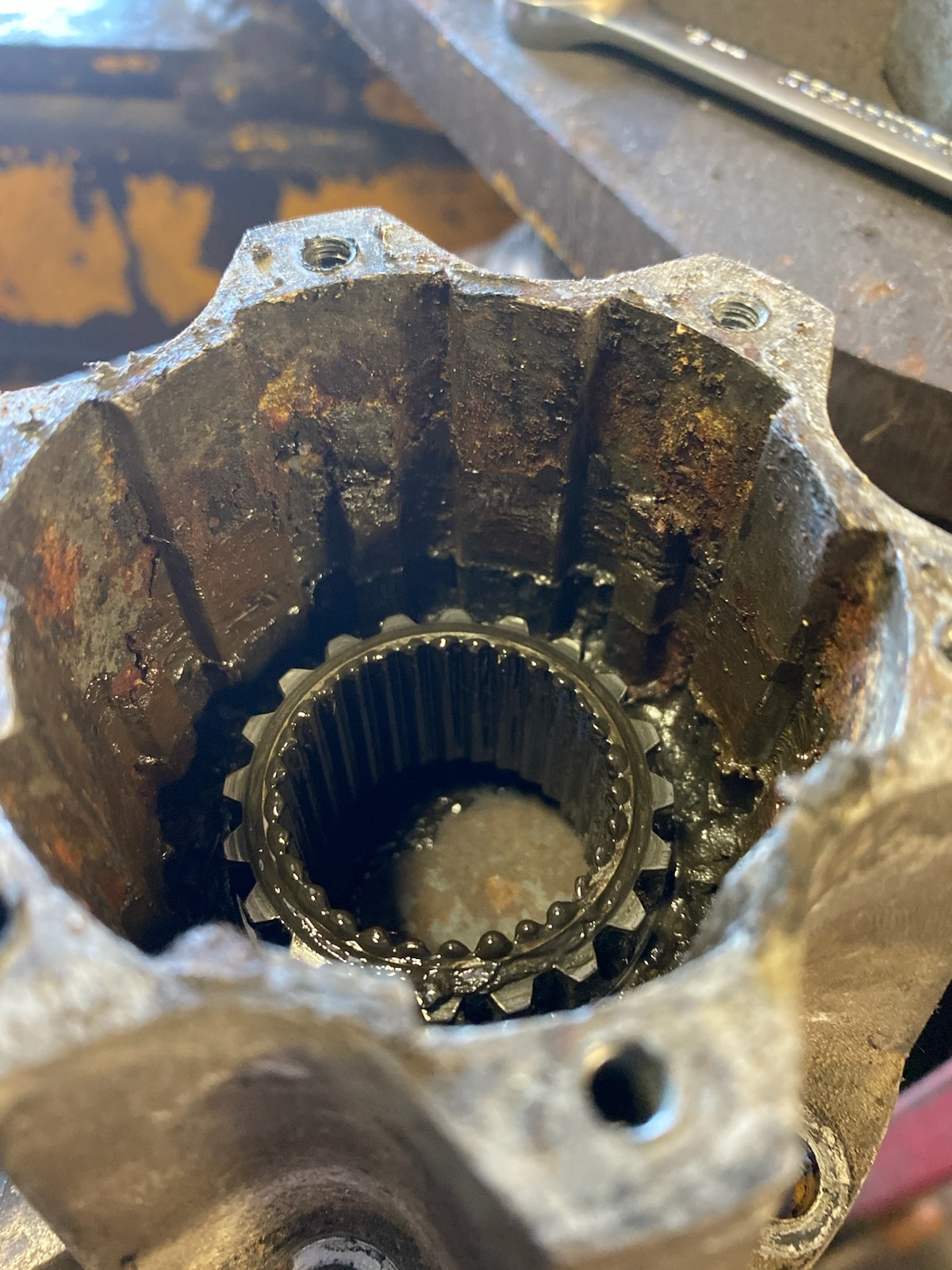

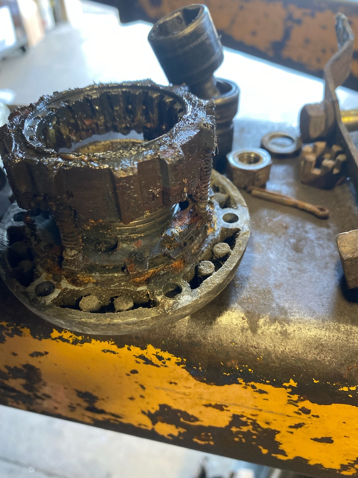

My buddy works for the shop I took it to, and he'll be relaying pictures of the carnage. He said the front wheel bearings are likely original, and pretty gross. The hubs are plenty gross. I've got new Warn lockouts on the way. Should've been here earlier this week, but something got discombobulated, and I should have them Friday.

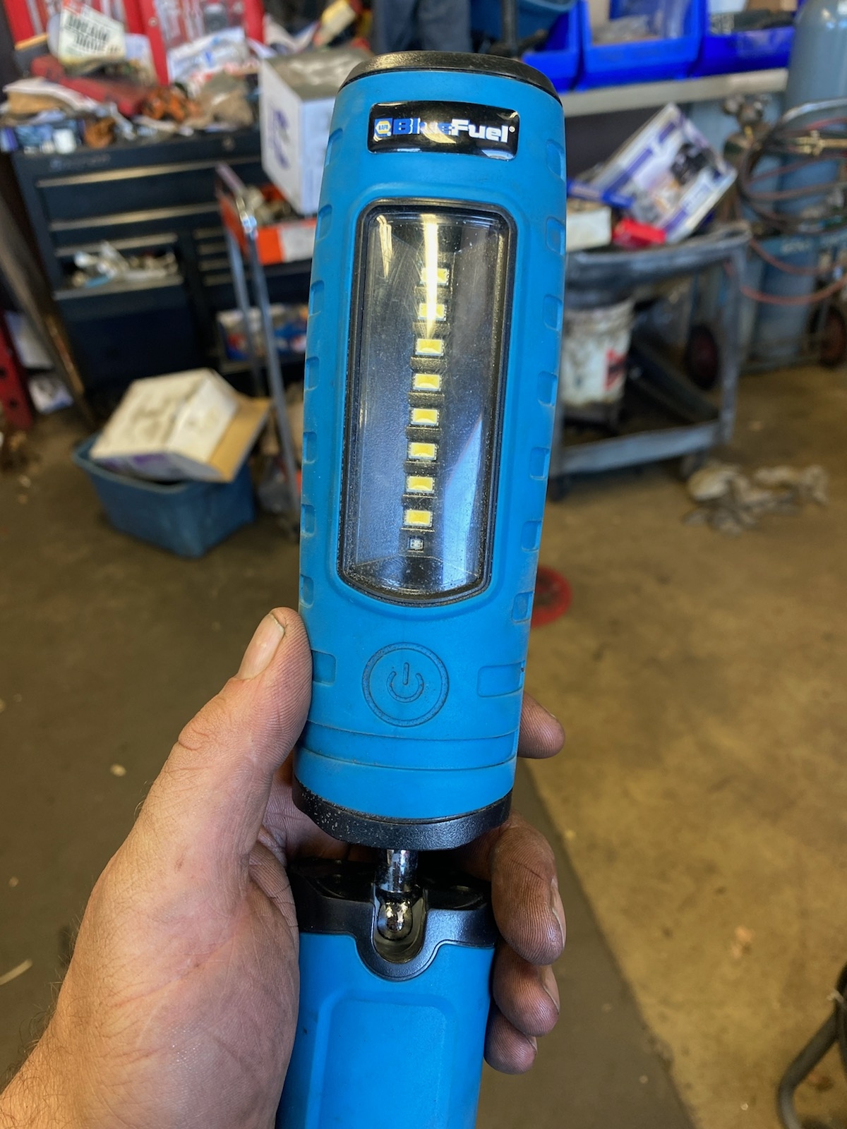

My trouble light was stuck to the bottom of the body and managed to survive the 40 mile trek on the trailer. Better to be lucky than good I guess. One of these days the Gods are going to smite my in ancient fashion. It's actually clean because I just wiped the whole thing down with contact cleaner. It was basically black from shoving the tranny back in.
