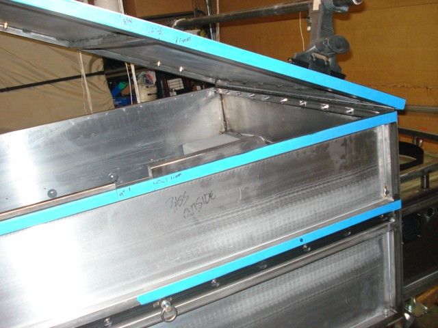

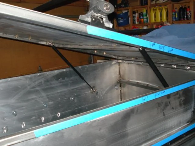

I got the gas struts installed tonight. I made up a little plate with a nut welded inside them, then opened up a hole in the tubing on the side and lid of the trailer and welded them in place. This allowed me to keep all the mounting nuts blind, so you can't see them from the outside of the trailer. Keeps the lines clean! :D
Got the buggers installed, closed up the lid... got the wife, to show off the struts of course... opened them up... and HISSSSSSSSS one of the struts puked its guts out and died. Bummer, this is my first bad item from McMaster, I hope they come through for me.
Any way here are the pics...

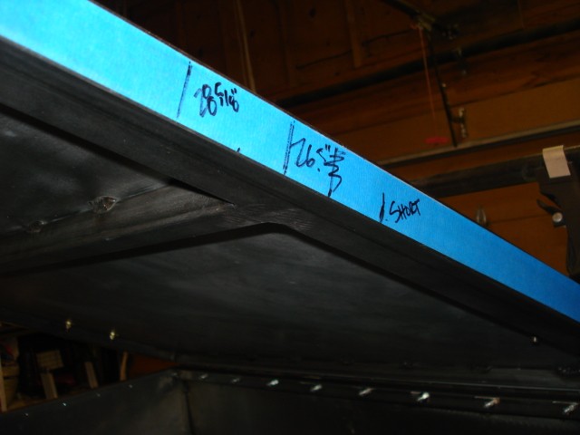

Here is a few shots of the measuring fiasco... my geometry skills are kinda weak, but things started to come together once I had the tape up and could visualize the struts and their placement.
McMaster has a great write up on figuring out the pressure and length needed. Just search gas struts on their site.

Are you sure both struts were the same. For those ratings, they shouldn't have had a problem. But if they sent you a 200 lb rated, instead of 500, i can see it puking easily.
Nope, it just burst. Both are rated at 150 lbs of lifting force, and I have them arranged that it will aid in the lifting but probably still need a prop to hold open all the way. The lid actually opens a good bit higher when they were both working.
Cool thing to know, McMaster got back to me in about 20 minutes last night at 11pm Mountain time, and they are sending out a new one today for free! Got to love a place that knows customer service! :D

Ah. I thought they were 500# units. Which is why I was so surprised to see it burst.
