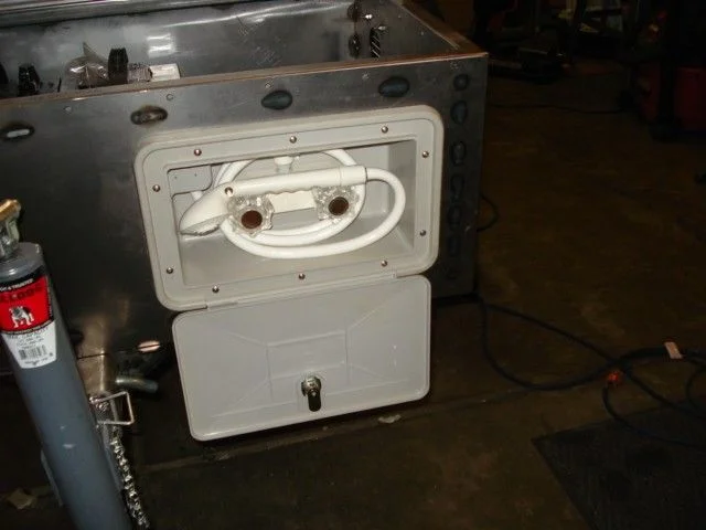

My first job today was to get the shower installed and fitted into the front box. It went smoothly and I am getting better with the cut off wheel and the grinder when going for straight lines. Pretty straight forward install, I will plumb it before moab if I have time... plumbing is getting further down on the list for sure since we have full services where we will be "camping."
It is a nice little unit I scored off ebay for a song. It locks and has inputs for cold and hot water... hmmm maybe a water heater in the future. Anyhow, my wife has beautiful long hair and a nice warm shower on a long weekend might coax her out to a few more outings this summer.
I'd like to paint it black, is there such a paint for plastic?

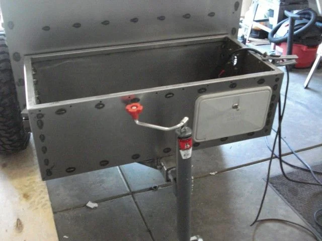

Next up was the plug in port for the battery charger. It is a Marinco (I like all their products so far) and is really well built. I went back and forth on where to put it, but in the end function won out over aesthetics and it now lives where you see it. It will allow me to run an extension cord from a power source to charge the batteries, either at home, or at a campground with facilities, or mooching off a hotel on a long road trip ;)

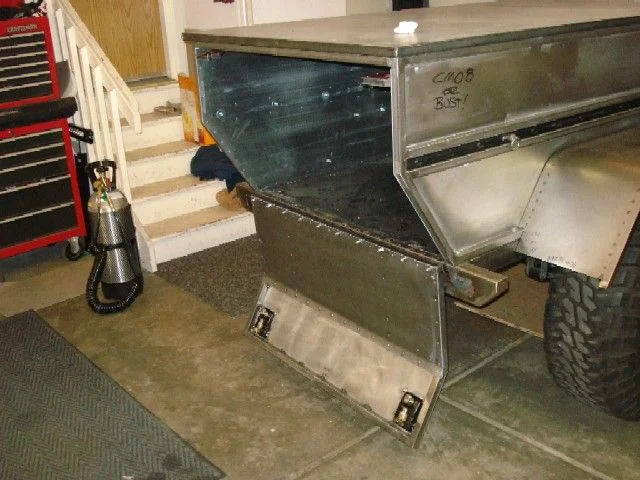

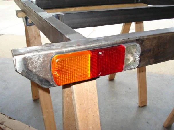

Drew I don't want to be a party pooper, but rather bring something to light while it can still be fixed.
I was going threw this whole thread again and admiring your work when something occurred to me on about page 19. I noticed that your tailgate opened all the way sits flush on the rear bumper. Then I recalled you were going to run FJ40 tail lights in it for some class. With the 40 taillights on there are you at risk of crushing the lenses every time you open your tail gate? I seem to recall for some reason you saying you might run some other taillights but for the life of me I cannot find the post. Here are some pics of what i'm talking about.
Tailgate fully lowered for drawer access:

Protruding FJ40 taillight assembly:

Nick-
Glad to have a friend like you in my corner. You are totally right, one of my club members pointed it out to me as well. The way the lid hinges it may clear, but probably not. I will have to use either a rubber bumper (think rubber stop) and or a set of limiting cables (more likeyl).
Man, you need to come out to my house and go over this with a fine tooth comb, I appreciate it... and anyone else that sees a problem I would ask you to speak up! Not that I will change it though ;)

For painting the plastic for your shower take a look at Krylon | Krylon® Fusion for Plastic®
Krylon claims that their Fusion paint will adhere to plastics. Check out Wal-Mart or Ace Hardware or others to find it.

Great! Thanks I am going to pick up a can today and give it a whirl... welcome to mud! :D
