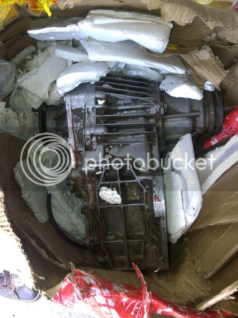

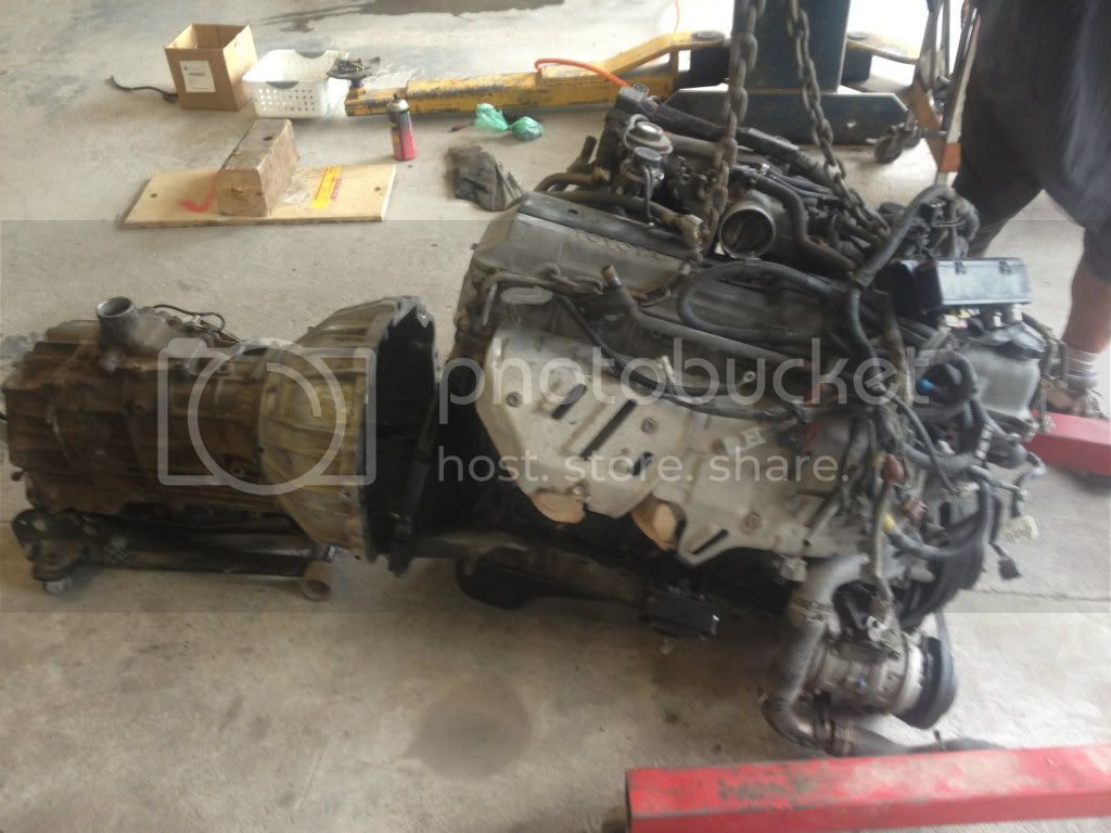

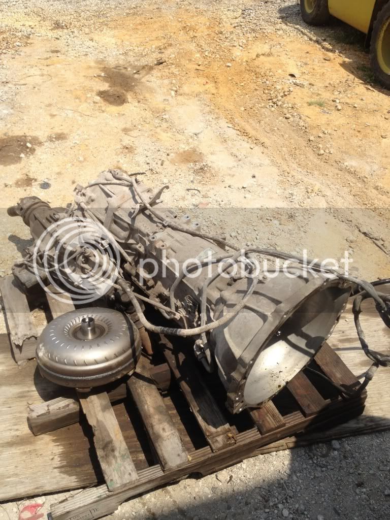

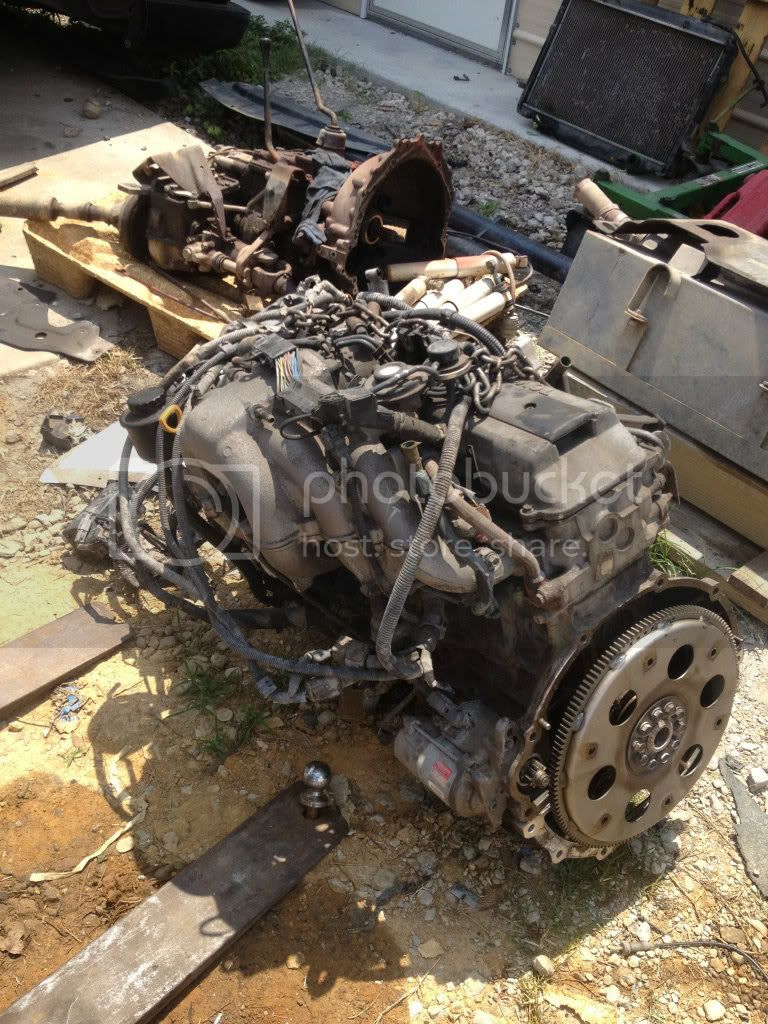

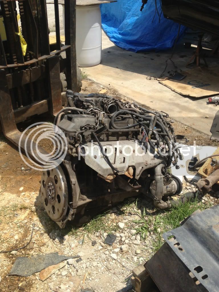

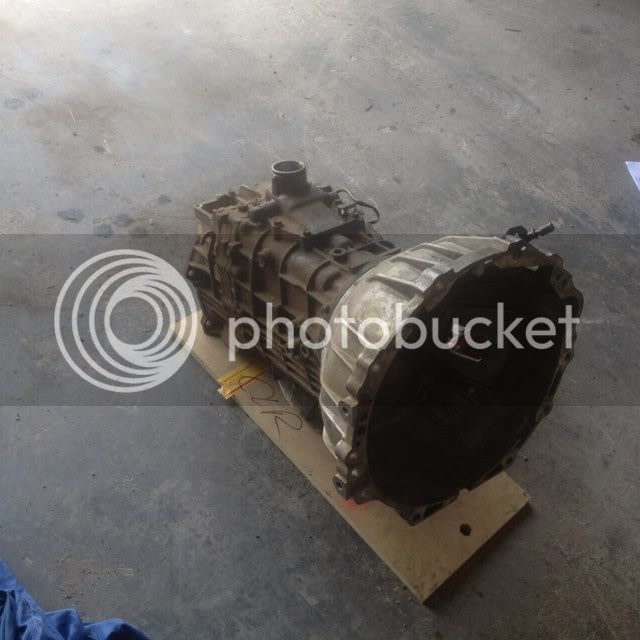

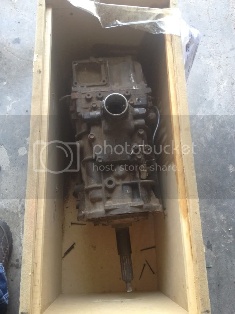

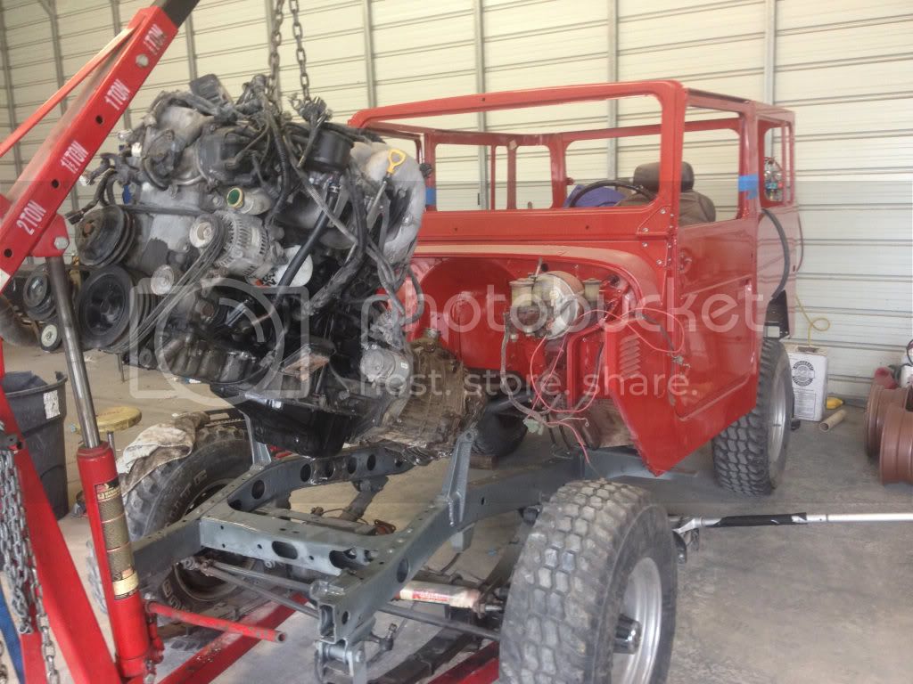

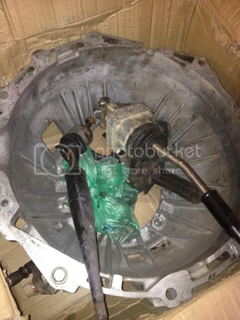

Thanks, definitely the V8 is out, I'm going back to the strait 6 and a 5 speed transmission. the motor is out of a 96 Land cruiser the 1FZ-FE motor and the transmission is on the way from Venezuela is a H151 5 speed

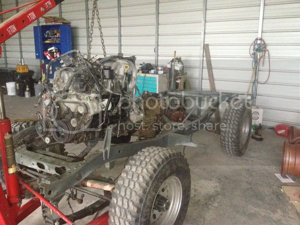

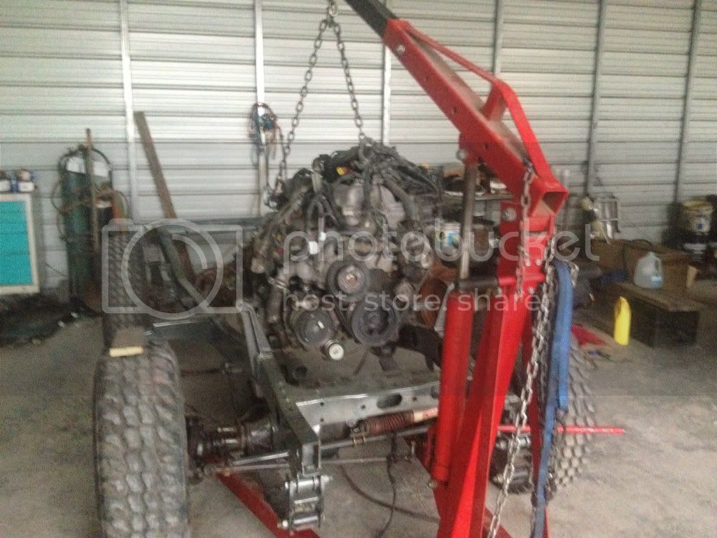

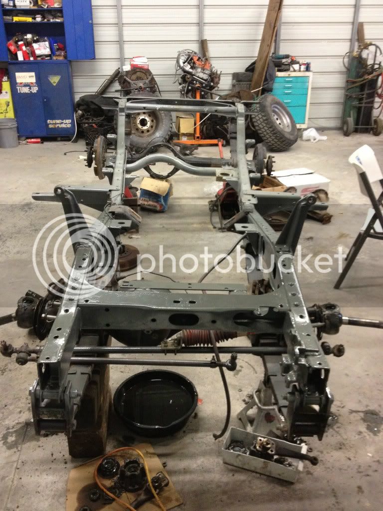

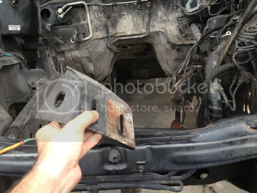

Ok. so finally I got the transmission from venezuela, Dhl lost my first transmission so I had to buy other one and send it. now that I got it I can start to move forward, yesterday got the front and rear ARB install and today I finish removing the motor and transmission mounts.

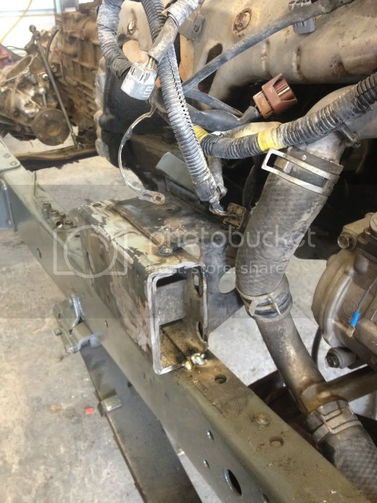

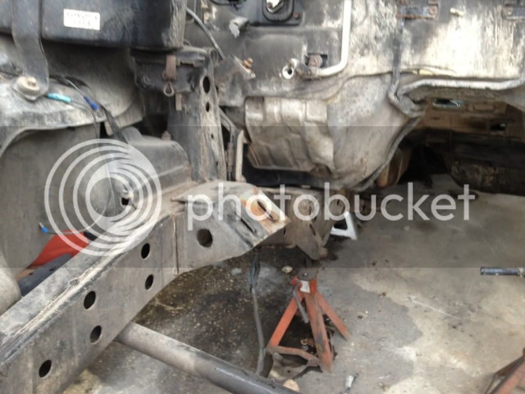

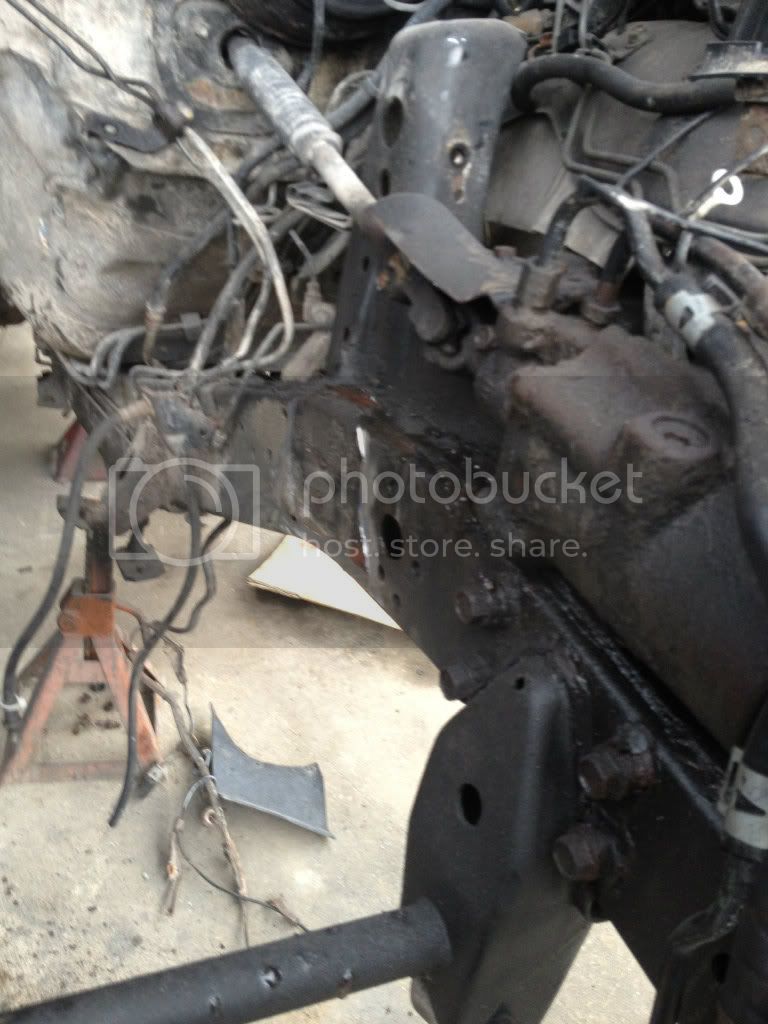

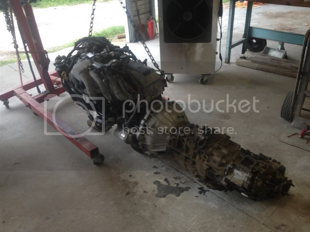

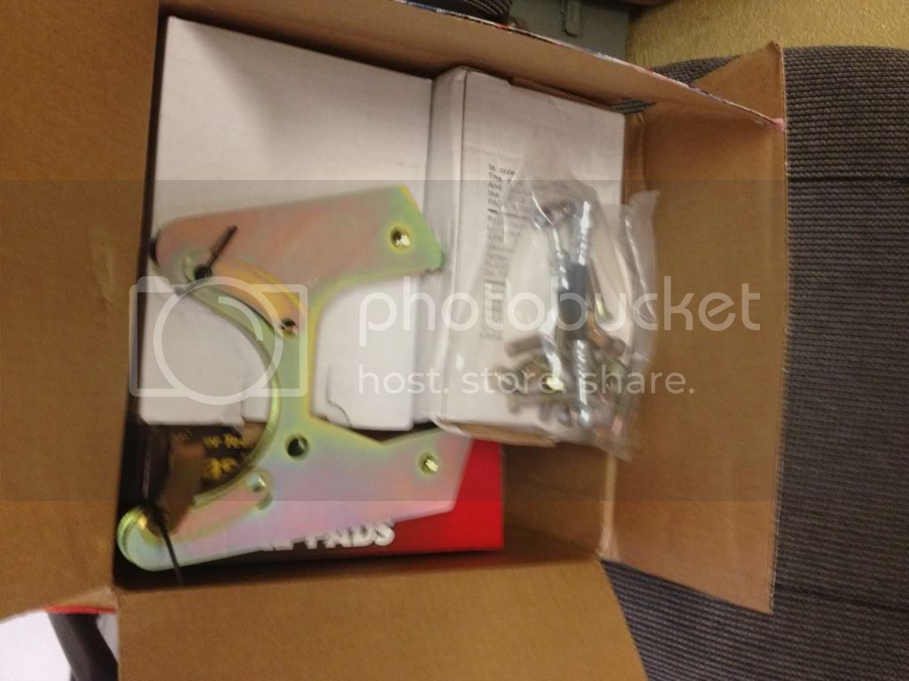

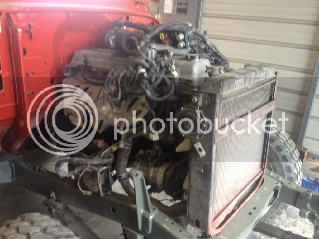

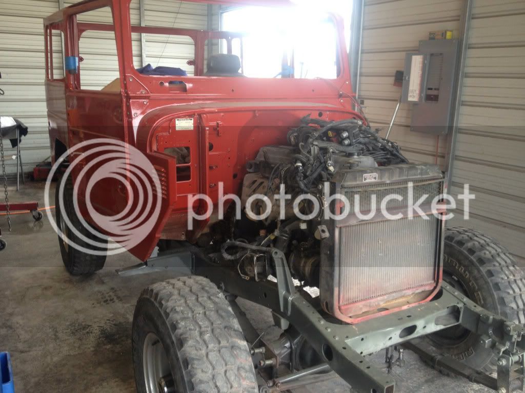

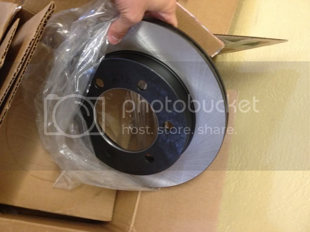

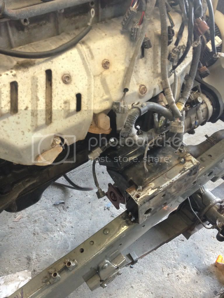

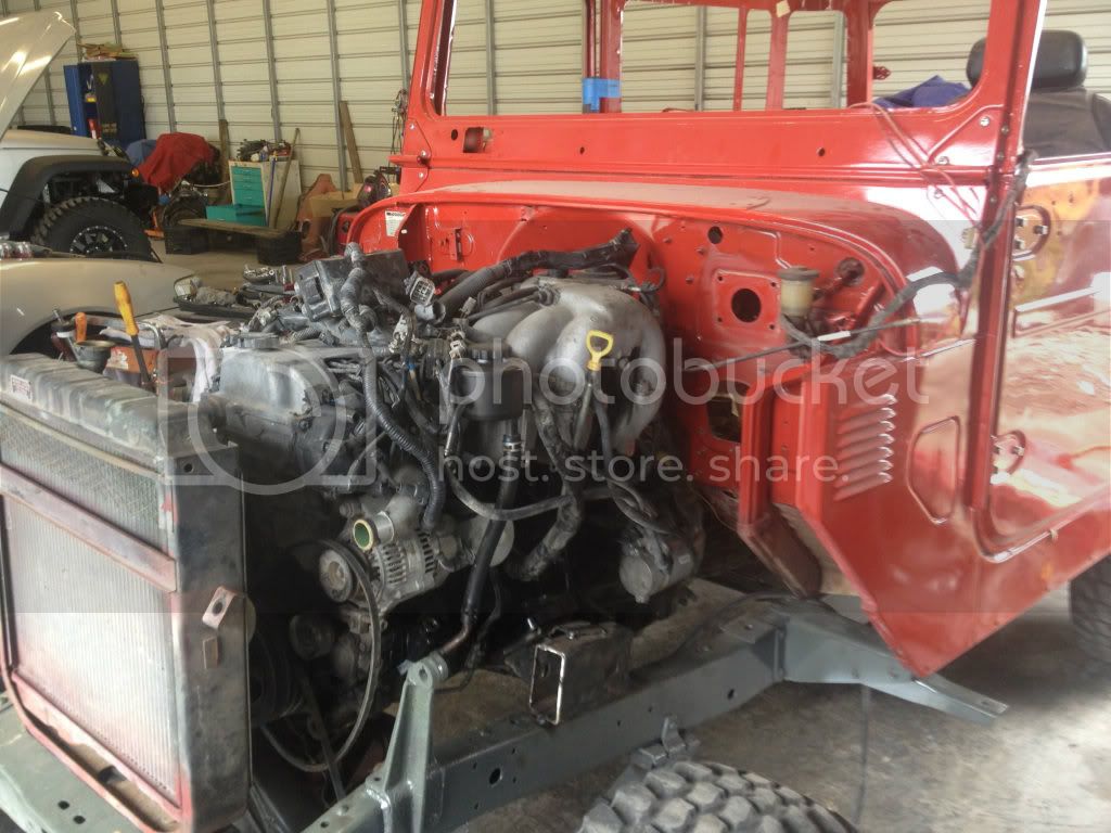

a lot of time and work has being done, motor, trany and transfer are on place but not completed, I had to put a body lift in order to clear the trany and transfer and also having some problem with the brake buster, the stock fj40 is to big, I took the one out of the 80 but is still little to big, also I'm considering to lower the motor about an inch.
Pics are coming!!!!

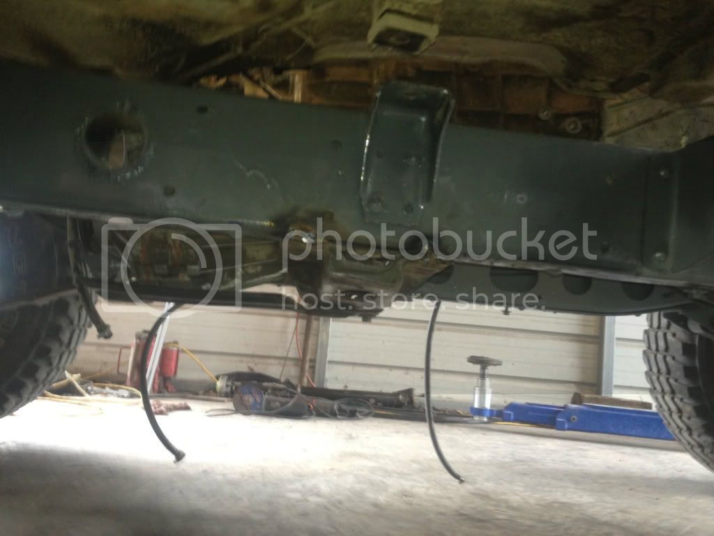

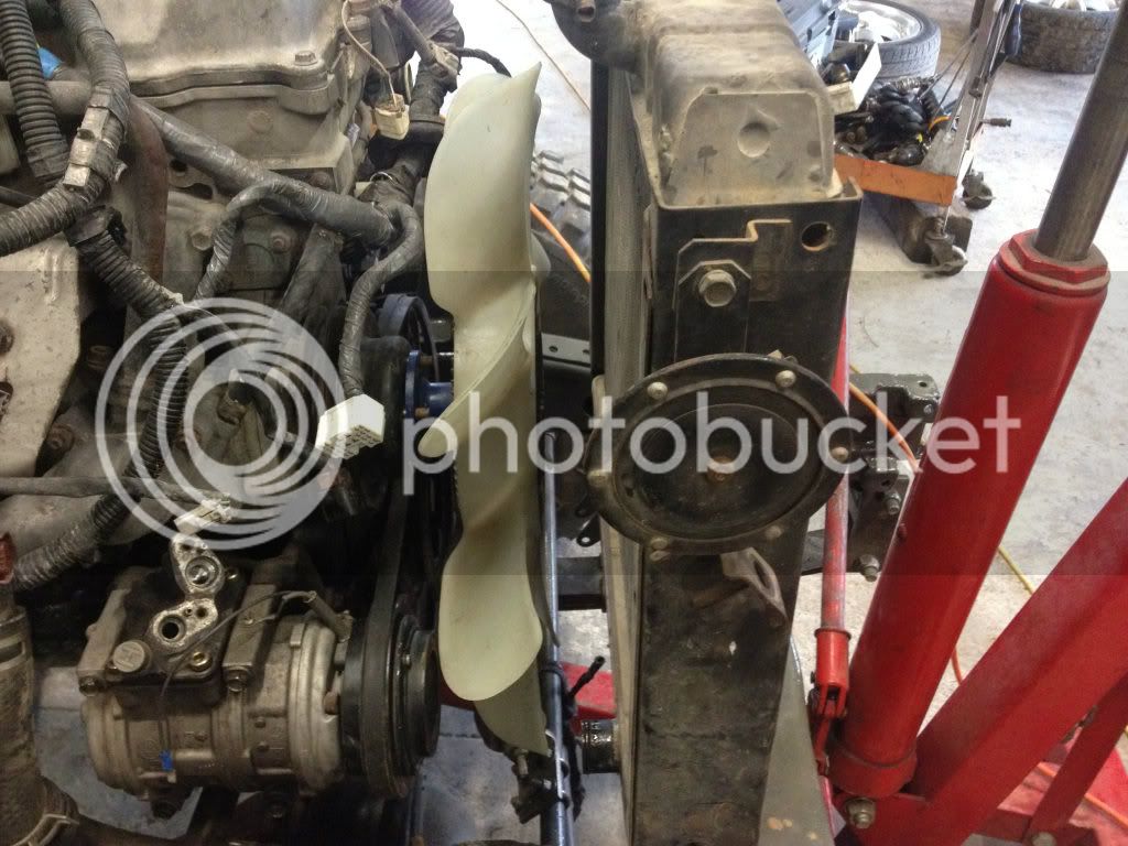

Are those blocks the motor mounts are connected to going to stay, or just mock-up? I see all kinds of weird stresses there.
How much drive shaft are you going to have? Seems like trouble.
Yes the block are just for mock-up as well as the ones doing the body lift. tomorrow I will make the ones going to stay for good.
on the drive shaft, the space is very limited but I'm planning on doing a 4 link rear suspension and moving the rear axle back couple of inches :hillbilly:
