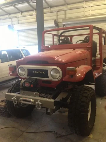

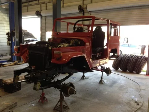

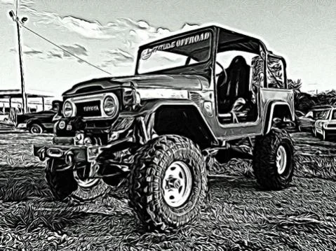

What type/size tires are you running on those? Was just wondering if you had to have the rims widened. Looking good! - JP

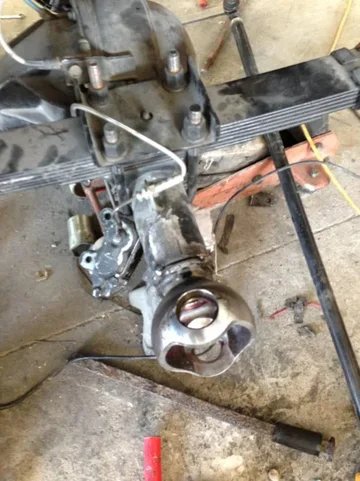

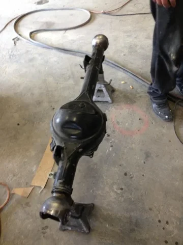

Just out of curiosity, since you're adding the wheel spacers, why didn't you go with 60 series axles?
Damned nice work.
That's gonna be a fun ride...nice work!

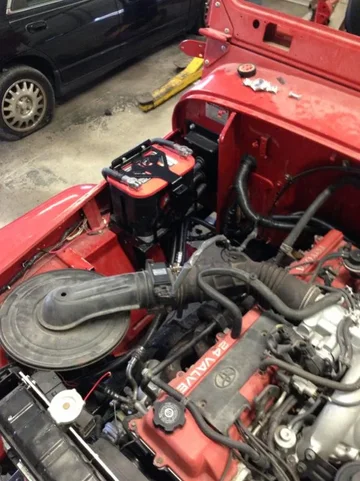

ey go on the passenger side by the fan in the engine side Straight down and then follow on the top of the frame I moved mines inside the frame all the way back by the rear shock out then top of frame splitting the right side amd left side and continuing over the frame the only ones that came out in the middle of the frame where 3?4? That goes to the transmission for reverse and for the 4x4 engaging light your kicking ass bro I can’t wait to have mines in if you have any diagrams on the angles for the driveshaft or advice anything yo look and be careful with I would really appreciate it brother can’t wait to see the endif anybody can post any pics of their wiring after it goes thru the fire wall and down, I know the wire goes back to the trans and up to the fuel sending unit but after that how does it get to the tail lights? frame or body? help me out please!
Th
Here’s mines as you can see on them the wires where they go I’m looking for the other pics of the wires running under to the back palfaro48@yahoo.com my email I’ll send you pics ASAP
