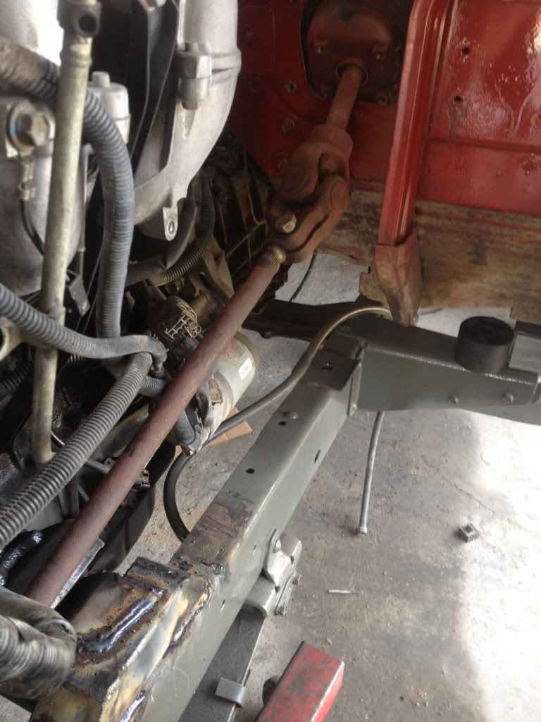

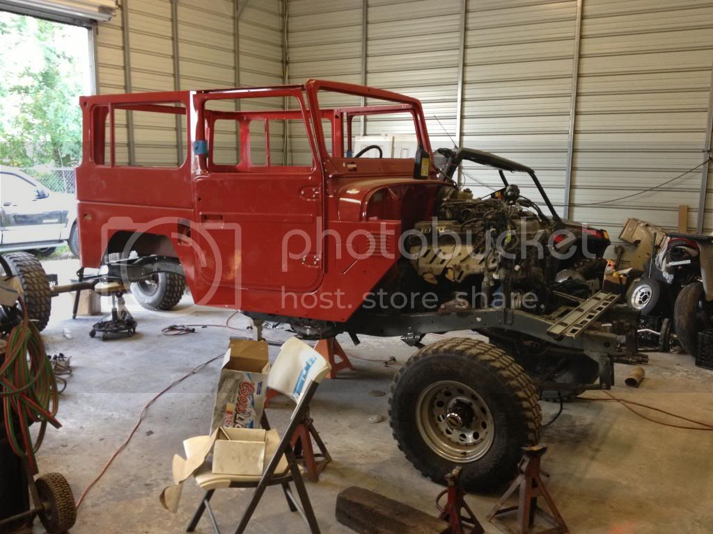

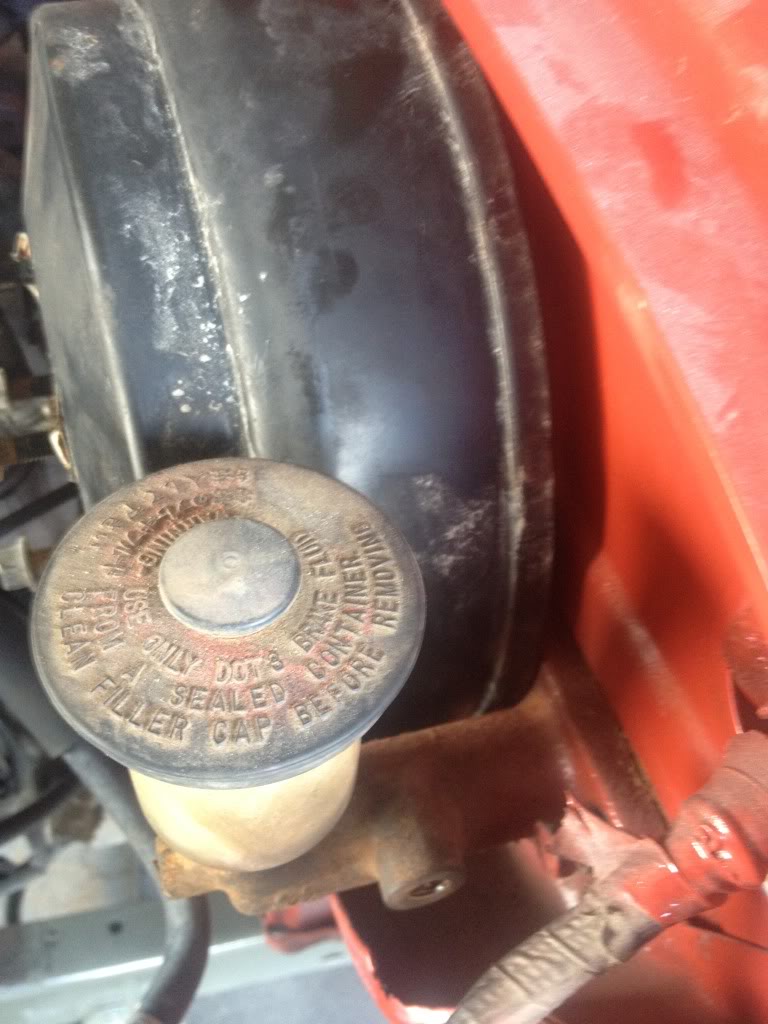

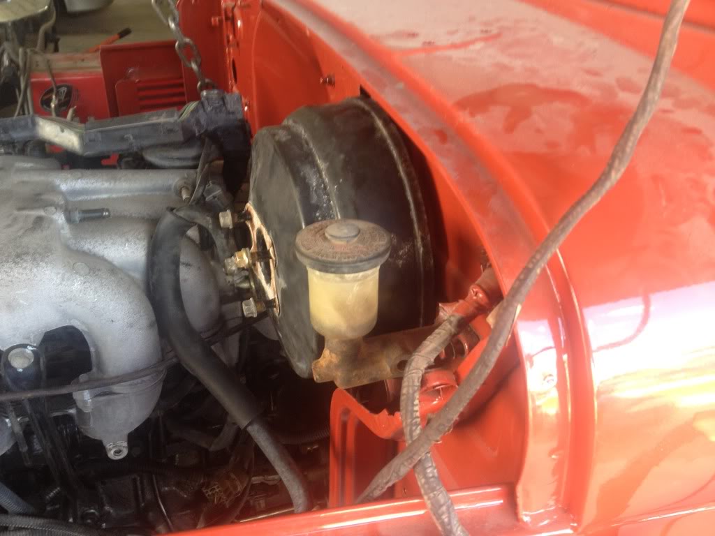

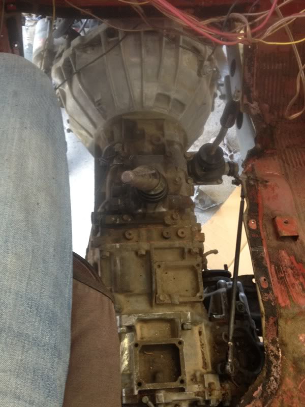

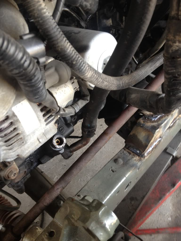

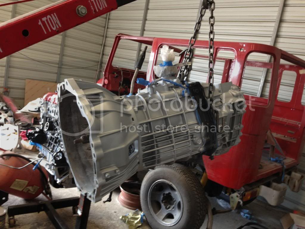

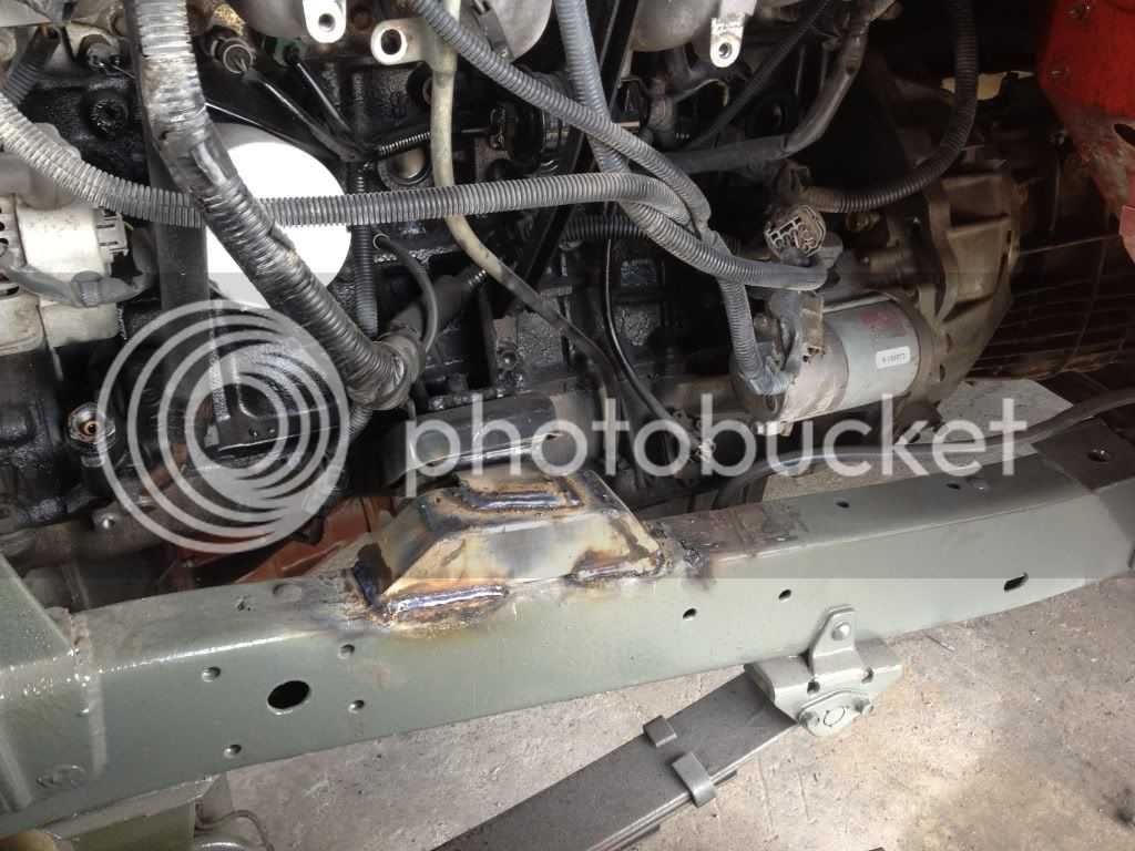

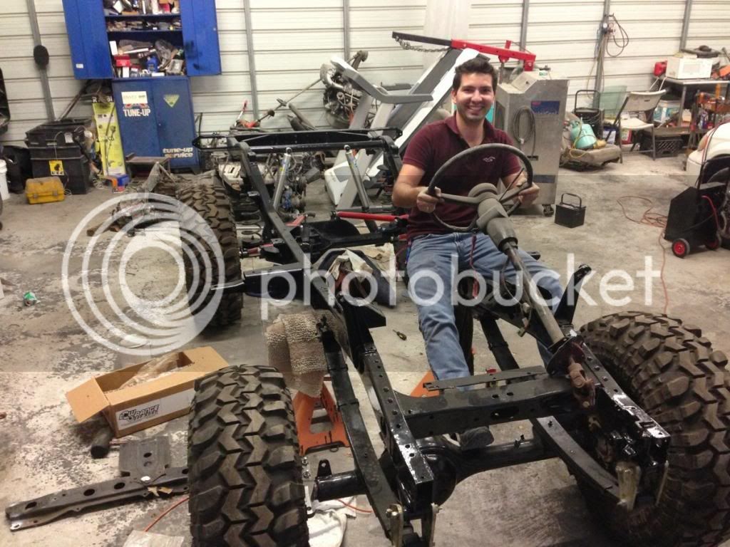

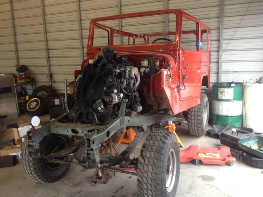

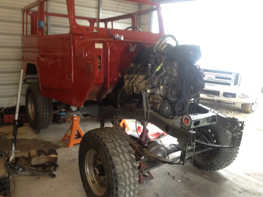

Ok so I did the final motor and transmission mounts, I'm very happy with the results the motor look really good and the booster and clutch fits very good and mounts are very solid

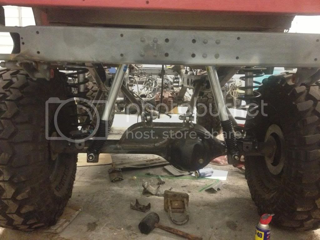

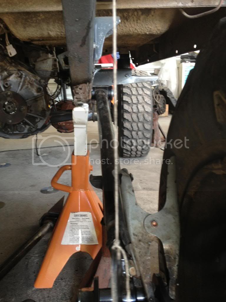

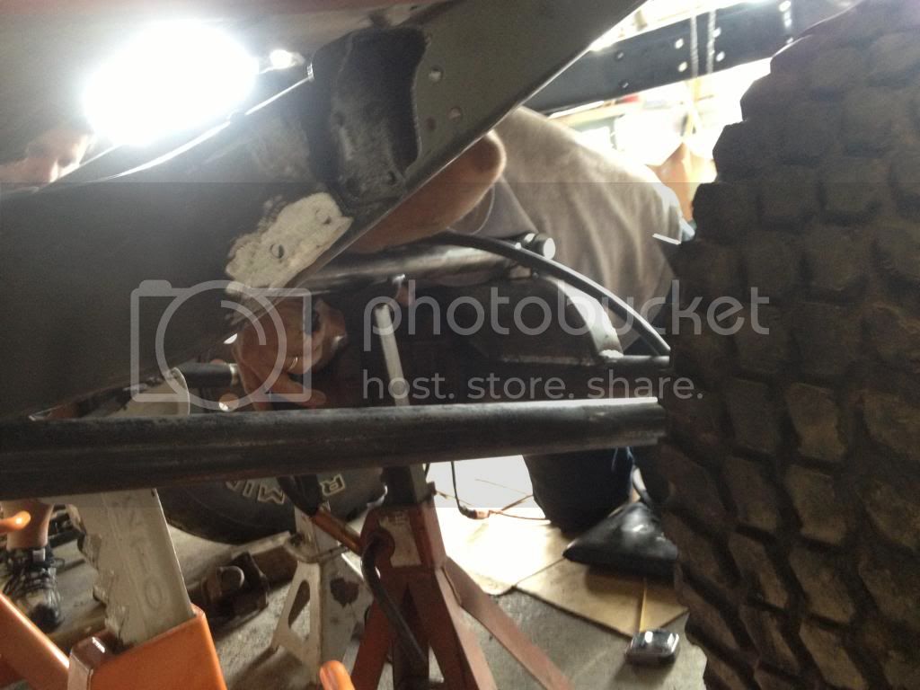

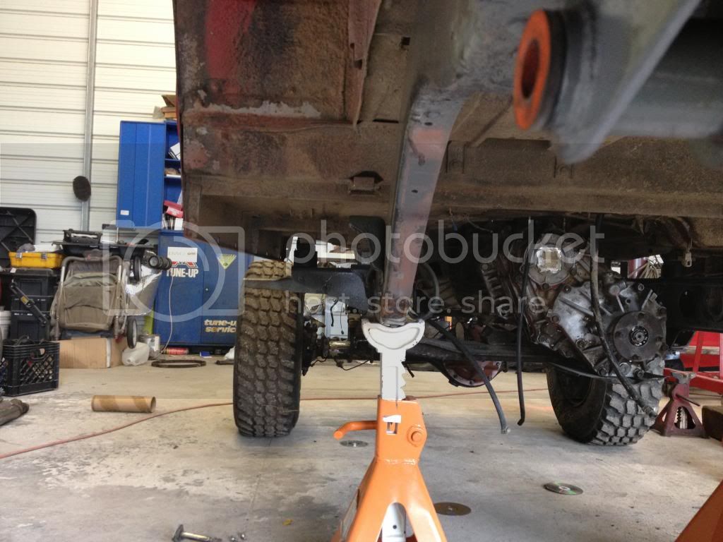

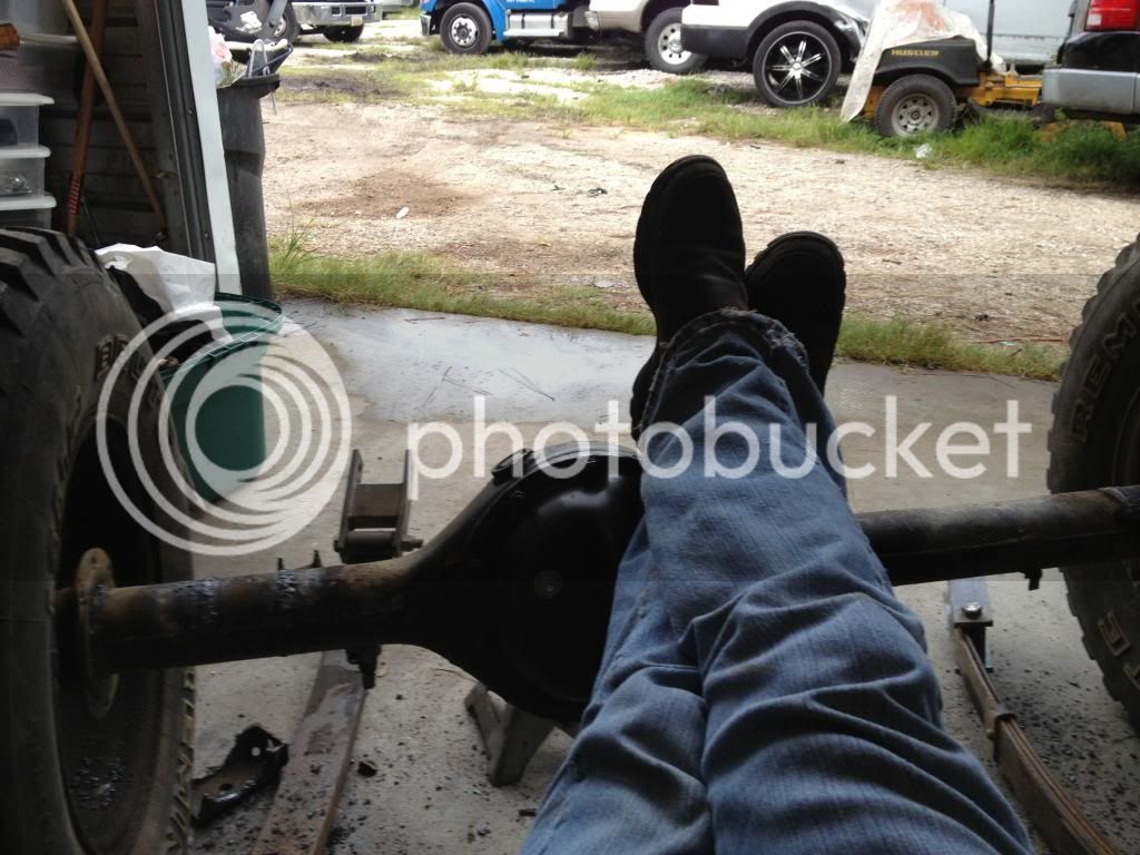

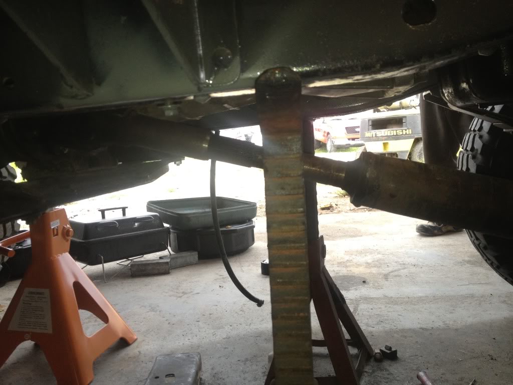

also started the front suspension I'm doing SOA in the front. I'm having some issues with the axle making sure is straight any suggestions are welcome
FJ60_ Thanks for the support :)

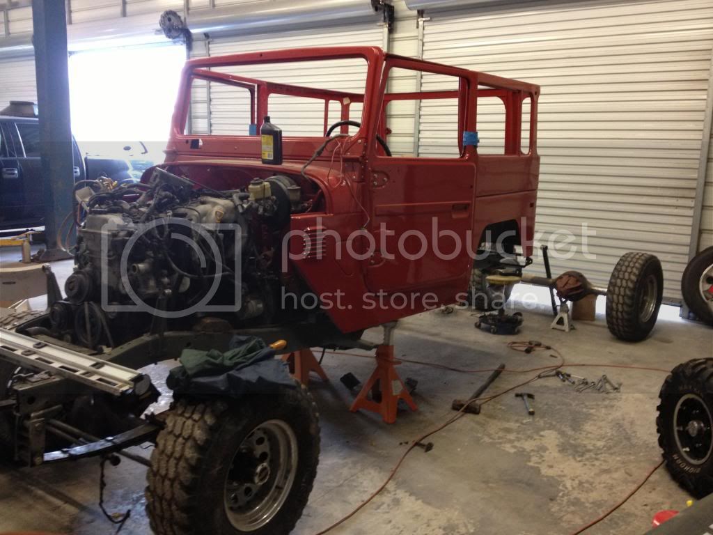

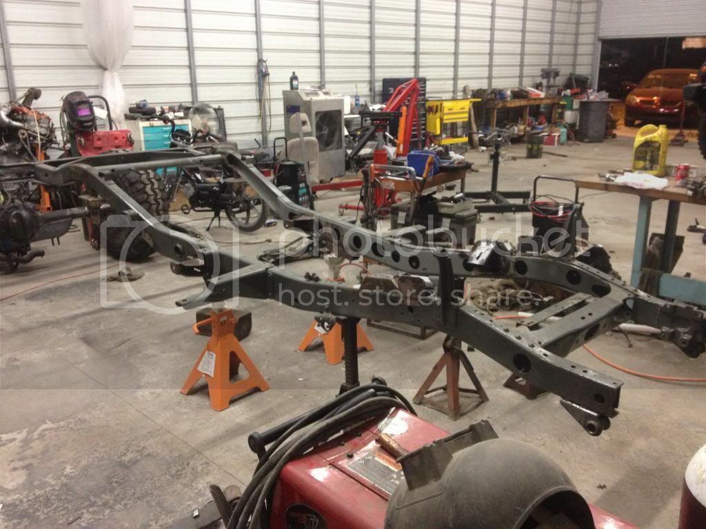

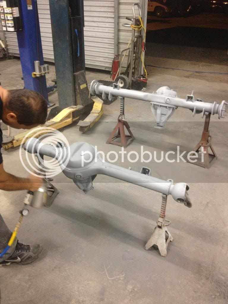

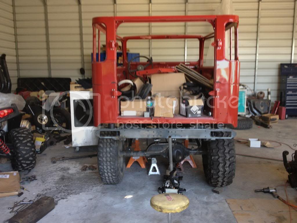

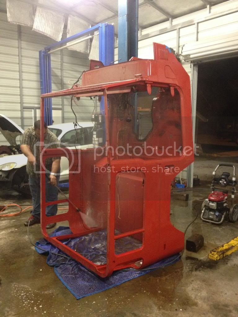

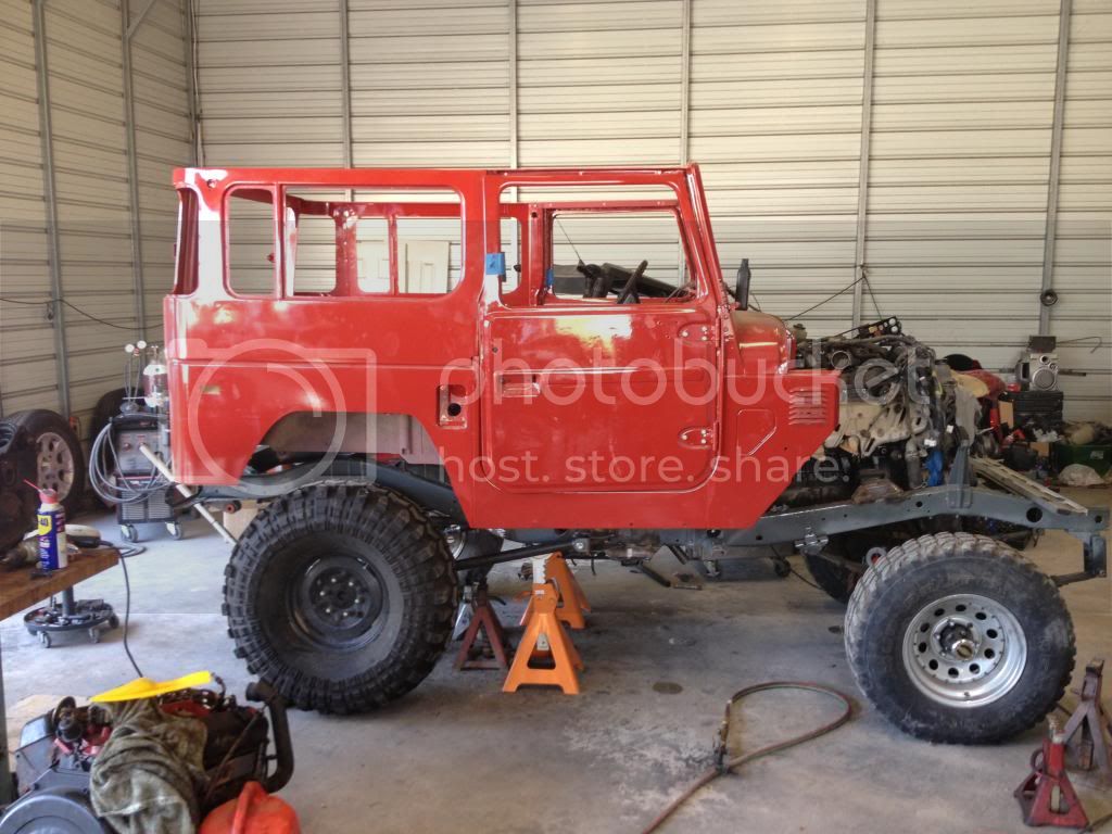

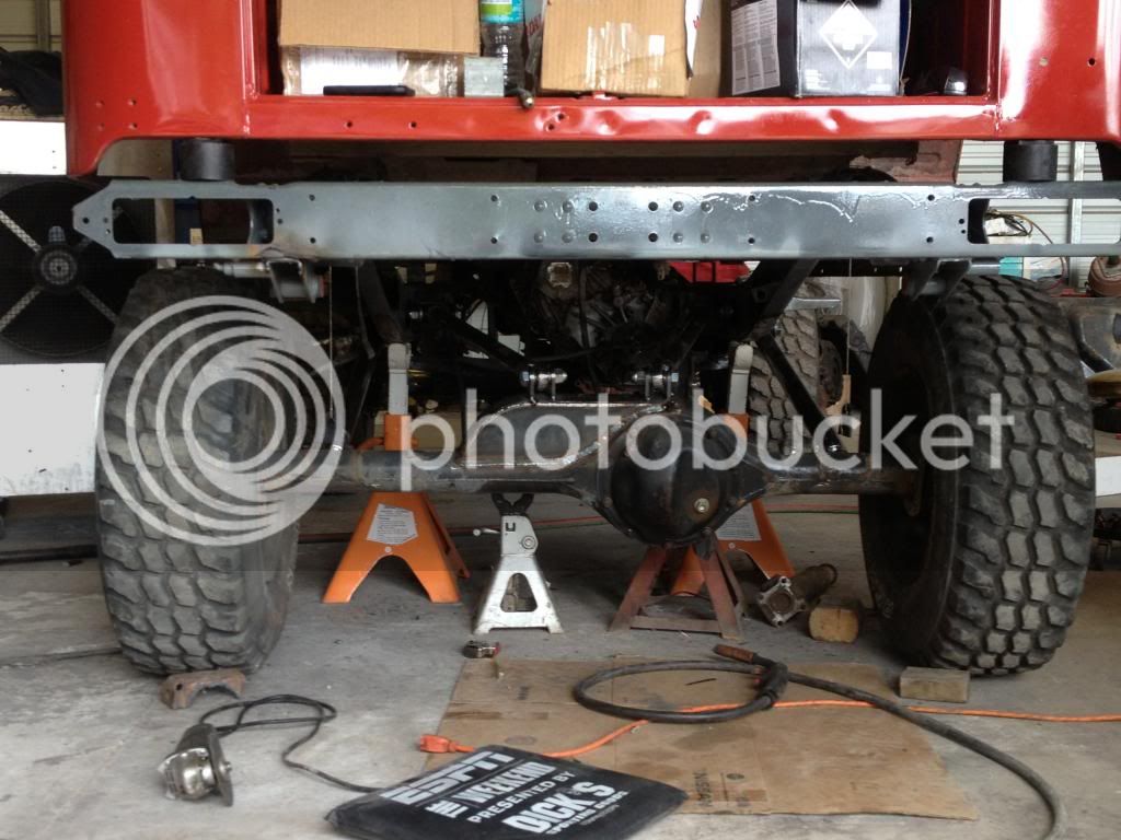

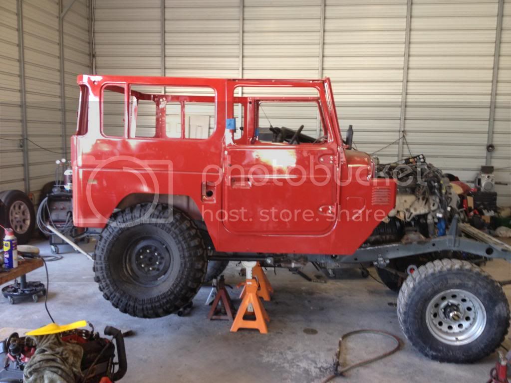

Hi guys, I got a lot done last past months

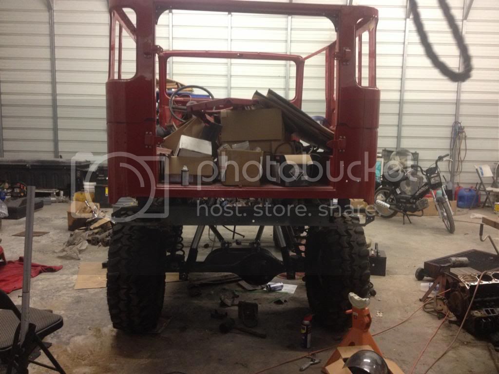

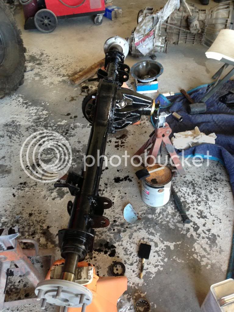

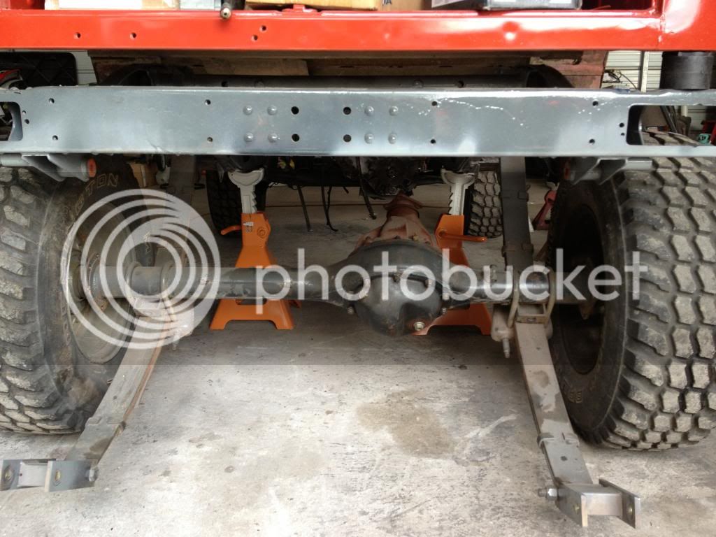

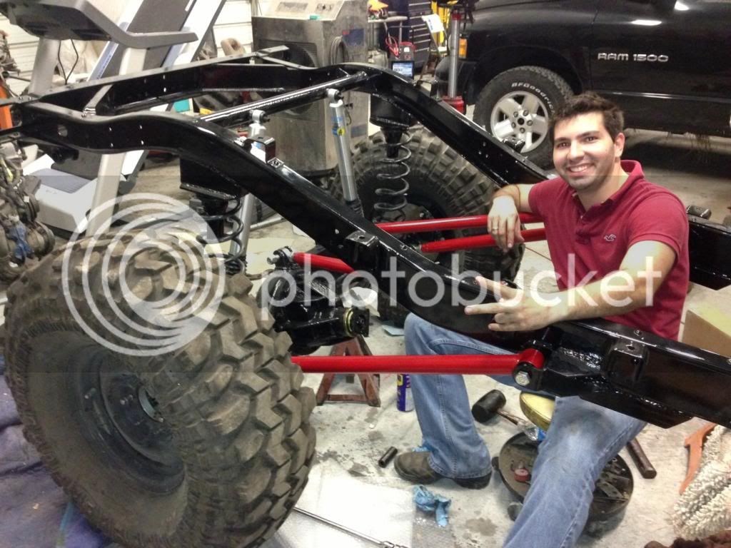

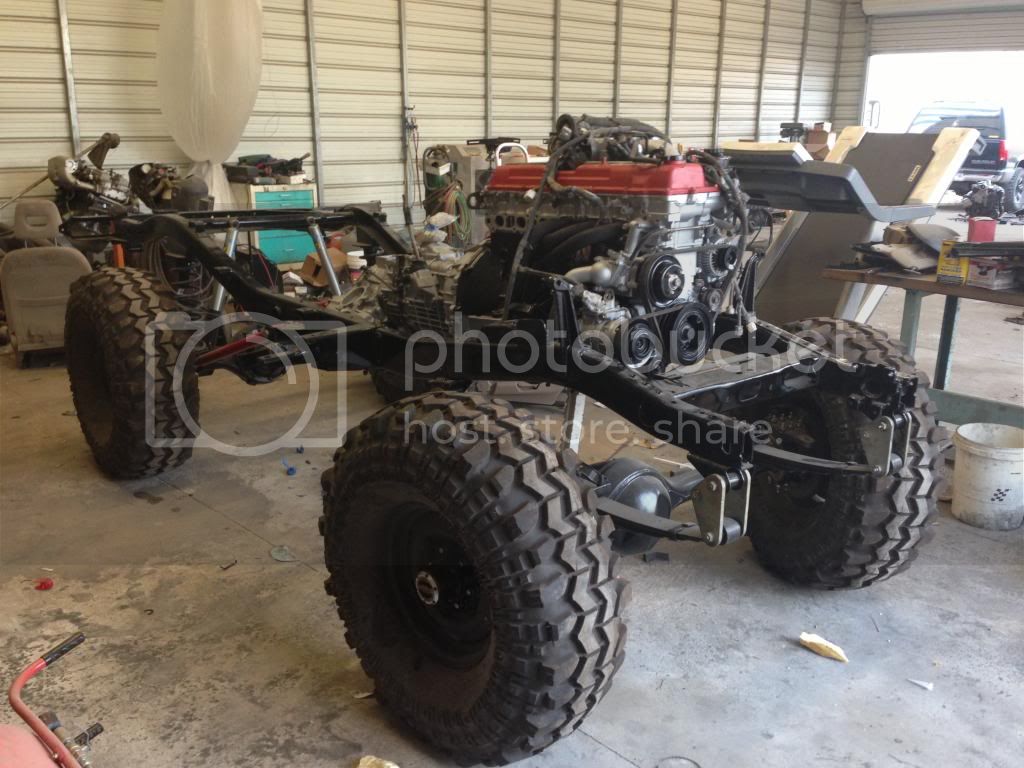

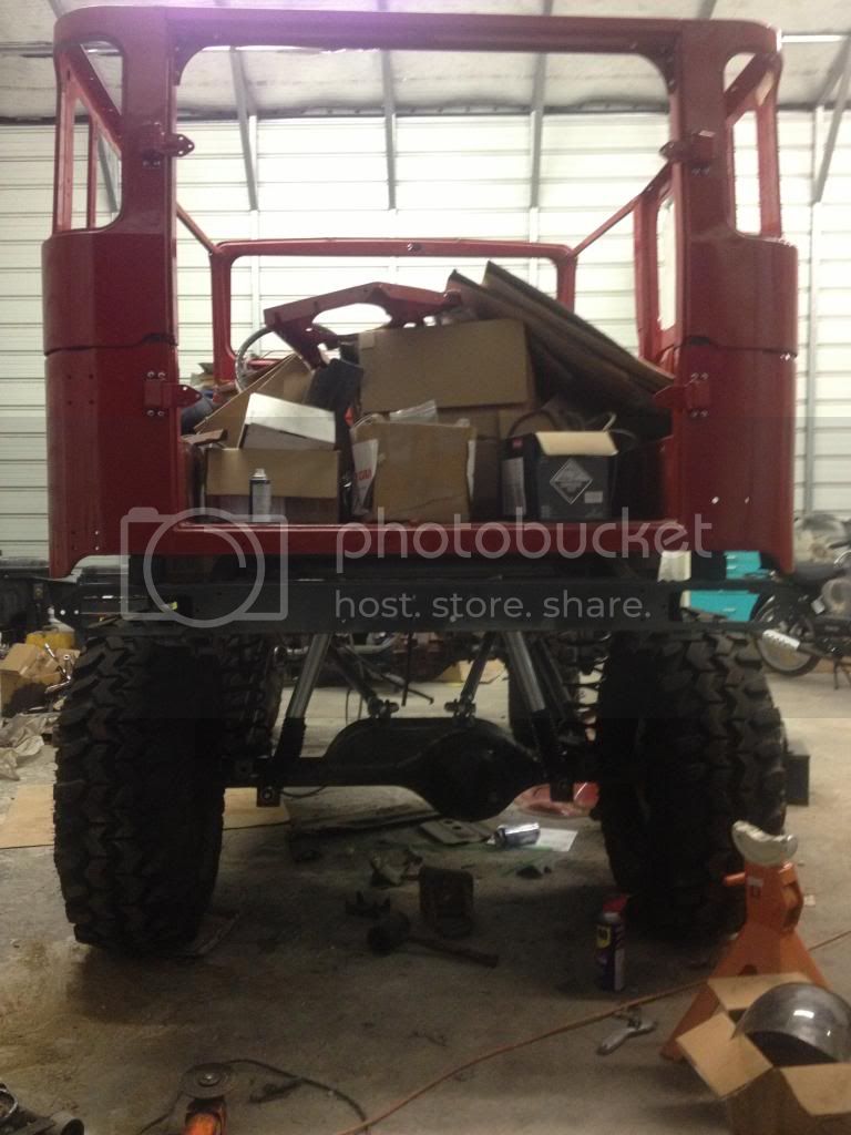

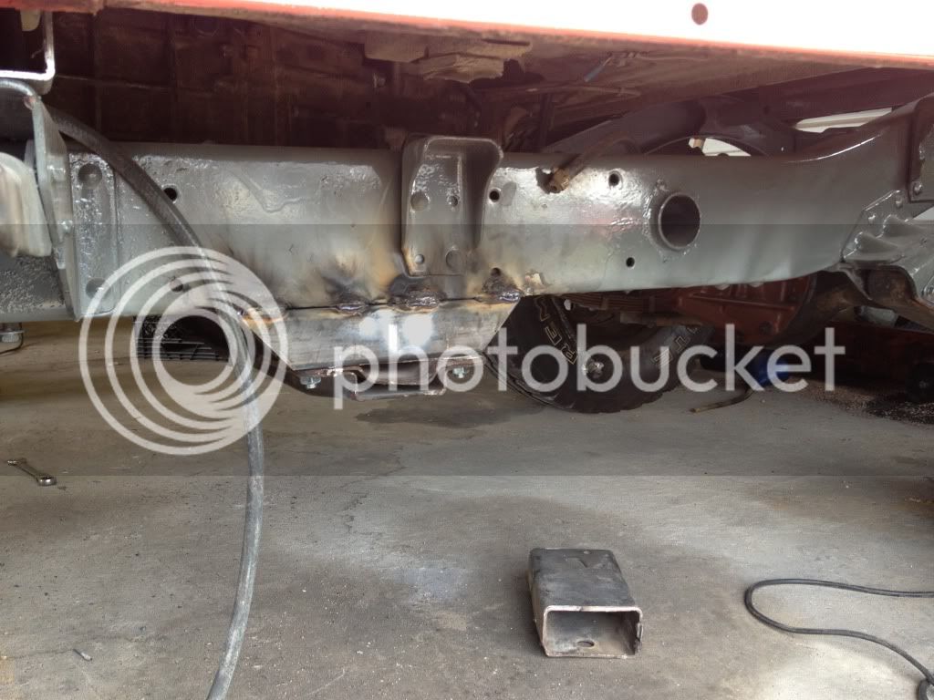

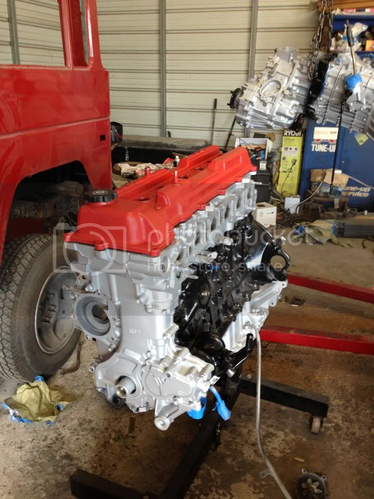

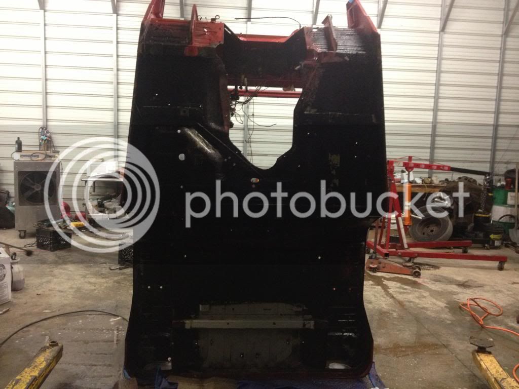

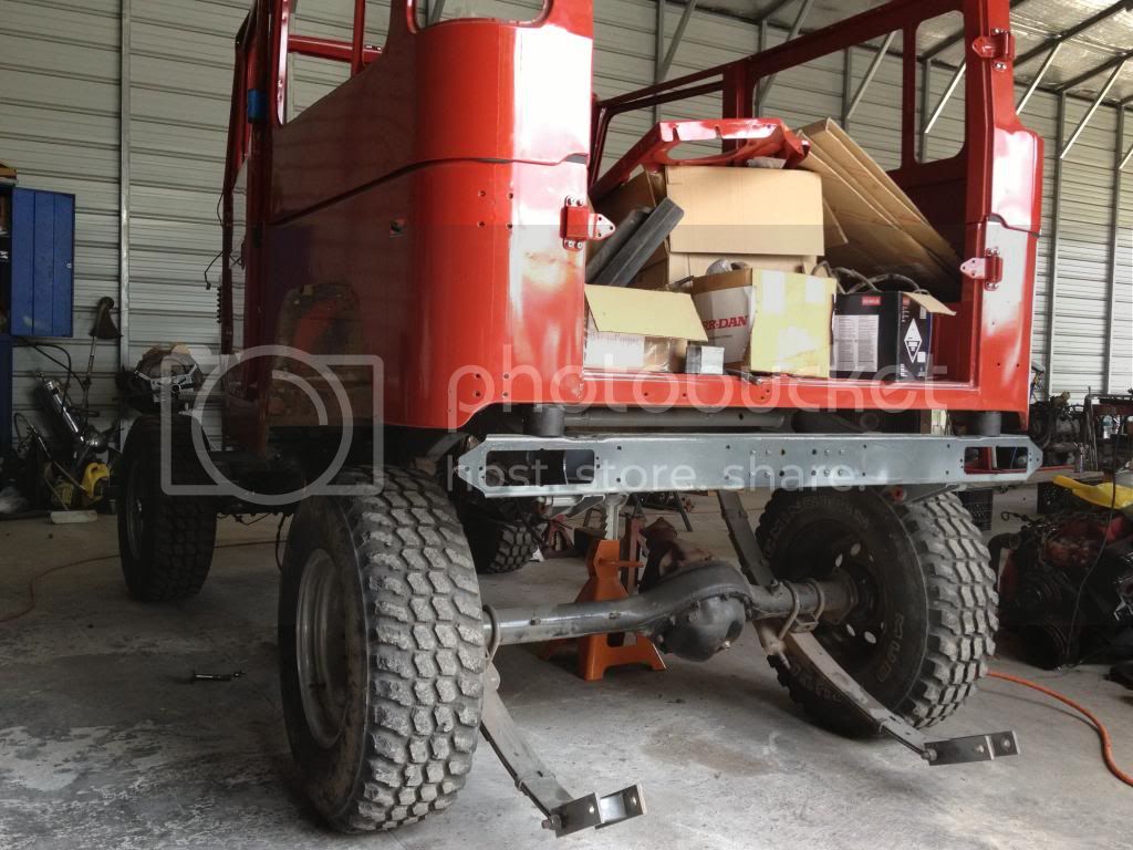

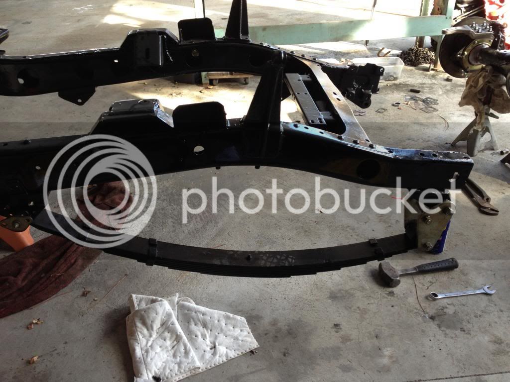

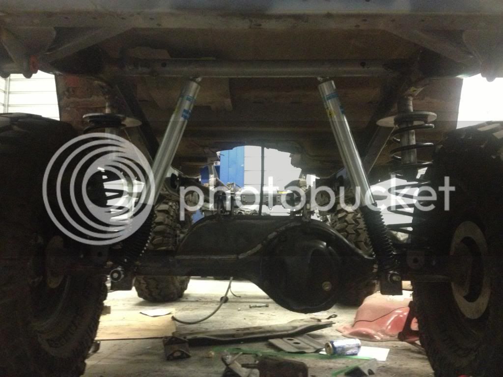

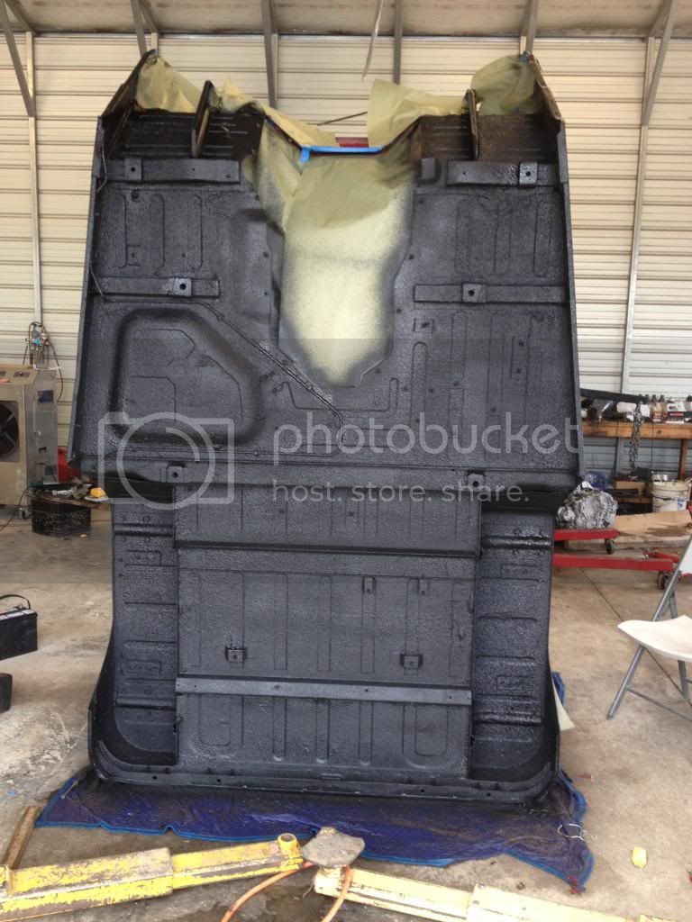

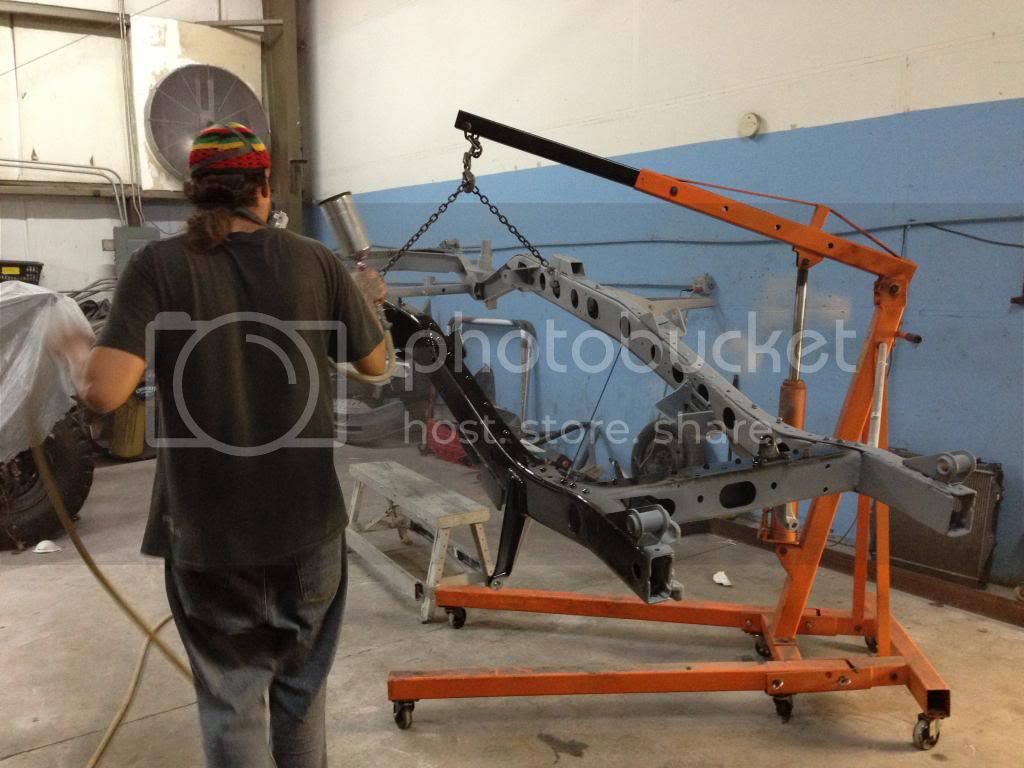

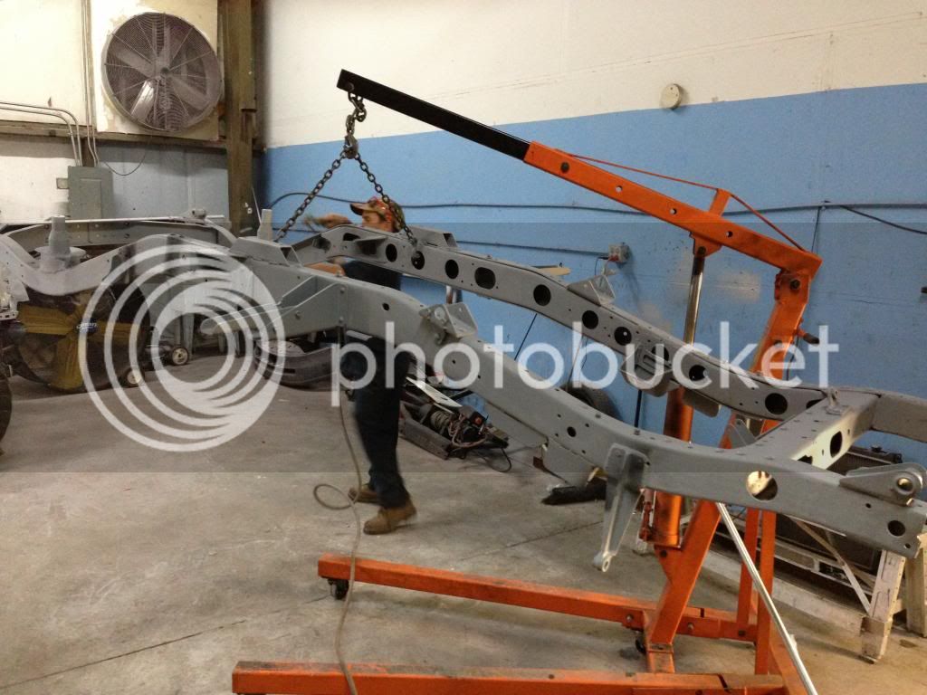

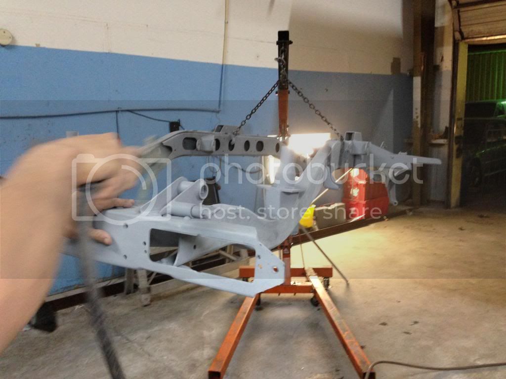

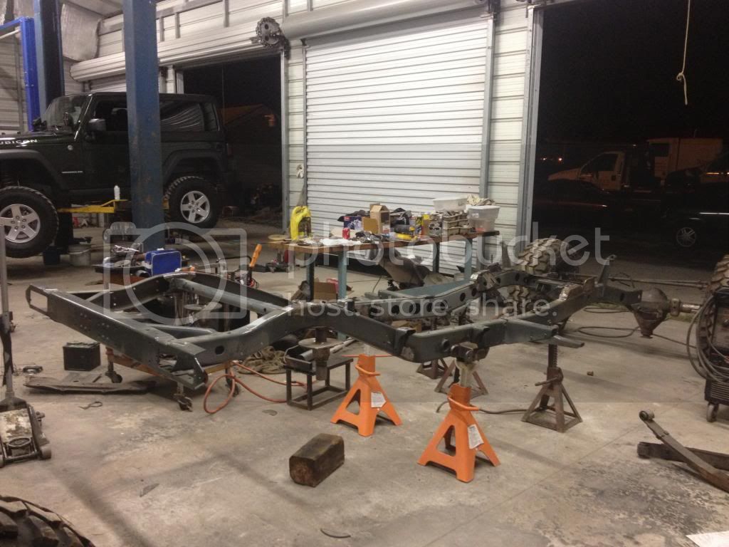

front spring over axle done, rear 4 link done, frame was sand blasted and painted, motor got new looks, brake lines are almos done, I did the under carriage with raptor upol, finish the axles with hight steer and trail gear six shooter knuckles plus ARB front and rear.

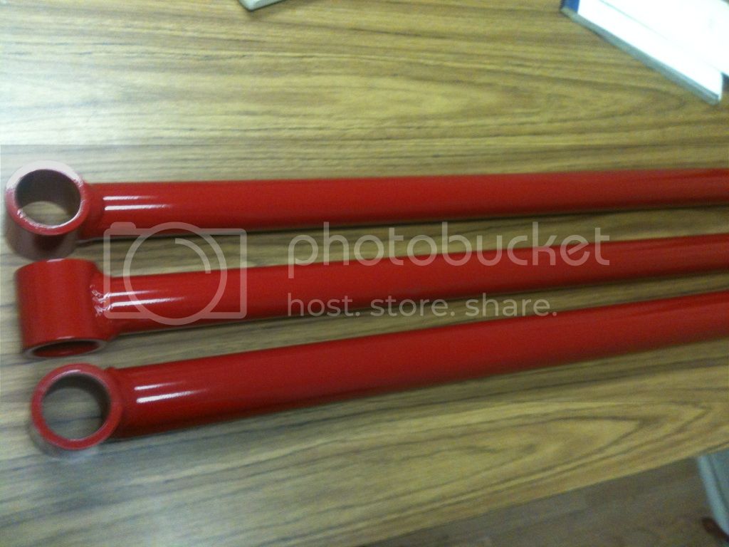

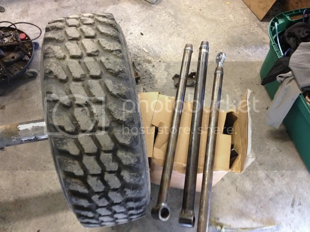

More specs on the link job please.

Good question. On the front bumper I'm not sure yet on what I want to do, The ARB looks good and it keeps the fj looking clean, but I'm not sure because it takes away angle of attack on the front tires. I have a warn 8274 50th aniversary for the fj so I definetely need a bumper.
The 4link setup is from profit cruisers, really ease to install and it looks heavy duty, I really like the way it look, going to have to way and see if I like the way it performs :p
