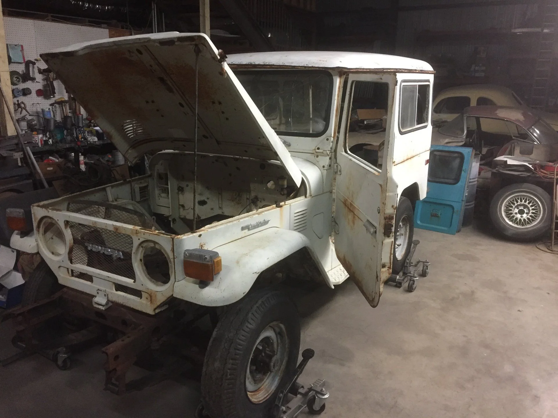

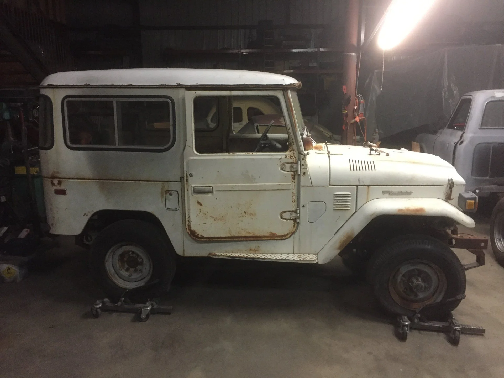

I just purchased a 1975 FJ40 roller. I'm building it into a daily driver primarily. I have zero experience but I'm working with a guy who has a ton of restoration experience with older 2WD cars. Plan right now is a R2.8 Cummins with an NV4500 tranny.
