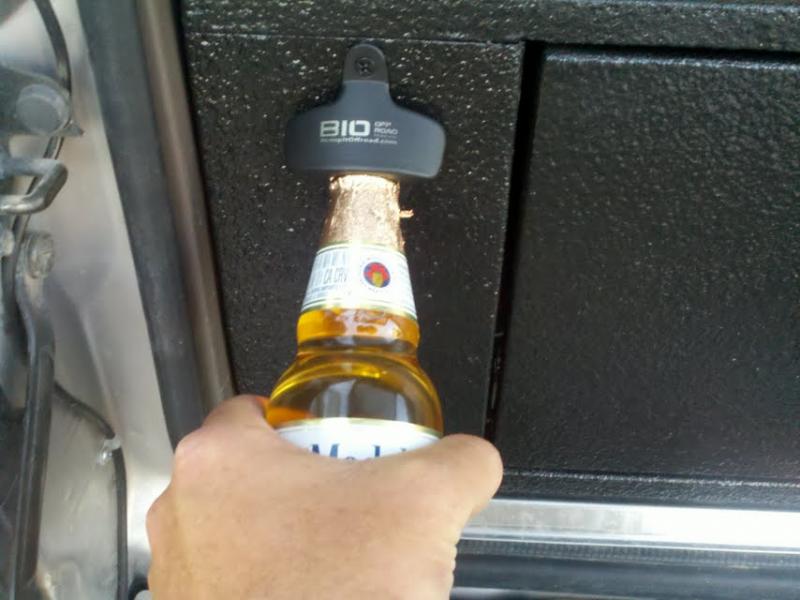

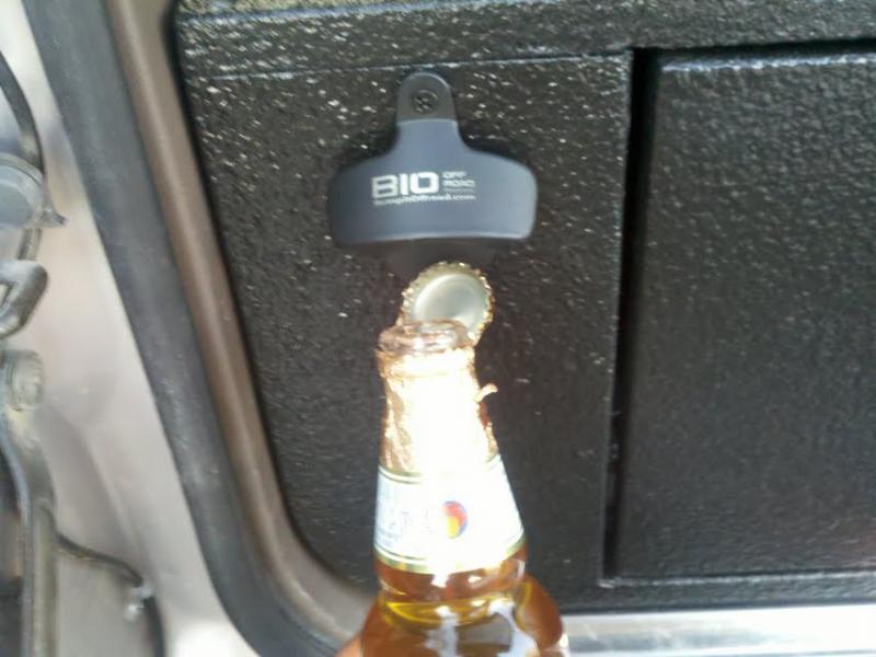

Last night in my haste to clean up the tremendous mess I made in the garage over the last 2 weeks, I forgot about a very important accessory...the new bottle opener that came with my recent purchase of a Bump It Offroad front tube bumper (thanks for the bonus gift Mike!) So when I got home I went right at it...installed and TESTED it! Ahhhh, now to enjoy the fruits of my labor :beer::hillbilly:
Modelo especial, very nice, I like the Negro modelo myself.
Oh and the drawers look fantastic. The more of these threads I see the more I think I need to ditch the 3rd Row.
Cheers:beer:
Now that is a nice finishing touch to a very nice drawer system Derrick.
I love the action shots. How many takes until you got it captured on film? :hhmm::beer::beer::beer:
Seriously though, looks awesome. Very well done!
