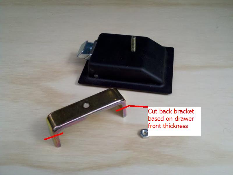

Latch installed. Take note, that the ears for the mounting bracket and the notch for the strike and are routered to a depth of 3/8".
The completed drawer system looks really good. I really like the finish. I'm a little concerned about how the top is secured considering the heavy duty tie downs you are using. A suggestion to the next builder would be to trim down the legs of the U-clamp instead of cutting the wood to secure the latches.

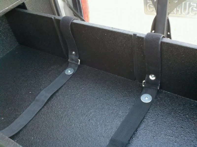

Well, after the coat of Al's Liner cured, I noticed that there was about 95% coverage and you could see the wood through the liner. Had I known, I would have primed the wood black like the areas that did not get liner. So I had to apply another coat to get full coverage. Since I had another batch mixed, I went ahead and sprayed the inside of the drawers. Other than the structural attachment of the cargo tie-downs and the hinges for my side compartments, this drawer system is done! When I was at Lowes I saw some velco storage straps that gave me a great idea - use them to secure my CO2 bottle in the drawer. Here are a few more pictures of the progress:
CO2 Bottle Straps
Here's the velcro straps I bought to kee the CO2 bottle from rolling aroung in the drawer.
