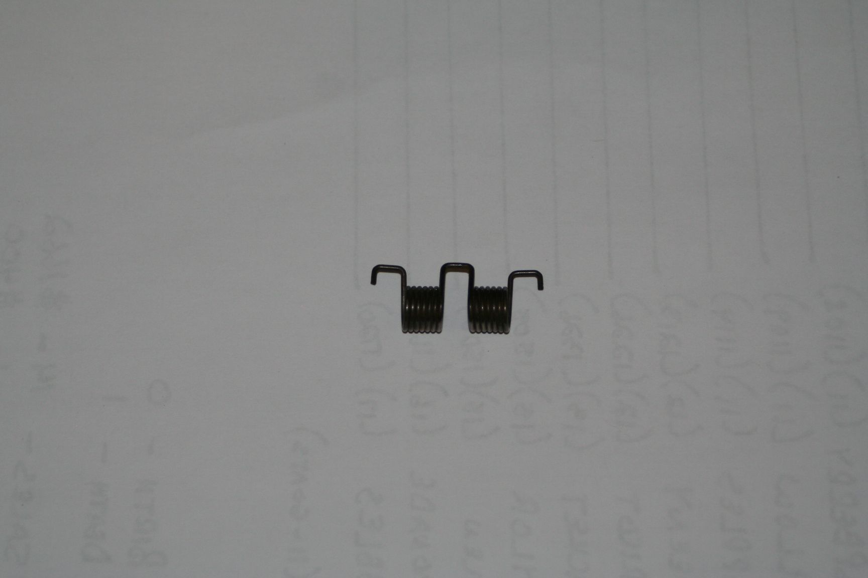

Did you replace the main springs in yours? Yes the green clip is what I was curious about.
Hey Nik,
I found this spring in my stash pile, if that's the spring you need I can send it with the clips.

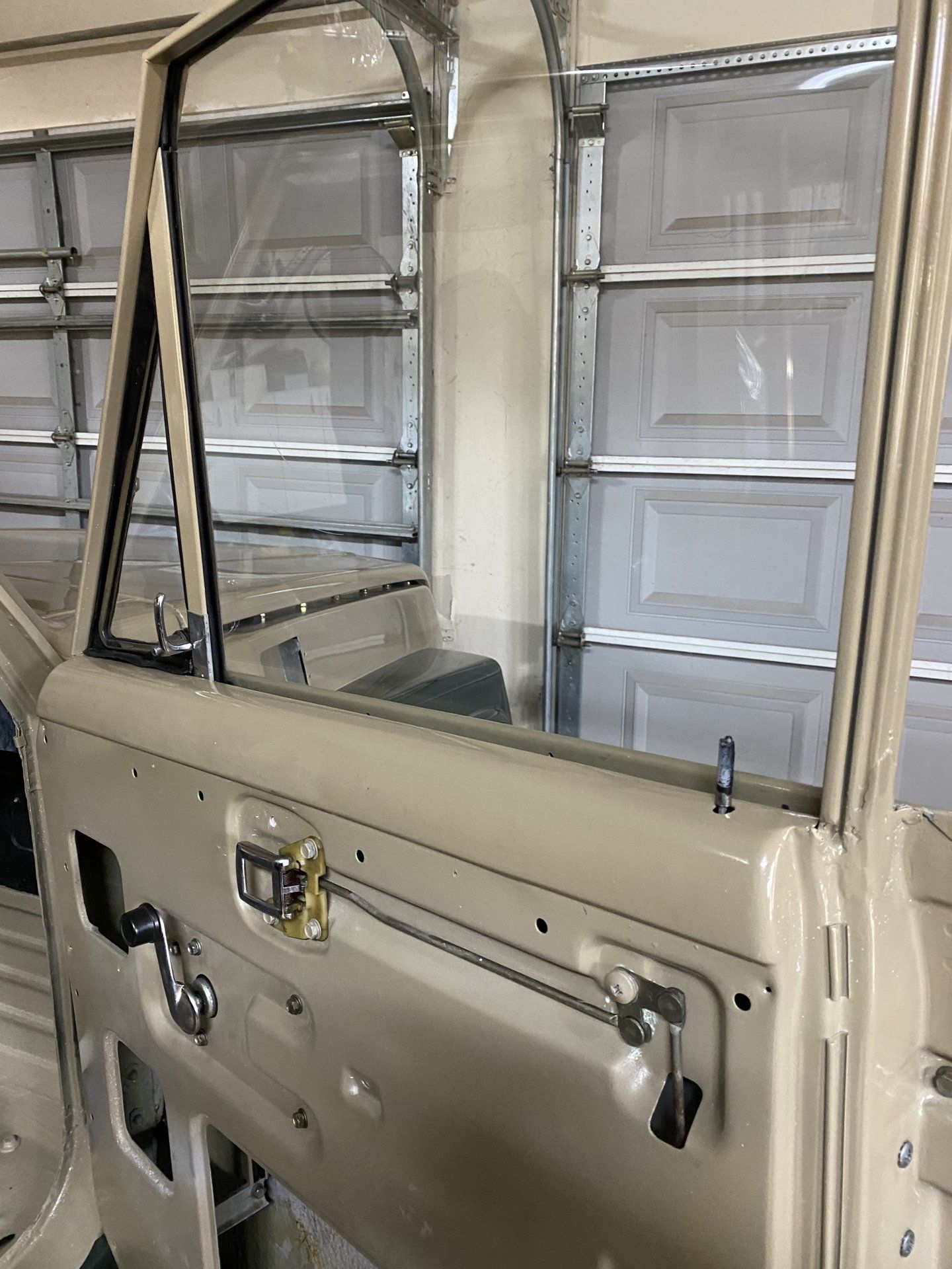

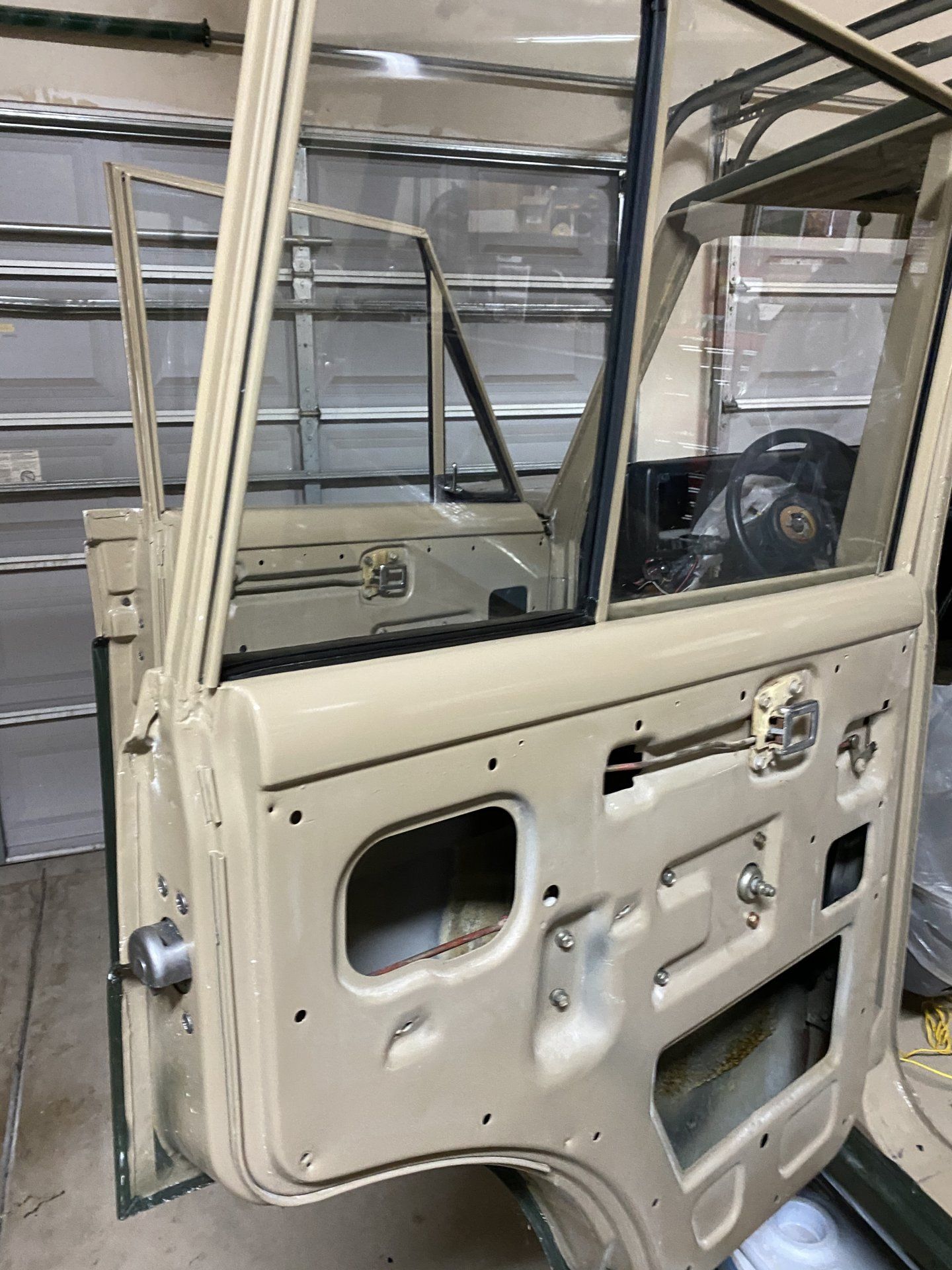

Tackled the task of starting to put windows in. Pain in the butt when you can’t remember from 8 years ago how the window regulators were oriented. It took a couple hours to practice then the second door went quick.

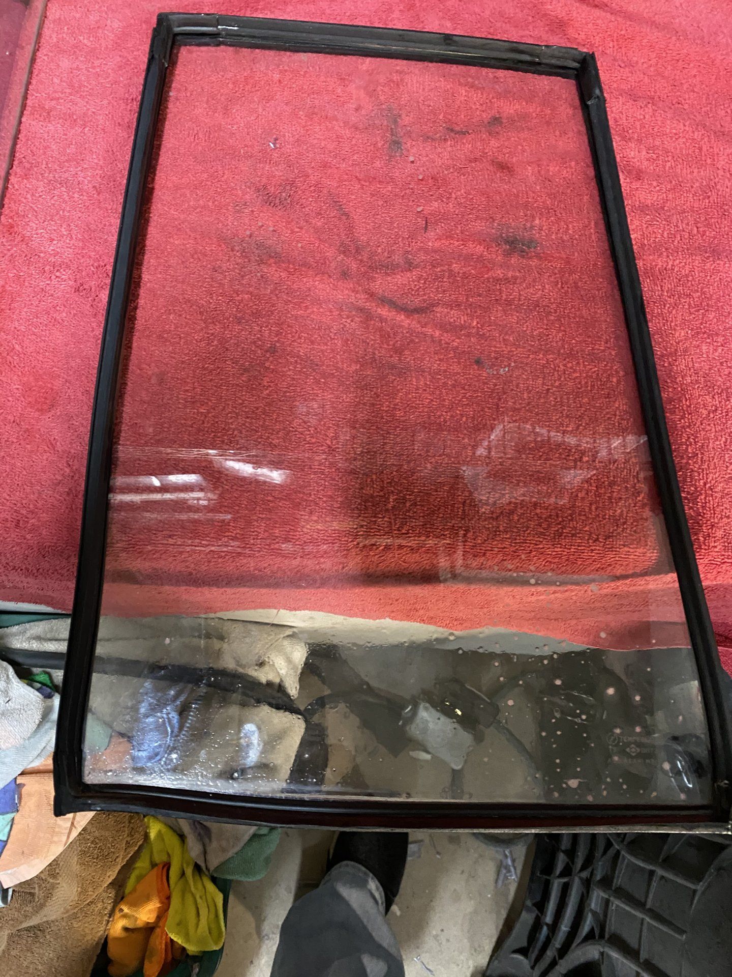

Wrestling with the fixed rear door glass wasn’t fun but I eventually got it situated and the rubber like it should be. Lacked completing one door before the wife called me in for dinner.

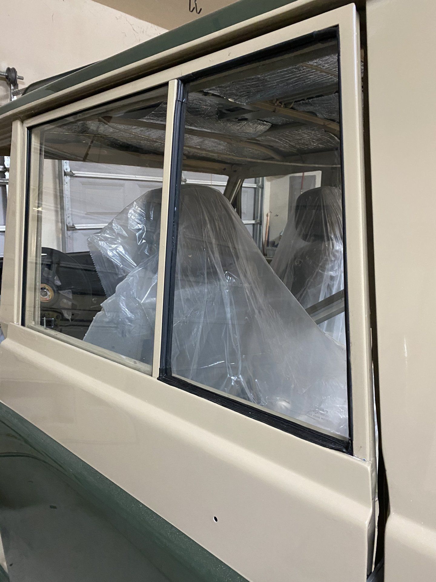

On the rear fixed window, I used lots of soapy water. Place the gasket around the glass and place the glass about midway in the doorway. You'll have a couple of inches of rubber into the track to make sure it's started. Place the bottom of the glass first, this allows you to manipulate the top a bit and since it's in the middle of the door, the top of the door has some flex to let the gasket slide into place. Trust me, the glass doesn't just slide into place the first time, or the second time, or the third,... I worked each side for 30-60 minutes. Once you've got the top and bottom situated, you can stand at the edge of the door and pull the glass/rubber toward what is the rear of the door. Be slow, make sure the glass slides horizontally or the rubber messes up and you have to start again. I could get the rubber close and then I used a plastic trim and molding tool from Harbor Freight to poke and push the rubber into to place and slide along the lip to help the rubber move into proper place.
Once into place, place the door runners (felt) in the track of the door. I used FAIRCHILD 06348 Door Window Glass Channel from RockAuto.com. Four 8 foot sections - Total Cost $83.73.

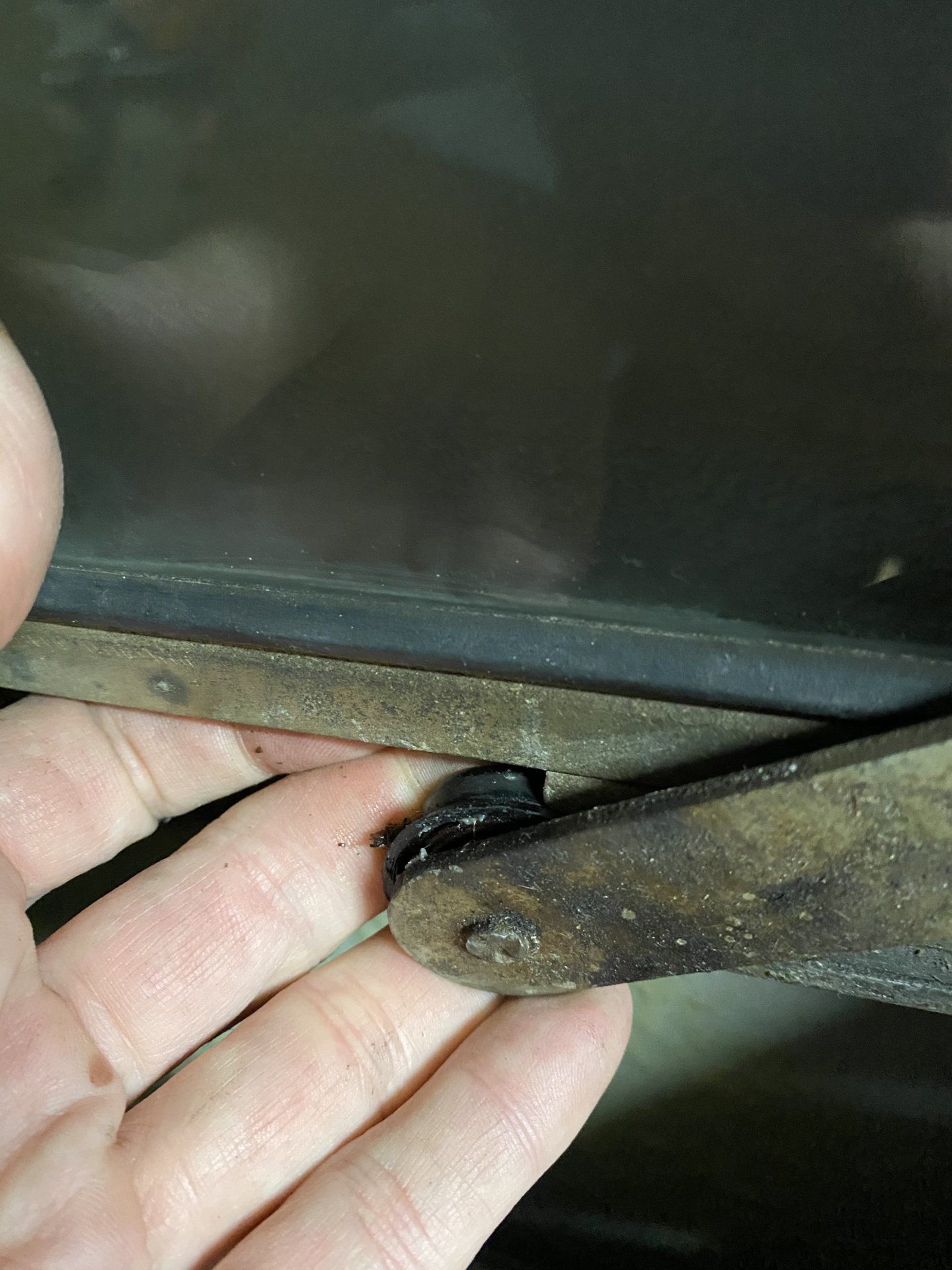

Place the runner in the divider section. Install the window regulator (if not already installed). Insert the glass into the door and attached the bottom to the regulator. Jamb the glass into the door runner track that's permanent in the door. If it's new runner, it will likely hold the glass while you insert the window divider section (for the rear, or the wing window divider for the front). As you install the divider, make sure the runner groove starts to mate up with the corner of the window glass. The divider will go in at an angle and you'll be able to position it more upright as it's inserted.
Once the divider is in place, I raised the window part way to ensure it was tracking and it also holds the divider in place while you insert screws in the door frame and bolt the bottom in place.

The rubber around the stationary rear window, pinches and gets dislodged easy as you try to slide it so repeat and have patience. (lots of patience)

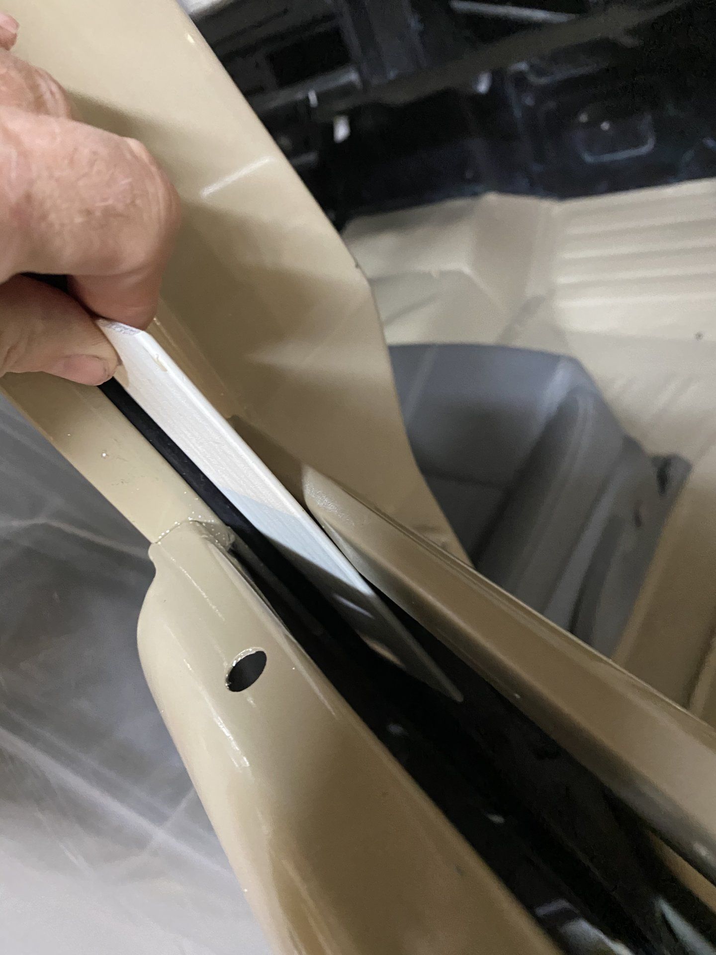

As luck would have it, I didn’t follow my key learning from my previous post. I installed the fixed window before I set the roll up glass door in the door.
So I captured a tutorial of putting the back door together.
I had to remove the fixes window.

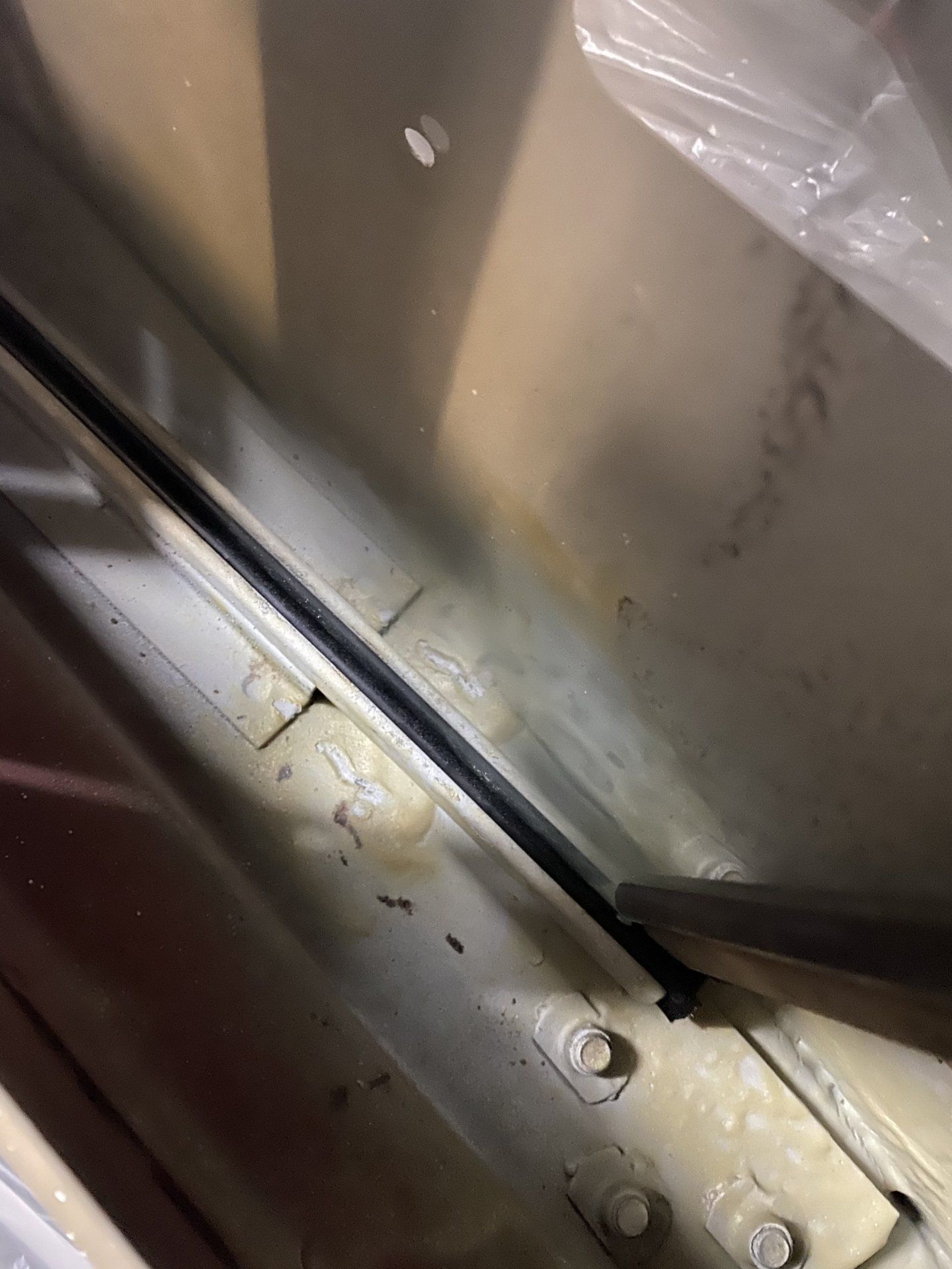

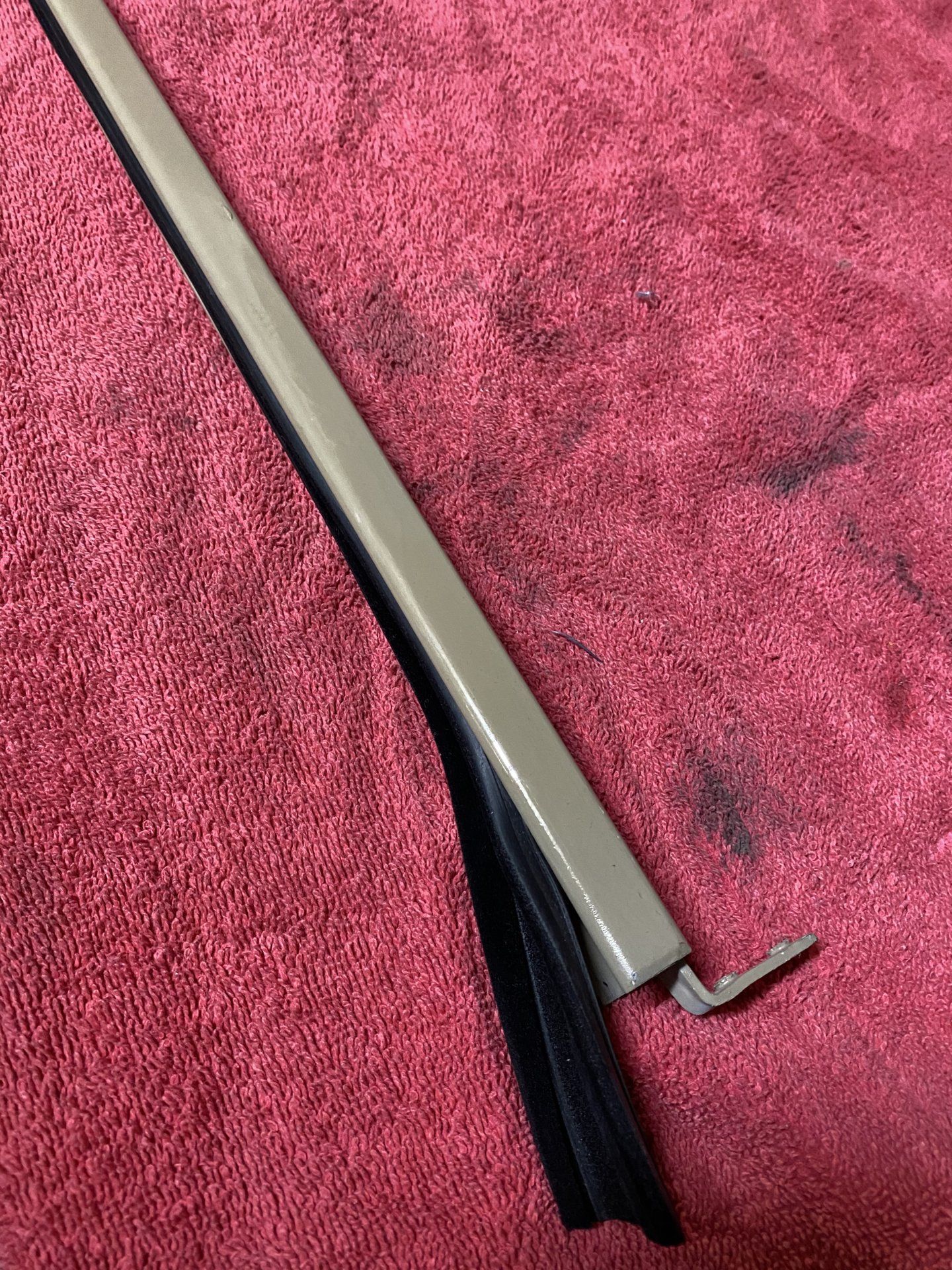

Install the window channel in the divider and leave some to trim once it’s installed.
Bevel the ends for the corners.
Install channel in the door. You might have to use something to push it into place where you can’t reach. Then install the regulator.
Set the roll up window in the regulator and place the edge in the channel.
Move to install rubber on fixed window.
