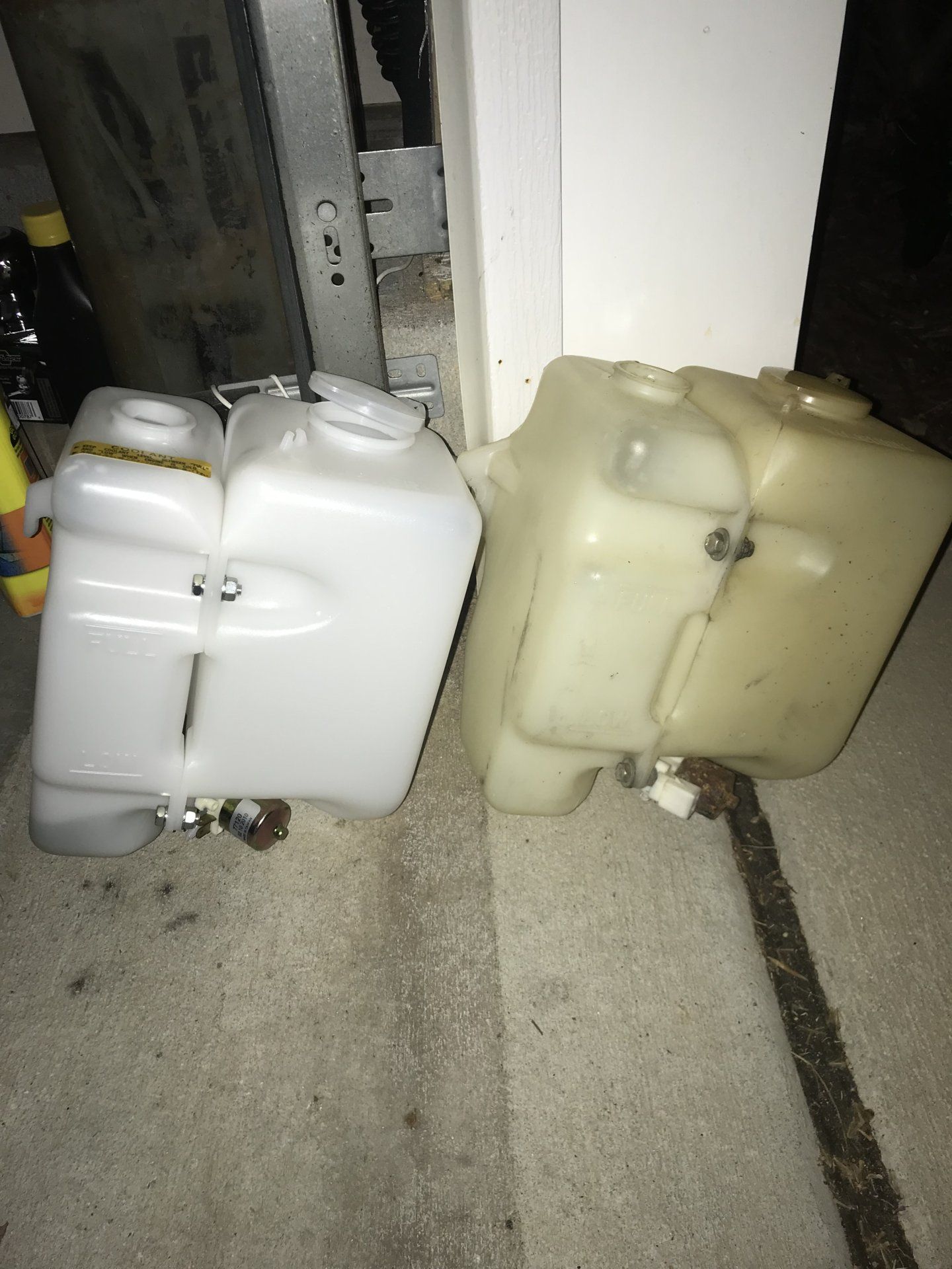

I also installed a new washer/coolant bottles and Anco washer pump p/n 67-14 since the 79 version is NLA. Had to pull the factory plug and replace it with one that’s compatible with the new pump. The factory wire terminals fit the new plug exactly. It’s not a waterproof connector like the one it replaced but some dielectric grease should keep the terminals nice.
It happens to be the same plug used for several things in my ‘79; radio, rear side marker lights...

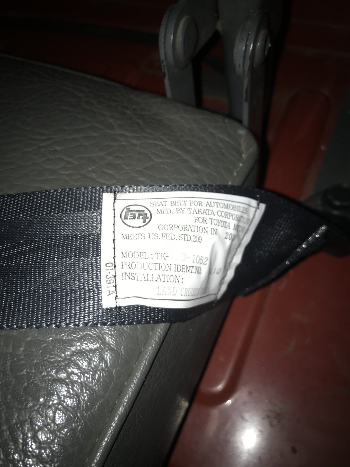

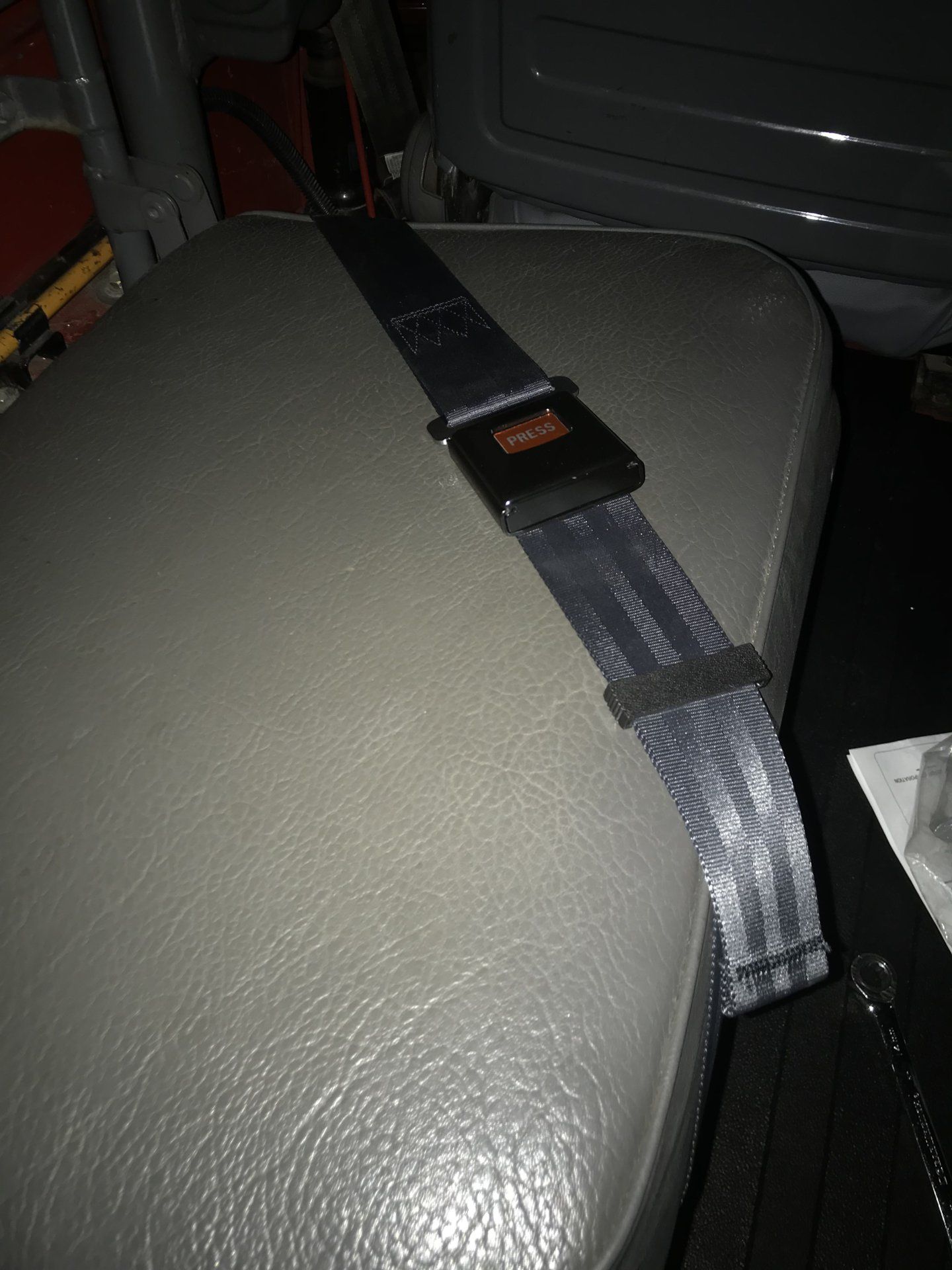

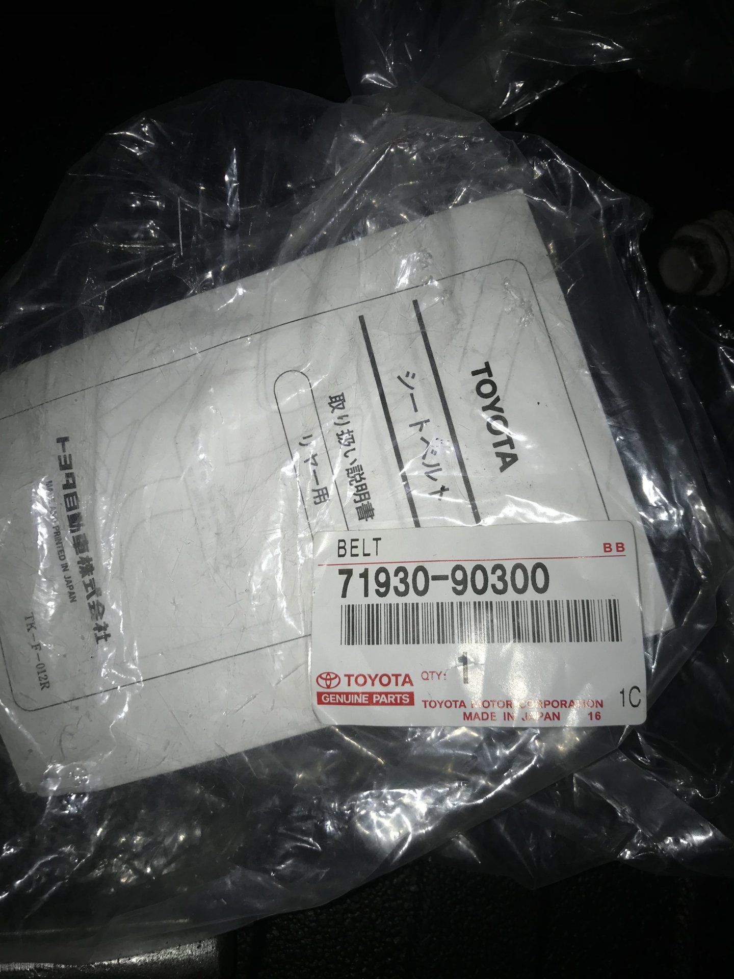

Installed some new toyota rear seat belts. They aren’t the right color but put them in anyway until I can find some grey ones.
