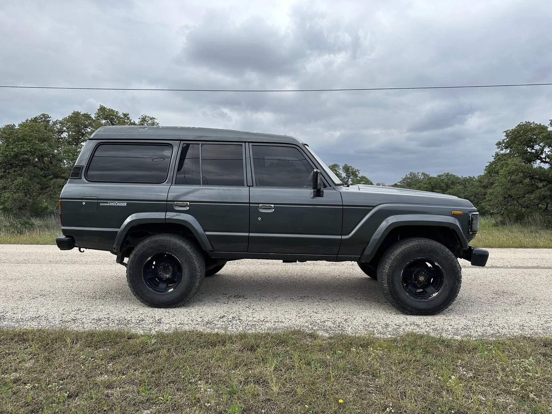

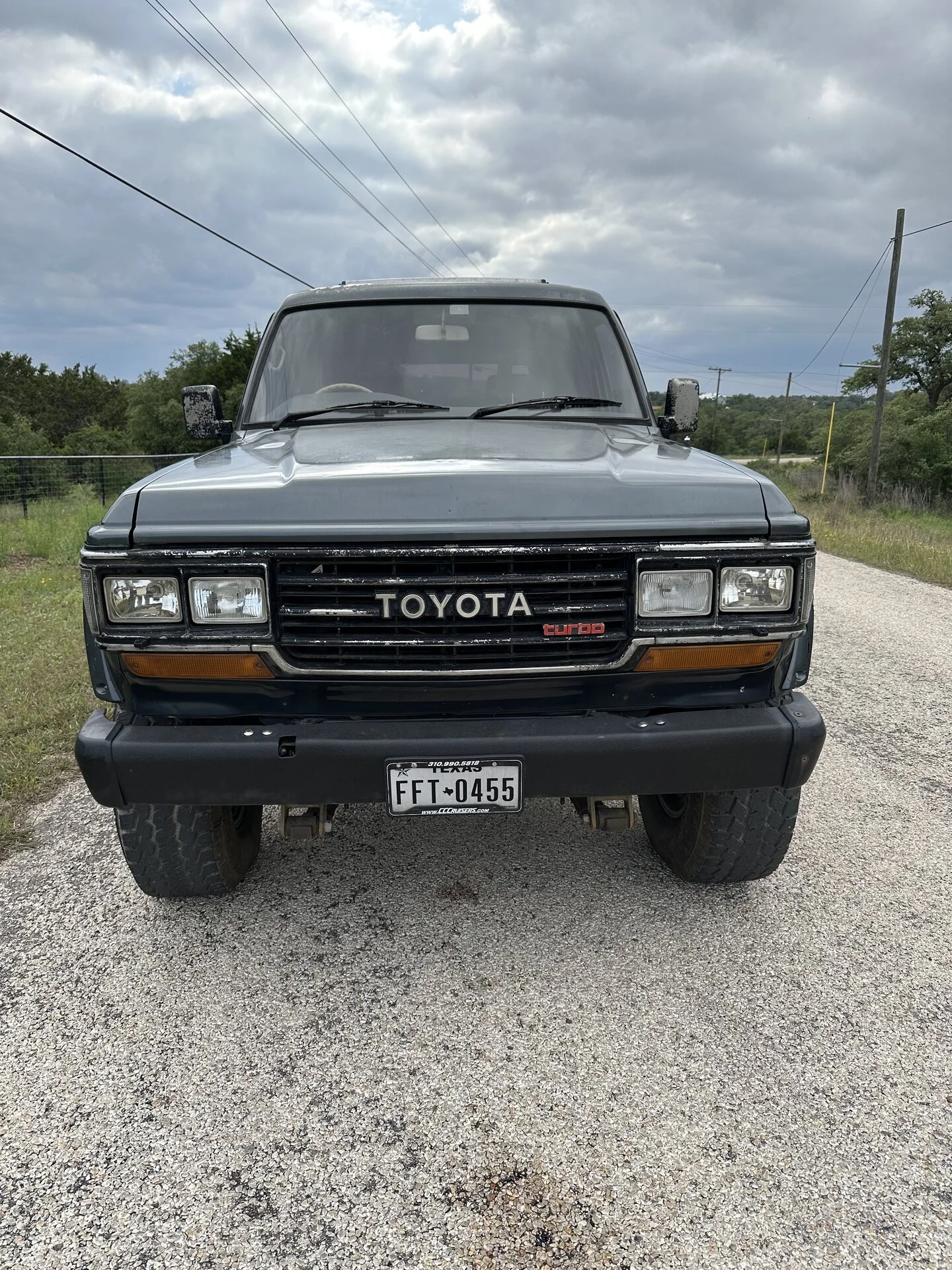

A little backstory: I grew up in a family that was always doing outdoor activities. From the rugged dirt roads of Big Bend to the thick sand on Padre Island National Seashore, having four-wheel drive on the family's 2001 Ford Excursion was a necessity. My buddies in high school led me towards sports cars, but as quickly as that interest began, it ended. For the past four years, I have been browsing the web to find a vehicle that would bring me back to my roots. After finding out about Land Cruisers and doing lots of research, I knew this was the vehicle for me. Fast forward to now, I'm 22 and have just landed my first job as a firefighter in a place where I can finally afford one. I've finally pulled the trigger and purchased an RHD 1988 HJ61. It's time to find out what the hell goes on in Jimmy's garage!

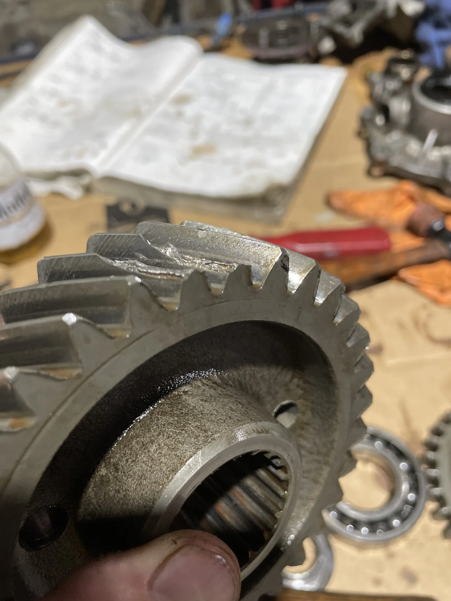

Jimmy @CenTXFJ60 helped me find this Land Cruiser. He helping me with baselining in his barn. So far we have gone through and flushed/ replaced the coolant and oil. Working on swapping out the current automatic for a new 5spd. Ran into a few problems while taking apart the transfer case.

T-Case update/ rust repair

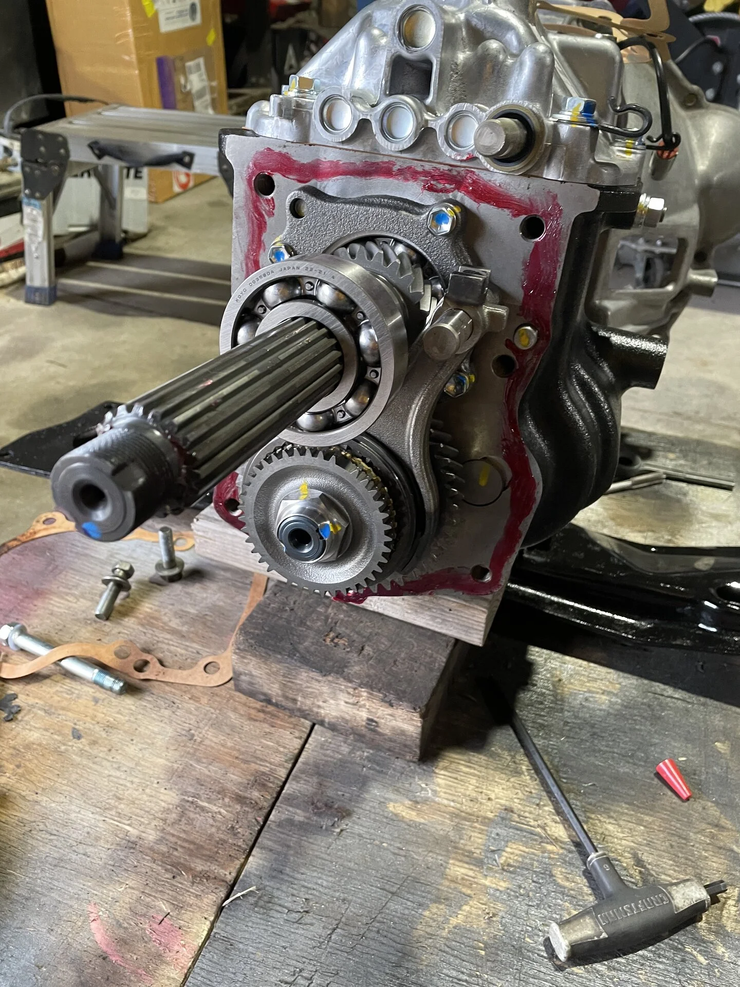

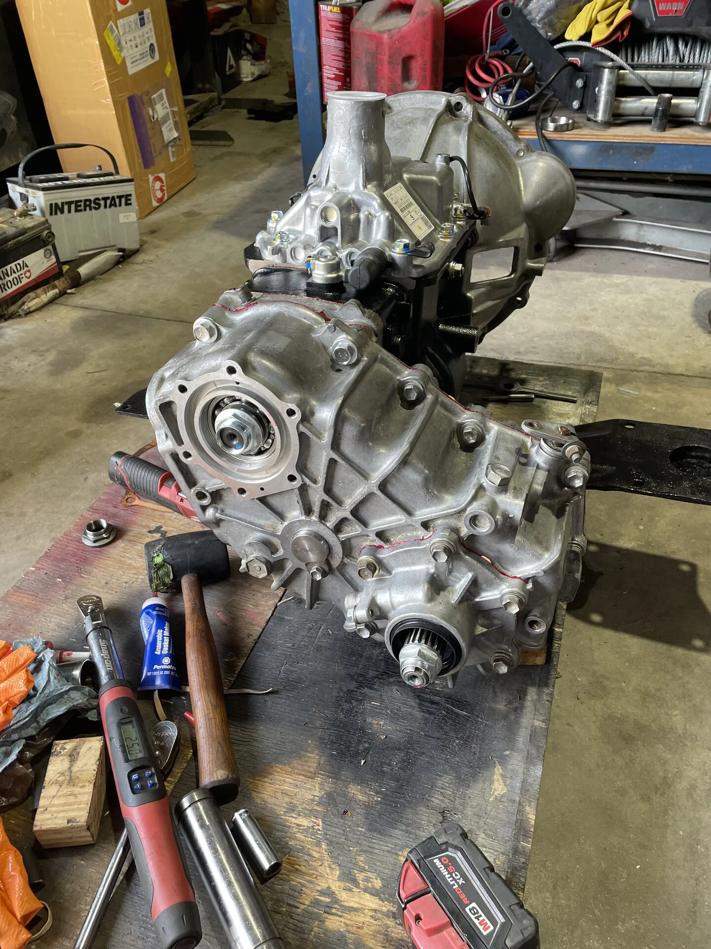

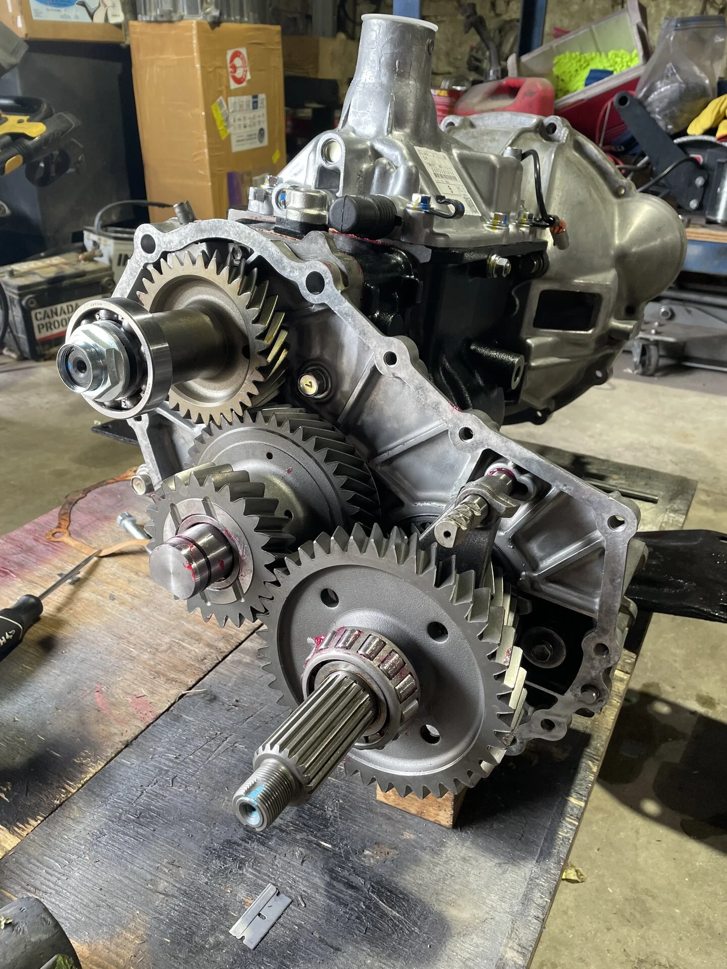

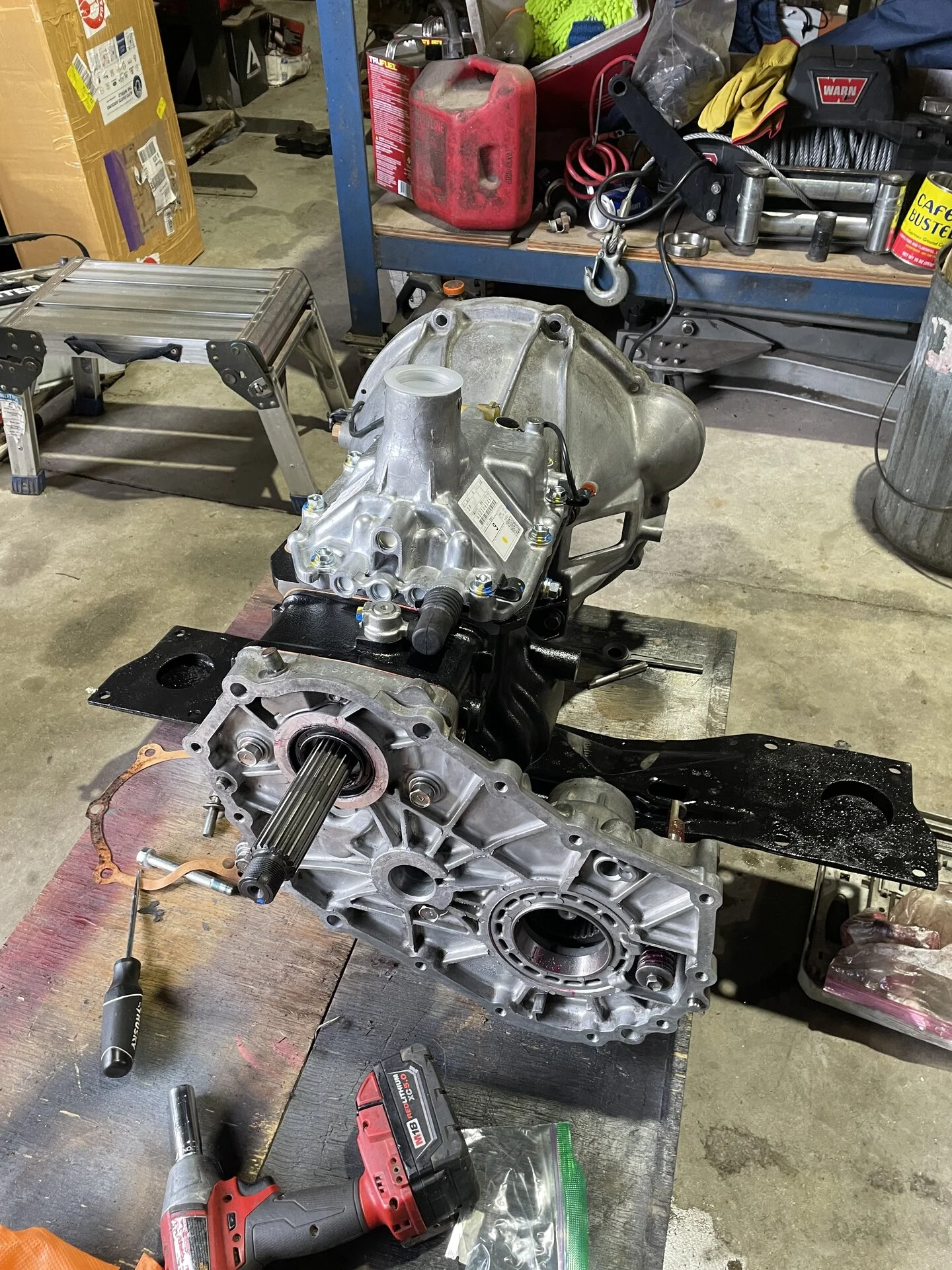

All new gears have arrived thanks to @orangefj45! Starting to rebuild transfer case. Hopefully next week @CenTXFJ60 and I will start to put everything back into the truck.

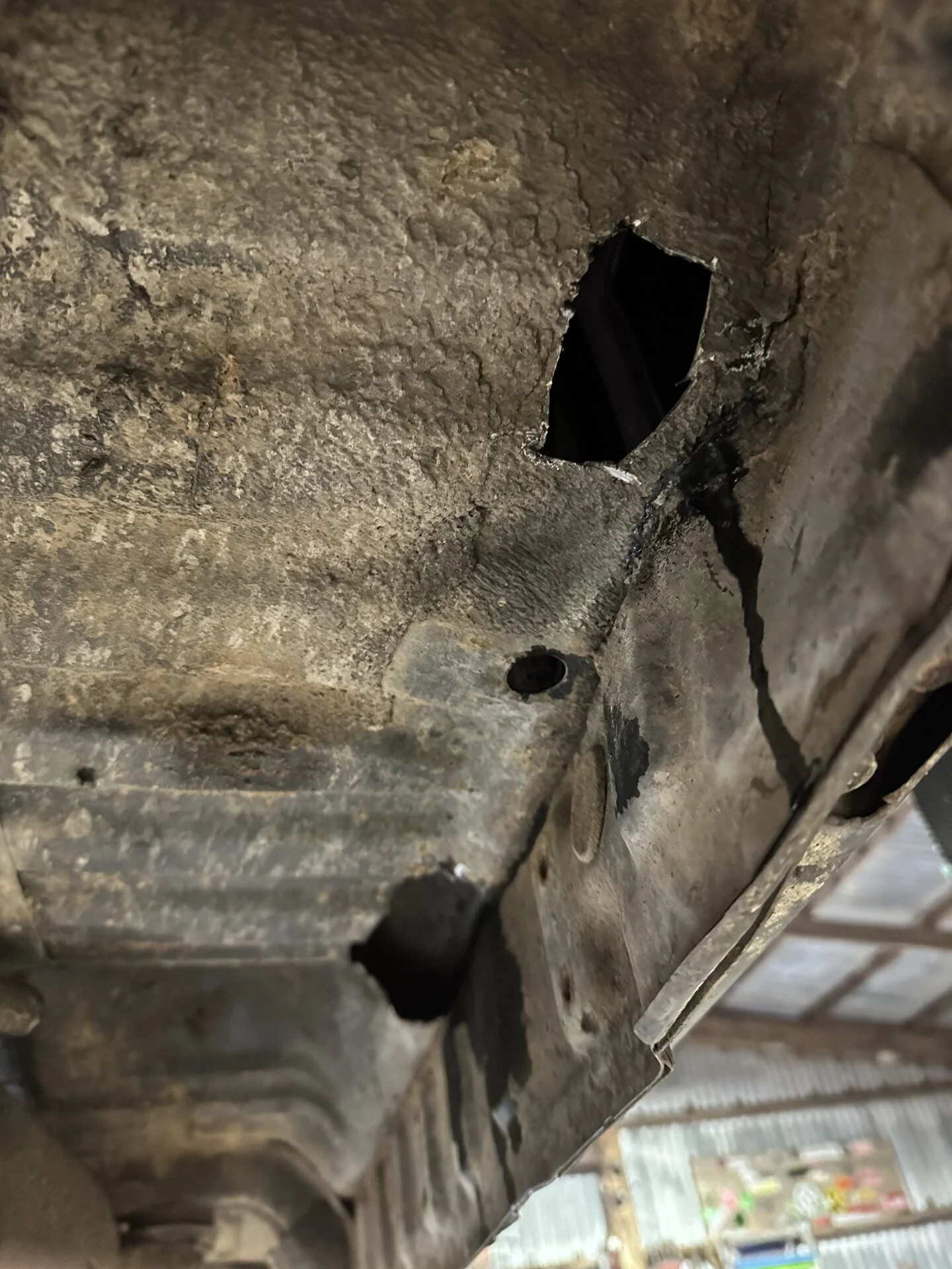

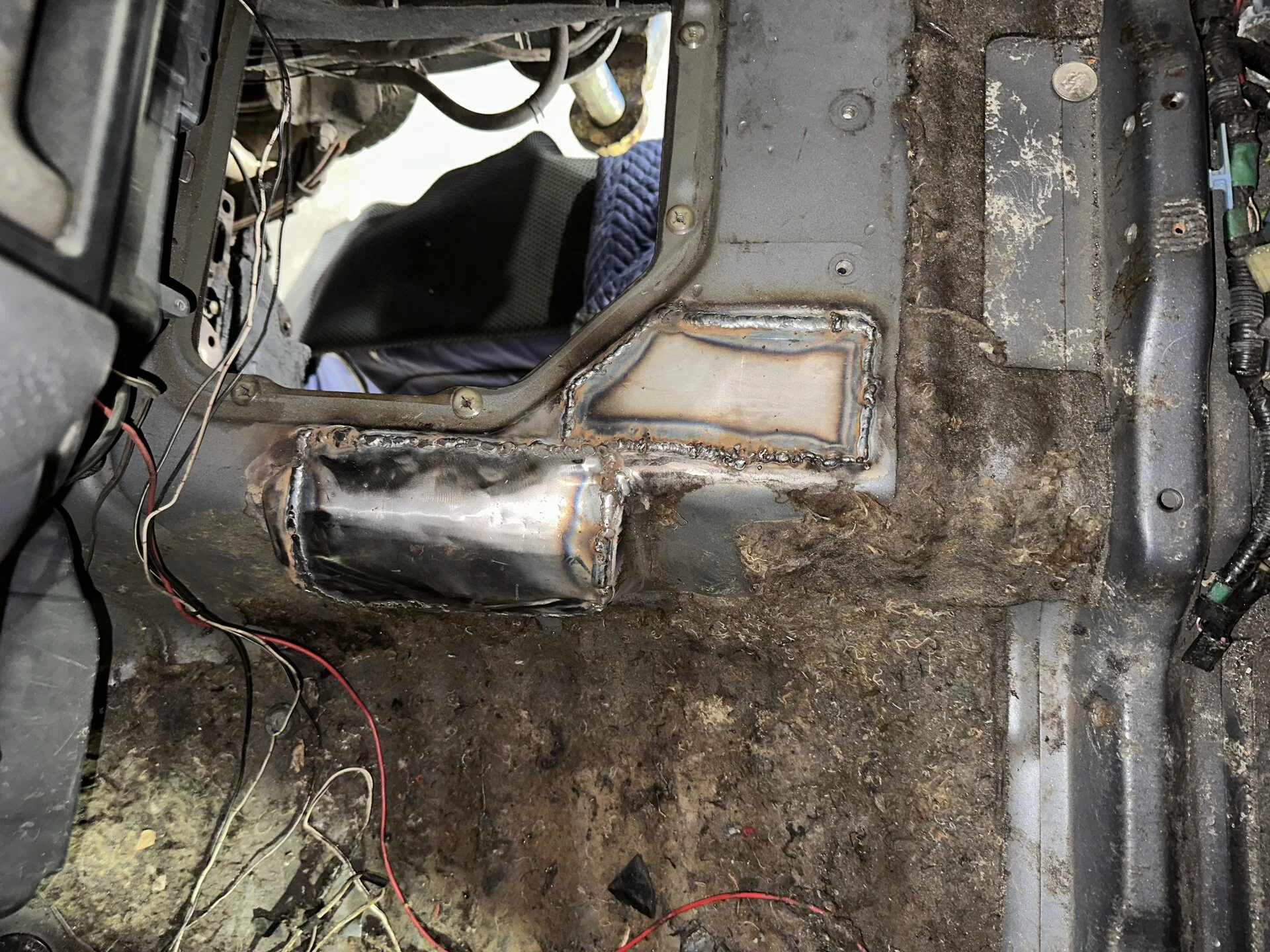

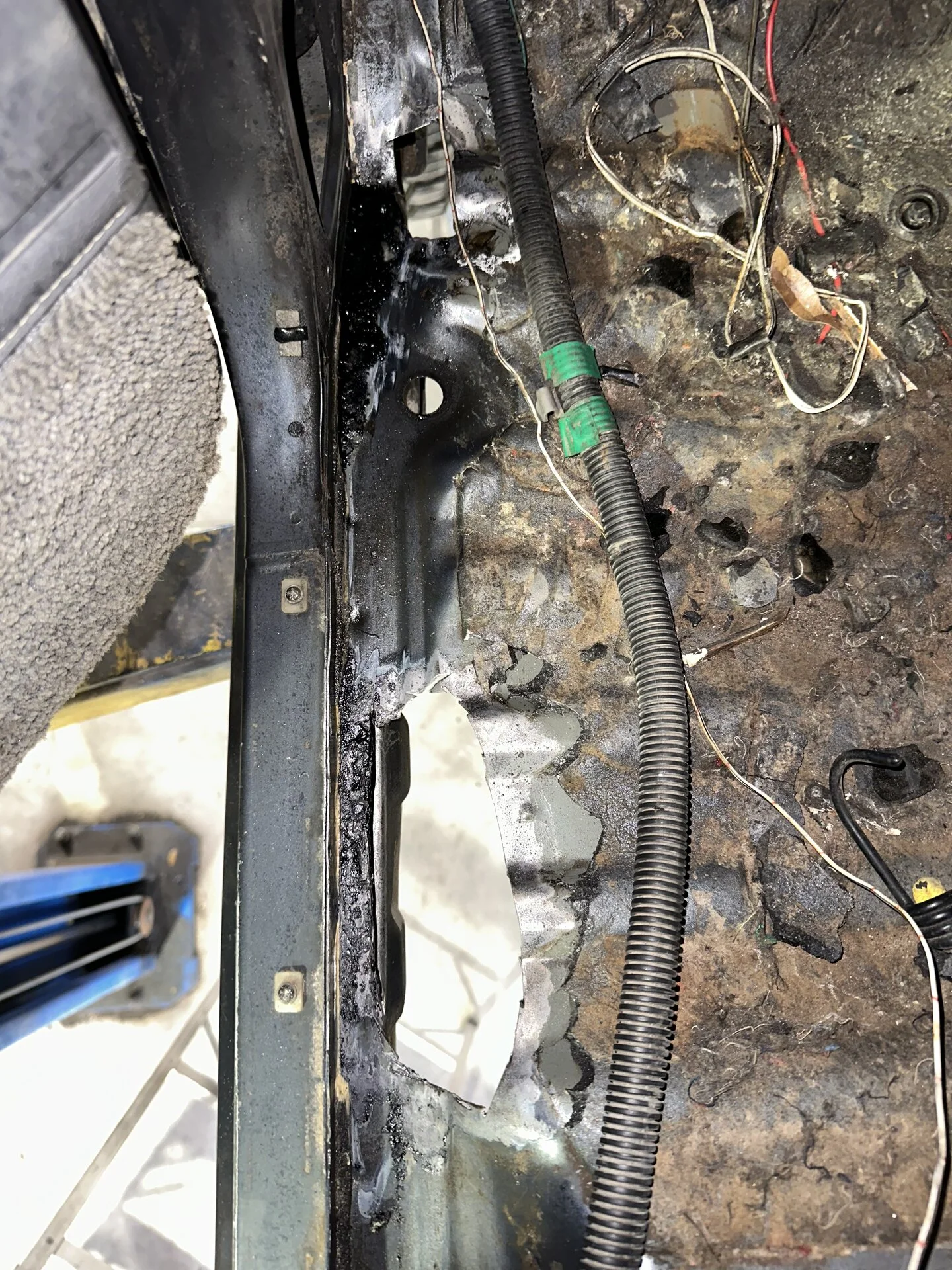

Also took care of the rust in the passenger side floor, and closed up old auto shifter/ pto holes. First time welding as well so that was cool!

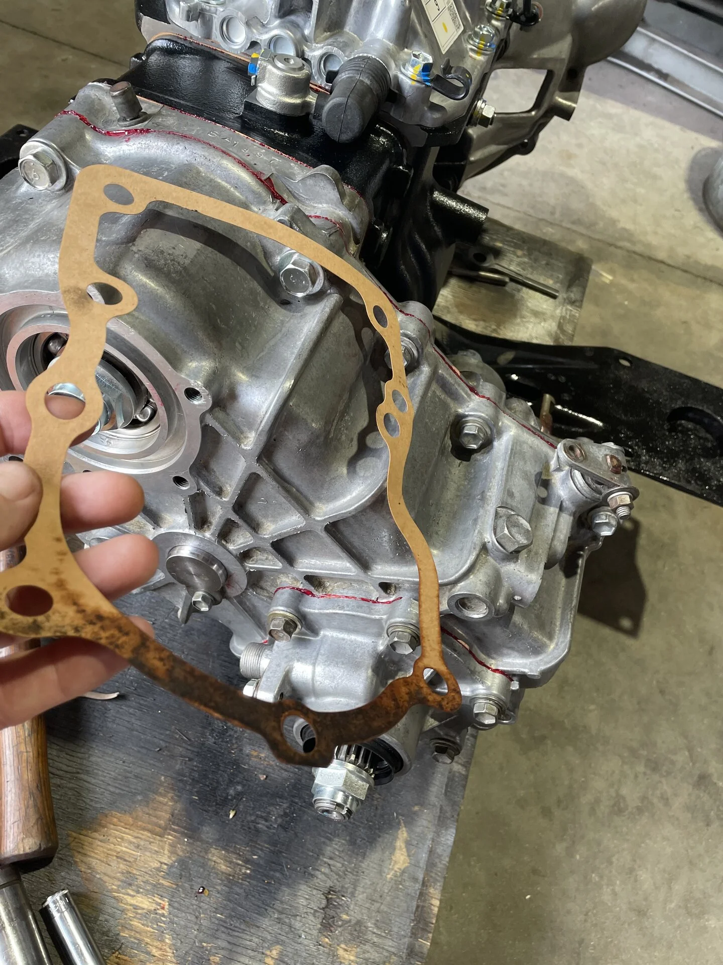

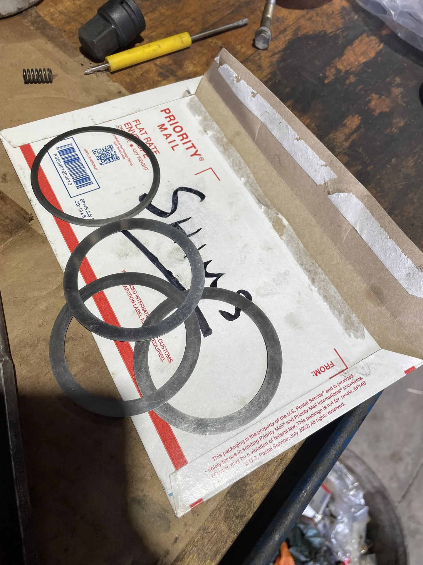

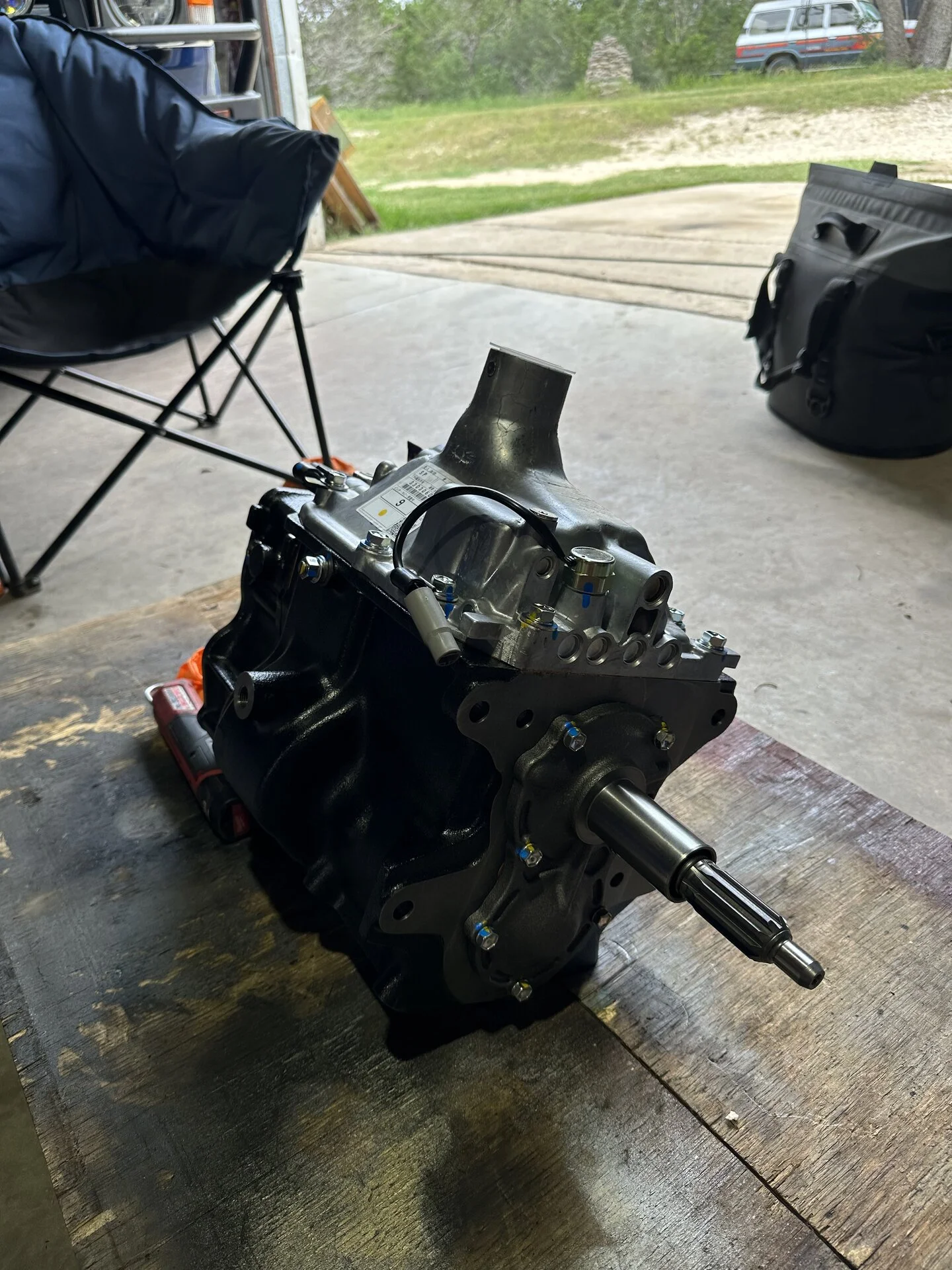

I’ll post an update since Mason is off playing fireman for a few days :). JK…well, he is actually at work and even tho he wanted to be here when stuff was getting done on his 61 we both agreed I should keep rolling so he can be rolling down the road sooner than later. T-case is done except for torquing the input and output nuts which I’ll do once it’s under the truck. If you watched one of the above videos you saw that we were at 2 inch pounds on preload. Had a lot to do with the jacked up gears etc. with new gears from Georg and a new bearing/seal kit the preload was just under 13. The acceptable range is 13-21.4 with new bearings. Since everything is new in there I deleted one factory shim and added one from a kit we got from VH’s. Now we are at 20 inch pounds. Gonna get the flywheel/clutch loaded in and possibly stab her manana. Then I’ll weld up the bracket kit from TorFab. Also, showing a pic of the paper gasket that’s between the trans and 5th gear spacer. I’ve had two in a row brand new H55’s where it’s all nasty at the bottom for some reason. May have to do with conditions during transportation and storage with in the Toyota supply chain.

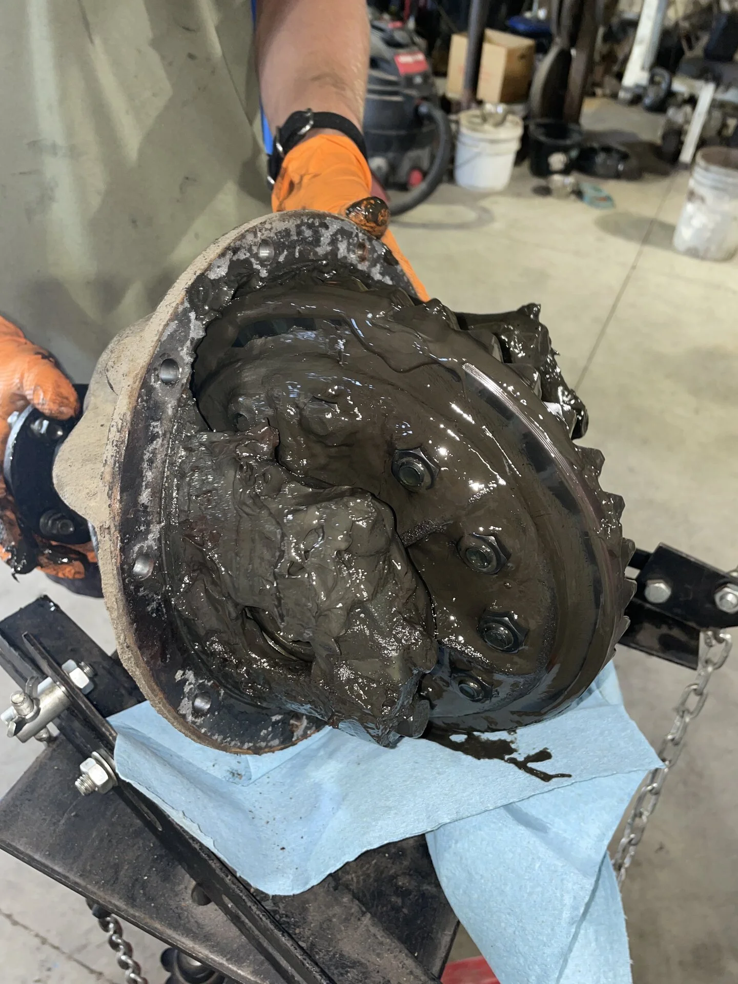

Knuckle job chaos

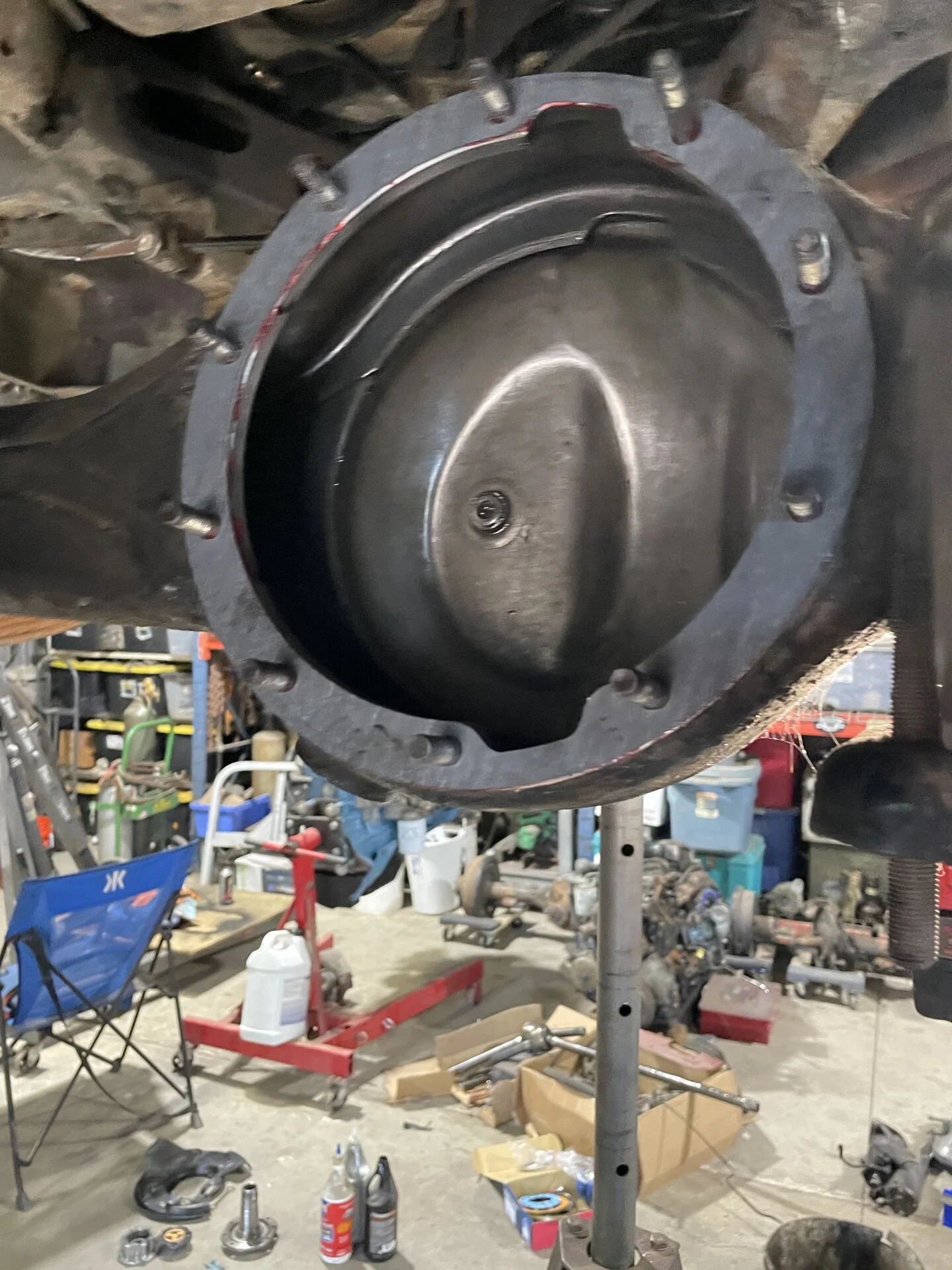

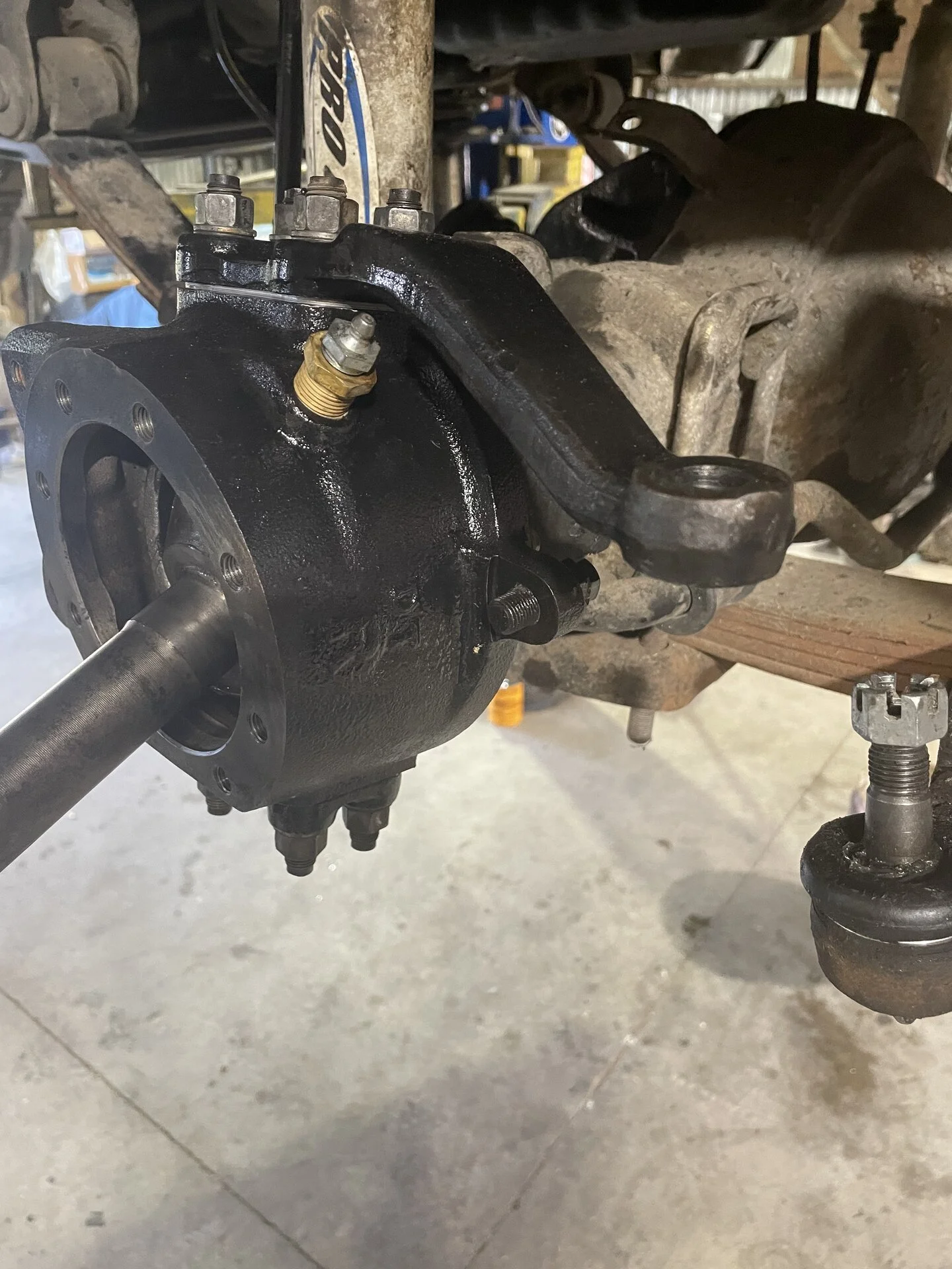

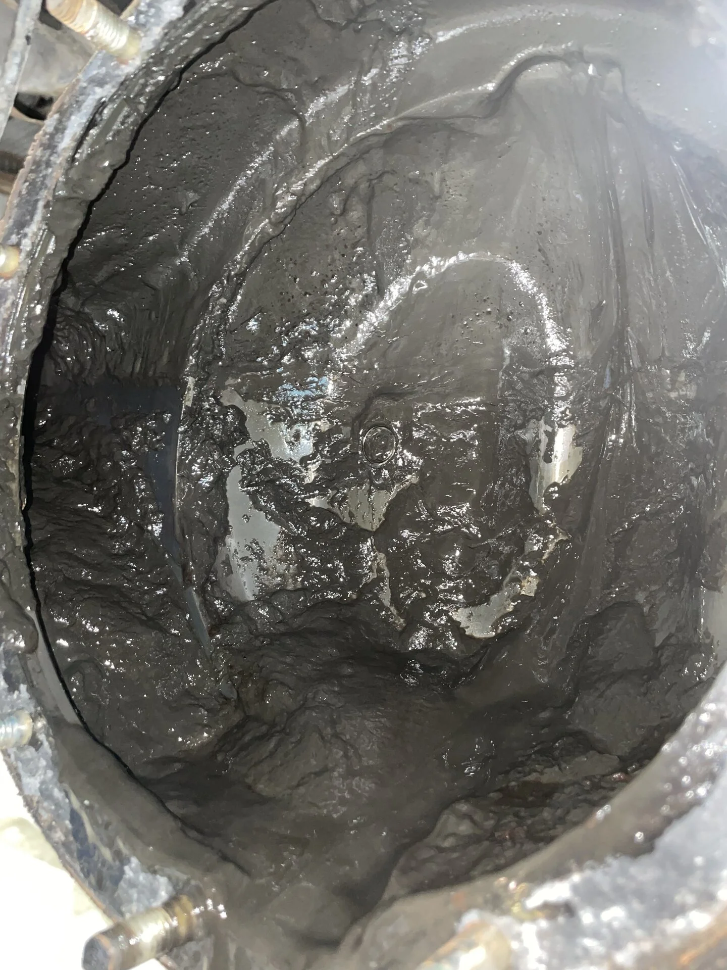

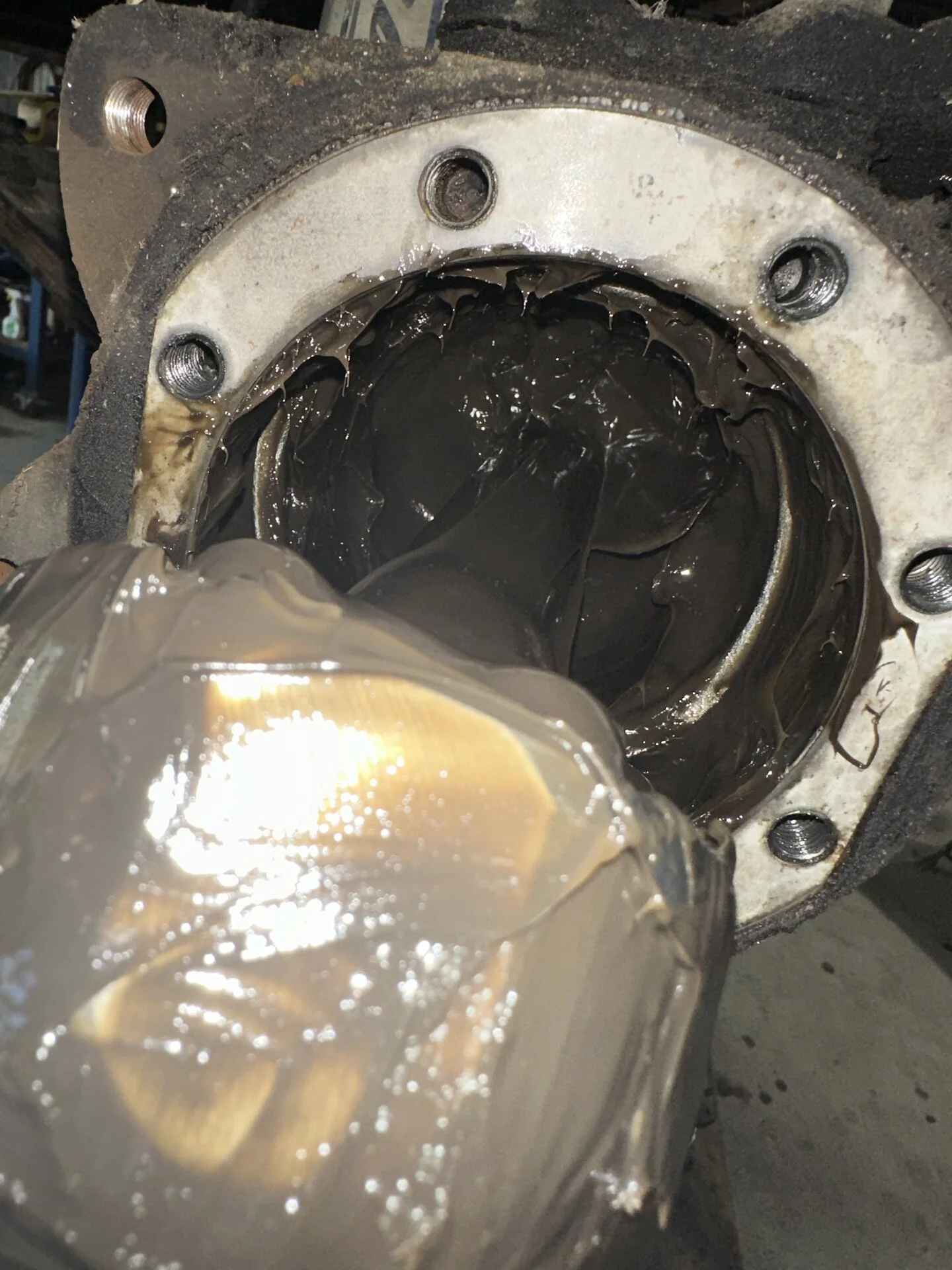

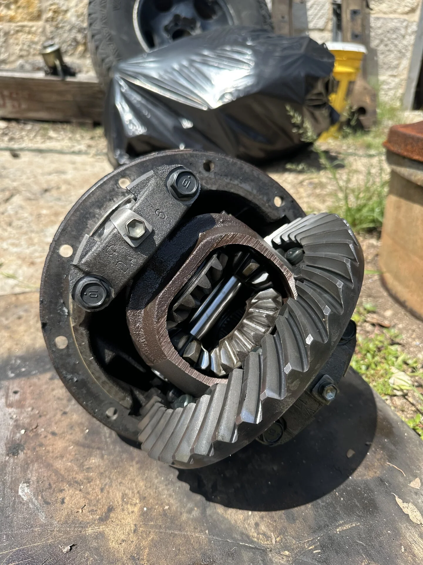

Safe to say things don’t always go as planned. @CenTXFJ60 and I decided to tackle knuckle job and breaks while we wait for driveshafts to be lengthened. Took apart knuckle housing, grease looked good but there was a suction when trying to take it apart. Once opened up, there was much more grease than we were hoping.
Turns out, PO may have been regularly adding knuckle grease through an aftermarket valve. So much grease in fact that it flooded the entire axle housing and front differential.

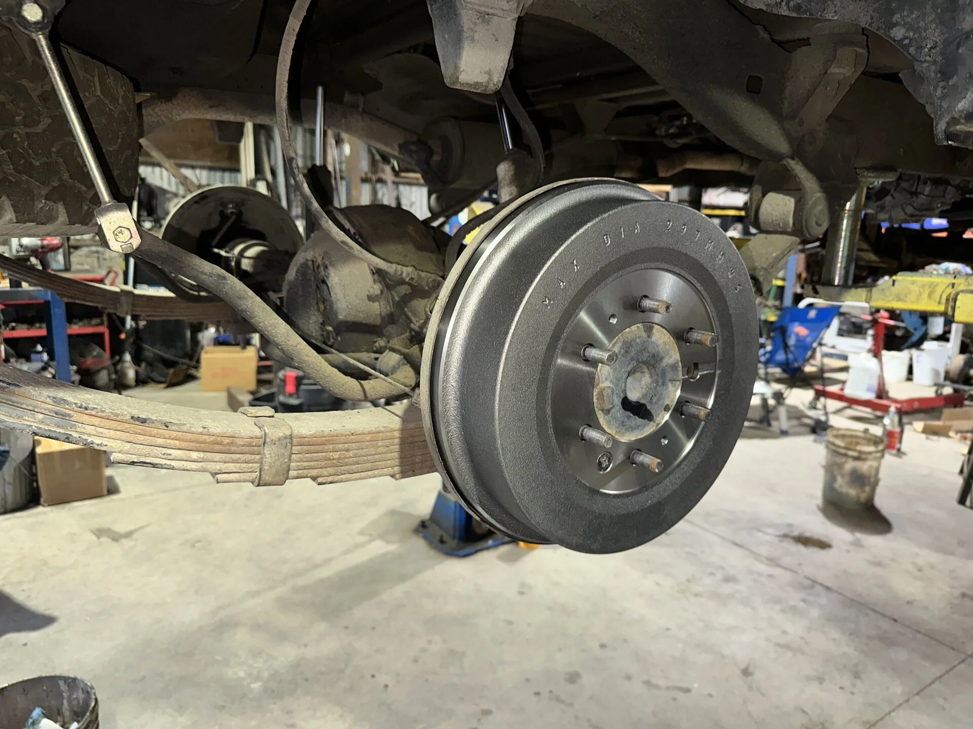

One role of paper towels, a pressure washer, and a few hours later, things are cleaned up and looking nice. On the bright side these new rear break drums do look very good!

The should rarely need to be greased. Someone put these fittings in place of the plugs and I’m assuming a Previous owner was over doing it year over year
@CenTXFJ60 The photos of the transmission & t-case assembly are pure art. Beautiful.
