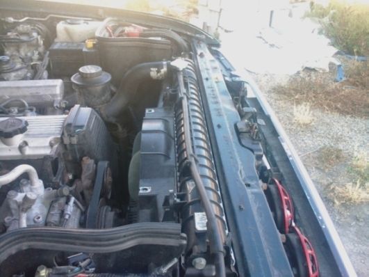

Better late than never Mike.........sorry for the delay, under bonnet first, inside follows.
The under bonnet shows the Aux battery that runs my fridge, this is on the right when viewed from the rear of the car (drivers side UK), I ran the battery cabling under the existing radiator shroud, this not only tidied it up across the rad it also makes way for my proposed electric fan install at a later date. The start battery Blue Seas marine switch, this can be operated manualy in the event that the changeover battery is flat, there is also a lockout facility as well. You can see a small bundle of wires that need to be covered once I have finished the loom binding from the solar panel as I may need access to them at a later date.
regards
Dave
