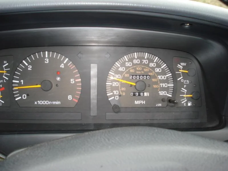

Well there we have it 200,000 miles and still going strong! Having now owned the car over a year I am now starting the import process, a pair of right dipping headlamps are on their way from Germany and I need to do some other minor stuff for the engineer who will be looking the car over (a mega version of the yearly inspection) and fingers crossed. I am now looking for a couple of LHD headlamps that have the electric adjustment a my RHD units will not swap on to the new lamps, if you know of any at a sensible price please let me know and perhaps we can have a deal? The plan is to use the glasses from my 'E' marked lamps and graft them on to the USA LHD housings once it passes inspection.
regards
Dave
