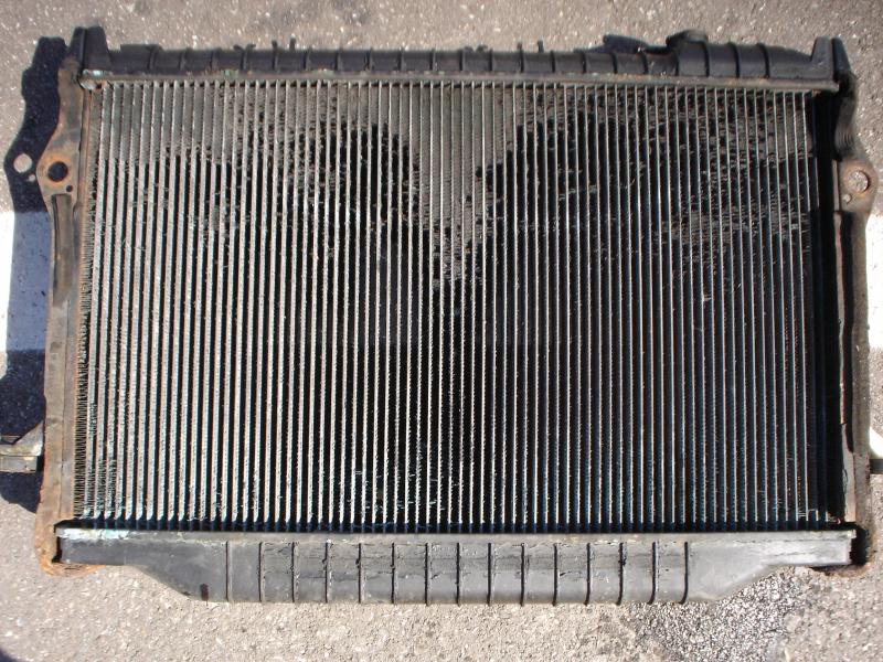

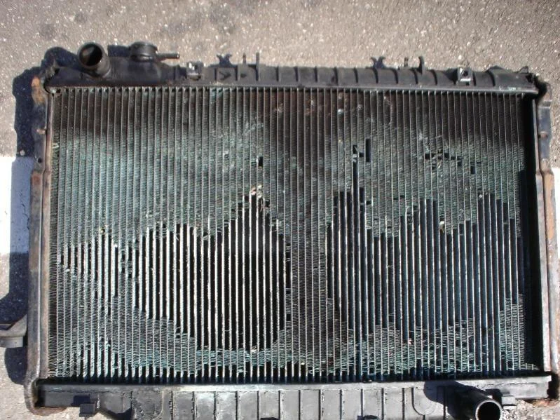

And what was I up to over the holiday? Well I removed the old radiator which I knew was falling apart but never lost a drop of water over the last three thousand miles, the pics say it all.

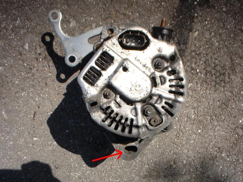

I also found some mornings my fan belt/s would squeal for a few moments until the charge to the batteries lowered and the belts gripped, the PO thought the adjusting bracket was broken so in preparation I had already purchased a new assembly including all the bolts ect, I had also purchased new top and bottom hoses to go with the new rad. Well once the radiator was out I could see the alternator bracket was intact so removed the alternator for a closer look, the bottom bolt hole was elongated allowing the alternator to twist on it's mount. The bracket on the engine had also taken it's fair brunt of wear as well. As it was the holiday weekend I could not get a new bracket so reinstalled the alternator with two packing washers and two new belts and pulled it up tight.
It is now in line with the pulleys and there is no squealing, my intention as part of the expedition mods was to fit a higher amperage alternator ect so I will replace the bracket at the same time, for the present the original alternator works fine.
I will leave you with three photo's of the rad and alternator, the rad is pretty impressive virtually no fins left and still not leaking a drop,I have looked the the service history and there is no mention of a replacment radiator so I must assume it is original, I have replaced the rad with a pattern aluminium/plastic which appears to be identical to the original except I decided to fit an automatic version, my plan at a later date is to pipe water through the radiator transmission cooler for warm washing water for use during off road stints ect.
Just a note, the top two radiator bolts are sleeved and both snapped on removal, it is OK to put back a couple of conventional bolts but the rad is not supported properly within the rubber mounts so they are on this weeks shopping list!

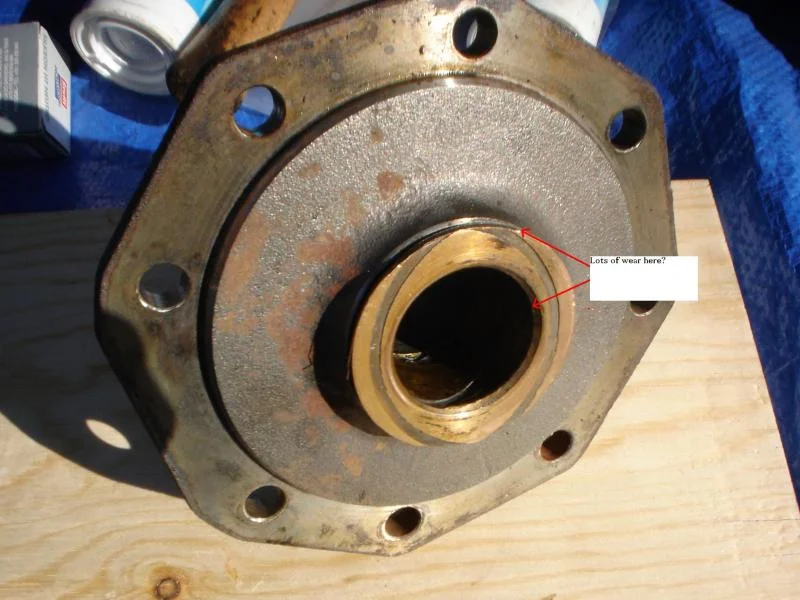

OK next update! Friday I started the front axle overhaul stripping, cleaning, greasing and reassembling ect. The RH side (drivers on mine) went according to plan and this side was the one where the swivel was nice and dry. Apart from a split pin needing to be drilled out of the steering drag link all went well.
Now to the other side, this one was leaking oil/grease quite badly and finding the breather blocked was nothing new however, once I had dismantled everything and started to clean I found the CV or Birfield had a strange wear mark on the outer ridge of the CV body. It seems the bronze bush in the front cover is badly worn? The birf flaps about inside the cover like a prick in shirt sleeve! So that will be ordered Monday evening, the joint does not appear to have any damage on the bearing surfaces and there was no nasty noises either, has anyone seen this before?
I have added a couple of pics for your perusal, also having heard of forum members in the past having their front lower arms work loose I decided to replace the four studs on each side, these studs are a 'torx' style and fitted nice and tight with a little loctite. The brake pads have seen better days so can someone post me the Toyota part number for the larger pads that have been fitted on 80's to reduce or at least slow the wear rate please? IIRC they were for a 100 or 105 series?
I will get back to you later this week when the other parts arrive.

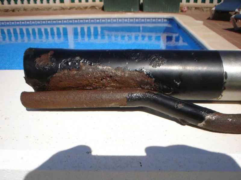

Well another job crossed off the list, you may recall I had a small leak when filling the tank? This only seemed to occur when either using a high speed commercial pump or if putting in a lot of fuel from a standard type pump.
The leak was getting worse and I had to keep fuel to a minimum, I could not put in for example 50 litres as a lot ended up on the floor, if I put in perhaps 25 litres slowly I hardly lost a drop but it was a bit of a pain. the problem was caused by corrosion where the fill and vent tubes are welded together, I have attached a piccy for perusal and no it's not my pool/house, the small pin holes are obvious but to the left of them you can also see a crack where the two pipes meet, this brought about a veritable shower under the car!
I assume the paint did not take too well and bearing in mind my car was from one of the wettest areas of the UK it is no surprise there was a problem. A phone call to a not so local dealer told me he was going to reduce my wealth by a rediculous 78 euros plus taxes and it would take a week to get here!! :mad:
Yeah right, I went to the local boat builders yard and got me some flexible reinforced fuel pipe in the right sizes and then cut out the 'bad bit' with a dremel, getting a saw up there was going to be a RPITA, remember this is diesel!
New clips and new pipes and all is well at the pump test this evening all sorted for the princely sum of 18 euros with all new clips ect. :bounce::bounce:
