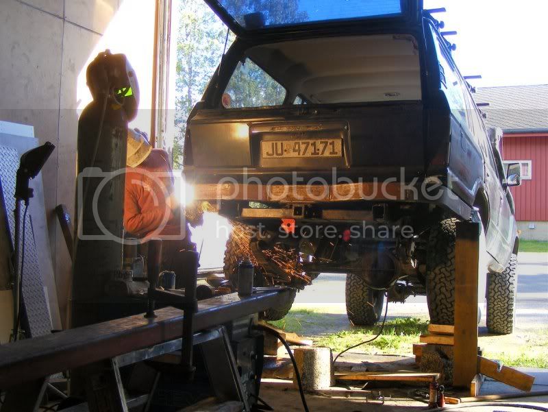

here goes the bumper build and rear chop...
Had lots of visions and plans, but scrapped all that and worked something out with what i had!:doh:
Not all that satisfied with the shape, but it works.
Just using 2x4" steel i had laying aroud, would love to add some solid plate (wich i dont have) to add a litte arb-angles and style, but once i add paint, tow points and diamond plate, it'll be okay.
I'll cut down the side sliders to 3" tall, they got the "sag look".
The shape idea was for it to still function as a step, but retracted in the middle for easy access to the hitch.
The 2" receiver is moved up 4" and forward 5". better angle back there now. still a lot overhang, but as good as it gets, can still drag it over rocks.

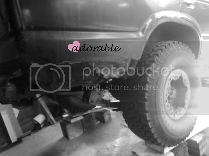

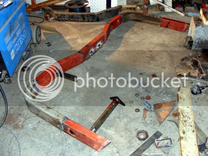

Almost done tacking the pieces.
Progress...slow progress...
Rear quarter... mud is filling up.... better get it out...

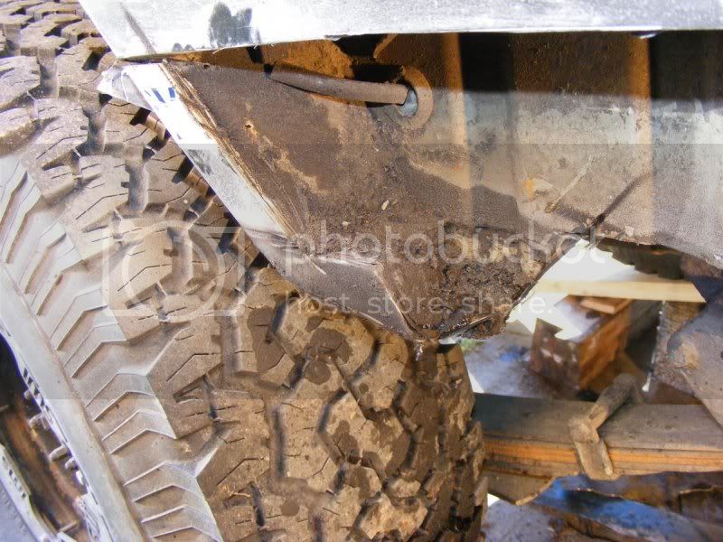

Second...i'm patching the rear up today or tomorrow. just gotta get some 0.8 thread for the MIG, and clean the area up.
I'm making a big flat U profile that fits nice up there. carosol from inside, welded outside.

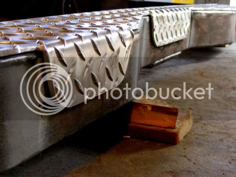

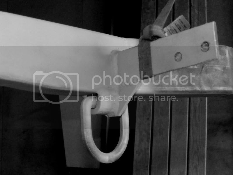

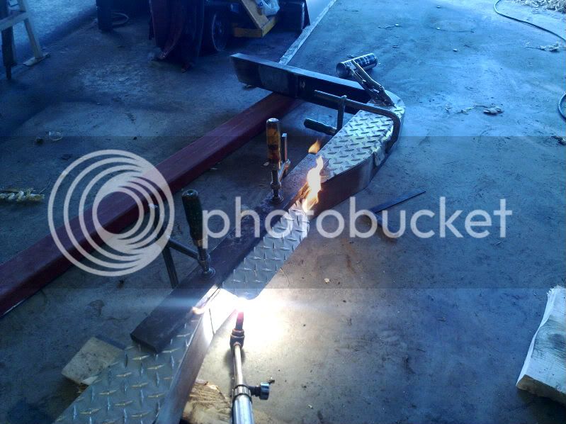

Close up of shaped alu...
One of many brackets to hold the bumper. Okay heat while welding.
Had to take the tires for a spin, they dig well and ride smooth.
Did some testing, they stuff well and all good. Now running 1" spacers.
Vacation over there? okay, i'm posting anyway... maybe i should add another separate thread on the bumper.

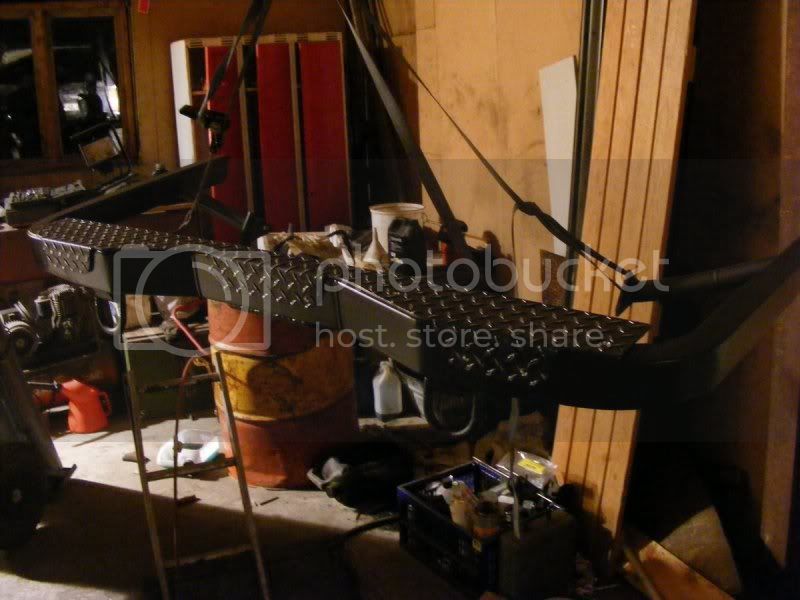

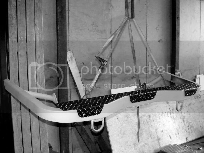

anyways, here is it, primed.
I cut down the quarter protection to 2,75" height, the rest of the bumper is 4"x2" dimention. Lots of work, but still worth it.
Next up is sliders and front bumper, same sleek style.
And i'll probably add some tubing to the sides for trees and steps.

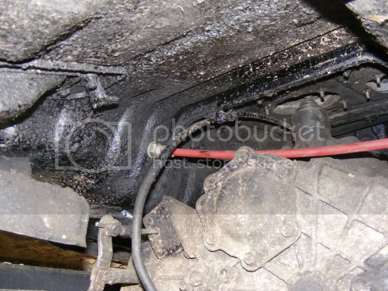

Hooked the locker acuator up with industrial wire/cable.
Welded the original grab end to the wire end.
This is the one end going up front to the handle, the rubber protected end going back to the locker.
Filled the rubber pice with white water repellant grease.

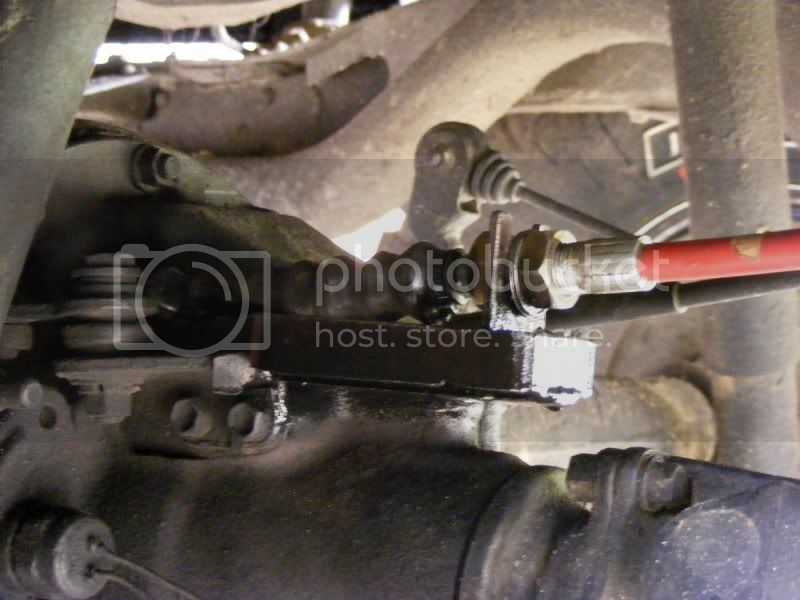

Made a bracket in the back, this one also protects the cable and rubber from excessive wear.
Wire runs up to the frame, accross the transfer case, and shoots trough the body right in front of the driver seat.
Hooks up to a modified e-brake from a lj70 with a ball mount. Right in front of the seat.
I cant tell comfort-wise if its there, i just know it! ;)
Hooked up everything, adjusted the wire ends and joy, it works perfect!

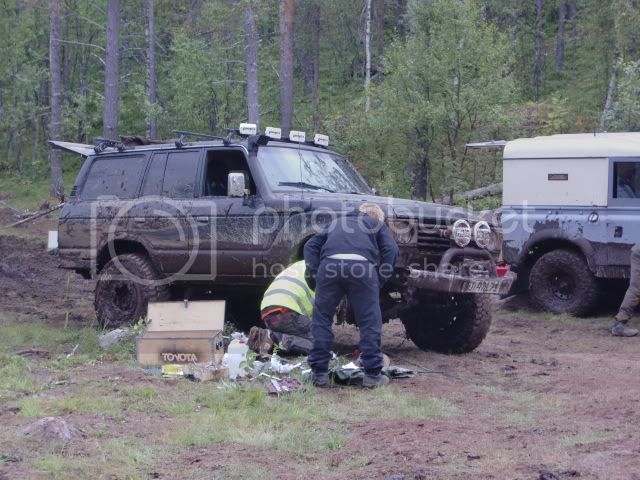

So i popped the smashed birf out on the spot, since i had a spare i the rig.
Diagnostics told me exploded birf, fubar outer splines on the inner shaft,
terrorized knuckle housing, oil seat bent and wrecked, and another wierd round big pice laying on its side inside the axle housing, all the way into the diff. :clap:
Probably the one thing centering the inner axle when putting it into the diff.
Since i had no spare inner axle on the spot, i mounted it all up and went 3WD rest of the day.
Went home after camp-time to pick up a birf and inner from the donor.
Happy moods in the camp beer-wise and people-wise. Got pretty cold outside, so i drive the rig into the warm tent and wrenched.
50-60 people got something interesting to watch while drinking...
Since i had the spares, i did the full job on the knuckle.
Had to break the thing in the axle tube to fish it out, and filed down the seat for the oil seal to put in a new one. Nothing in there was like it was supposed to be..

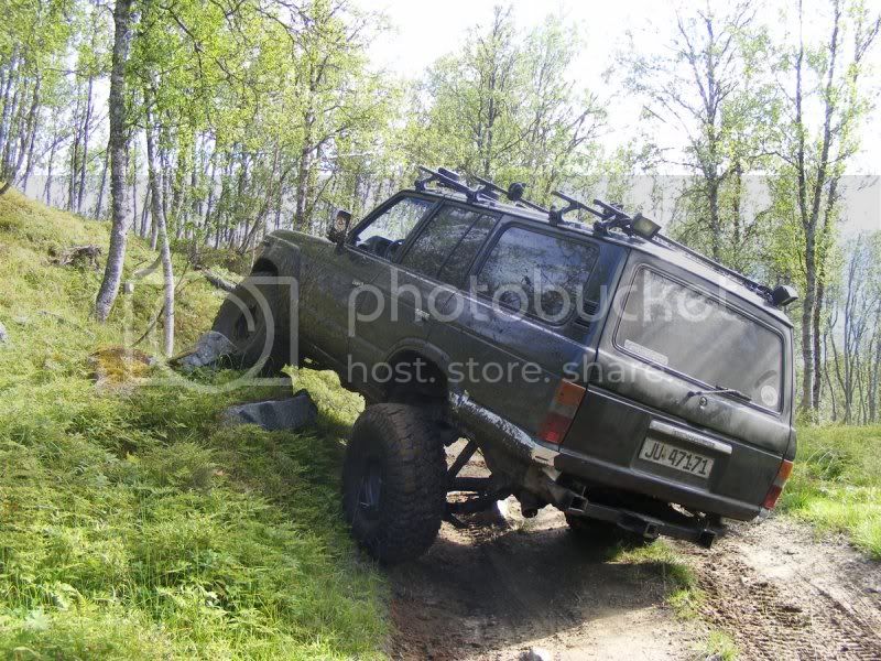

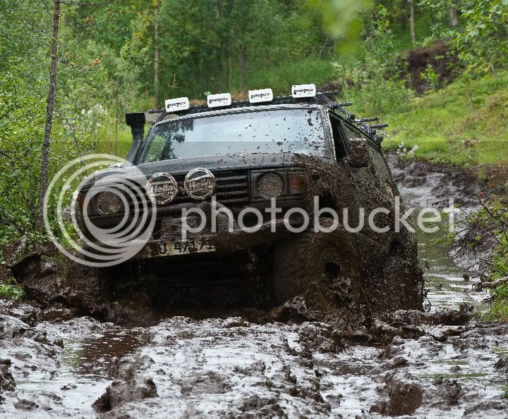

Sometimes the fully loaded 60 is just too heavy in the mud...
This pix shows me almost tipping over, into a deeeep mud hole... The picture ofcourse does not justify...
