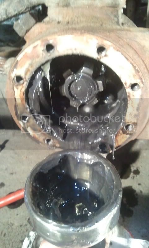

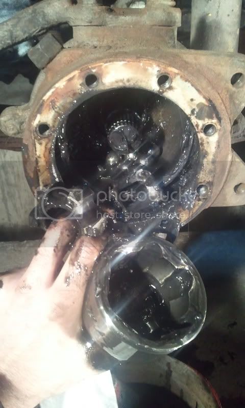

Some carnage pix.
Suprise!
Yummy...
Nice weddingring. The cage is gone, eaten to pieces.
Parts of it is wedged between the knuckle and the housing, prevents steering from time to time.
Is that what you have broken on the other birfs? I have only seen the birf ball break in the few I have seen. That cage totally broke apart, interesting.
My brother is putting the Nitro Chromoly Birfs in hopes they will hold up a bit better to the 37's. He has not broken a stock one yet though, just doing it preemptively.
Love the truck and what you have done with it, wish we had snow like that here to play in. :cheers:
First time it breakes like this. This is the "better than stock" TrailGear kind.
Honestly, the stock held up better.
But the star and the birf itself is not broken, just banged up from the balls going mad in there, eating the cage up.
Thanks for the compliments. But it still needs a few MUST HAVE upgrades, a few SHOULD HAVE upgrades, and some more love. Love is what i got most of right now. Should get better along the years.
