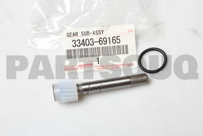

Tried to fix my Speedo reading
6x16 was installed ... I guess I should be closer to real speed with the 6x15 :)
According to a calculator I found online I should be spot on. Let's confirm with the GPS in a moment :)
In the end I'm 4km/h over ( at 100gps I'm 104 on the Speedometer)
But while at it I verified what size was good for the gear I had and I'm gonna keep it if I ever want to go back to 31s
It was almost perfect with my other tire setup too !
Anyway both fit the 6t drive gear 😅 I will now be able to get my fuel efficiency more accurately.
Tried to fix my Speedo reading View attachment 4033849
Cool! what part is this? Ill likely do the same once i get bigger tyres.
