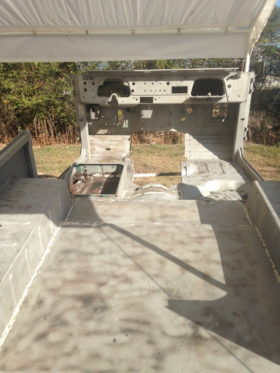

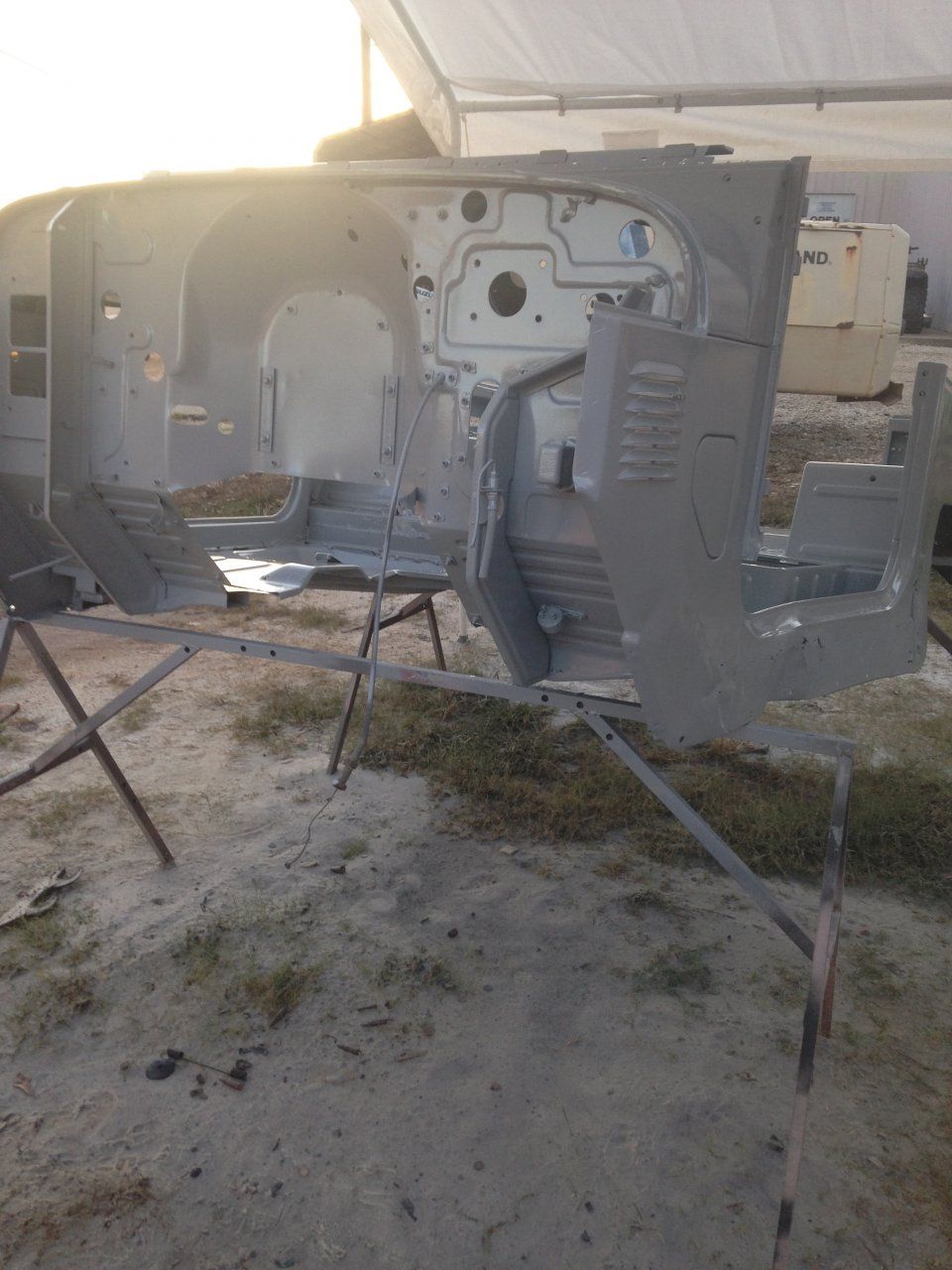

I've haven't made much progress lately. I've been mainly been taking the hinges and other small parts off to prep for sand blasting. What is reasonable price to have all the body blasted? I had one local guy give me an estimate at 1300 to dustless blast and prime everything.

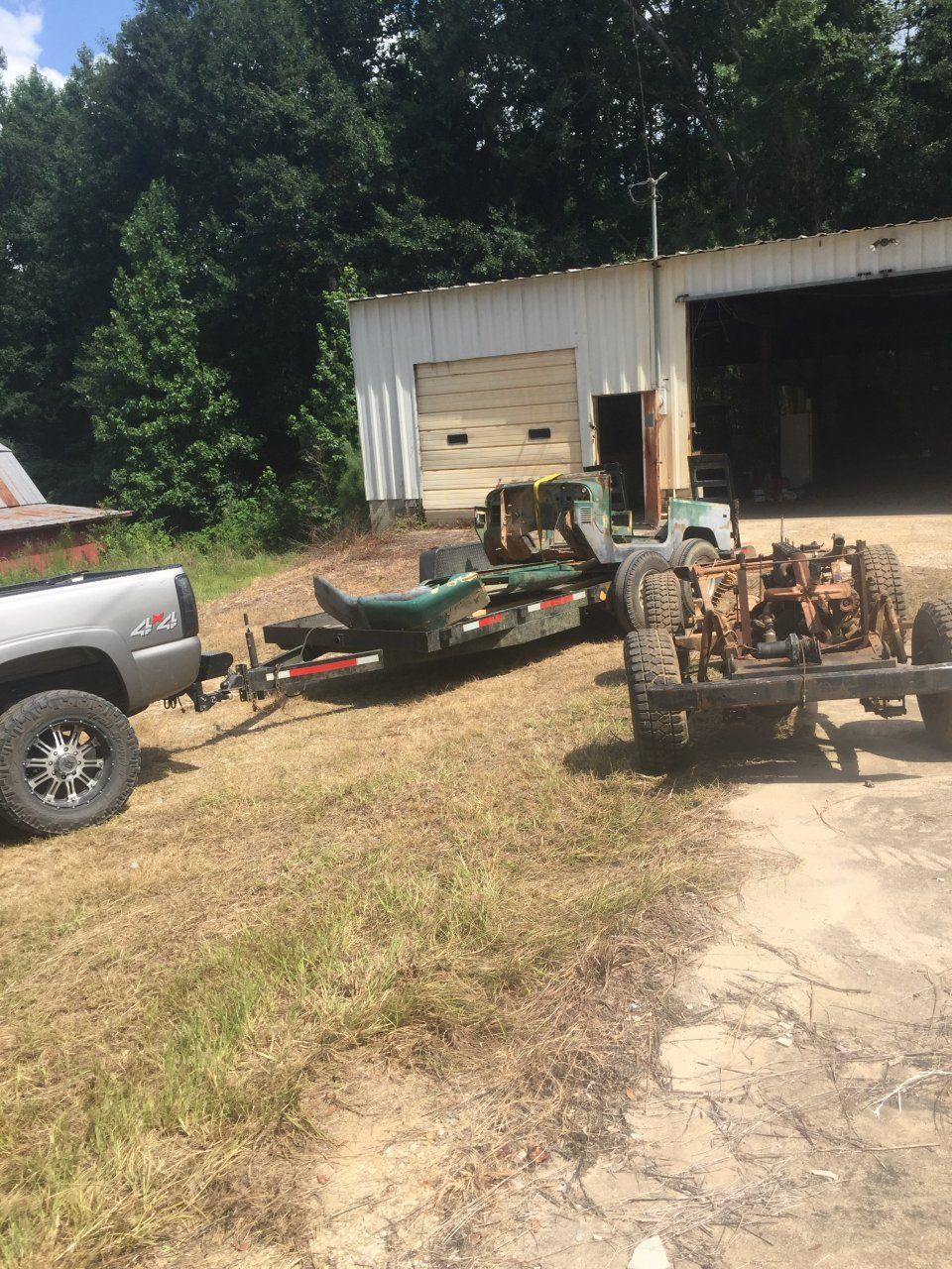

I had to make some room in the shop today so I could pull the engine and trans. I wrestled my 16 foot trailer and the tub for about an hour but eventually got it loaded. Once I got the the tub and the body parts out I started working on pulling the engine and trans. I got the motor and trans pretty easily.
Just a little update. I took the tub and most of the other body parts to get blasted. I'm starting to think I want to go the resto-mod rather than a stock restoration. Im thinking I would like to drop a mercedes om606 turbo diesel adapted to a h41 with a stock tcase along with a 3.7 r&p. Overall I want to achieve a realatively stock looking cruiser on a mild lift with a Diesel engine that will achieve decent fuel economy. I've seen a few 606 swaps, a fj60 I believe, a jeep jk, and a jeep Cherokee. Most of the swaps I've seen have pulled the electronic injection pump in favor of an earlier all mechanical pump that is more upgradable.
